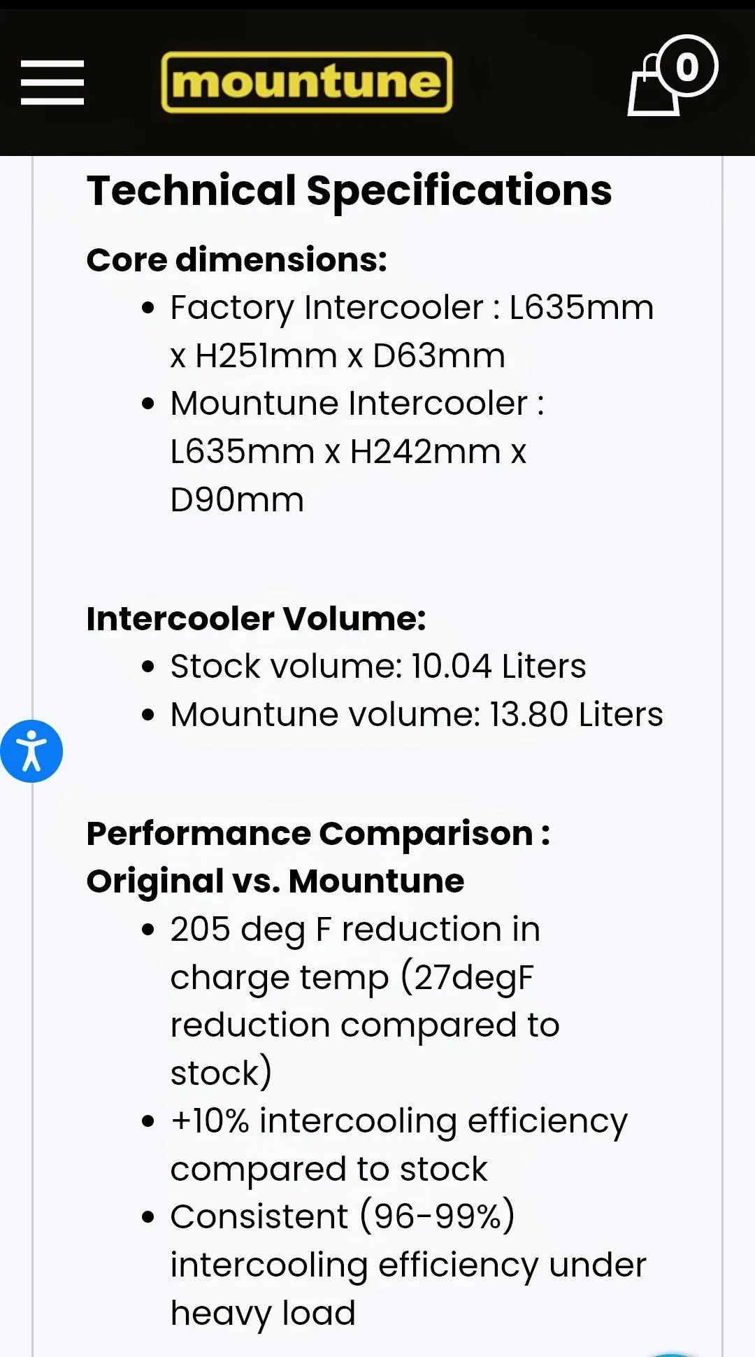

A forum sponsor has a 'flash sale' on their intercooler for our trucks.
While there is a decent debate for and against changing the factory unit out (and I hope we do that here) after looking at the dimensions and construction of what's available it seems the aftermarket is all aluminum bar and plate design and all similar dimensions except all tend to be an inch thicker. The common argument is that the plastic/metal stock piece 'could' suffer some separation and leak - but I'd argue a solid tig welded unit could crack too.
The all metal unit presumably would dissipate heat a little better and the increased volume I expect would change the perceived power band though I presume the maximums will be the same.
Here are the specs from the Mountune:

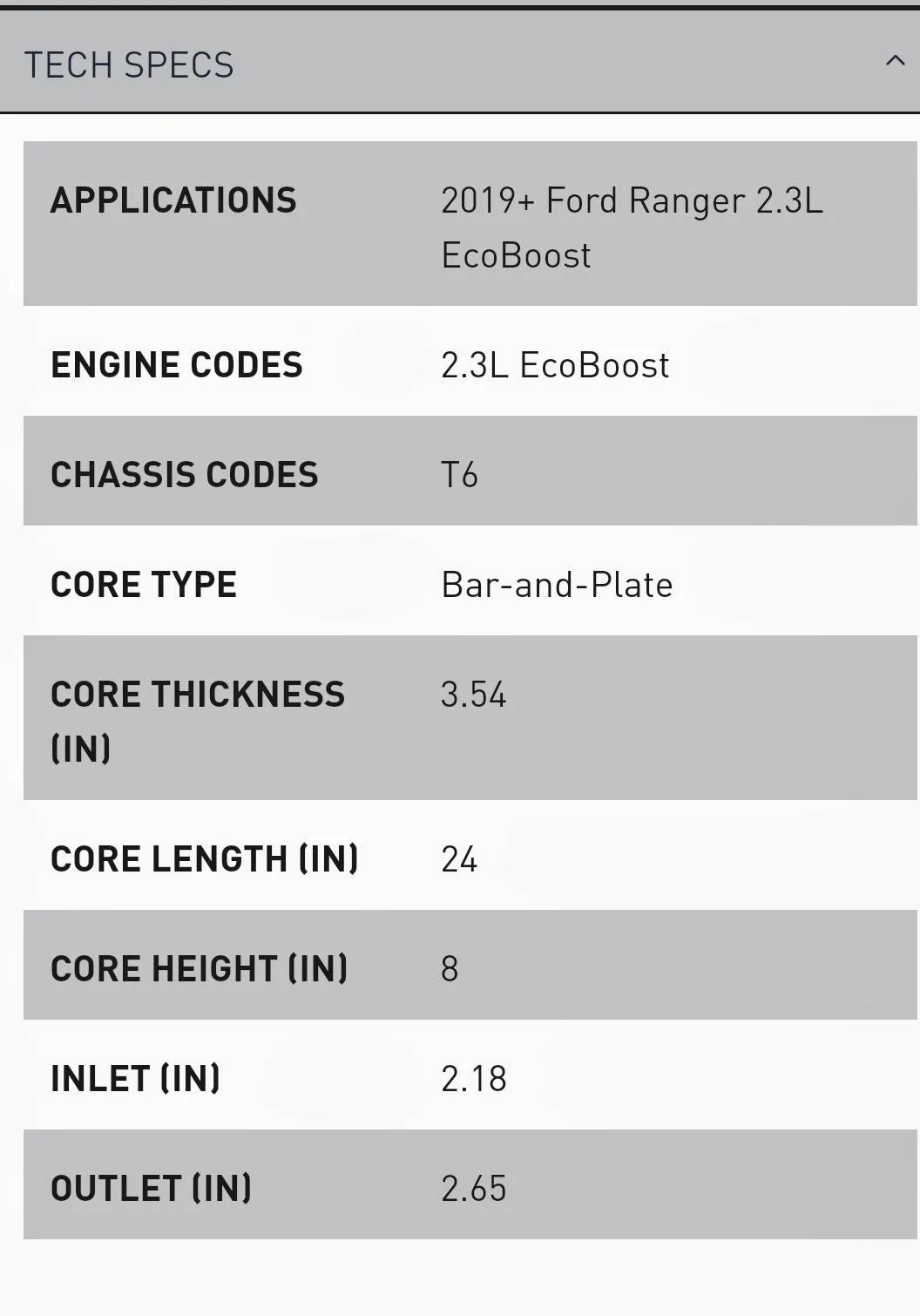

Mishimoto:

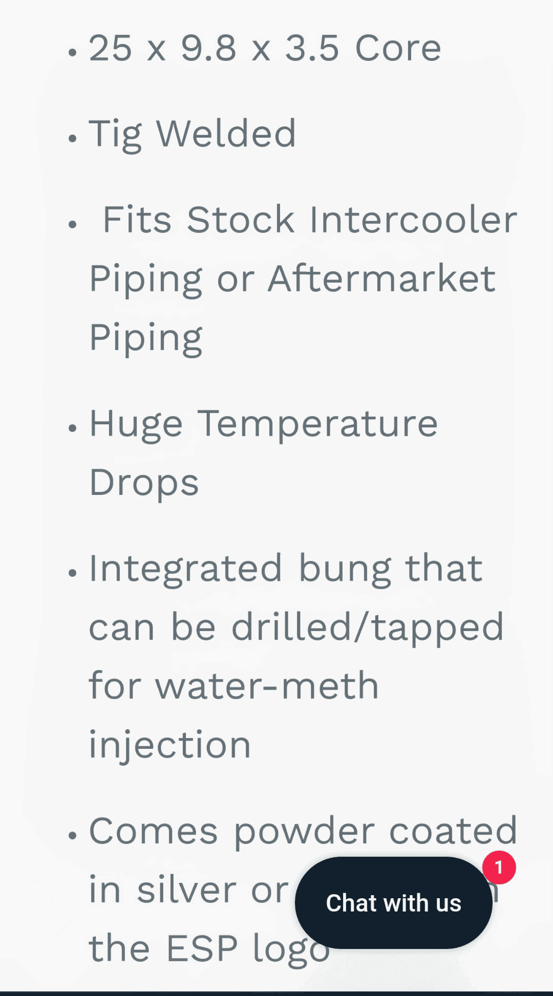

Elliott Specialized Performance:

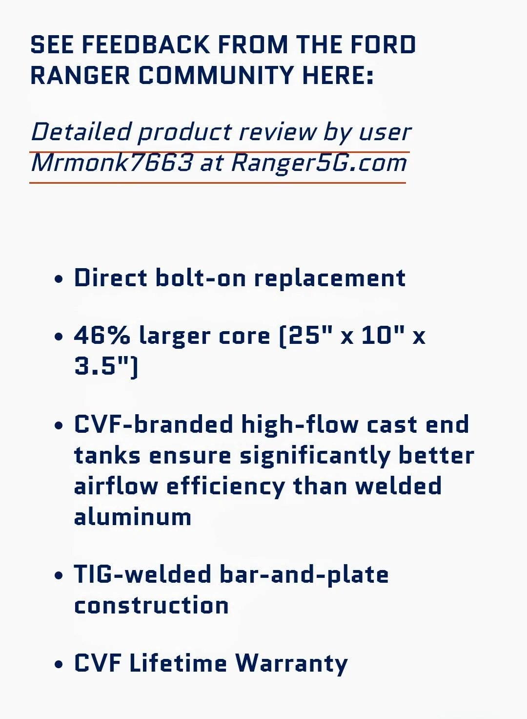

And CVF:
I've ordered the ESP via their promotion - my only hangup is I'm not a fan displaying big assed logos on my vehicle. (CVF being the price leader and no logo gets a nod)
Some thoughts here, maybe some big claims https://www.torquecars.com/tuning/aftermarket-intercooler.php
I've never put my truck on a Dyno and rely on perceived driving experiences to justify my spending. I'll likely get another base file to Unleashed and see if there will be any further refinement.
Since these aftermarkets are an inch thicker= more volume I expect some delay in boost coming on but also once fully charged (with cooler air) the same peak power. Whether the turbo can be manipulated (electric wastegate) or not and if my tuner is willing - I don't want to risk my engine - we'll see. I think I've read in passing there are some performance shops manipulating the controls?
Anyone else done this or weigh the pros or cons? Can changing this trigger codes (P04f0?)? I occasionally tow and spend all my time in the southeast. No offroading (RWD only truck).

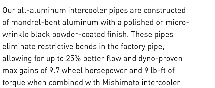

In the Mishimoto intercooler development blog with a non-tuned truck, the intercooler yielded like 3 hp and then power curved barely changed. Same with intercooler pipes too (see AFE dyno). However Mishimoto found the secret combo was to have BOTH the pipes and the intercooler together which yielded gains through the entire powerband of 13hp / 14tq. For example, Mishi changed their product descriptions to no longer highlight the power of these parts individually, but speak of the gains combined.
The hot side is the restriction. Mishi flow bench data shows a big difference in the hot side stock vs aftermarket pipe, minimal on the cold side. This is what makes CV Fab the better deal, you can buy a hot side only pipe from them for $180 shipped.
So overall the gains from the hot side pipe / intercooler combo are due to better airflow to the engine to make more power, NOT due to a drop in intake air temps. I too bought the Elliot intercooler for $300, but I’m only going to install it with the better hot side pipe or it’s not worth the change.

Just to chime in here with a few details as I've seen them mentioned:
- Despite size similarities there are still slight differences in the units due to core composition (charge rows, fin density, etc.). The eBay variants you see are the least effective, cheapest off-the-shelf cores available to sell units. Are they better than stock? Maybe. Are they the same? Definitely not. Data will prove this. Our cores, specifically, are engineered in-house and made to our specification. They are not off-the-shelf.
- Be wary of anyone who claims excessive temp. drops with 0 data (especially as of late). We're actually collecting some data on the Ranger IC specifically as we speak to prove effectiveness of our unit - this is something we do with every single intercooler. You want apples-to-apples testing above all.
- With that in mind, note on who says "HP increase with tune" as you want to see the unit alone, without a tune. Now, will intercooler raise your HP? No. But it WILL have a massive effect on retaining power on a run/towing/hot weather as your power normally drops off due to heat soak on the OEM unit.

Honestly? The logo's more about legitimacy than anything. Knock-off products don't use logos as they're bought generic in batches with little to no quality control (another issue with the eBay knock-offs). We cast our own end tanks to ensure product end-quality and we know it's ours if it has our logo on it (that, and in the differences in the cores).
The coating is heat-dispersant paint, of course. 0 negative thermal effects.

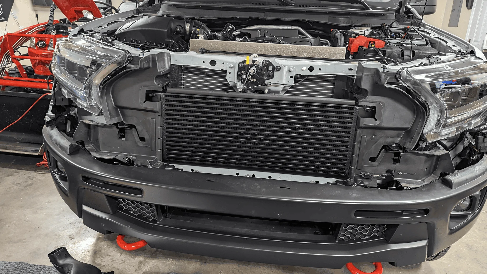

I just installed a Mountune intercooler and did not use the stencil. I went with an upgraded intercooler for towing purposes, but I will also be turning up the power a little bit as well, which still the real heat mitigation needed will be towing.
I did take some data logs prior to the intercooler and will take more after.
