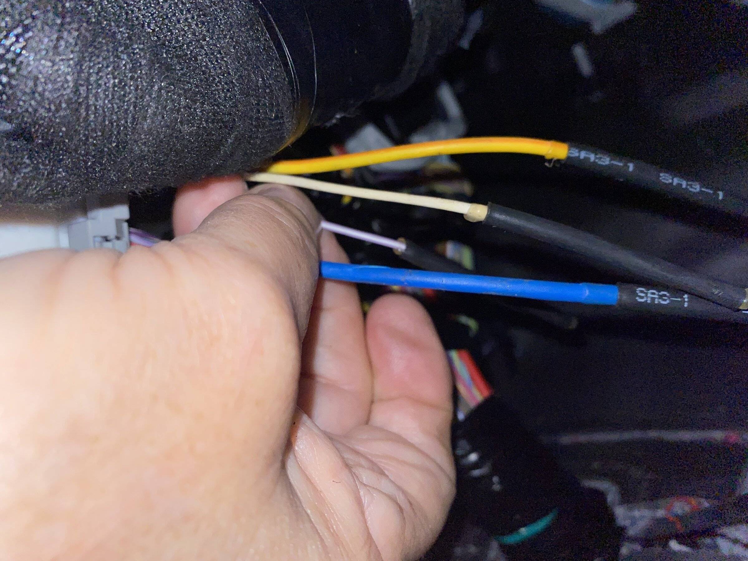

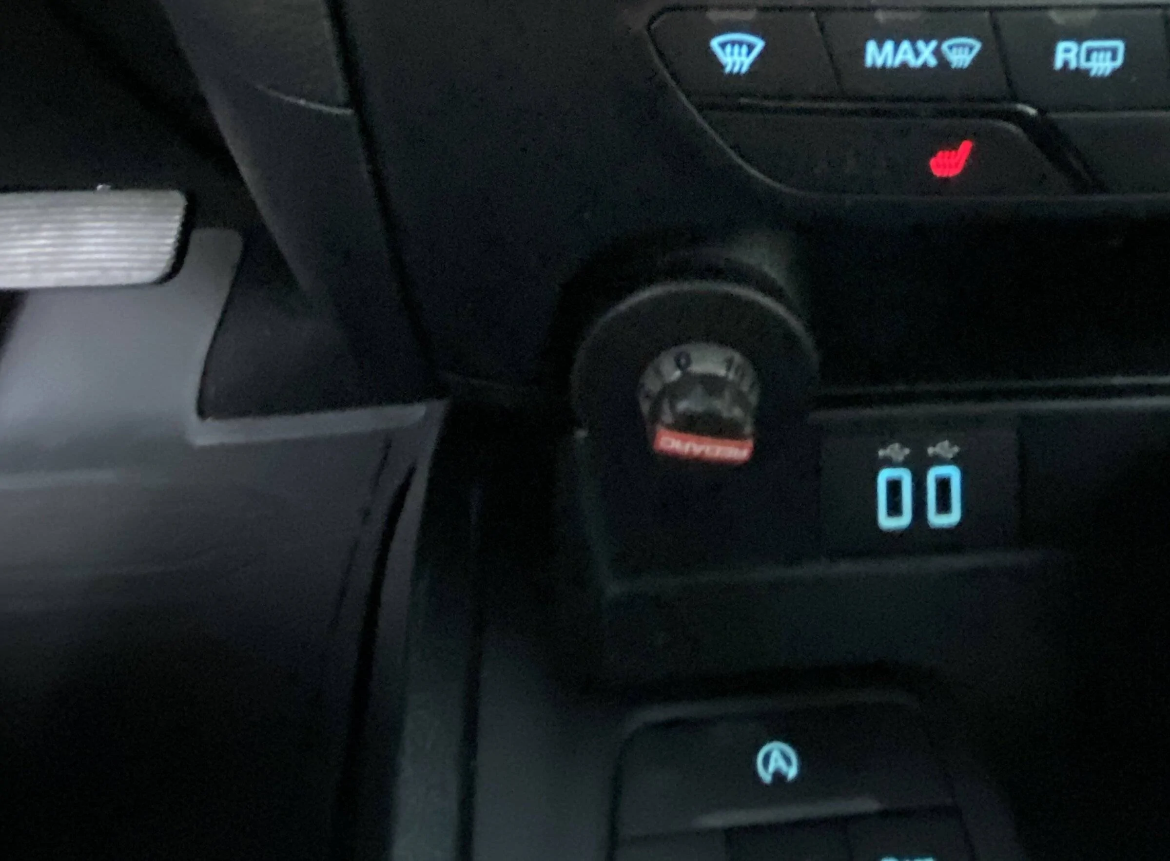

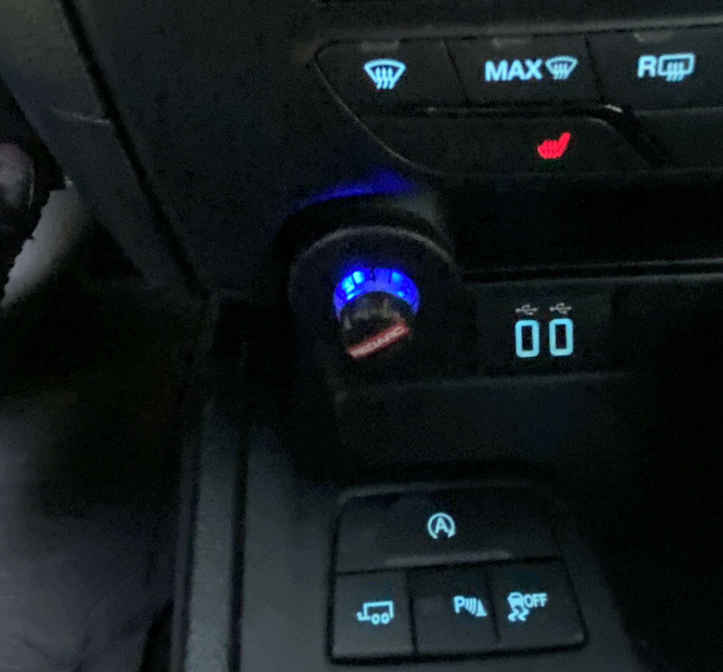

To all 2019 Ranger owners wanting help with brake controller choice/install. I hooked my truck to an RV for the first time yesterday to see how it worked. It worked perfectly, doing everything I'd hoped for. It's the Redarc Controller that's hard wired and easy to install. The picture is what it looks like on your dash. etrailer has a great video on how to install. You'll need to install a 7 pin connector with harness. Etrailer has that also. And they price match. I've never done anything like this before and I found it to be straight forward. Just don't get in a hurry. The entire job cost me around $270 and have me great satisfaction.
