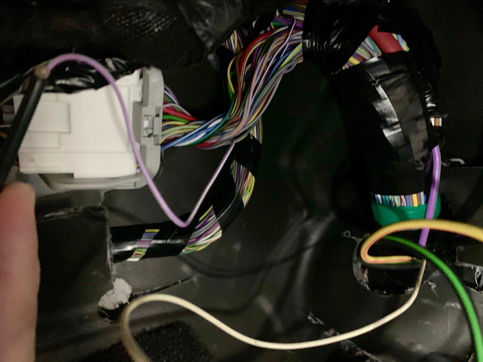

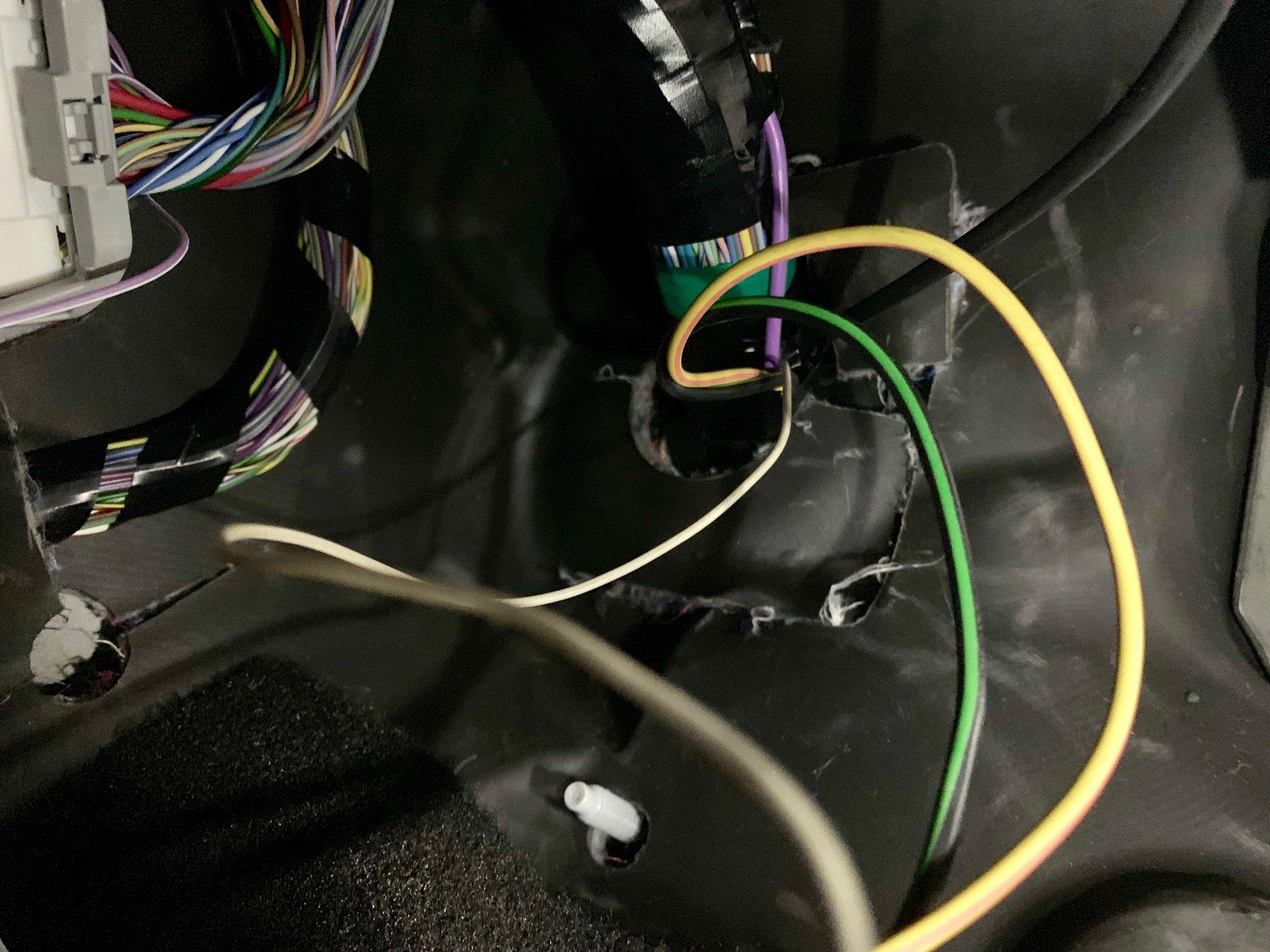

Pulled the lower driver kick panel and saw the 3 wires coming through the firewall. The purple wire was harder to find, it was taped up to the large white plug on the left in the picture. I had to extend this wire to reach where I wanted to mount the controller.

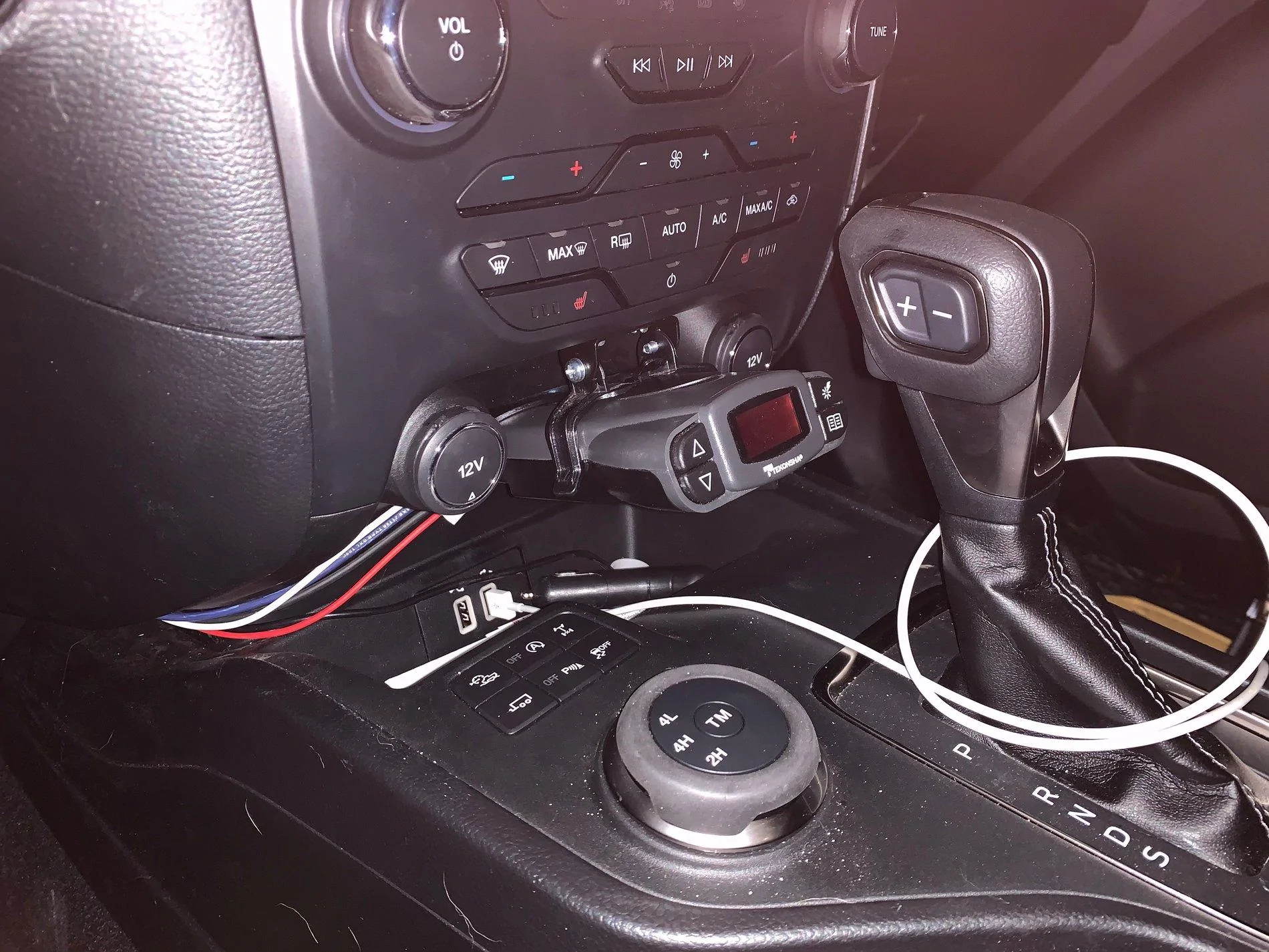

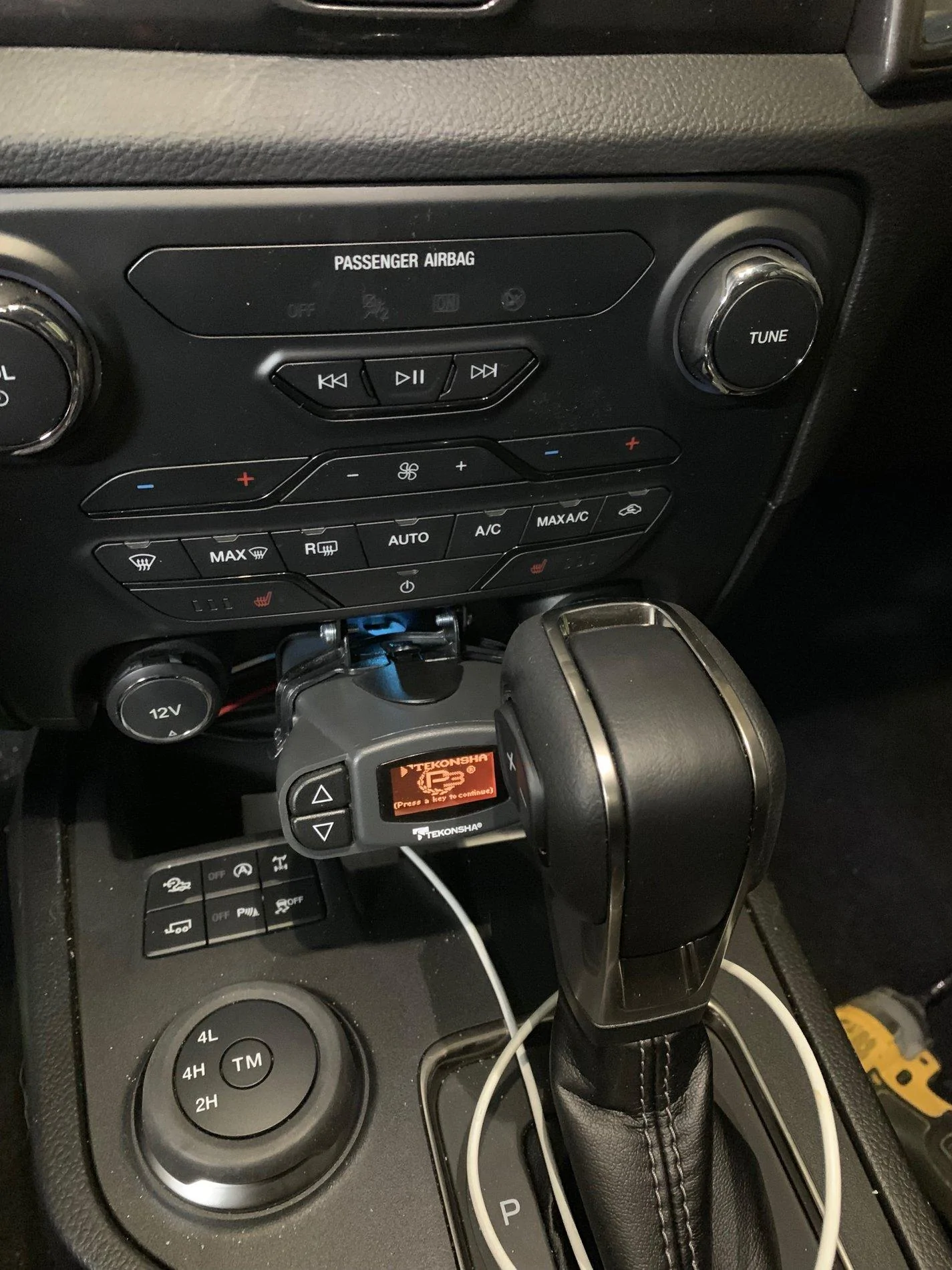

I thought about mounting it under the dash where my knees are but I feel like the knee compartment in the ranger is very tight already. I decided to mount it near the 12 volt outlets as seen in the pic.
This required taking the trim pieces off the whole dash, but I feel it was worth it. Its a very clean and convenient install.

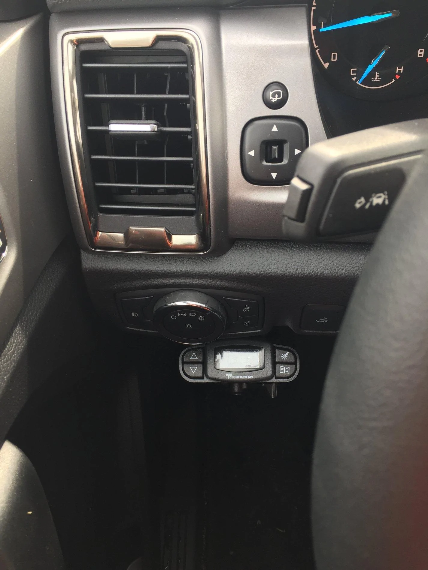

I put mine on the left of the steering wheel, that thing is too big for that cubby and it’s where I put my phone. It’s mounted with a really strong magnet so it comes right out of I need it elsewhere.

That’s great. Ya there’s a couple places to put it. I don’t use my cubby at all. I tried where you have yours but I’m 6 ft 3 and my knees literally would take out the controller every time I got out of the truck. I tend to sit close and secure, old habits die hard. My 5ft 10 wife moves the seat back every time she gets In.

I'm just an average sized human male, so I don't have to worry about fitting in places (usually). That spot worked for me, and with the magnet, it's a 1 second remove.

It relies on two of the magnets linked, one is placed inside the handle area, and the other is bolted to the P3's bracket. I did not secure the inside magnet with anything, but I would recommend doing so with either a small blob of super glue (small so you can remove it if needed). Or maybe some thin 3M grey tape.
I've bounced it down really messed up dirt roads and it has not moved on it's own once.

Have you confirmed the magnets do not interfere with the controller sensors?
t4thfavor
Chance
Feb 5, 2019
2,607
2,358
yes, the brake controller is accelerometer controlled, and the magnets have been stuck there since it was installed. No issues whatsoever with either the controller, the truck or the trailer. Sorry it took me several months to reply to this :)
