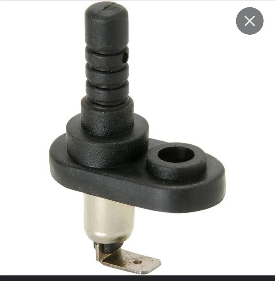

Plunger switches?

Ah, yeah sorry, maybe should've been more clear, I'm not sure where to attach those too to make them light up, was wondering if anyone had figured out the colour of the wire in the harness to tap into to make it work.

I tapped into the hood sensor to monitor my tailgate. The wires are right at the latch and you can split one and do a series through switches on your doors. Makes the warning come on in the dash and also triggers the alarm.

If this was a supported feature, it would be in the Body Builder handbook. What you're asking for doesn't appear to exist. It looks like you need to install your own separate indicator light with a switch similar to what is in Post 2.
