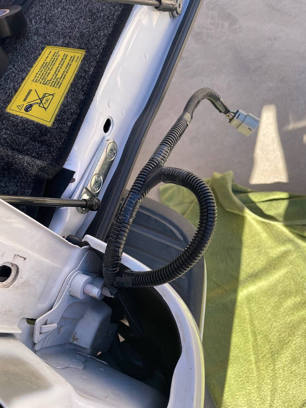

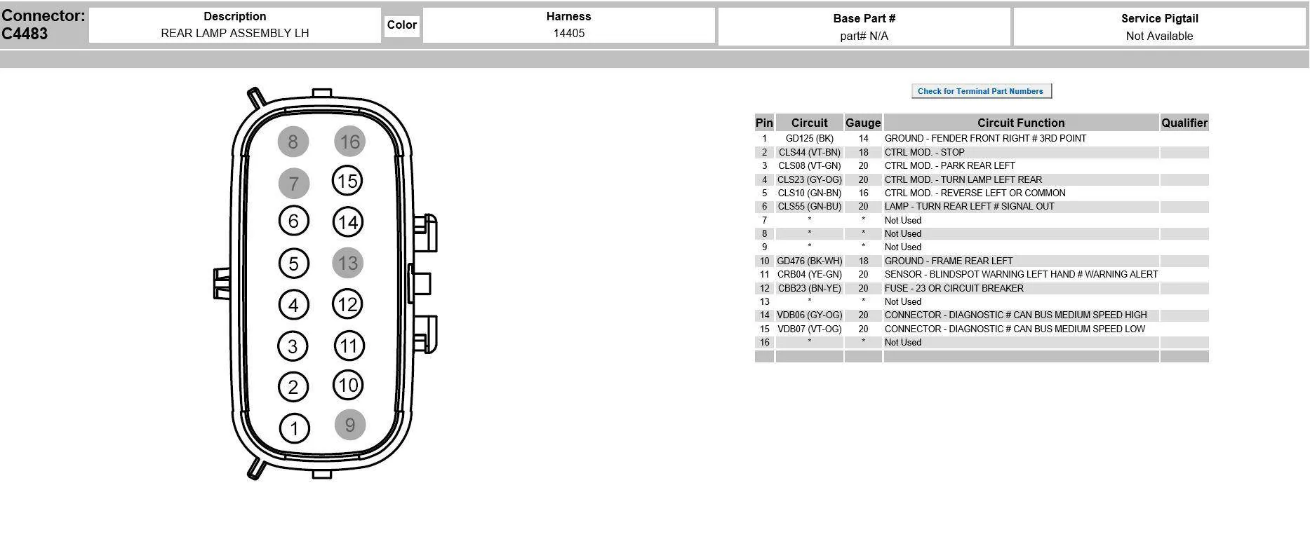

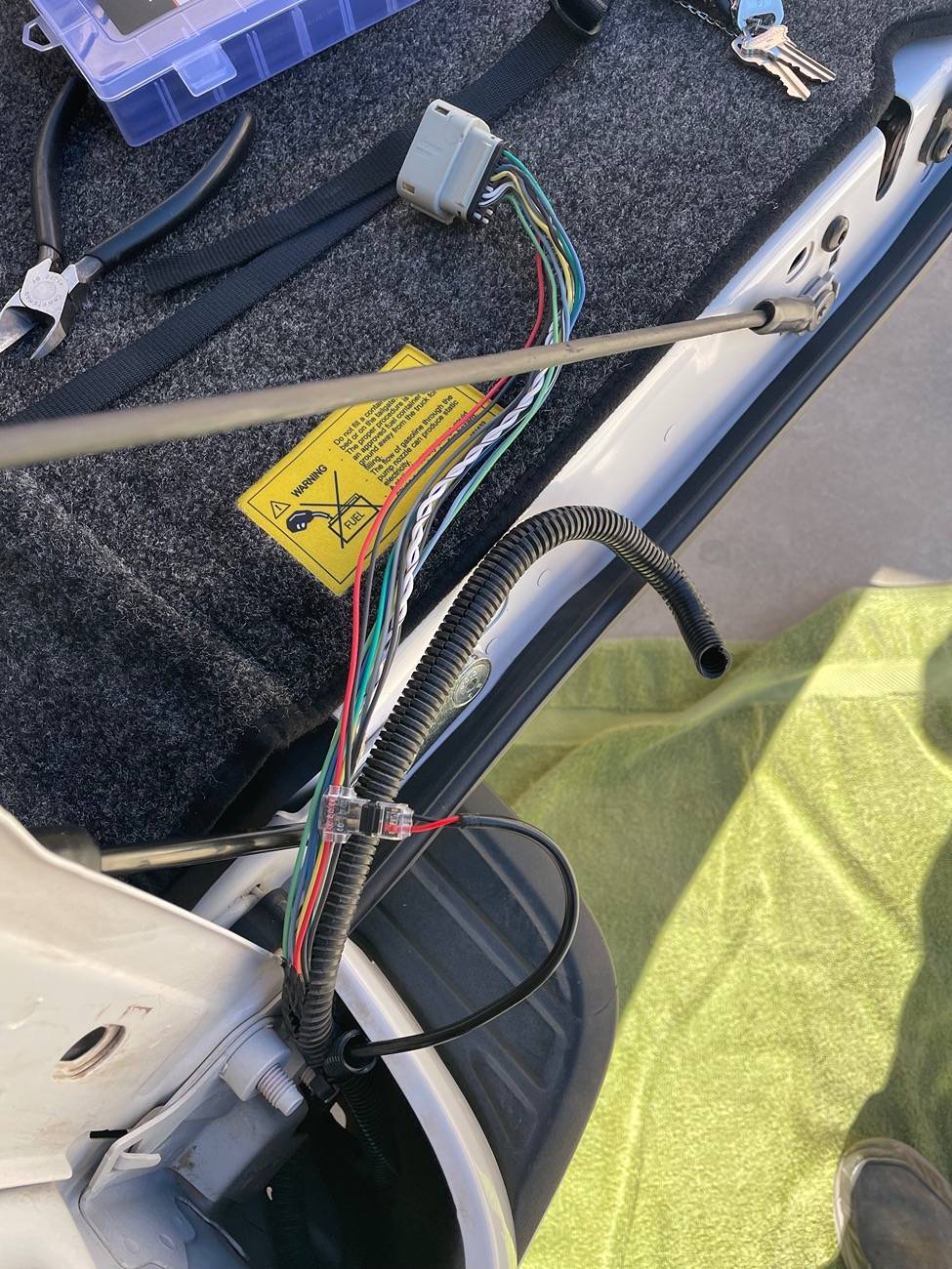

Fortunately, all my cap has is a center brake light. I just tapped the brake and ground wires. This is a Lariat with all the sensor stuff, so I was really hesitant to get into the harness, but it went well.

It’s pretty scary messing with factory wiring!
