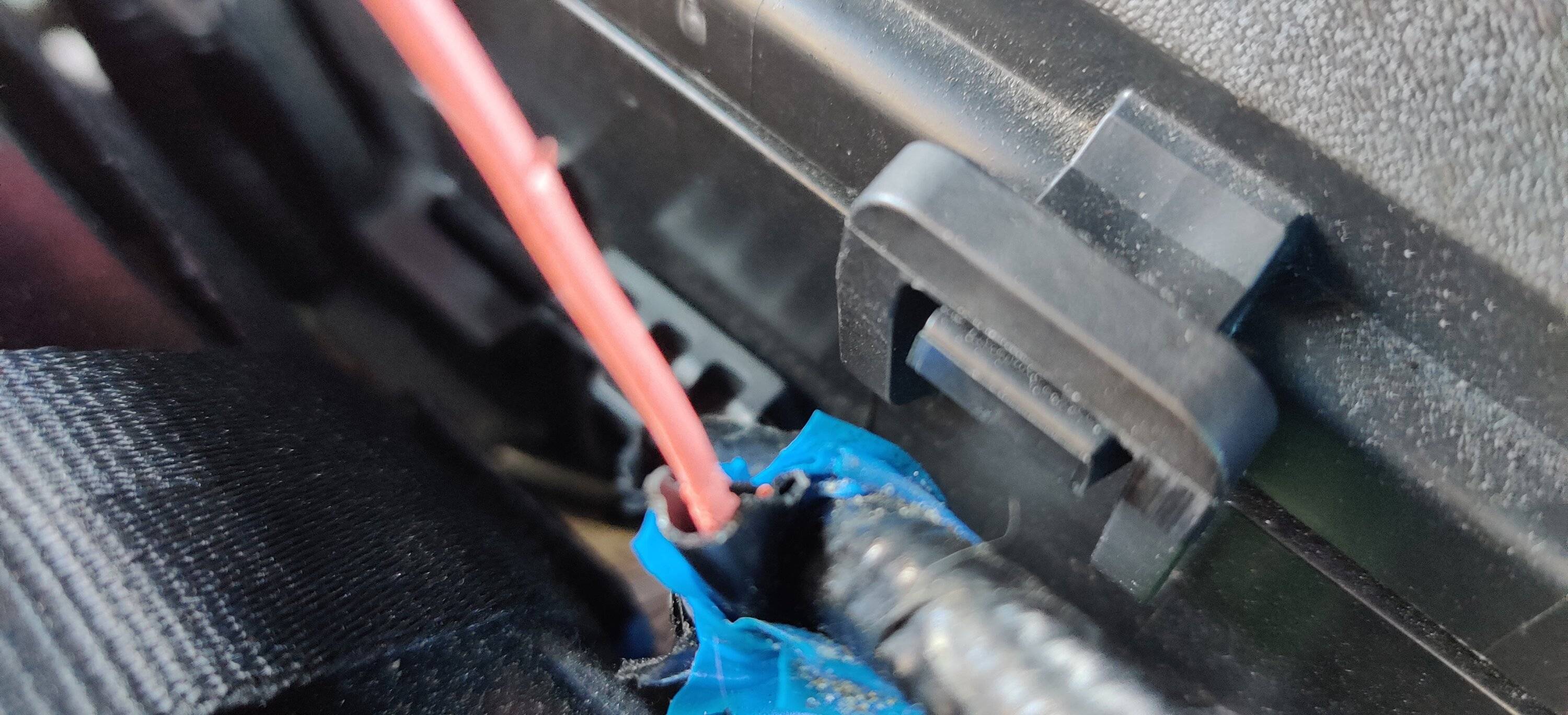

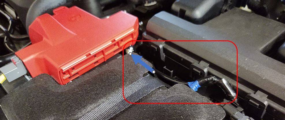

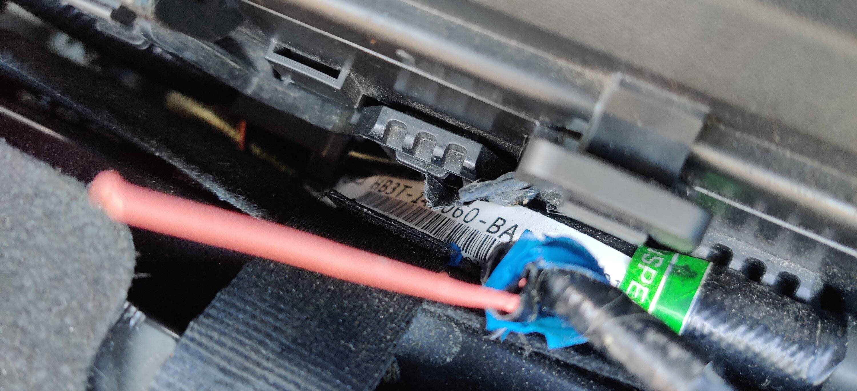

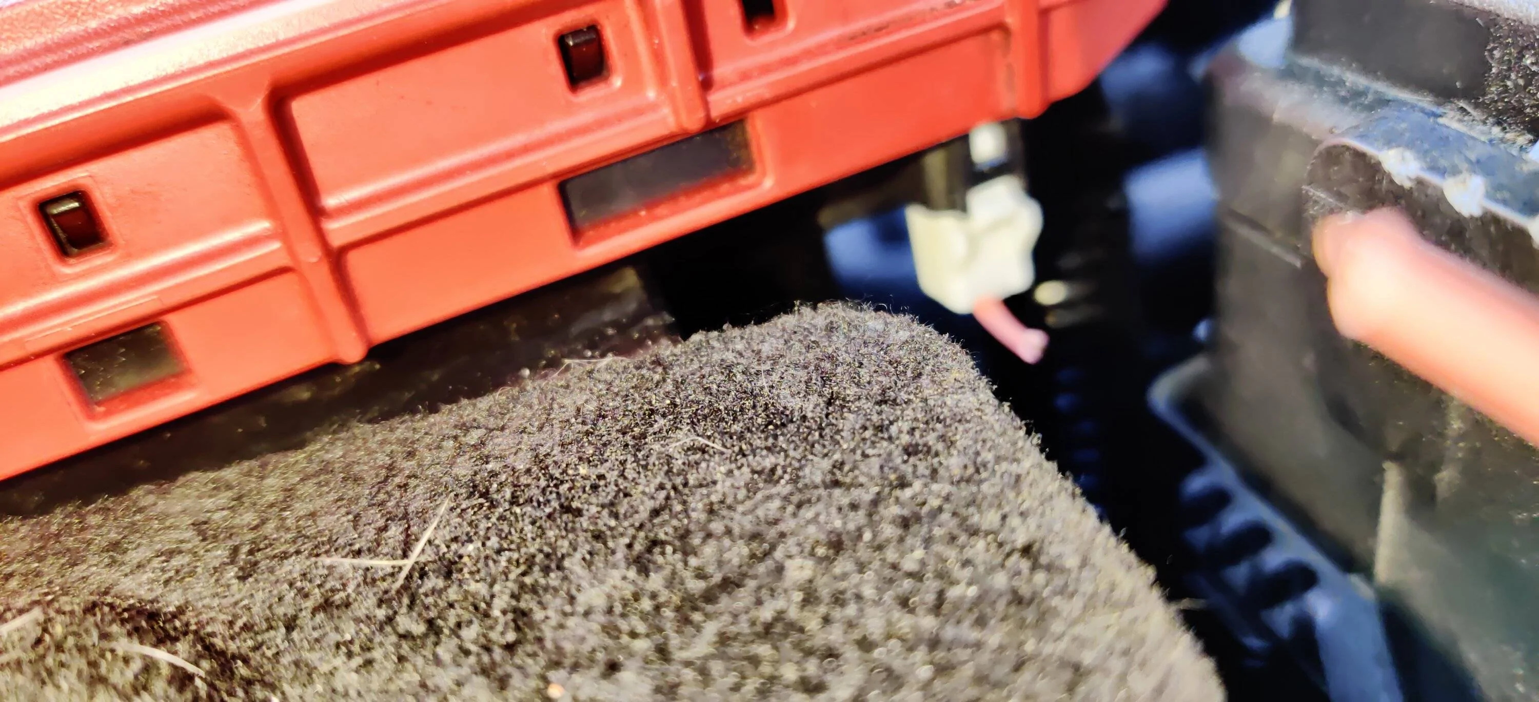

Wire plugged into positive battery terminal

Can you pop the battery out and find the other half of the wire where it has dropped down in the gap?
Actually found the the wire in 2 pieces and the black hose covering ford uses. The connector was still in bottom of positive terminal so I pulled it out without dropping it (actually tied string to it just in case). I have a lot of colored wire so I soldered a piece of wire to the connector then put some head shrink sleeving over it and soldered the other end attached to the truck harness. Was a bit tricky reinstalling the connector but I managed. Now the wire is tucked in between the battery and the fuse box.

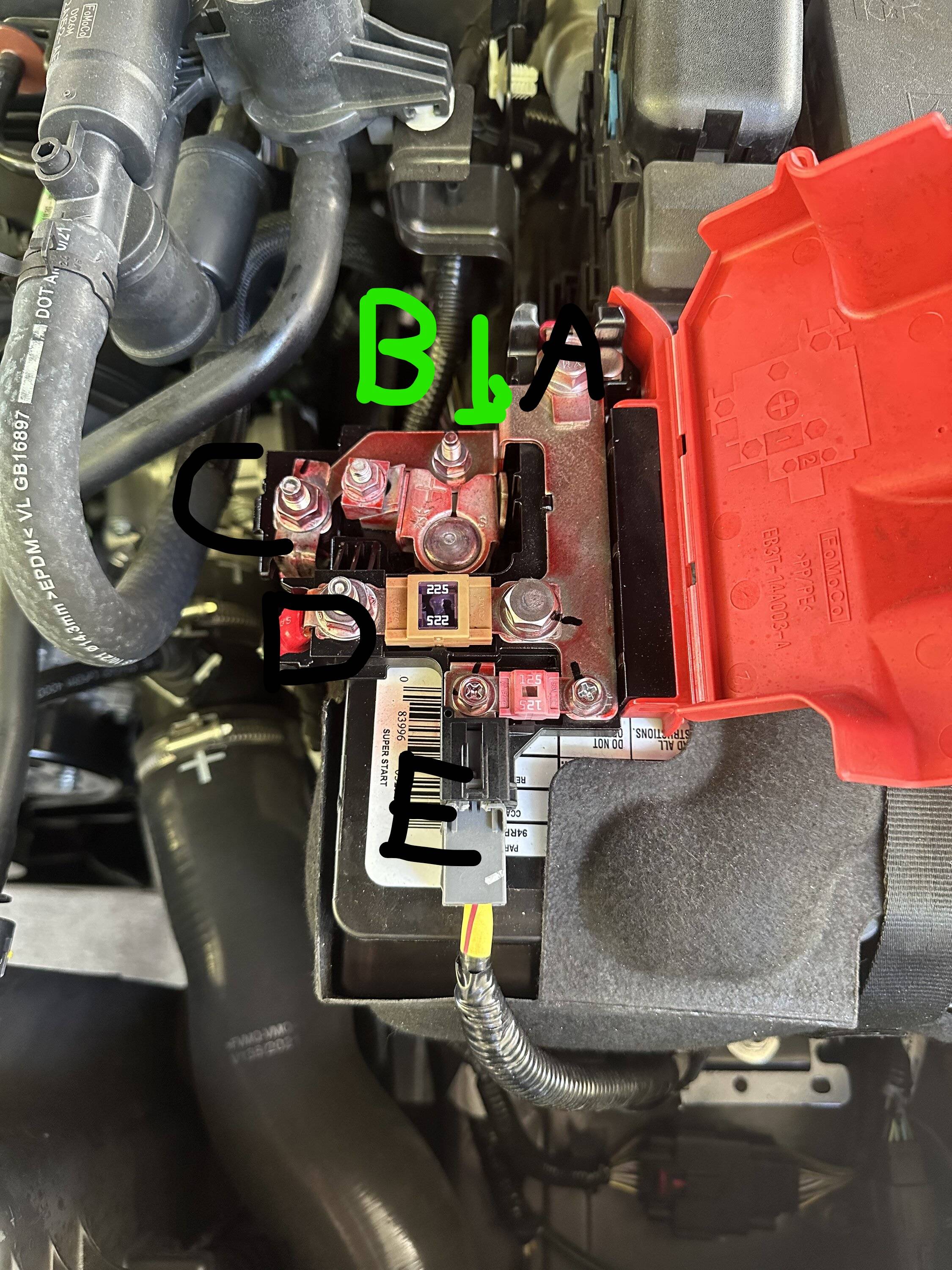

The Wiring Diagram is not 100% Clear on this but deduced that the only 20 Gauge wire going to the Battery Mounted Fuse Link is the Power (Battery Voltage) feed to the BMS sensor on the negative terminal.
I have deduced as follows:
By Connector #
C1135A = (4 Gauge) - Bolt On - Starter
C1135B = (20 Gauge) -Plug In - BMS Sensor (Note: Plugs in from Bottom) - Not Shown
C1135C = (1 Gauge) - Bolt On - Battery Junction Box (BJB) Power Feed
C1135D = (1 Gauge) - Bolt On - (Fused 225 Amp) - Generator
C1135E = (4 Gauge) - Plug In - (Fused 125 Amp) - Power Steering Control Module (PSCM)

Hey, unrelated and I know this post is old, just want to thank you for the great close up of the better terminal. I changed my battery out the other day and this morning truck wouldn't start. Found positive terminal was loose and realized I had switched the two lead pieces

Hello- realize this is an old post and my comments are unrelated. Just wanted to thank you for this detailed pic of the battery terminal. Truck wouldn't start this morning, checked the battery and the positive terminal was loose and I couldn't get it to tight down. Searching the forum to see if anyone has had a similar issue, came across this photo and realized after seeing your pic, when I'd changed out the battery a few months I accidentally reversed the metal “split-cube” 180 degrees. So the bottom part wasn’t pushing against the batter terminal to close it. So, thanks for this!
