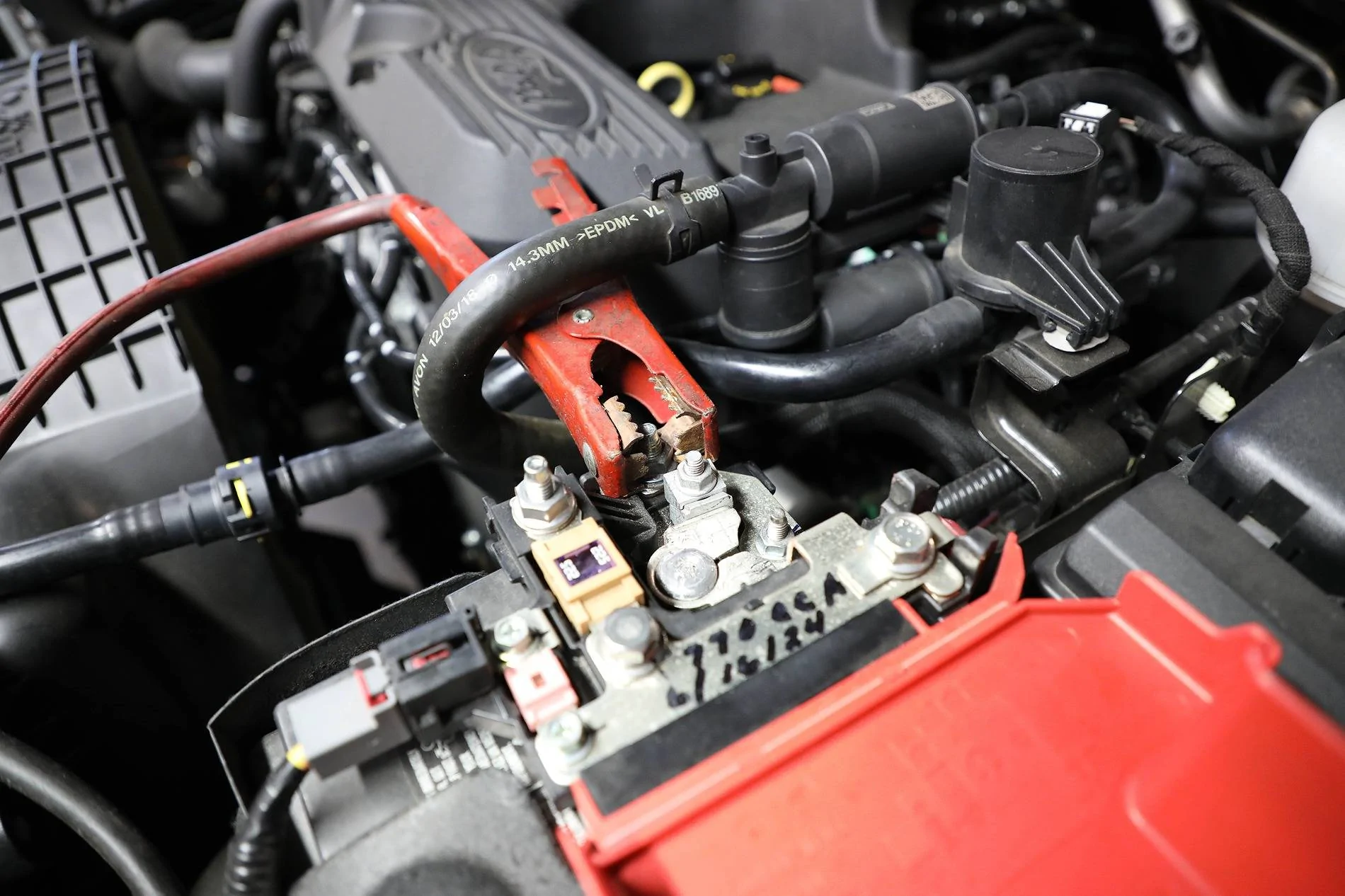

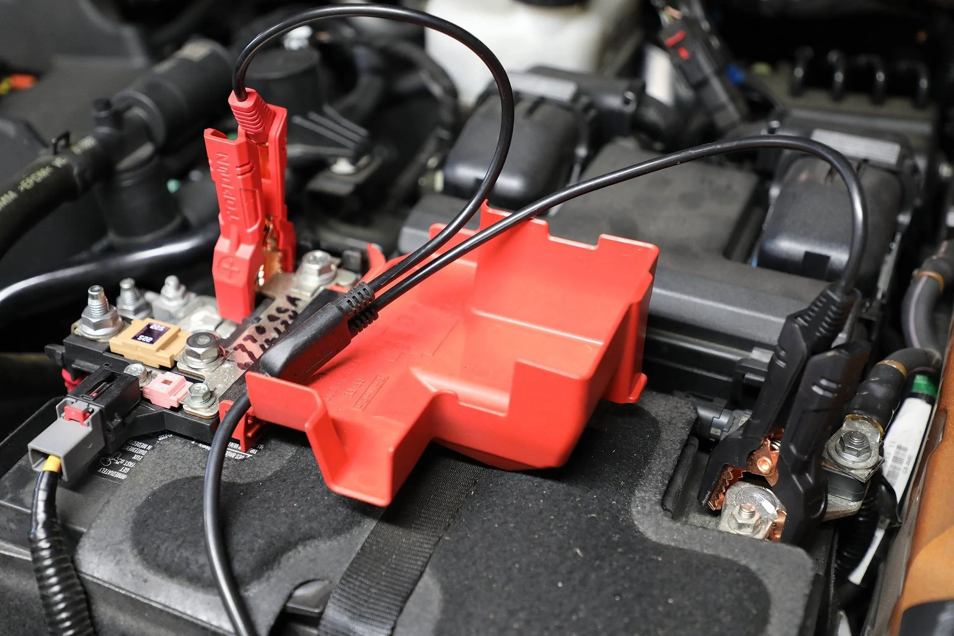

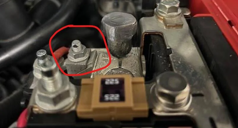

I wasn't criticizing the concept of what you are doing. I have the same problem with using my Topdon battery tester as well, due to its small size clamps. I have found that clamping to the vertical edge of the buss (which is hard to get the clamp to stay on, since it is narrow), seems to be the best connection for the Topdon. I get the best readings clamping there. I haven't taken my positive battery terminal off to use the Topdon, but I am sure it would give the best reading. I wasn't trying to discourage anyone from finding a better solution, but my battery jumper cables work fine on the Ranger battery terminal connections.

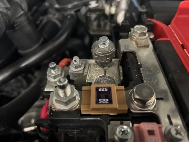

Here are a couple of pictures showing my jumper cable connection to the positive buss of the battery, and my Topdon battery tester connections. Hope this may be of some help to someone.
