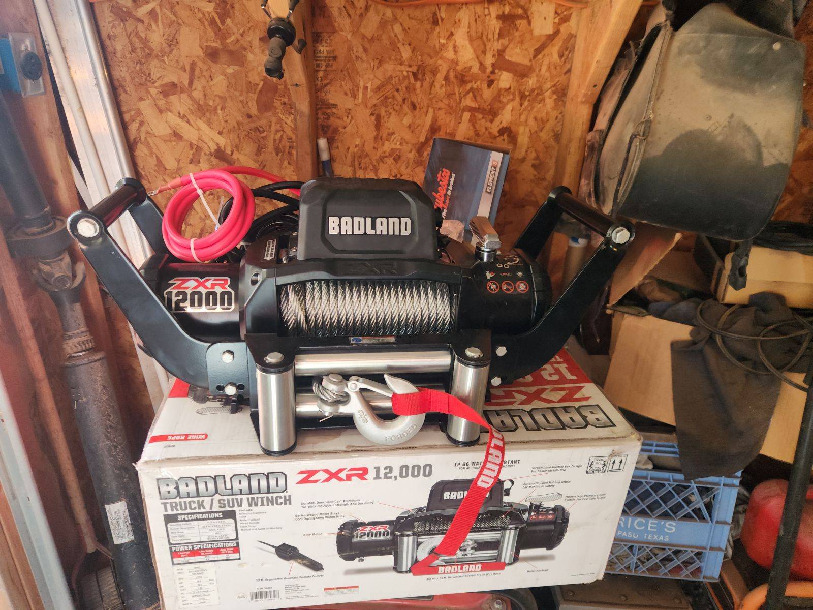

350 max @12k pull, that info is printed on the box. It's a harbor freight zxr 12000 badlands winch. I do know Anderson connectors and thanks to your question I see I need to select a higher amp connector than I perviously had.
4,572
23,285
This is the only Pic I have right now. Will take pics after wiring install.

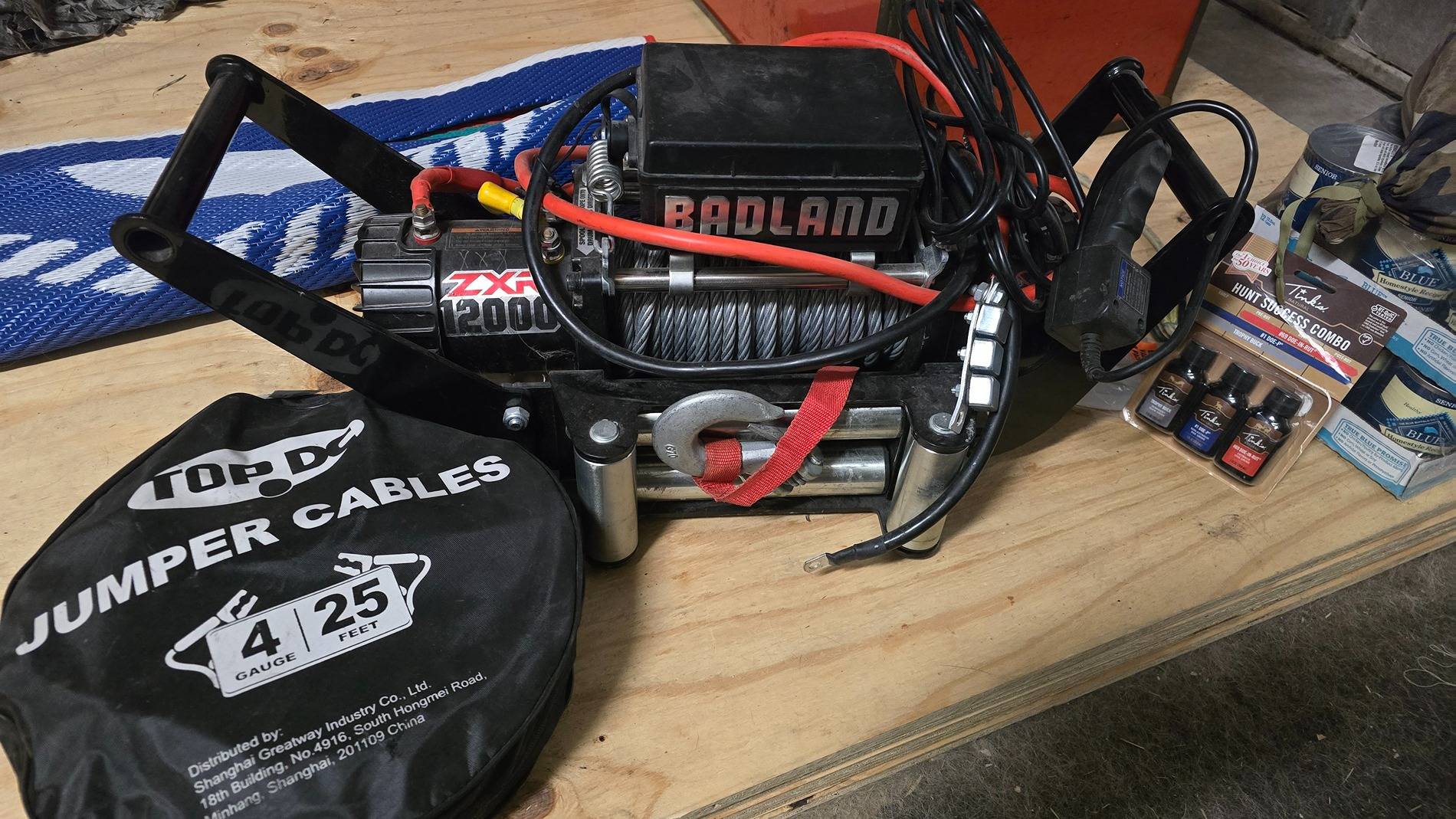

This is my set up. I use these super long jumper cables to power the winch when in use. Its a set that has worked for me so far. I attach it to my rear receiver, usually to bring cars up on trailers and stuff. Over summer hope to have a more permanent solution installed where it is just plug and play.

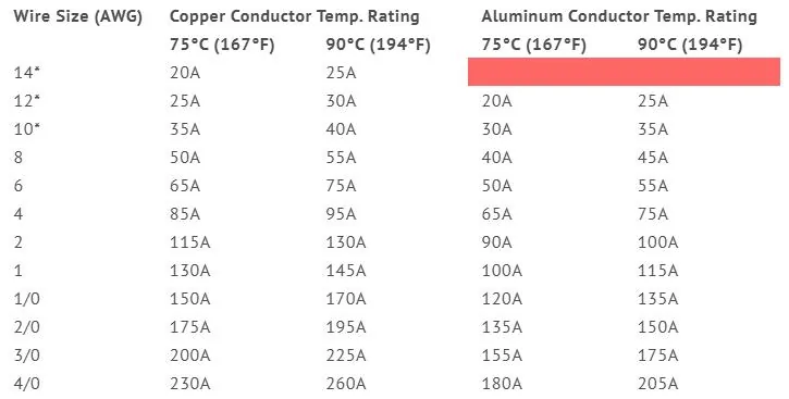

And thanks for the link but thats only 2ga and I've been looking at specs and the minimum I can run would be 1/0 may even go to 2/0 I've chosen the Anderson sb350 amp connectors
So your using 4ga jumper cables and not having issues under a heavy load?
No, they dont heat up spark or anththing. If i use it for 5 minutes thats a long time. When used, i dont use it for that long. The longest time i used them for was to pull a small utility trailer on top of a bigger utility trailer. I have not done recovery, ropes and straps for that, but just for moving heavy thing usually on top of a trailer.
For my needs and uses, this has worked okay. The only hassle is having to open the hood and attach all the jumper cables to battery and winch.

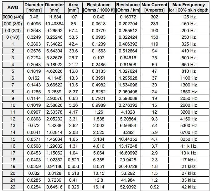

According to those charts they don't make a wire big enough to handle the amps. And that's not correct. 2 ga battery cables deliver as much as 350 amps when cranking

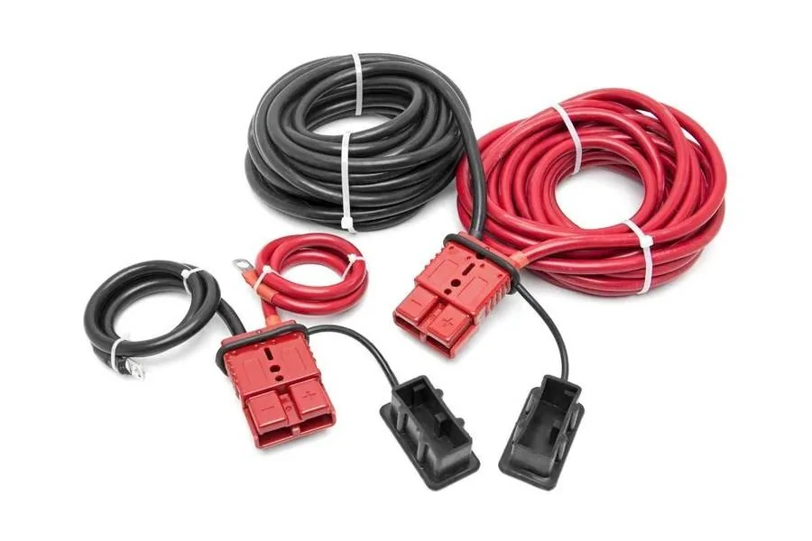

For what it's worth, I have a Warn 10k VR Evo winch and have Rough Country 24' 2 gauge cables that I use. Granted I haven't done any really, really serious pulling with it, but it hasn't been an issue for me.
I have the normal rear receiver mount and also got the @HeavyDuty front mount. I've pulled from both mounts with no issues.
