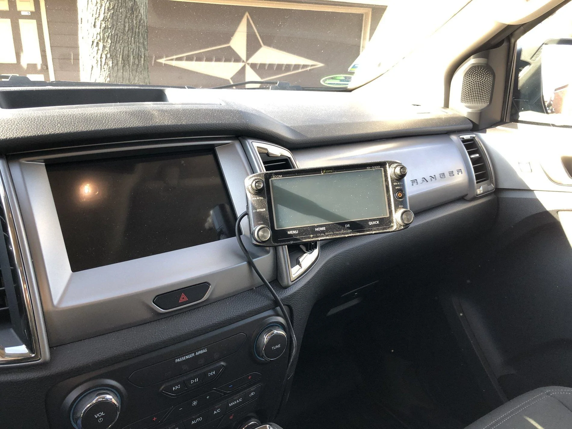

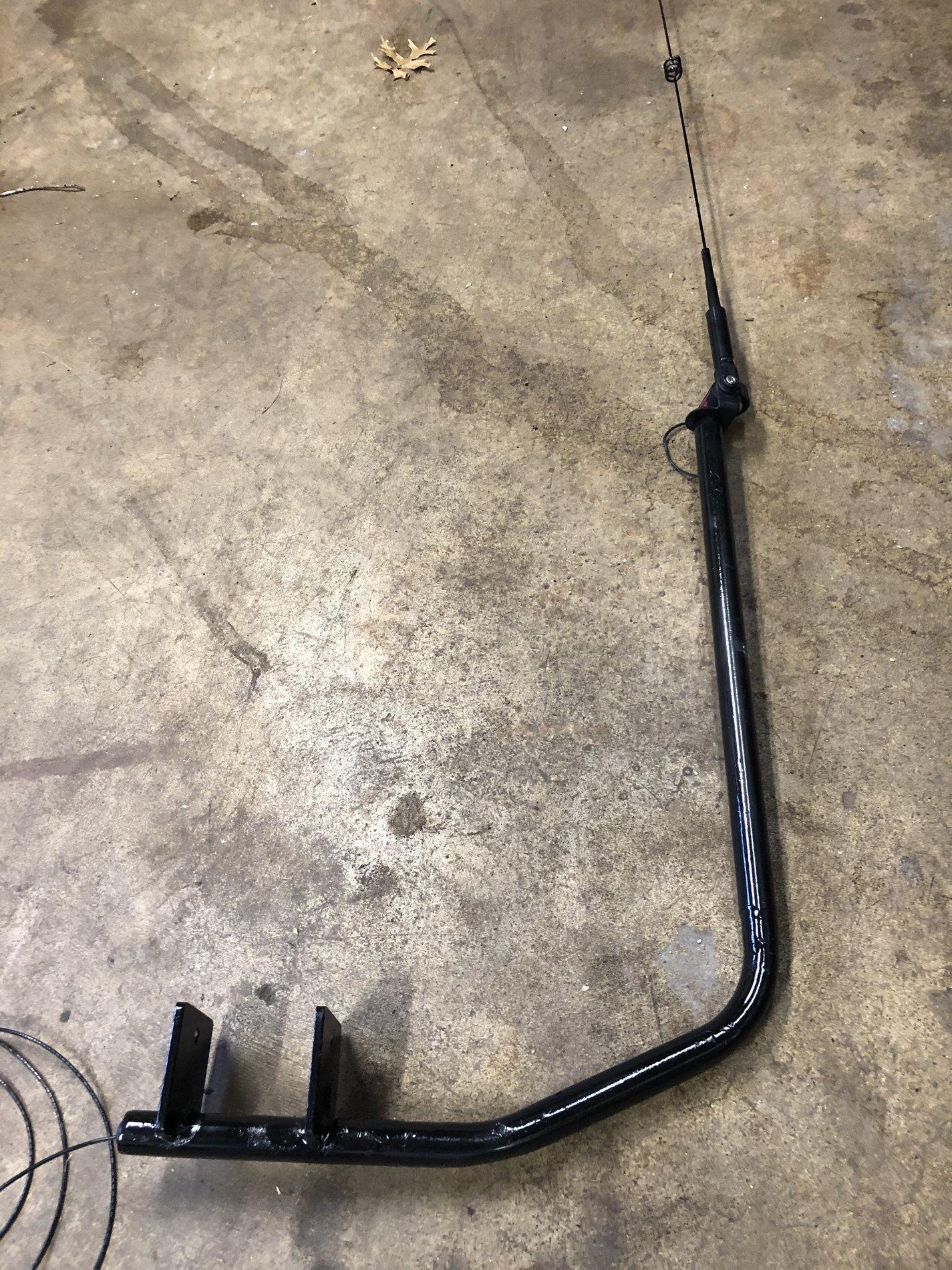

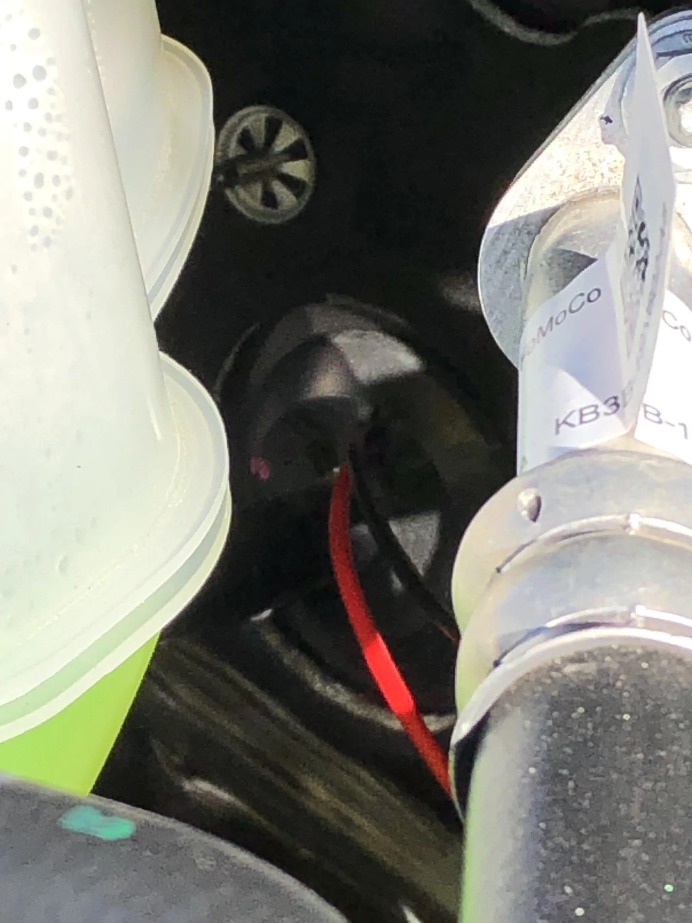

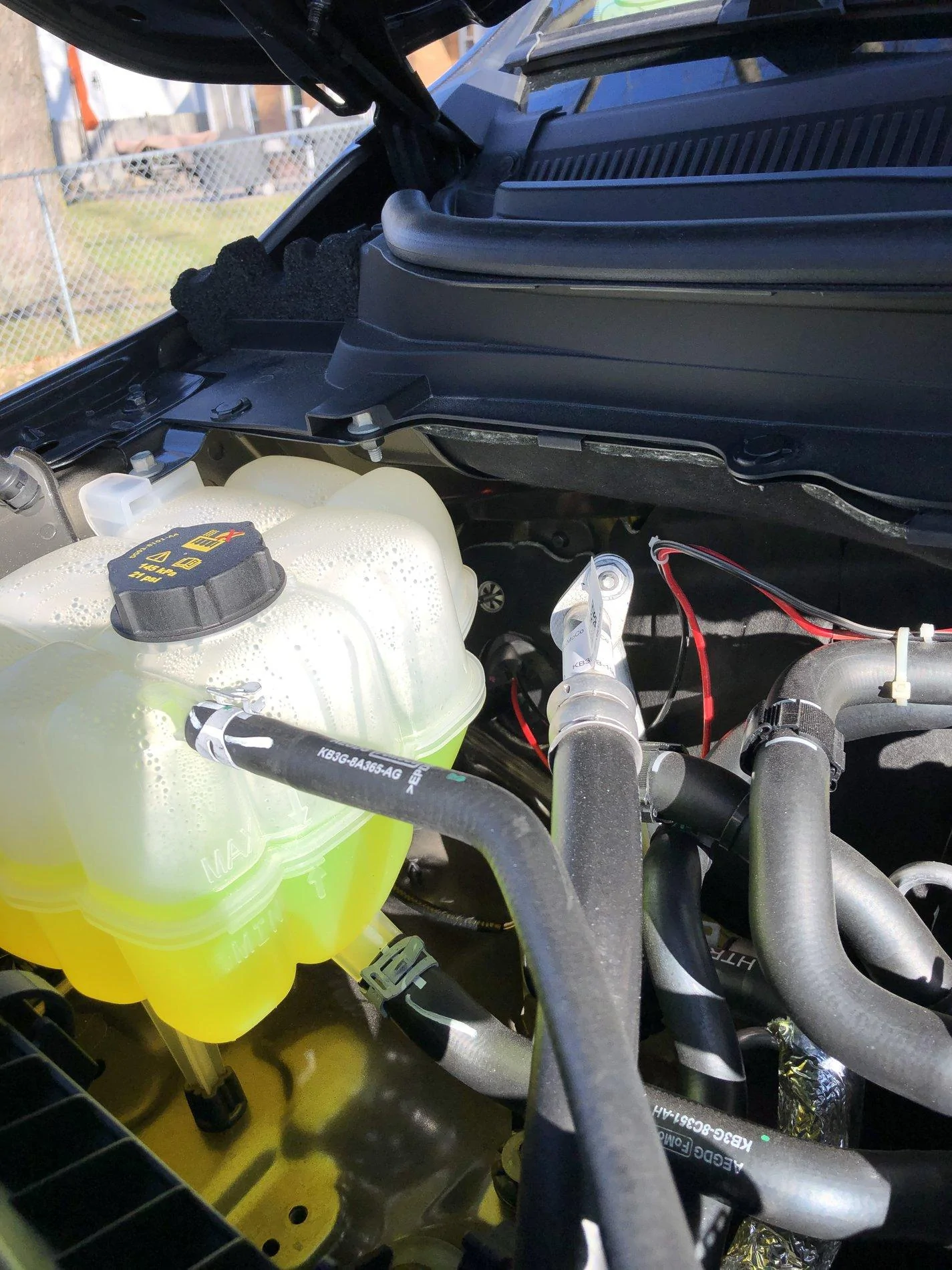

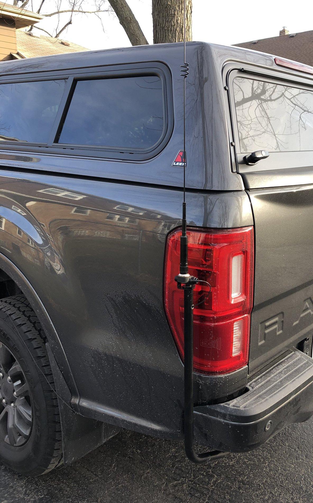

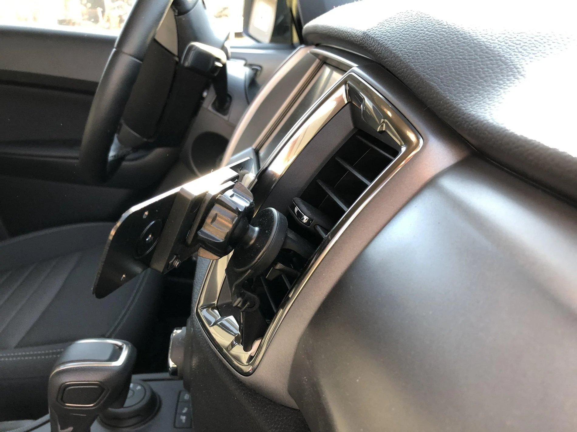

The head of my Icom ID-5100 is on a dash vent mount. The radio body is under the passenger seat. The wiring goes from the battery through a grommet on the lower right (passenger) side of the firewall. From there it sneaks over to the radio body. Custom antenna mount to the frame still being worked on.

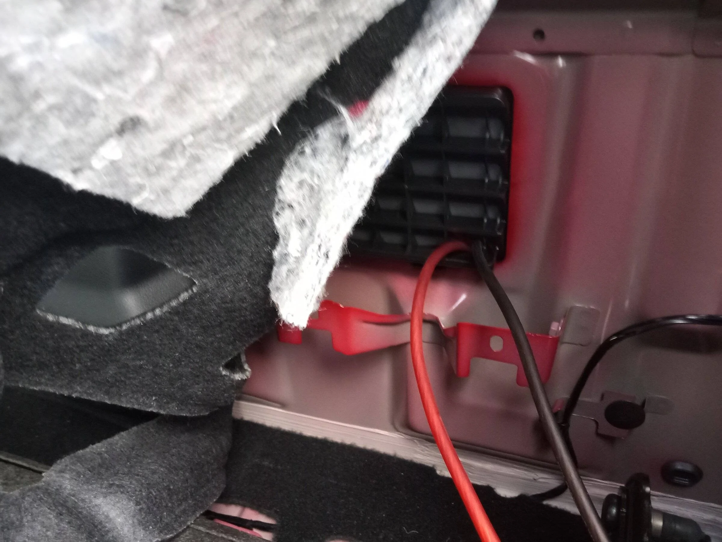

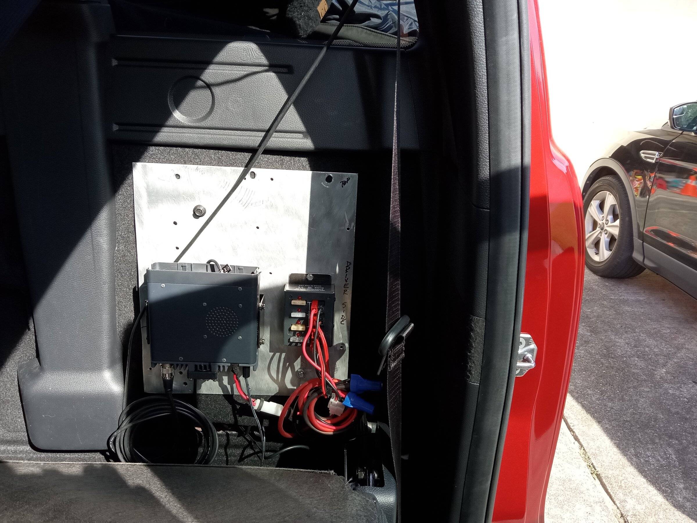

Direct to the battery. Ran two 8ga under the truck and brought them in through the cabin air exhaust vent. Coax comes that way as well.

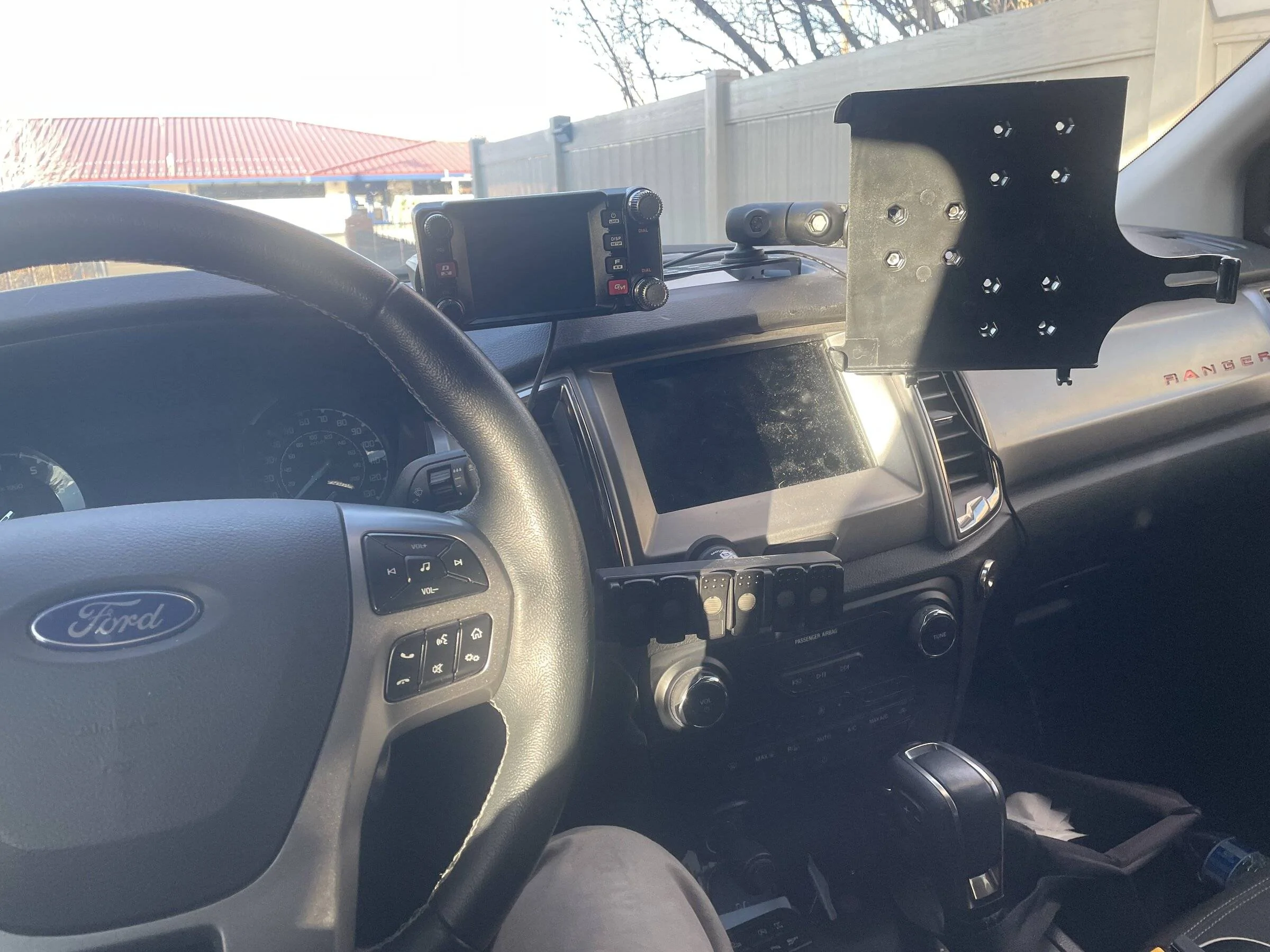

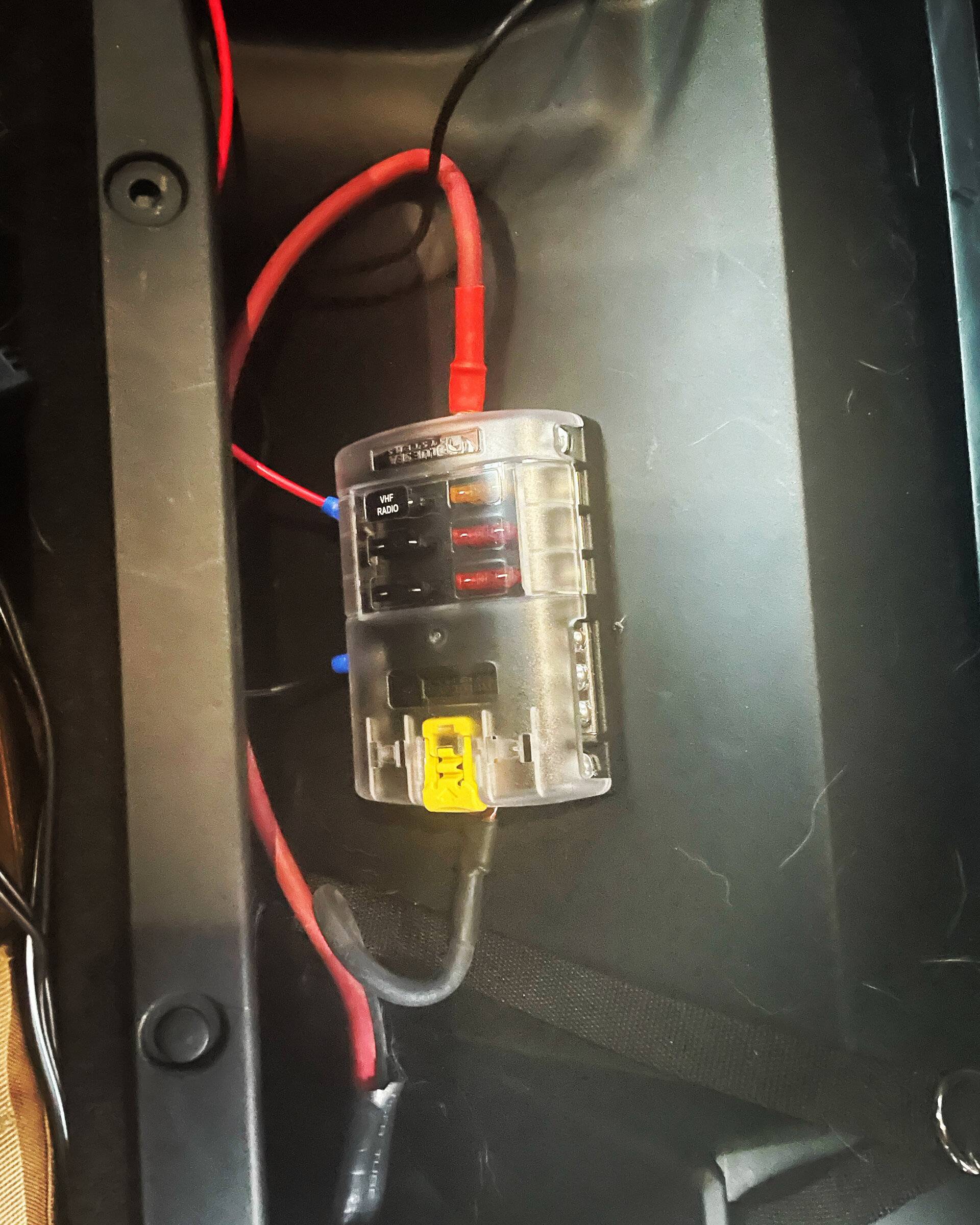

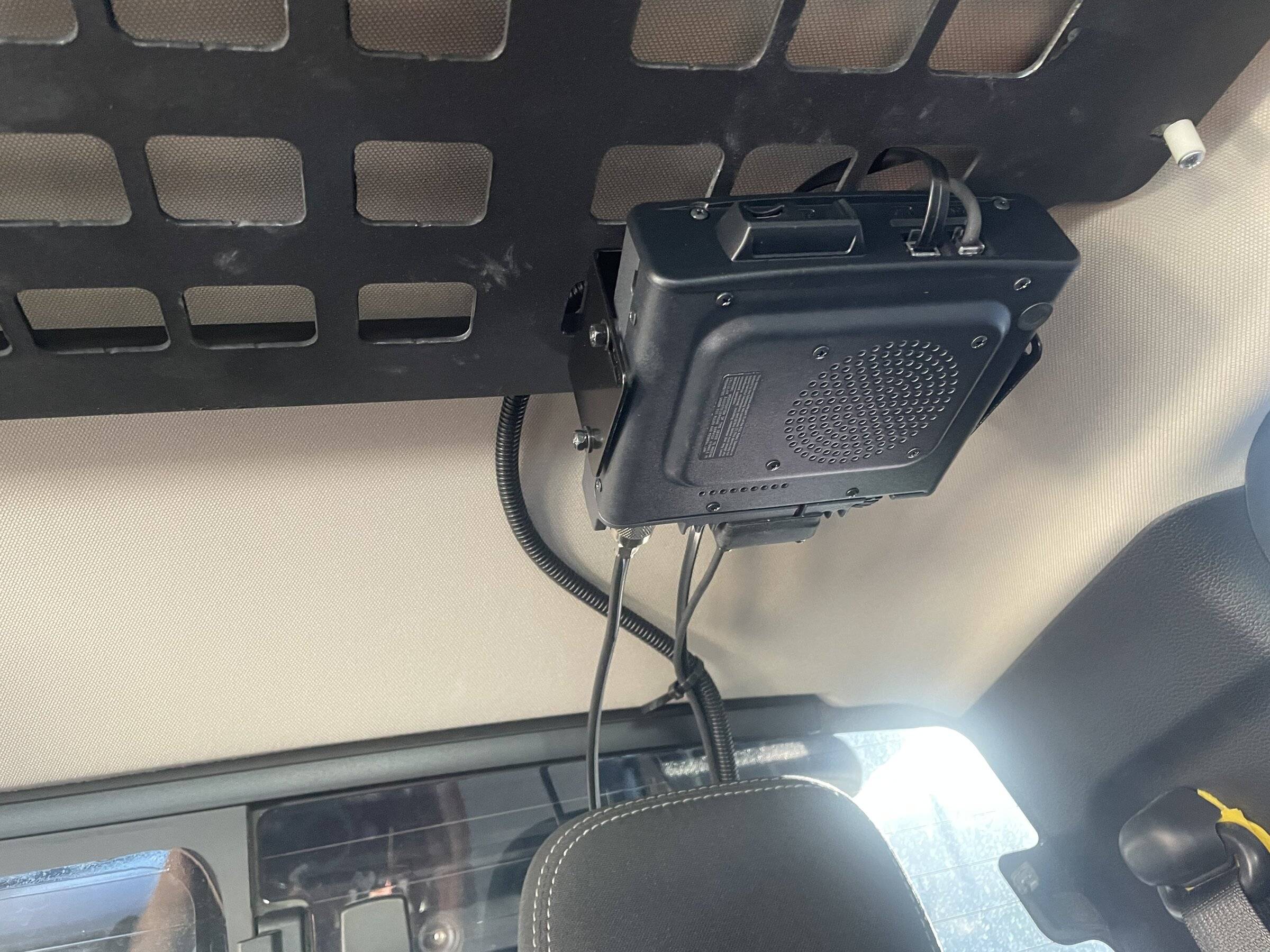

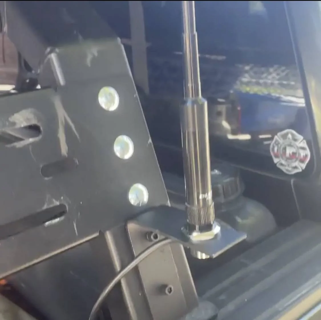

I went another way entirely and mine was a little more… labor intensive. I installed a six position marine grade fuse block under the backseat to future-proof my later options, and ran positive and negative 6 gauge wiring up to the battery. Then I installed a Yaesu FTM400XDR to a ceiling rack. I detached the faceplate and mounted it up front off a dash rack in the center console with a mount for my nav. All the cables are run under the door trim and through the firewall except for a 2 foot section from the steering wheel to the faceplate. I built a bracket for the antenna and ran it through the grommet in the rear of the cab to a rack on the bed.

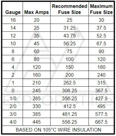

KA5CVH and Dredgerie - nice installs. But why the heavy gauge wire? 8 ga can carry 40 amps; 6 ga 55 amps. What are you guys running that would draw that much juice? I wired my truck with 10 ga which is more than enough for my VHF/UHF radio but with enough extra capacity should I decided to put an HF radio in the truck.

I put a six position fuse block in mine so I could add extra options later- right now it’s running the radio and my cell booster, later it’ll power my fridge and accessories in the bed like additional lighting and maybe my compressor.

I used 10 gauge also, plenty for the rig plus a safety margin.

I am adding a Midland GMRS radio and I want to plug my FT991 there as well in when I do POTA. I need 25 amps for the FT991 to be on the safe side. The 991 won't stay in the truck when I'm not doing POTA. My hot is fused at the battery and then there are fuses on the powerpole bus as well as the factory in line fuses on the radios.

My 8ga comes to a 1 in 3 out power pole buss box.
