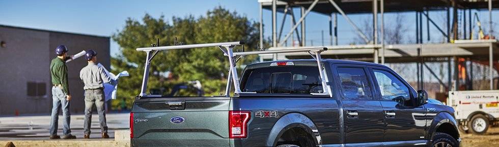

I've had mine posted since last year in several posts in the site. Here ya go!
I like that design alot. Is the wind noise of the leading bar awful on the freeway?
ldr01rl
Robert
Jan 17, 2020
162
290
TR Wisconsin
2019 Ford Ranger XLT 4x4
I'm glad you asked. I recently cut the front length 10"nto reduce wind noise. I have a length sheet metal folded that will be mounted up front to be more aerodynamic as well.
Reactions: J_D
J_D
Jul 23, 2019
27
Ranger
Even mine gets wind noise above 60mph. I will be mounting a triangular wedge to the front soon.

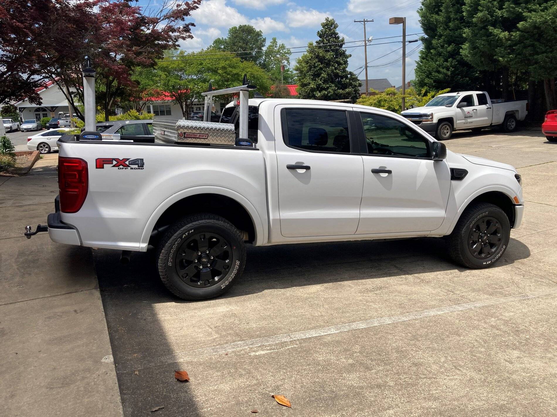

Werner rack from Lowes. kayak / ladder / lumber / whatever. I cut 6" out of the uprights to get it closer to top of cab height. Swapped antenna for stubby jr.
Saving money up to get a decked system, so I can ditch the big ass honkin toolbox. nice box, needing my bed space back though.

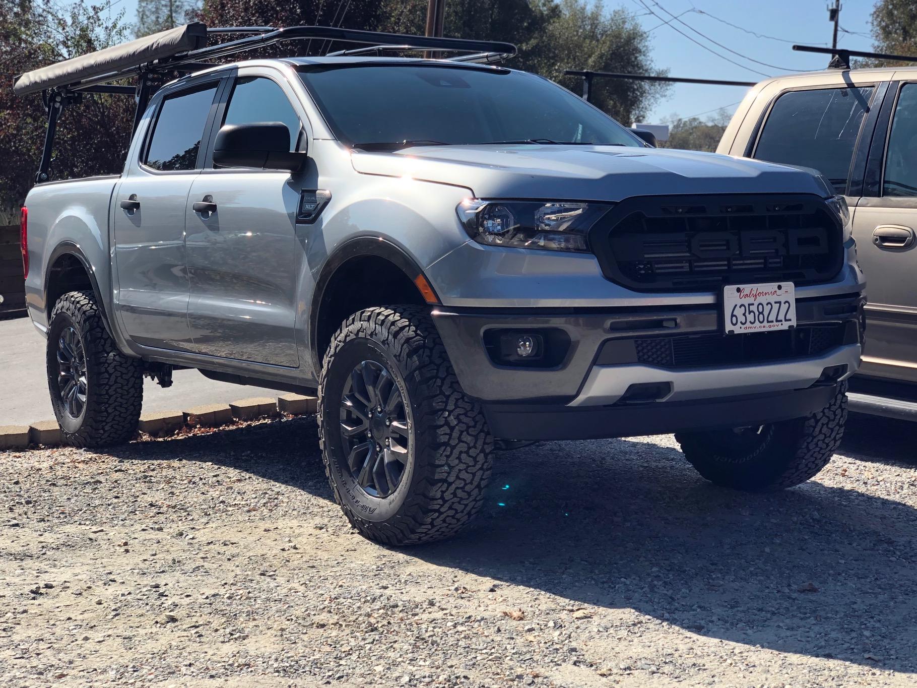

Here is mine, added my awning to the side. I use it to haul lumber and paddle boards. Works great but I do get some wind noise on the highway.
