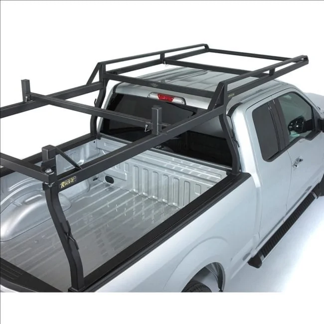

"EDIT" Added pictures of a Rack-It brand lumber rack. The rack is rated to carry 1700# but the truck bed may not be able to handle that kind of weight.
They make aluminum versions and make them to fit around shells too.
This basic rack cost me $730 here in California installed.

Added pictures to the first post of a Rack-It brand lumber rack I purchased.

Nice job! That should work well.

Easier, sure, but if they had designed stake pockets that would have required a redesign of the entire bed rail. Stake pockets "point load" the bed rail.
The racks shown above have angle iron that helps to distribute the load along a portion of the bed rail. It's a much better attachment method from a structural support perspective.

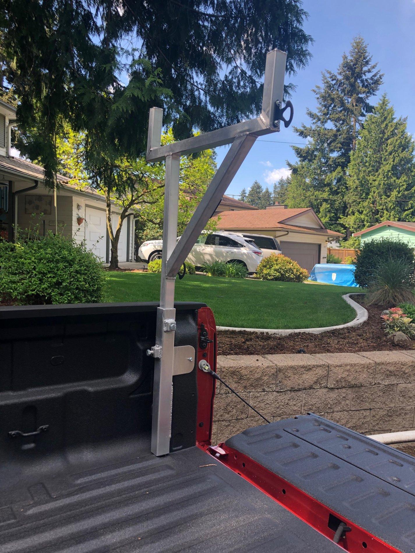

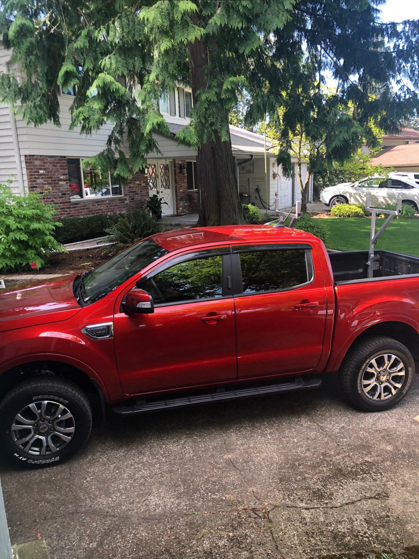

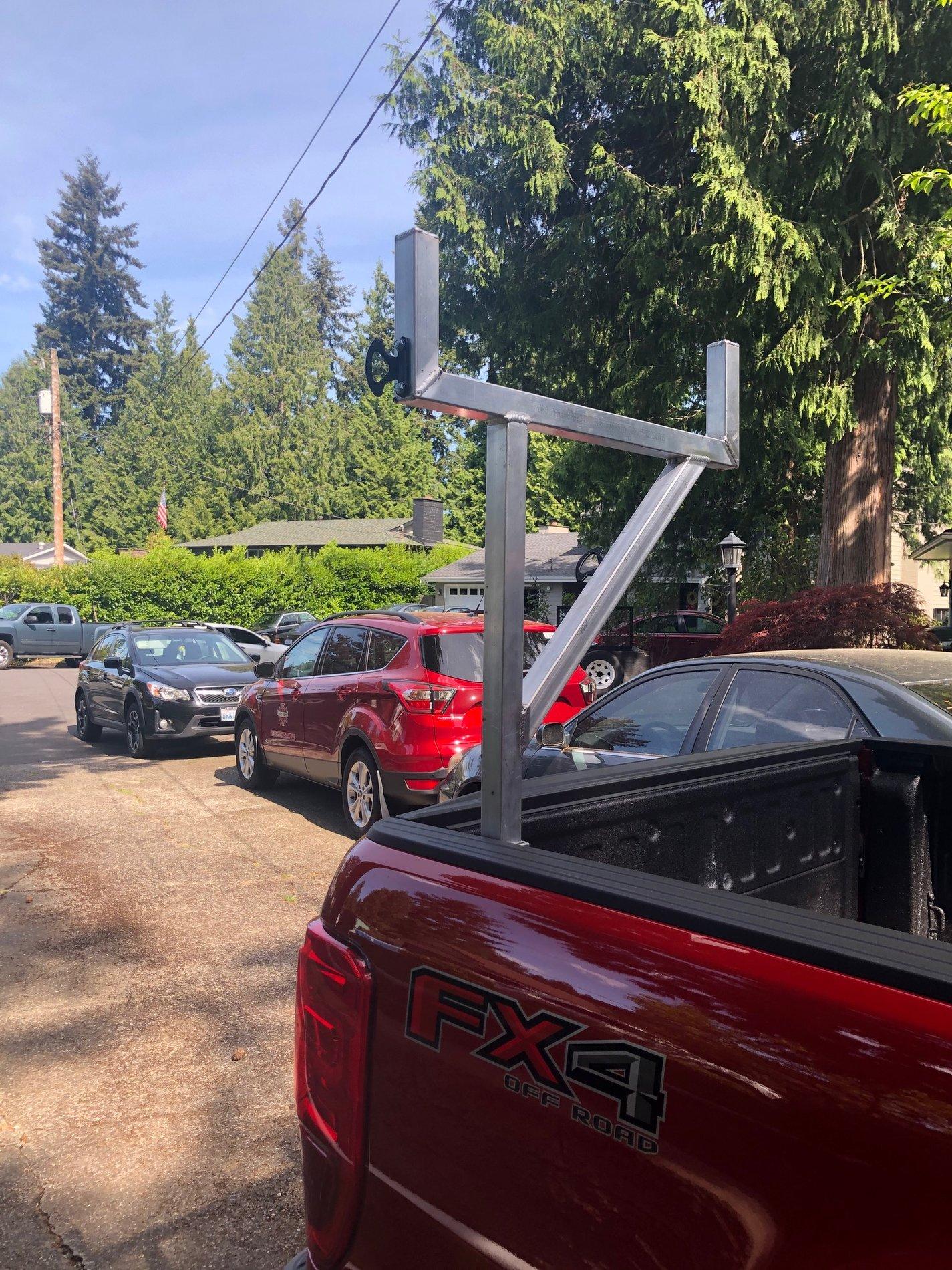

I wanted a rack for the occasional haul but didn't want something hard to remove so I copied my old trucks Weather Guard WEEKENDER rack and made it out of aluminum.
