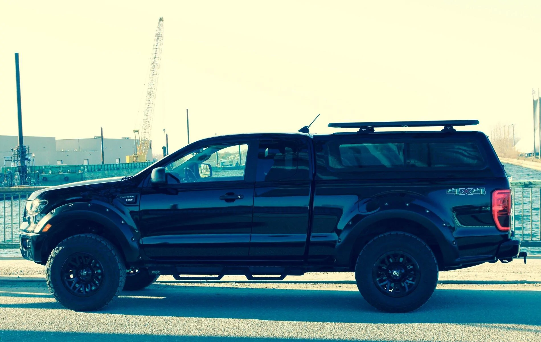

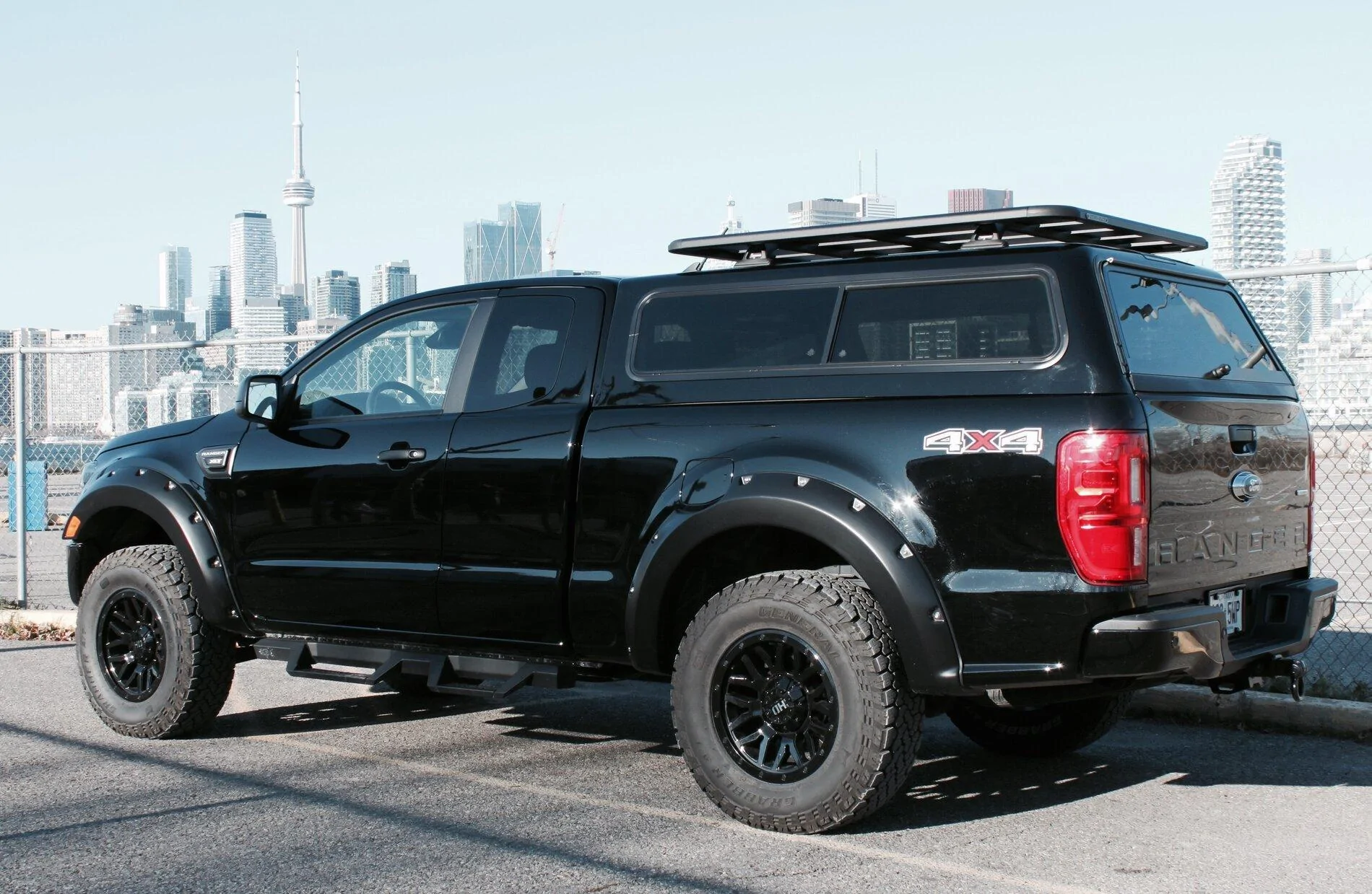

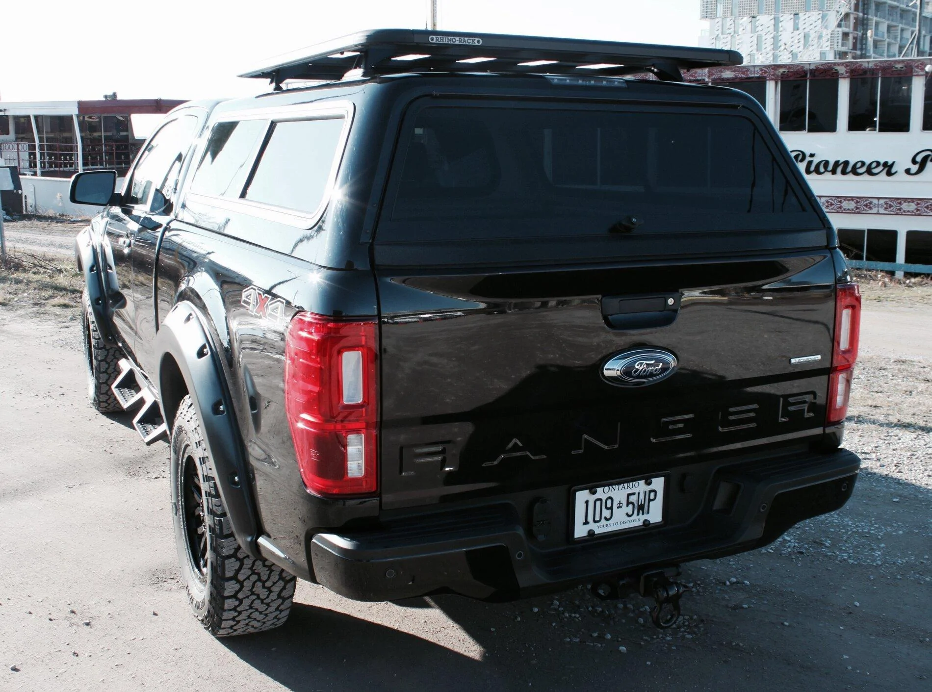

You’re likely to find that there is just enough crown in the topper to shatter your dreams. However, that doesn’t mean you have to have tracks, then legs, then crossbars, then your rack.
I wanted the lowest profile possible for my topper, so I hunted down a platform rack that would mount to legs that mounted directly to my topper.
You could mount Rhino Rack legs to your roof tracks and the Rhino Rack Pioneer Platform directly to the legs.
A few more details can be found in another thread...

That looks great! That's pretty much exactly what I was envisioning....probably because I've seen your truck on here before. Thanks for the reply.

Another member, RangerVA, has a similar Rhino Rack setup. He has roof tracks and then RR legs, then RR Vortex Aero crossbars, then his RR Pioneer Platform - the crossbars are not necessary because there are crossbars built into the Pioneer platform. However, he needs clearance for his awning, so the extra 1-1/4” helps.
I have the older model platform (42100B). It is 60” x 49” and has square built-in crossbars, which have the same profile as RR HD crossbars and attach directly to the legs.
The newer model (52100) is also 60” x 49” and has built-in crossbars with the Vortex Aero crossbar profile. You need a spacer kit to attach the legs to the built-in crossbars. Rhino Rack will be able to tell you which legs are needed for your tracks but you want the lowest profile option they can provide.
Hopefully, you can find the older version because it’s way cheaper, it comes assembled, and you don’t have to buy the spacer kit.
