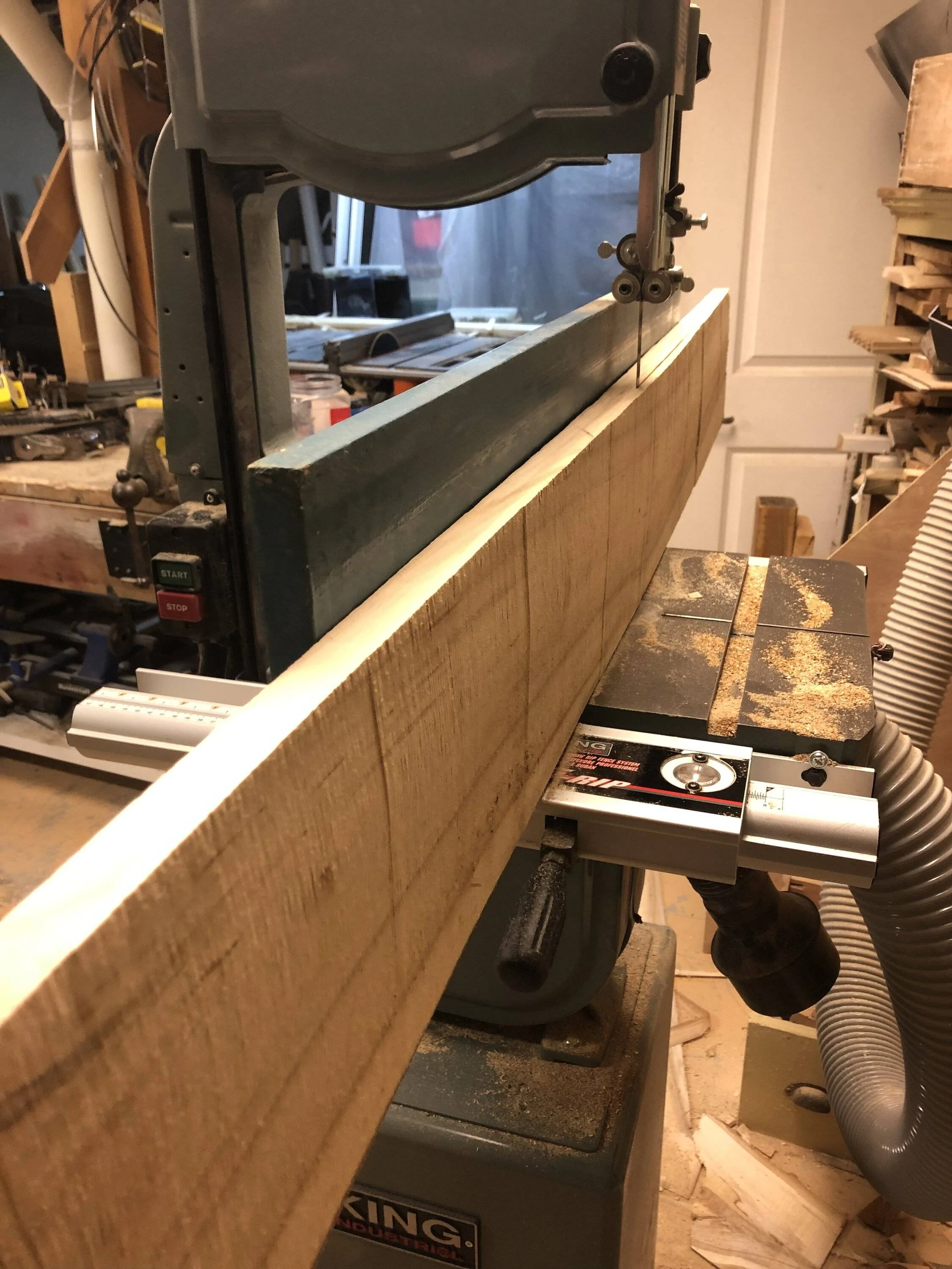

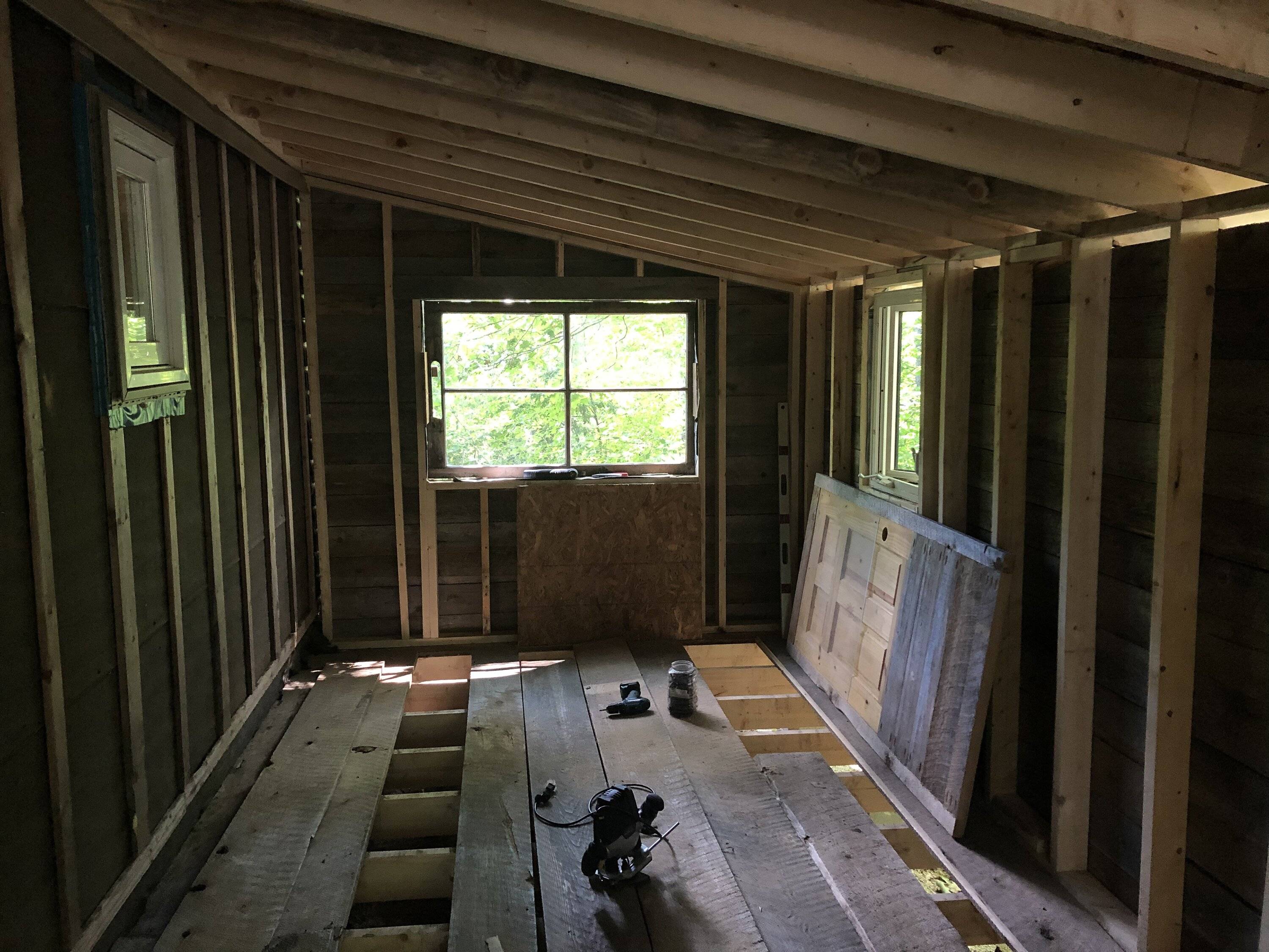

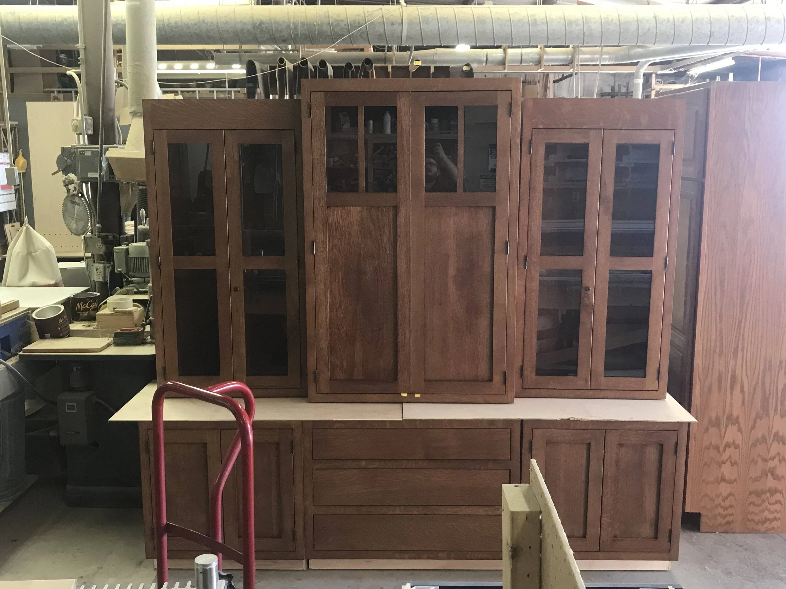

Back to the cabinet/countertop project.
Got a few minutes to start resawing the poplar boards that will comprise the counter top.

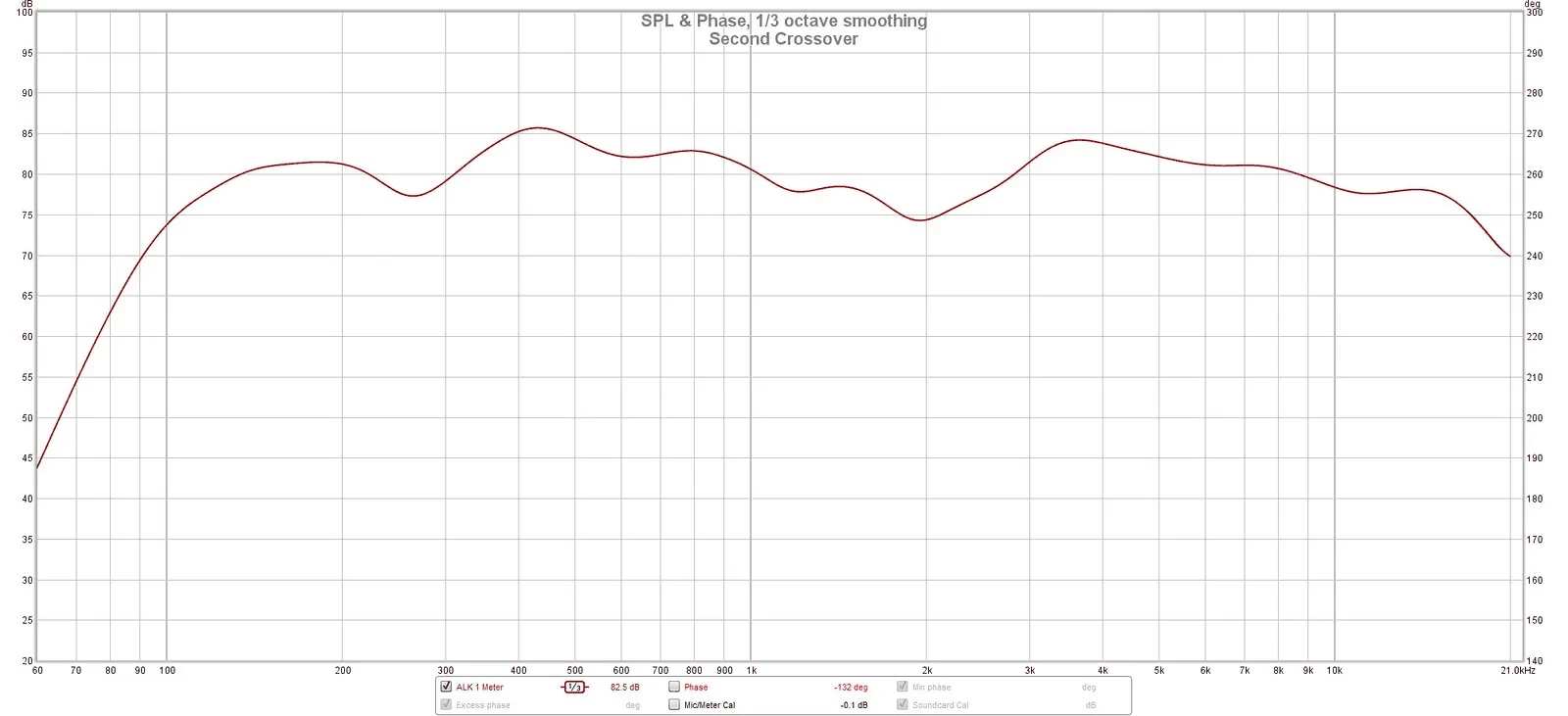

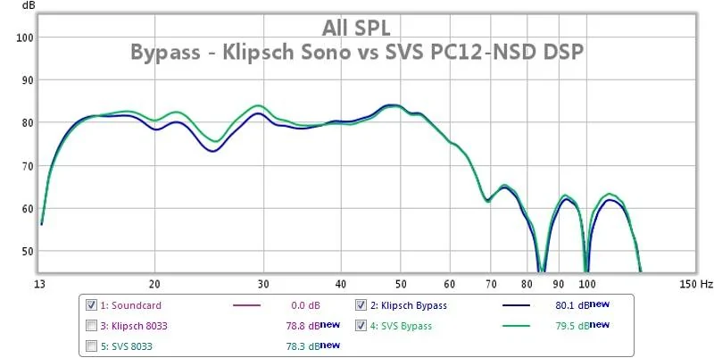

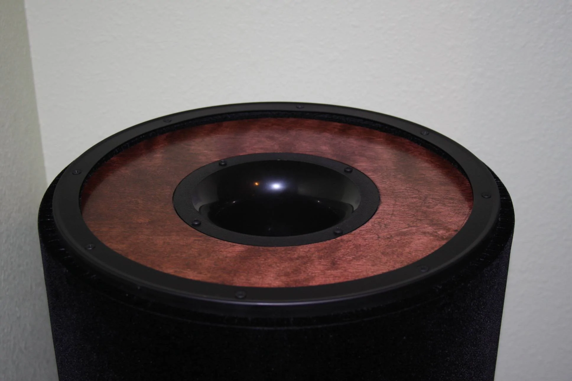

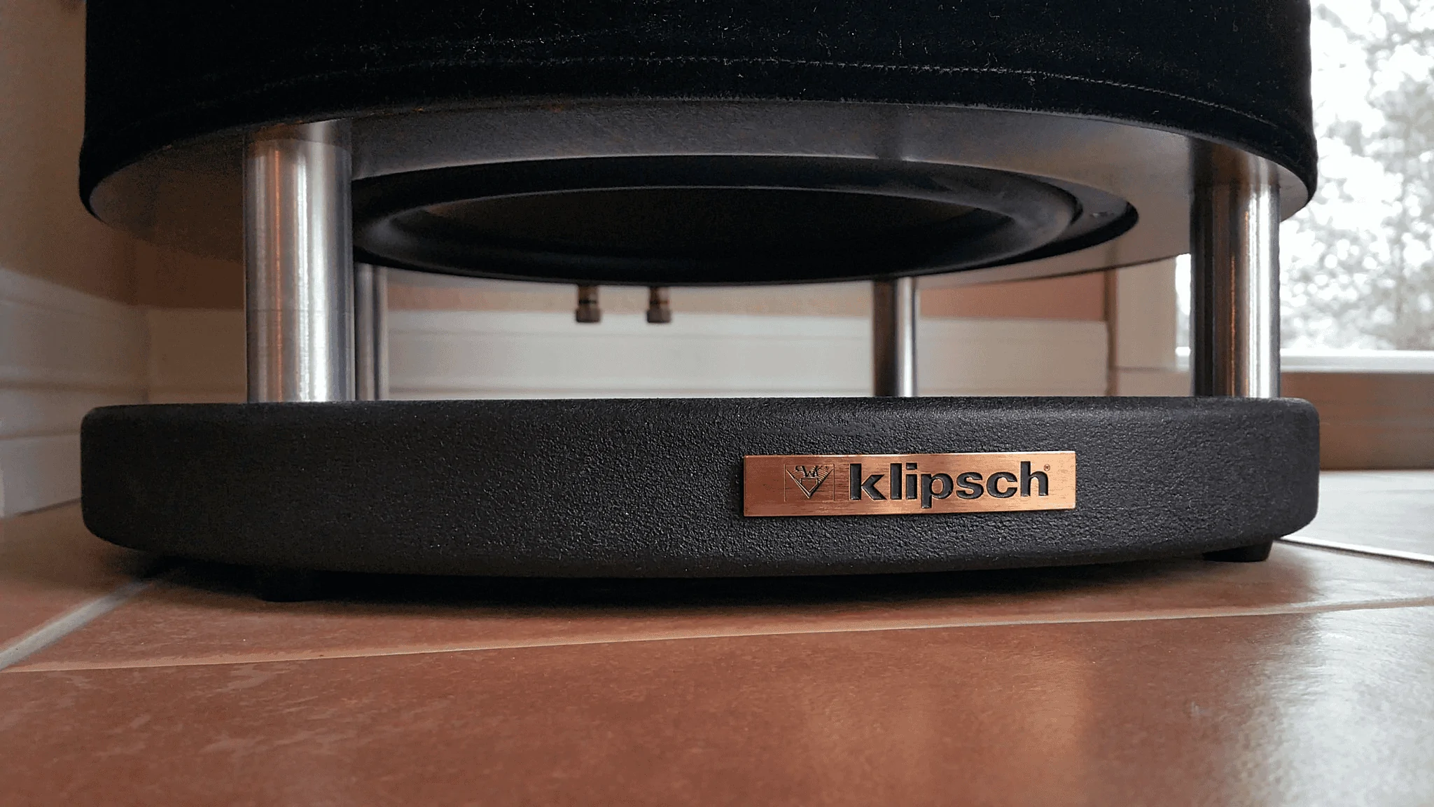

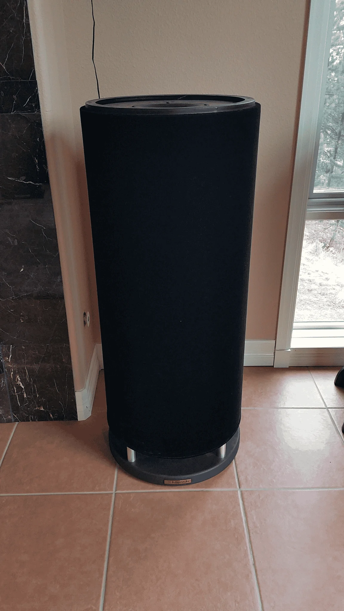

This one is a bit older, but built a Sonosub out of a Klipsch driver I had. This thing was actually amazing, especially for it's weight. It was able to run with the SVS cylinder subs I had and when I ran tests, the graphs were nearly the same.

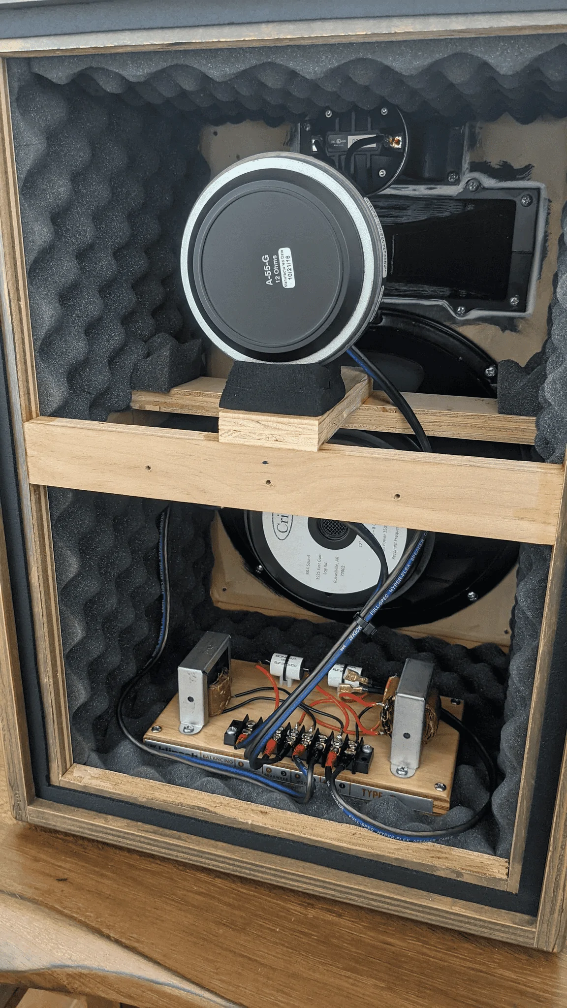

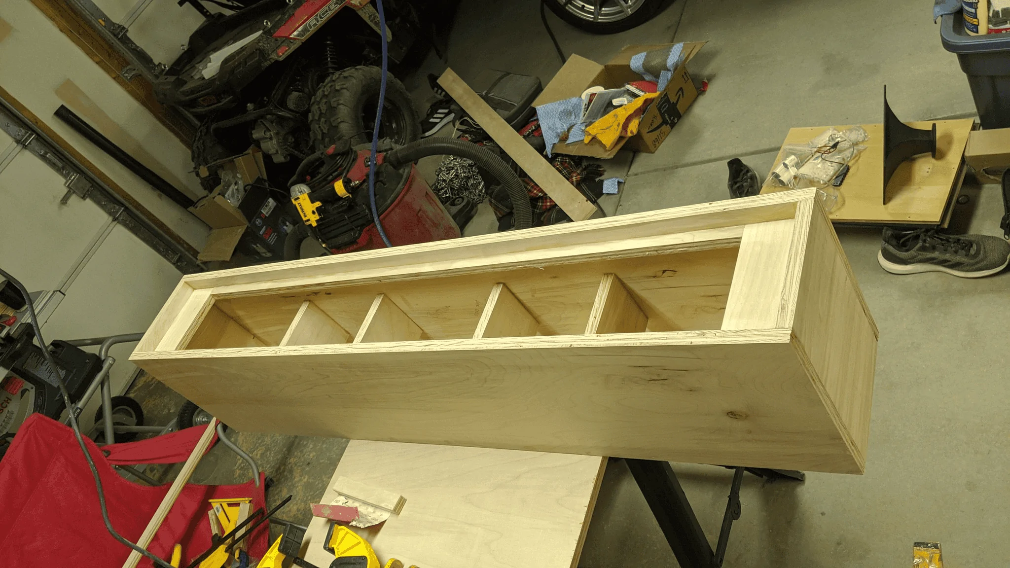

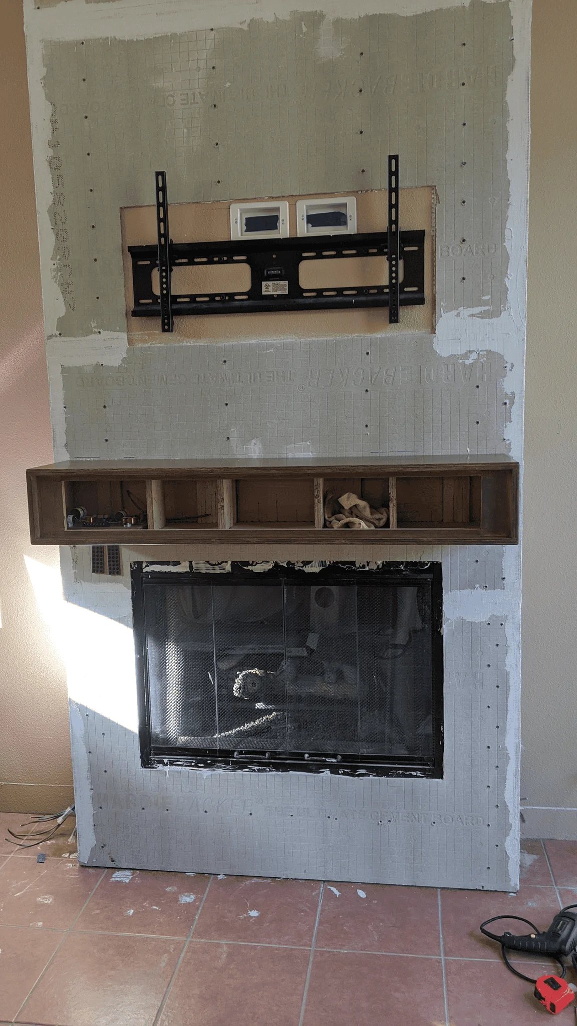

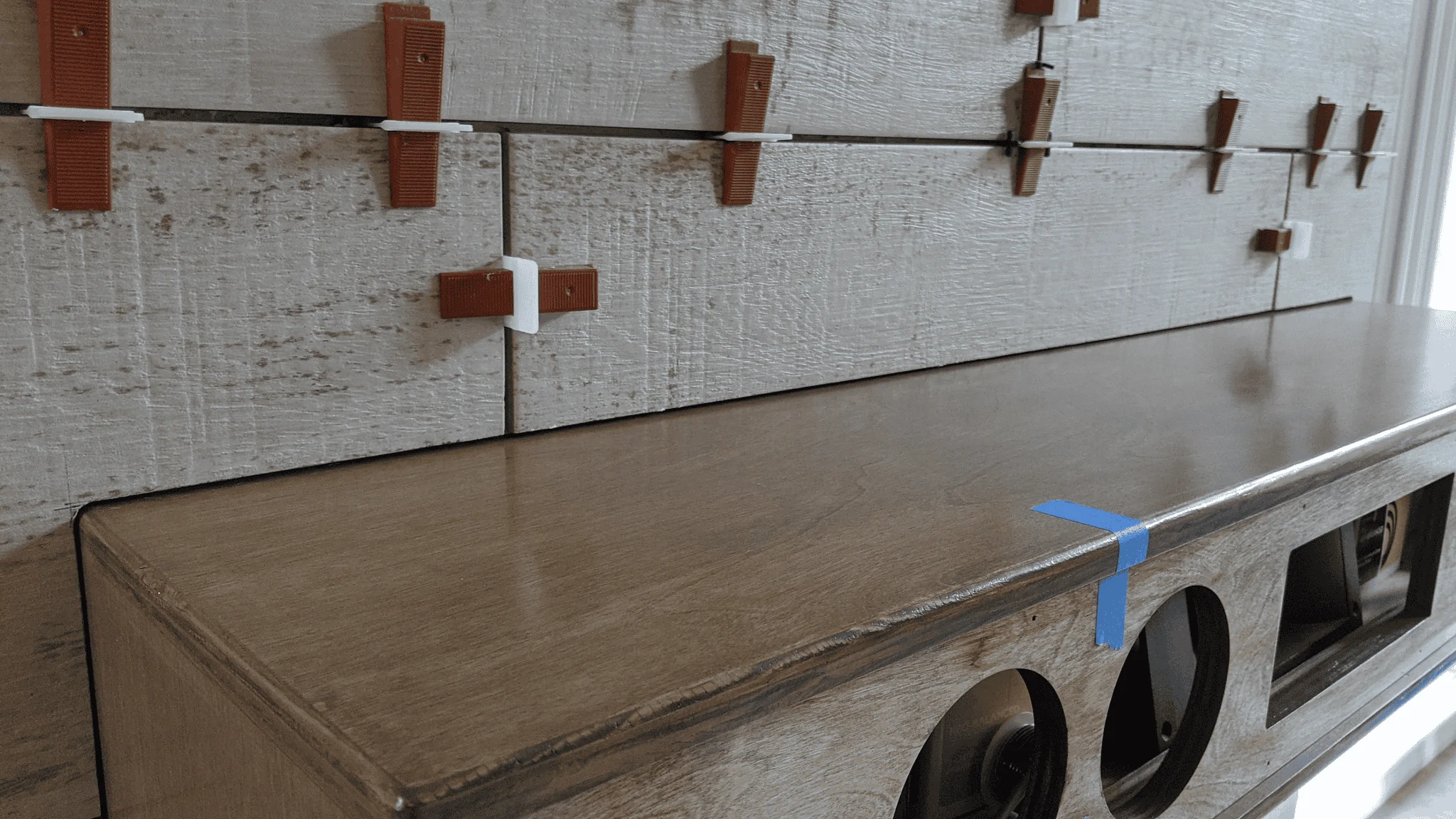

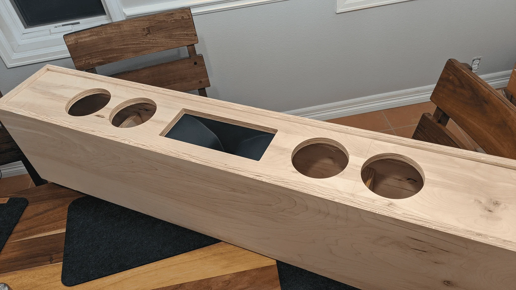

More recent, I wanted a center channel in my last house (I just moved), but did not want another speaker sitting out as my main speakers (and sub) are already large. I also hated the very high, useless mantle, so I pulled everything down, built a new mantle and made it the speaker, and then tiled up fireplace.

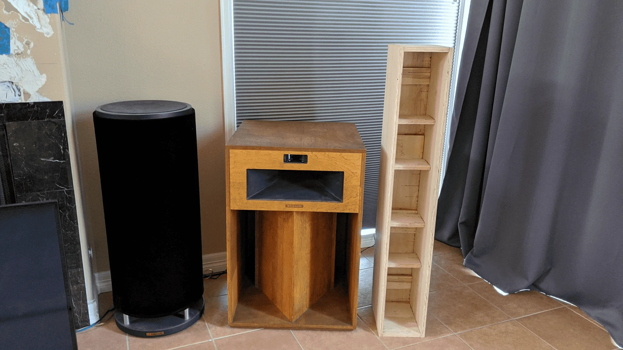

Size reference compared to my fairly large speakers, which those will be refinished soon.

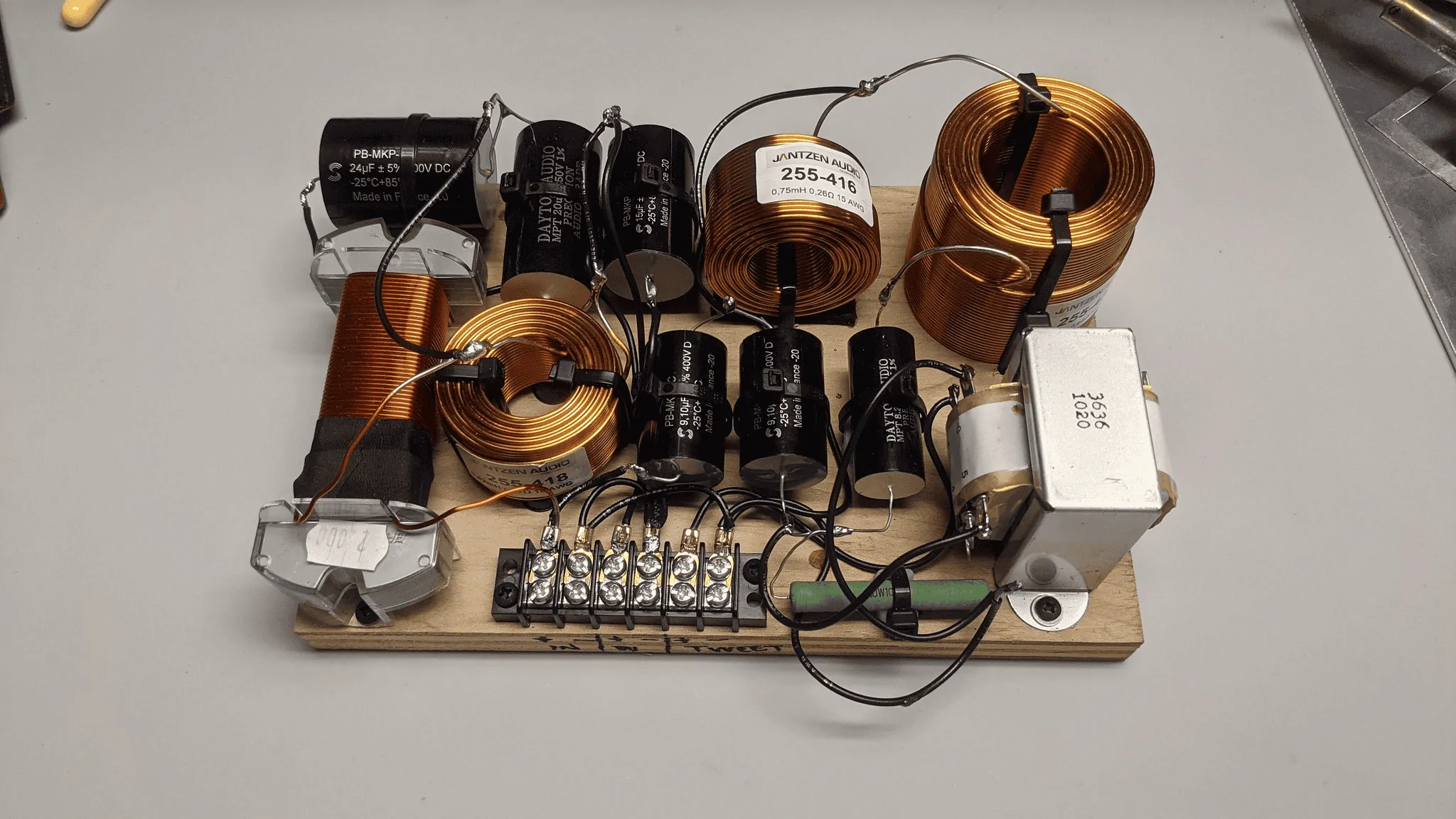

I had help in the steep crossover design, but I this was one heavy crossover once I put it all together.

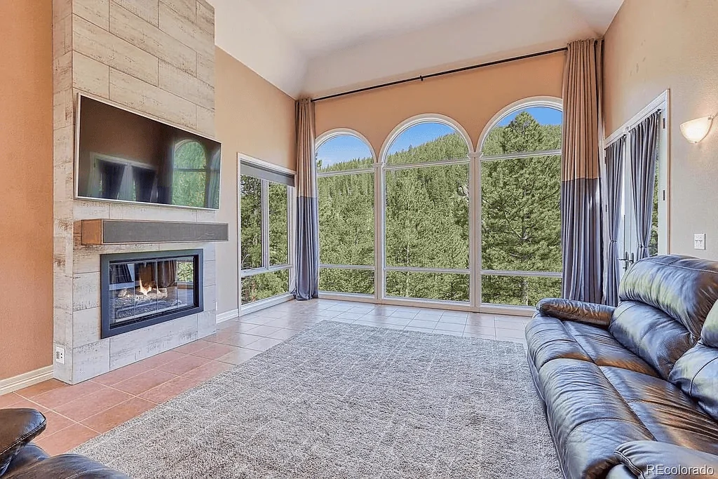

The best finished picture I have, which was from our house sale. But it all turned out great and sounded great.

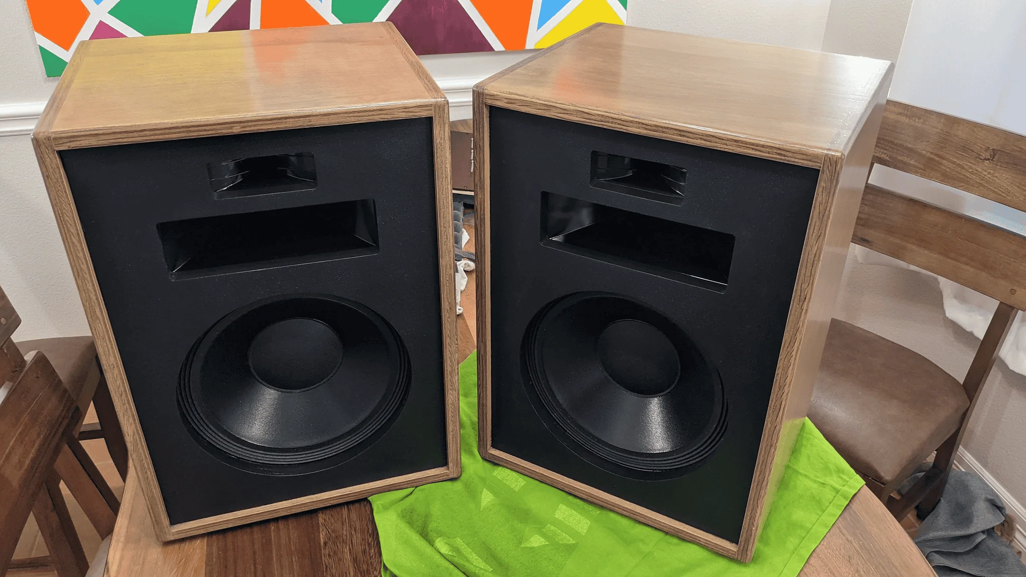

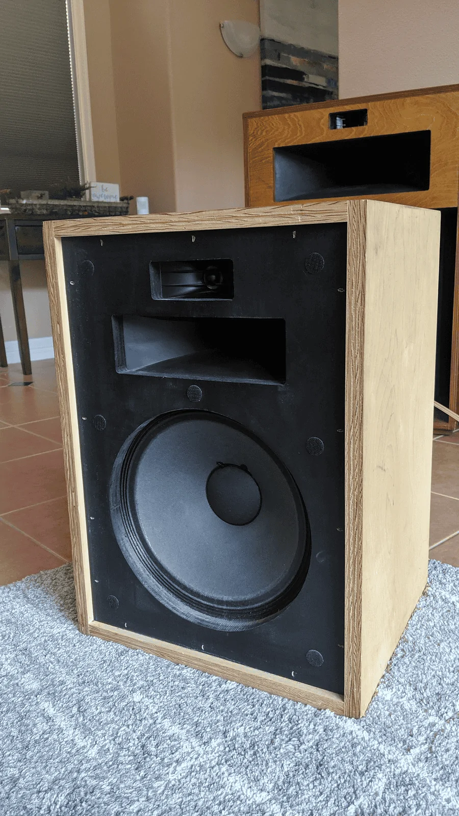

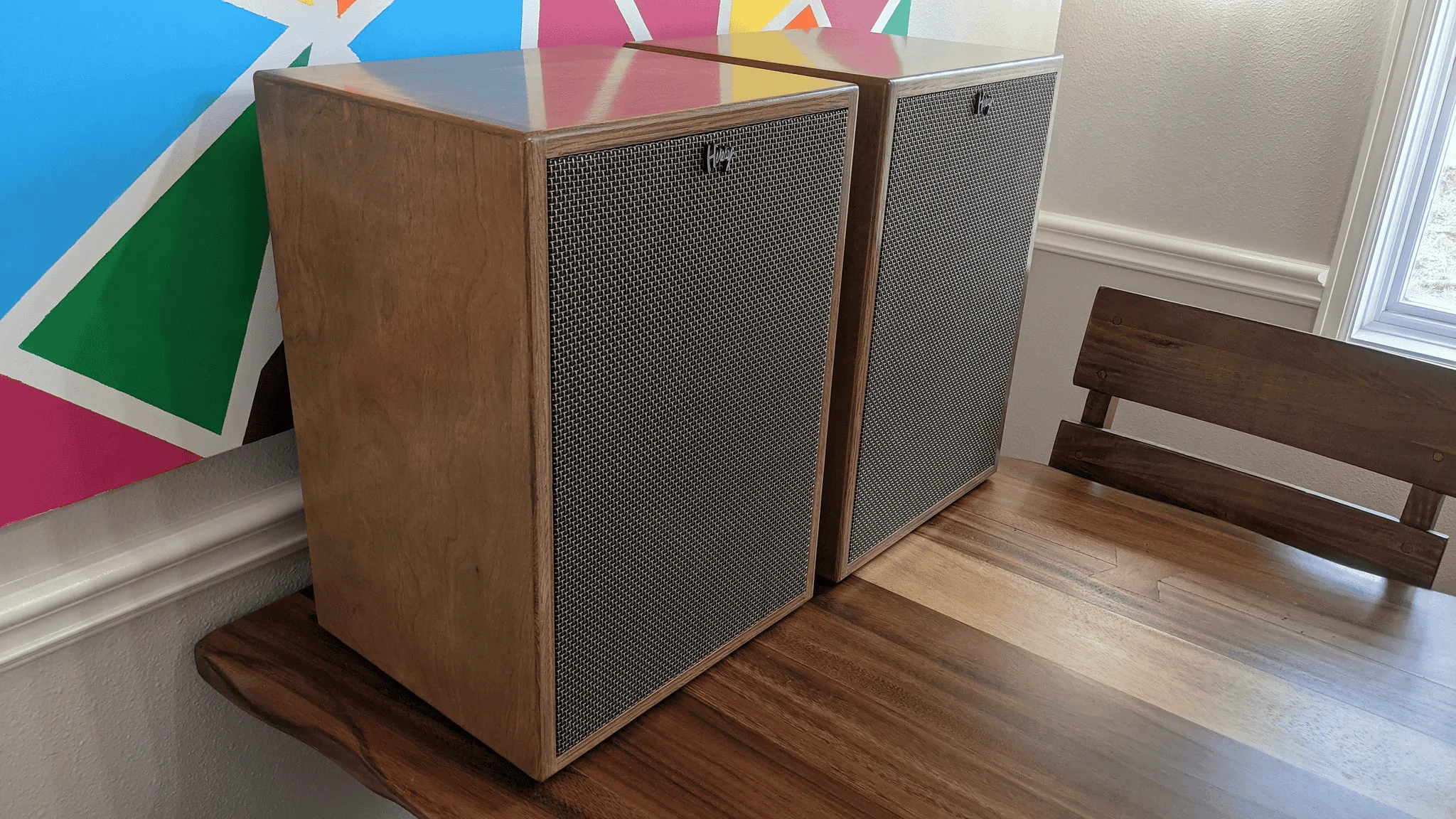

At the same time I did the mantle, I refinished a set of 1982 Klipsch Heresy's.

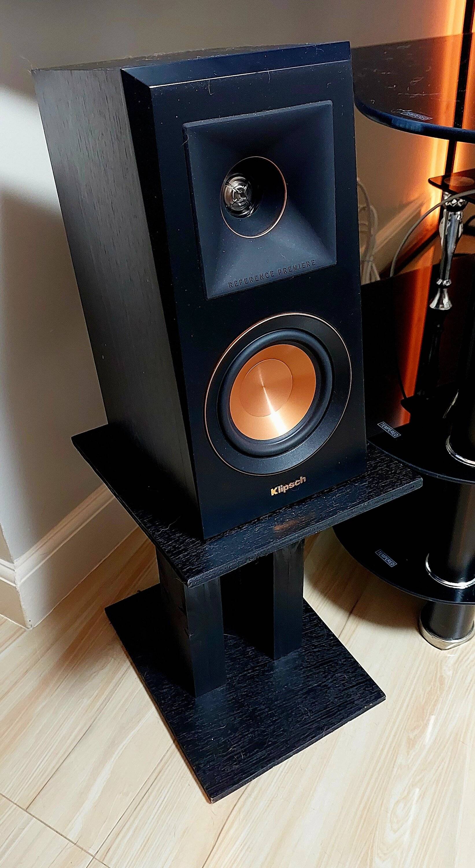

Had a set of those for my rear surround and Fortes for the fronts. I have scaled down now to Klipsch RP400M's just 2.

I wish I didn't love the sound of the La Scala so much, because I hate their size and the fact that I can't move them without help. I sold the Heresy's and my sub (replaced the sub with an SVS PC-4000) to a buddy awhile back and I contemplated keeping those and selling the La Scalas, but they sound big at any volume.
Eventually, I'll downsize. I hope it won't be for awhile. My dad bought a new set in 1982 and still has them.

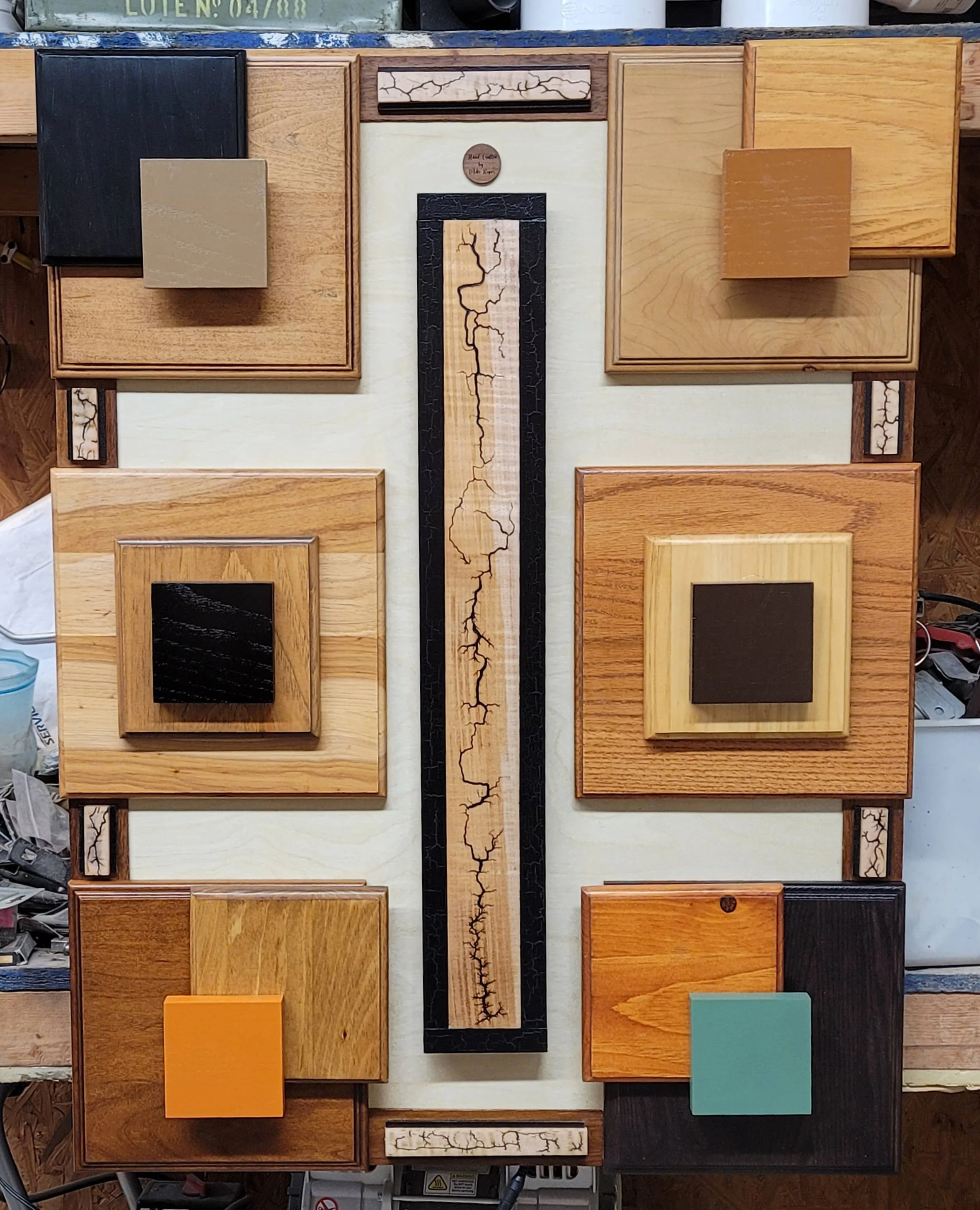

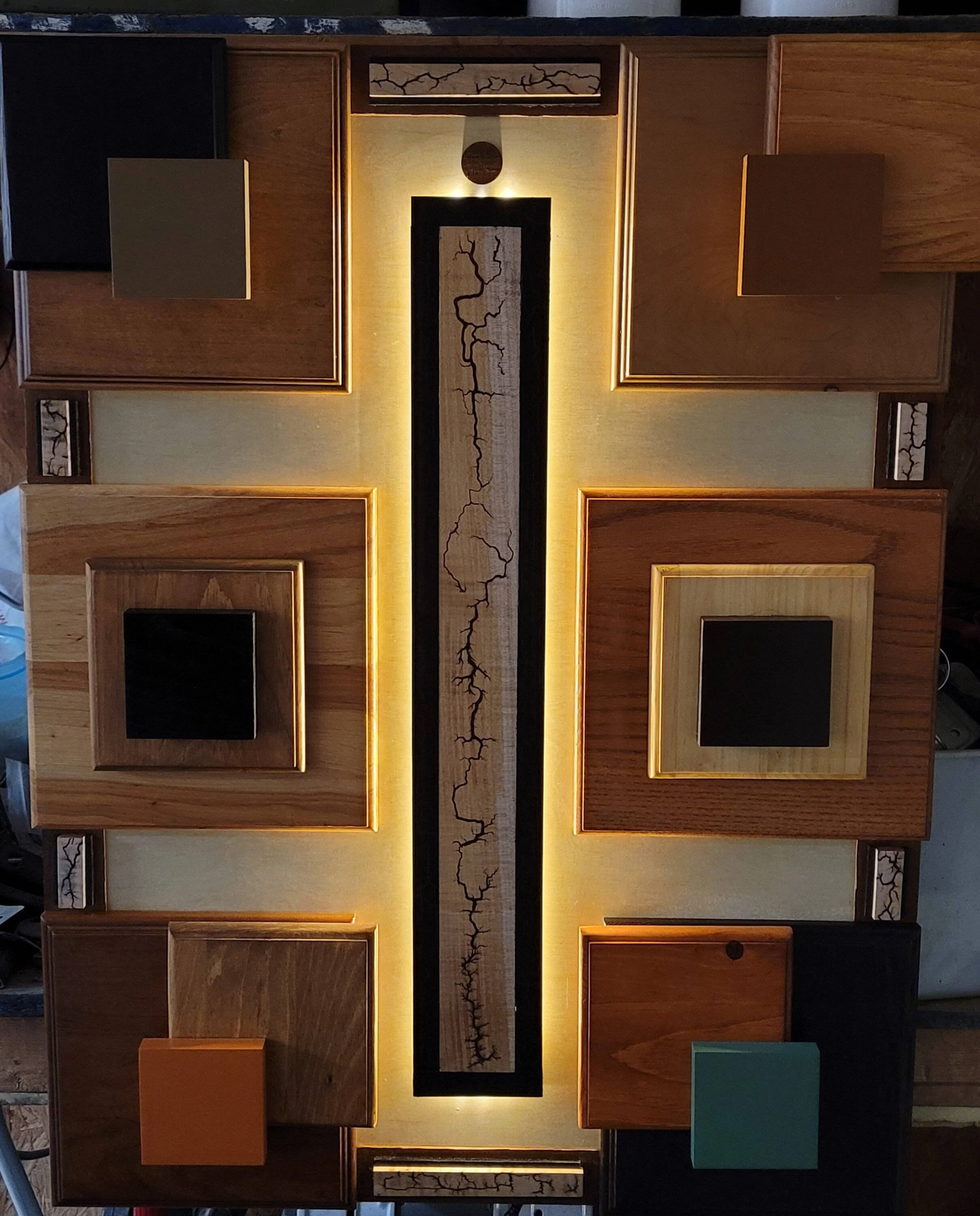

Made this abstract art wall hanging for my step son for Christmas, I recycled cabinet shop samples, plus made a few squares and painted them, used the Lichtenberg machine for extra design and put in led backlighting on a dimmer. Made a maple cutting board also but haven't snapped a picture of it yet.

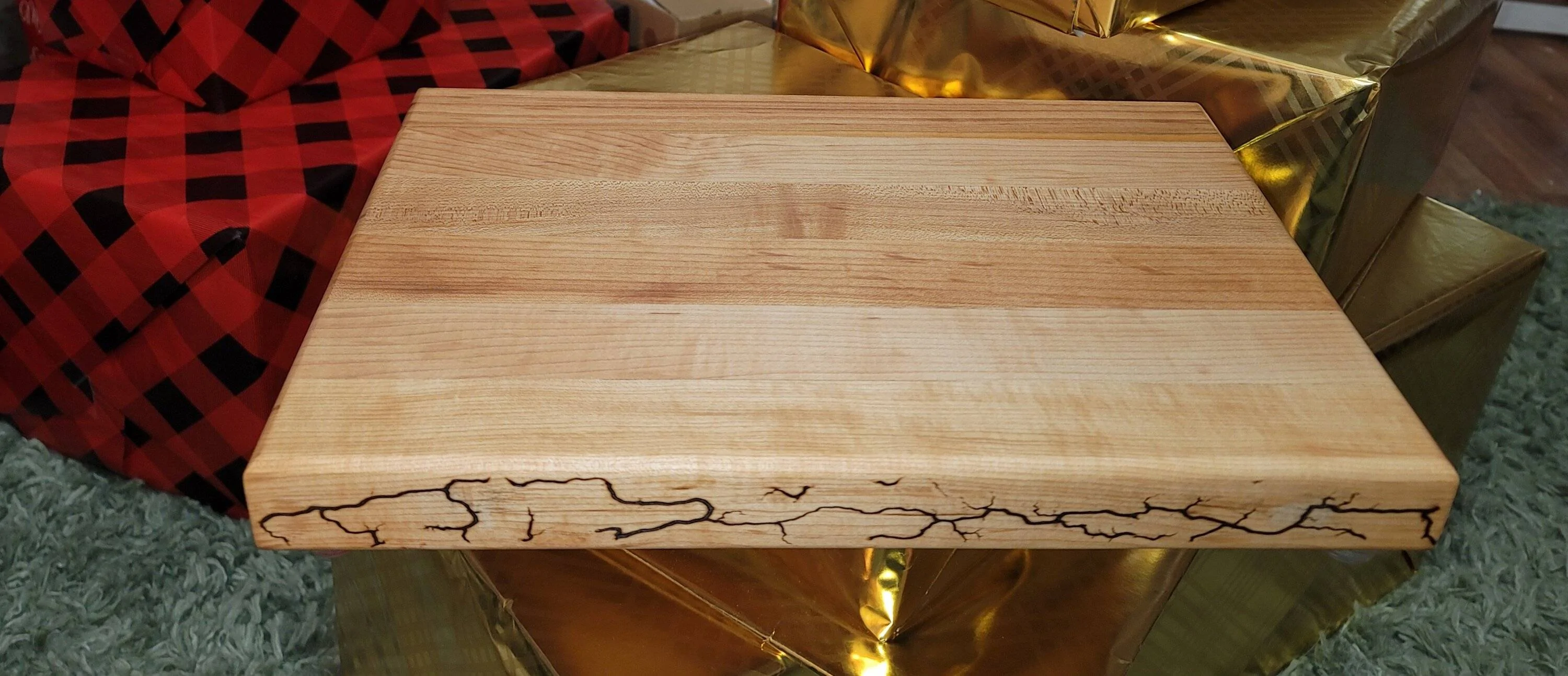

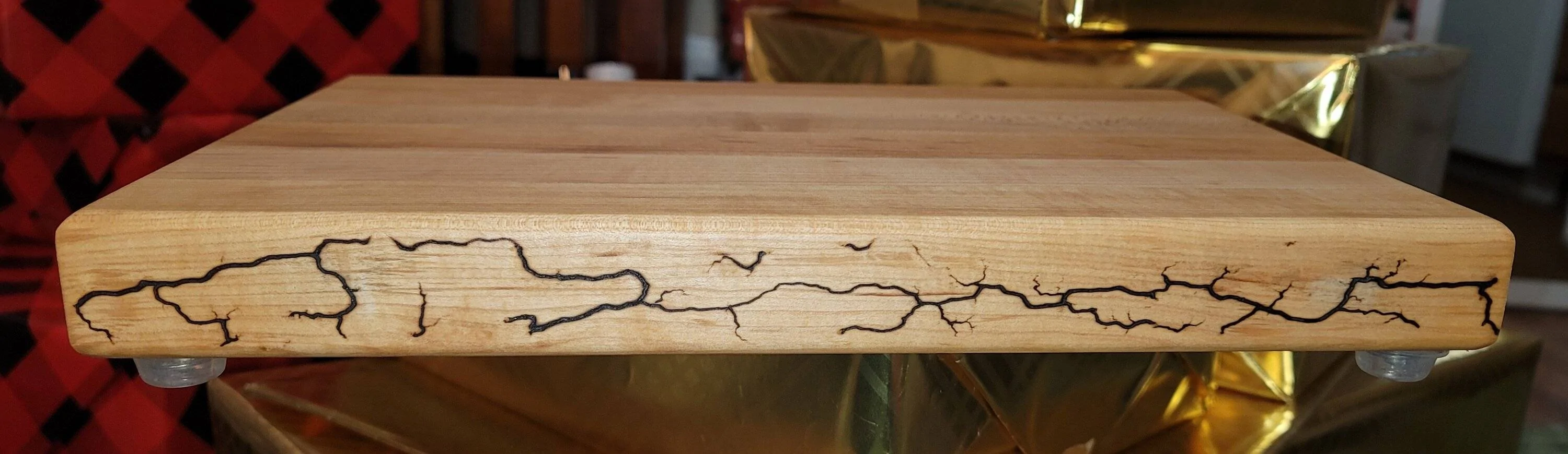

Here's the hard maple cutting board, soaked it for 18 hours in mineral oil and then let it air dry 2 days before I wrapped. Step son was snooping packages trying find out what I made so I wrapped another box with a big brick inside it lol.

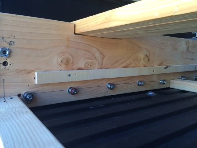

Would it be a permanent fixture in the bed? I made a knock down one for my Ranger, I cut to fit the bed width in front of and behind the wheel wells and then the top braces I labeled matching parts and dropped bolts in and it locked it from shifting. You might be able to find pics on here or I won need to look on my external drive here at home. I didn't make it for looks, just strength and functional. I can put 8-10 foot 2x4s on the bed floor and lay full 4x8 sheets of plywood or whatever on top.it worked out well. I pulled the pins out and tapped the bolts out and it's in the minibarn for next time. If I was going to use my truck for construction work or any other work I would use full length slides. Our beds are too small to waste space.

You read my mind on T nuts those things are great!
If it's exposed I would definitely treat it somehow, even a clear sealer like thompsons is better than nothing, but if I could I would buy a gallon of bed liner and roll it. I made a full width under seat storage box for my F150, had a sub box on one end and compartments on the rest, I bartered with a local shop who sprayed my bed, he sprayed the entire inside of that box for no cost and I in turn made a custom sub box for his Sporttrac. I already had the box from my prior Sporttrac so it was an easy swap. I put matching carpet on the outside. Wanted it sealed in case a liquid spilled.
