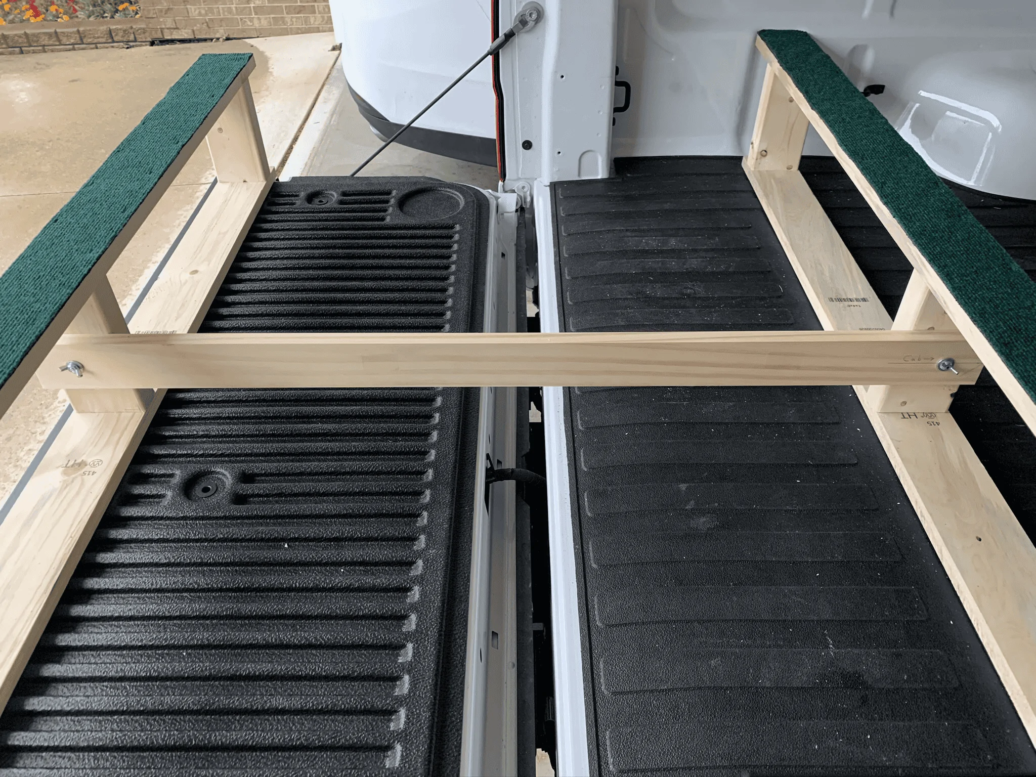

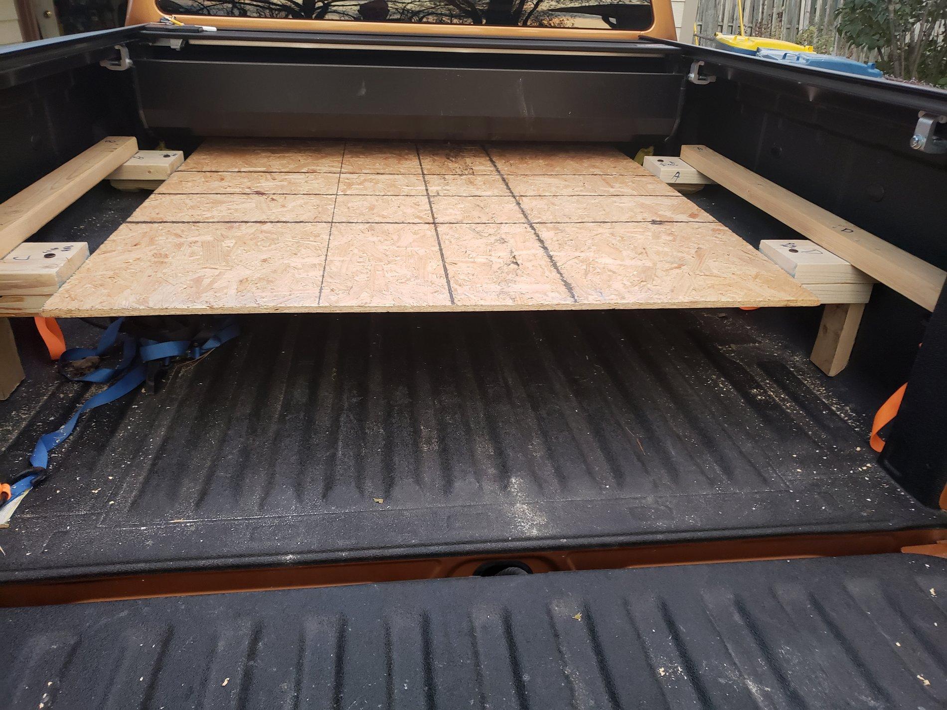

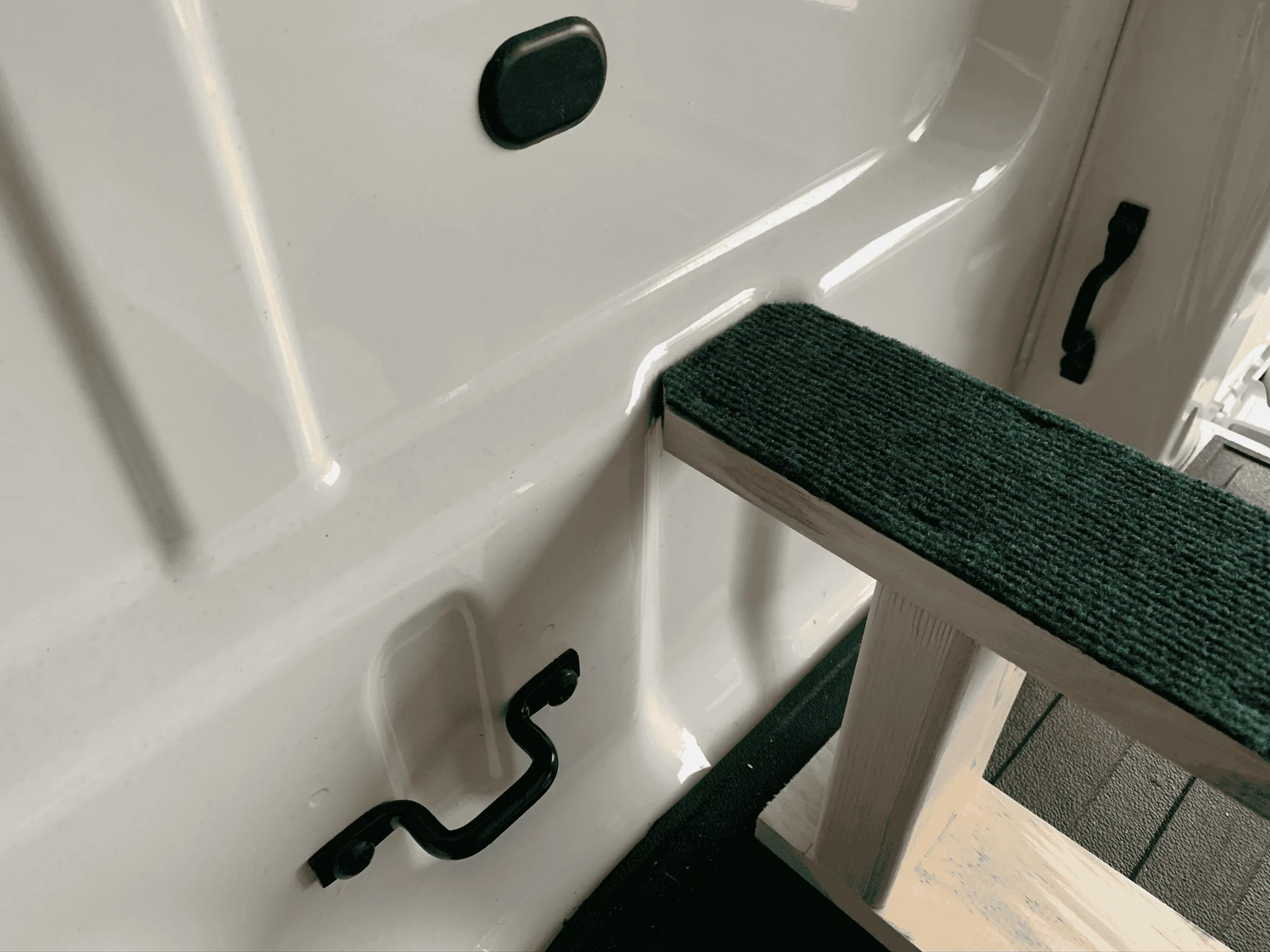

Had some. Scrap lumber laying about so I made this removable lumber rack. 4 bolts used as pins to secure it, will only need to unscrew 2 deck screws on one side to take it all out. 4x8 sheets on top that will stick out a foot beyond the tailgate, lumber on the bed floor or on top of sheets of plywood. Gonna make a minibarn soon so I needed to be able to haul 4x8 sheets of siding and lumber.

Thanks. It's a sprayed in liner, I didn't like the wobblyness of the rear 2x6 indent by the tailgate, the bed liner texture wasn't very even and due to my bed cover box that it retracts into I can't get at the 2x6 slot in the front so this was my next option.

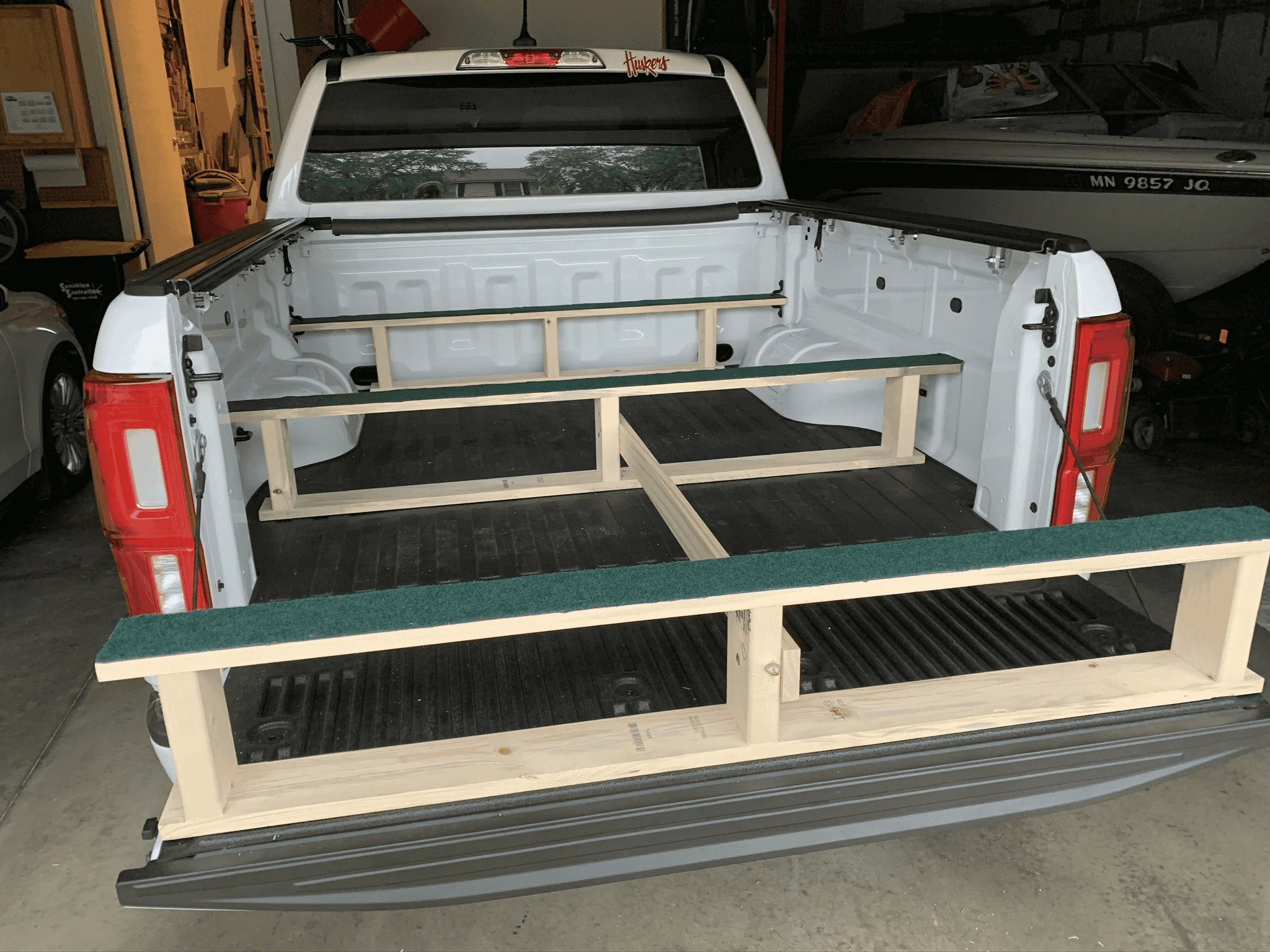

It also leaves the full length of the bed under the 4x8 sheets for other items such as tool cases, Gorilla platforms, step ladders, shovels, spirit levels, rifle cases, traction boards, etc. - stuff that you’d have to move or remove if you simply placed 2x6s across the floor of the bed. Those things would also be mostly out of sight rather than sitting on top of the 4x8s, in plain sight and easy to access. Even if a centre brace was added, you’d still have all that utility.

Very nice, Mike. I built some racks similar to yours. As Duke mentioned, the racks you and I built allow things to be hauled underneath the 4x8 sheets. I've already hauled dimesional lumber underneath sheets of drywall.
