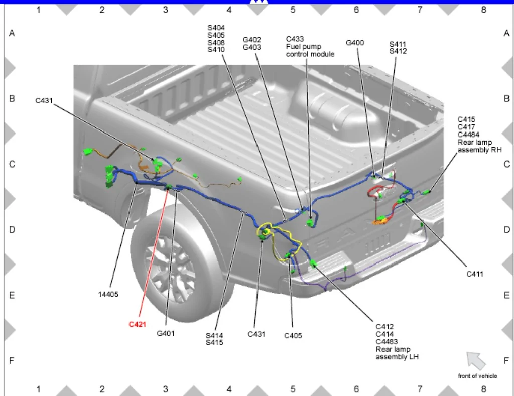

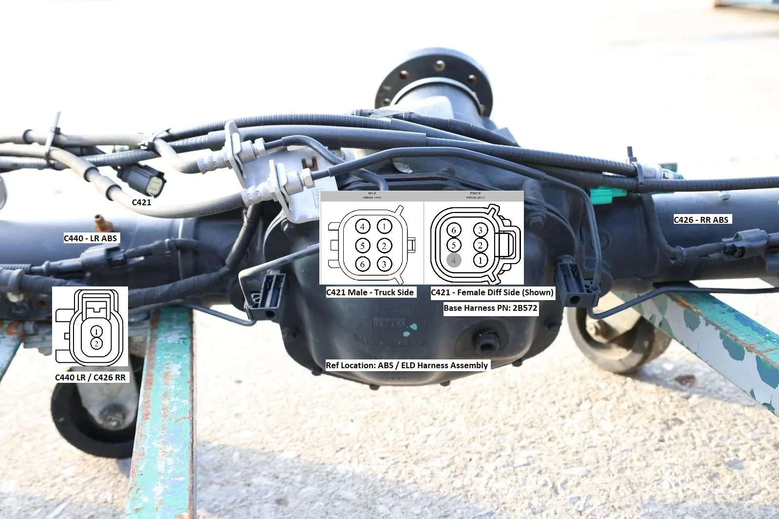

So the 6-Cavity C421 connector ?
Ed Kennedy
Ed
Aug 16, 2025
MS
2019 Ford Ranger STX
Finance
I assume so. It's the two wire plug in the top side of the differential, where the speed sensor wires split.
airline tech
Aug 24, 2022
4,721
9,035
Midwest - KS
Aircraft Tech
C421 is farther up the harness from the Wheel Speed Sensor Connector.
C421 has both LR & RR sensor wires + (if installed the Elec Lock Diff wires)
C421 feeds upstream to the C408 Connector on the Left Frame Rail

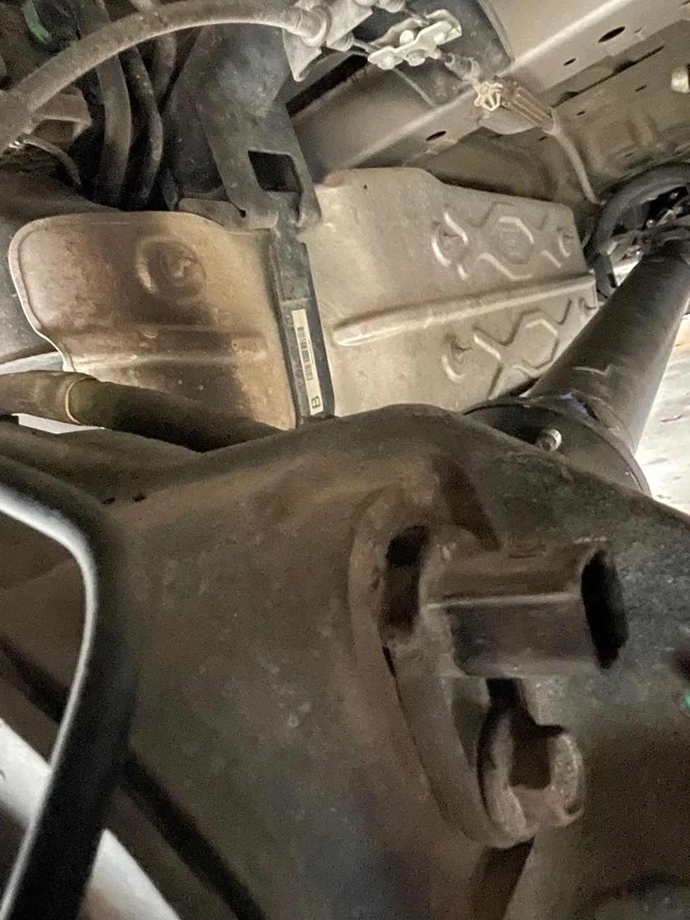

Thus is what it looks like (the plug I had loose) on side of differential. I tightened it and cranked it and no codes. Got back in this morning, cranked it, and codes lol....
I'll keep going through it.
That is the connector for the locking differential. It shouldn't have anything to do with a wheel speed sensor. I think that you are disturbing other wiring to the speed sensor when you are unplugging this connector on the differential.

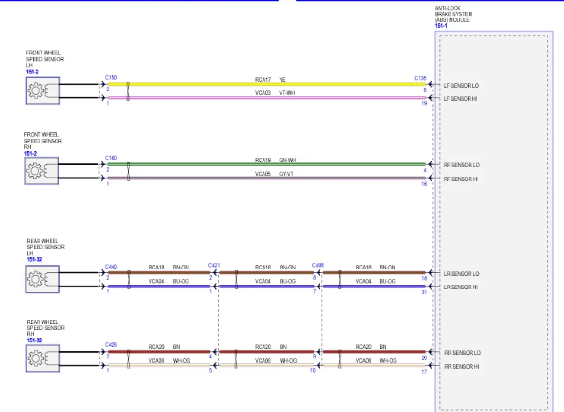

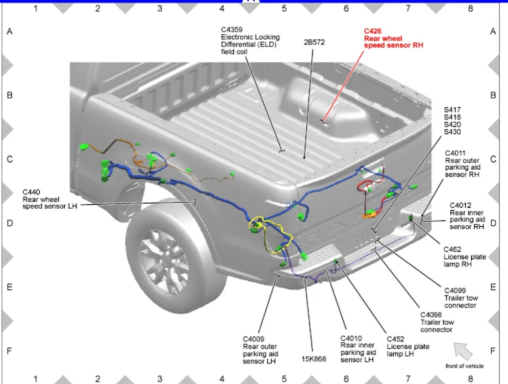

Sensors are a great safety feature but man, it's become overkill on automobiles and a constant problem.
Here is a wiring diagram and connector locations for the right rear wheel speed sensor.

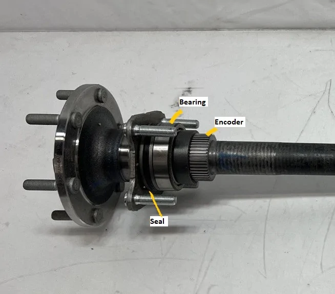

Ok, well, the news isn't good......Found seals leaking this time. Pulled the sensor again and this time it had oil on it. After looking at things, I believe the axle might be bad. Will know for sure next week because I'm turning it over to the dealership.. But the good news is it's under warranty for the axle and all parts.
airline tech
Aug 24, 2022
4,721
9,035
Midwest - KS
Aircraft Tech
I believe the encoder is normal to be wet as the axle fluid flows inside the axle tube to the bearing and this is how (metal shavings) can work down the tube to the encoder ring from the flow of the gear oil.
Now if you have a (External - Leak) then the bearing is worn and allowing the shaft to wobble and it damages the seal, thus this wobble with also cause the encoder to rock vs only rotate.
If bad enough it will hit the sensor and create a wear pattern on the encoder teeth (sloped)
and and

Slight leak I must have missed first time, so I'm leaving it with the dealership and using the warranty. I'm betting that's the vibration I'm getting too.
