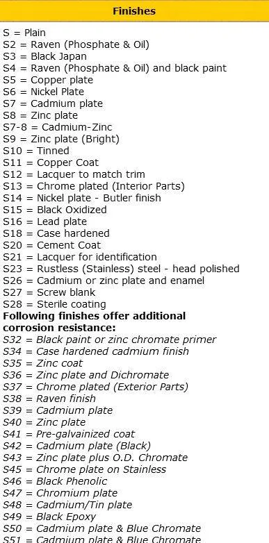

Hi Randy and David,
Different nuts... Here is TMI....Ford fastener finish suffix David has an S2 finish nut and Randy has an S36 finish from this chart....

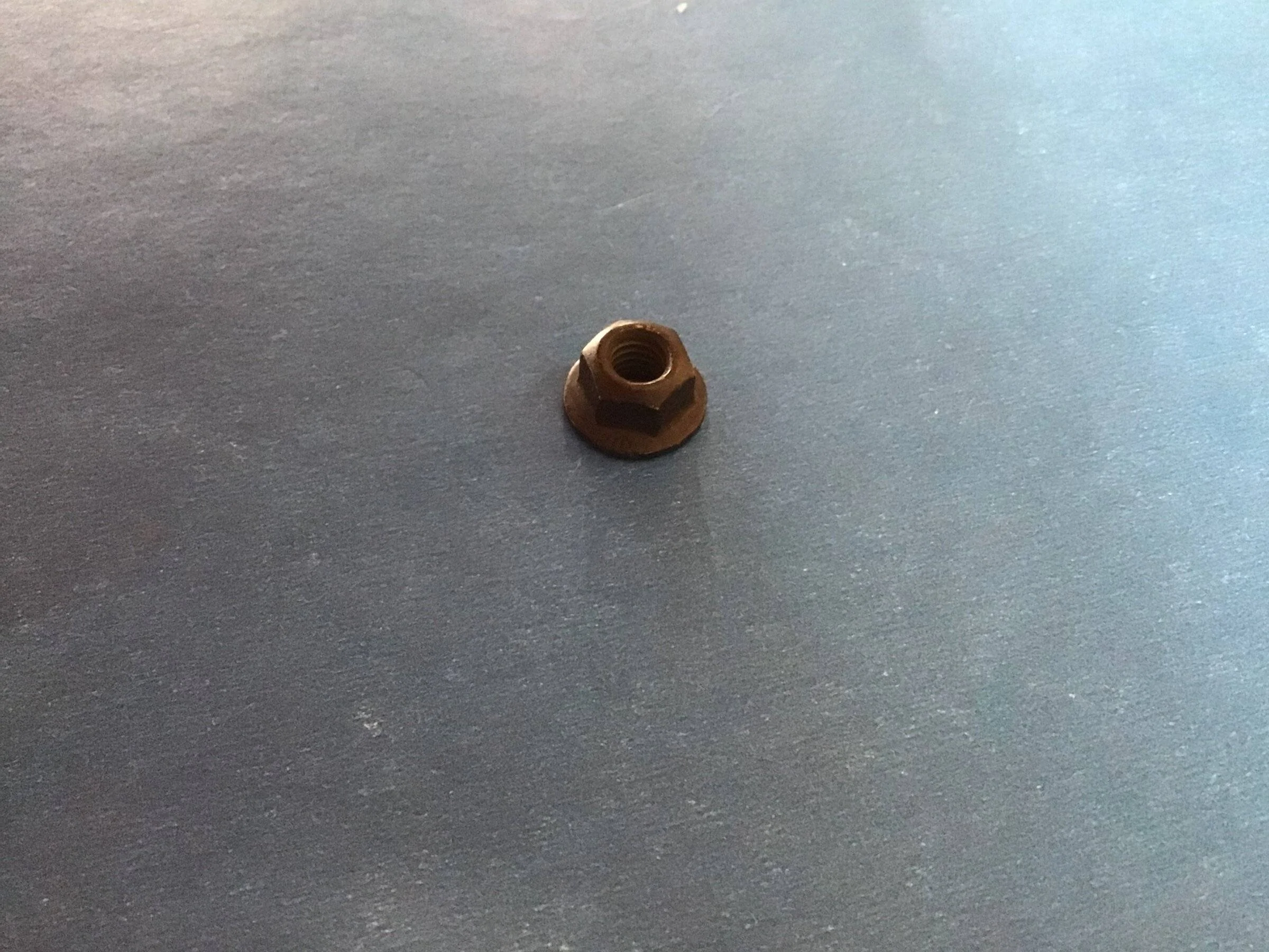

So I installed Wet Okole seat covers Sunday and what a pain those are!
But as I was futzing with the front passenger seat, this fell out toward the outside rear underside of the seat.
Great ... this stuff bugs me and it certainly isn't an "extra" part. I couldn't see anything missing a nut but it must be to something like the seat raiser and layer-backer thingie.
It doesn't look like it's had a socket on it. So either that means it was placed on and never tightened or maybe what, did uit just fall in from the extra parts when they build seats? I can't believe a nut would fall into a seat during assembly?

Hi Randy and David,
Holy smokes Phil! You can tell that from a pic!

Hi David,
It is a UBS flange nut... Uniform Bearing Surface It does not show signs of being installed as near I can tell... I think it is an extra nut that fell out of the operator's hand/installation tool, etc...
