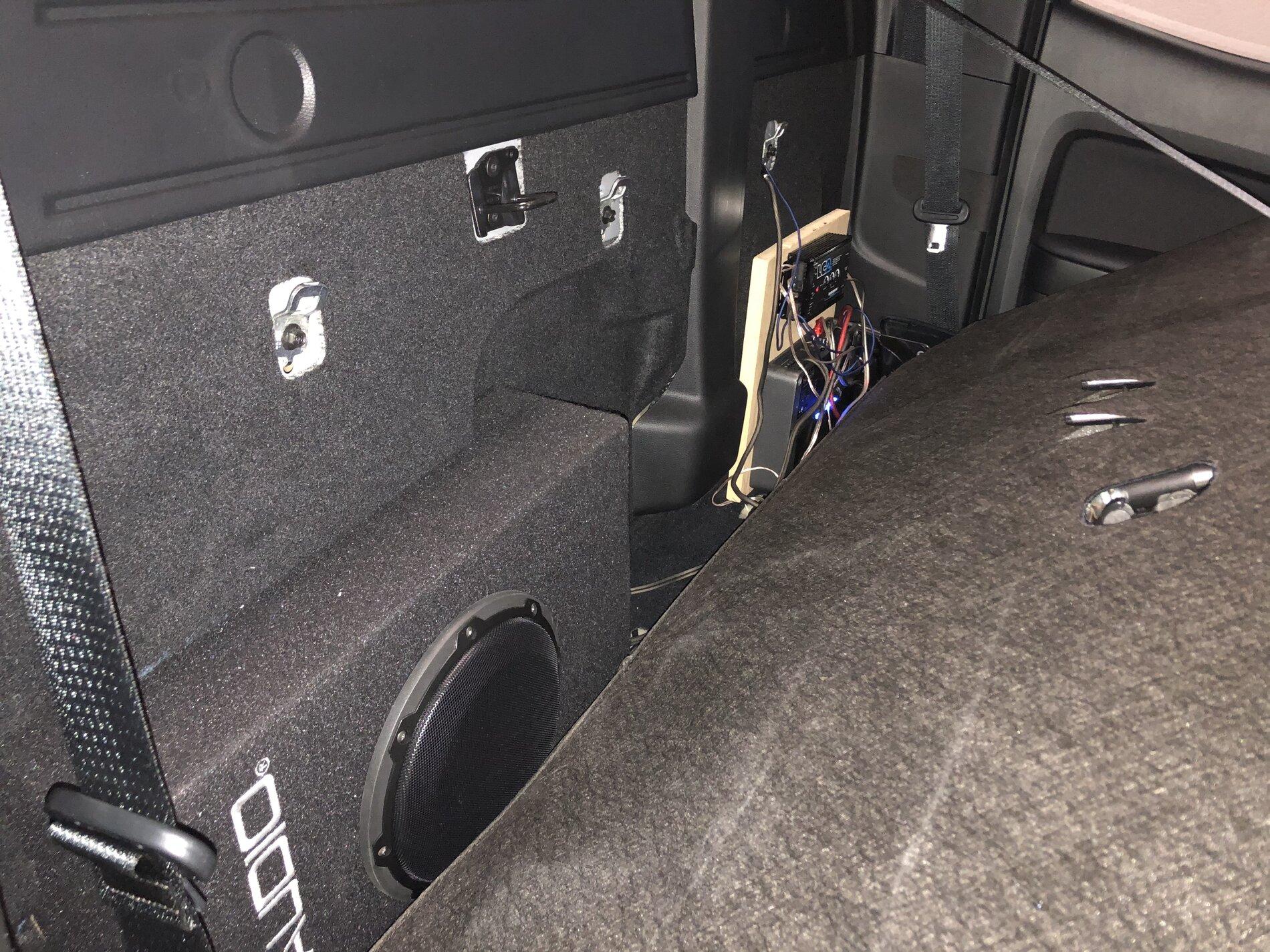

Just finished this build today on my 20 XLT Supercab with Sync. One Rockford 10, four Kicker components, and two Kicker tweeters. Removed the backseats and fabricated some 1/4" steel brackets to mount the enclosure to the threaded holes where the seat belts were.
