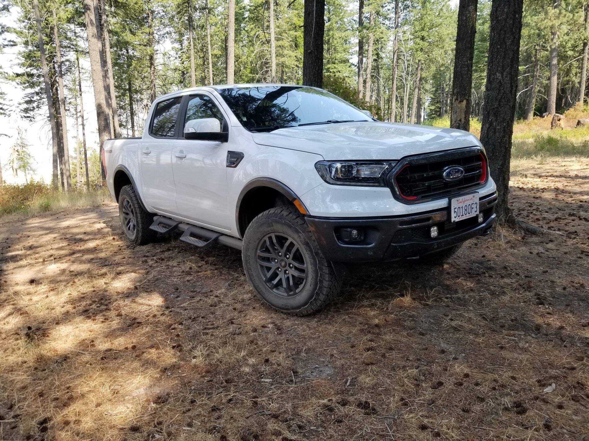

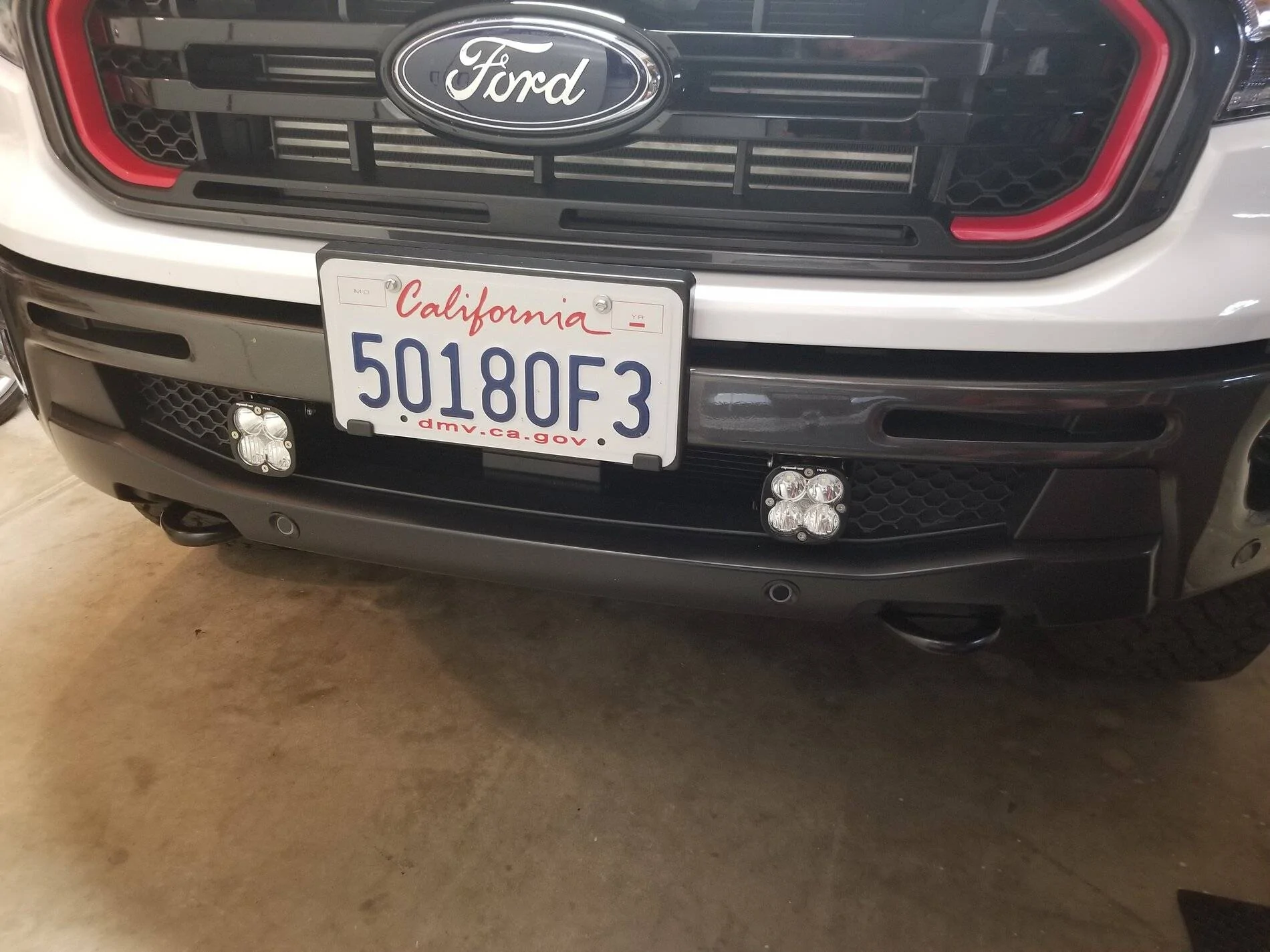

My 2021 Lariat needed better lighting for off road and dark mountain roads. Two Bsja Designs Squadron Pros in the combo pattern, mounted easily in the front bumper, and made a huge difference. These lights throw much more usable light. They make the oem led highbeams, low beams, and fogs seem weak. About 80% brighter. It may be due to the color range. This is an excellent upgrade for safety and pleasure.. HUGE DIFFERENCE.

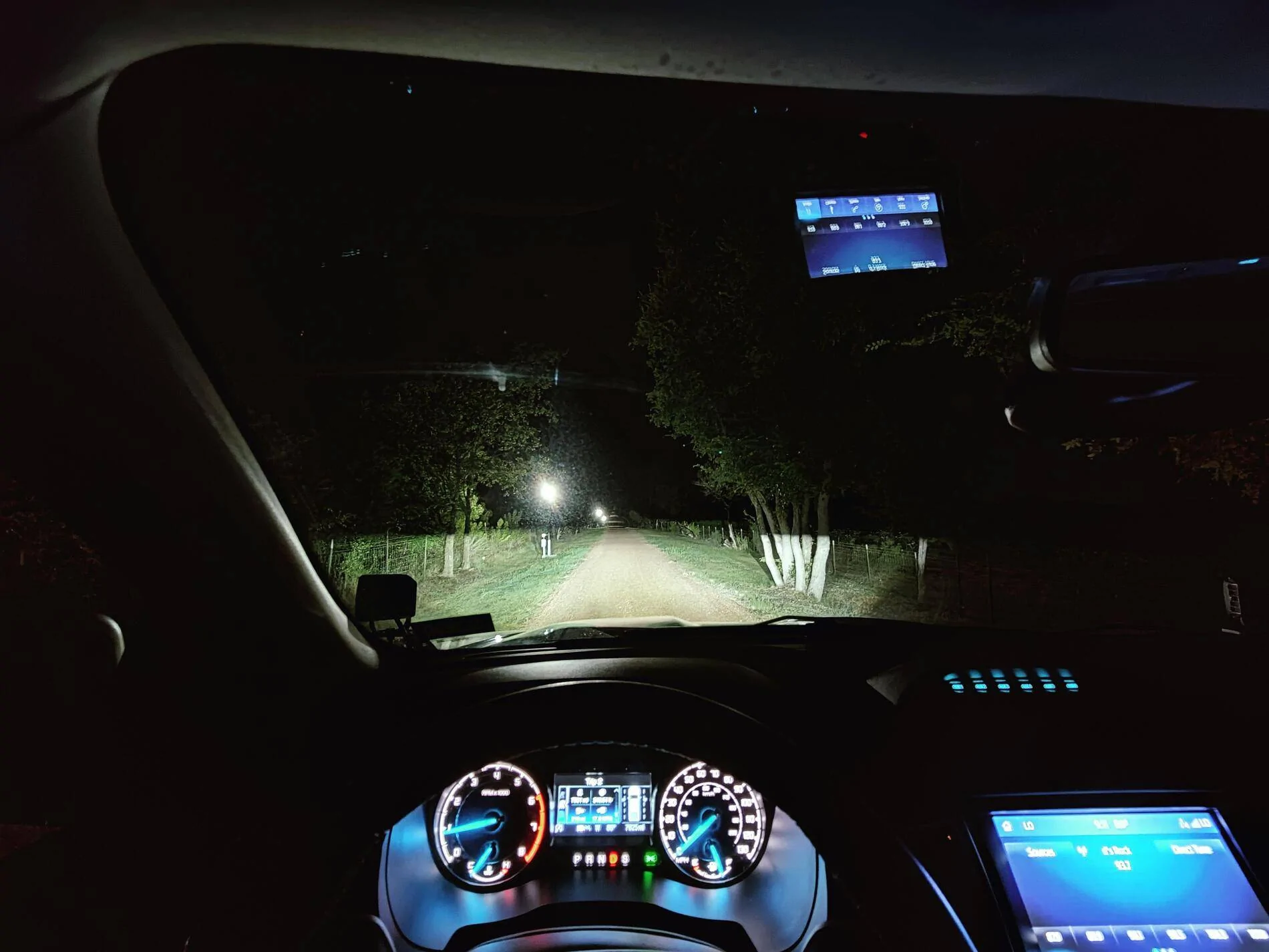

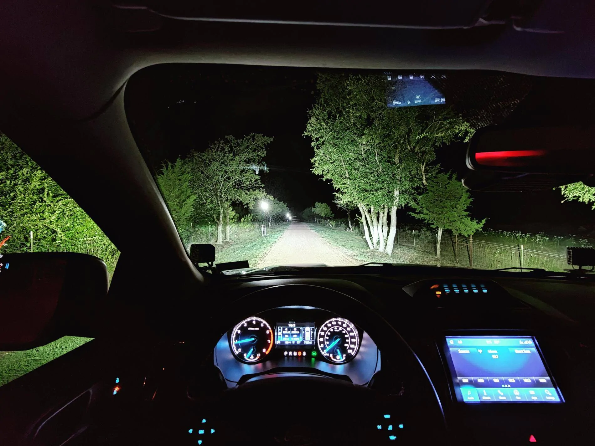

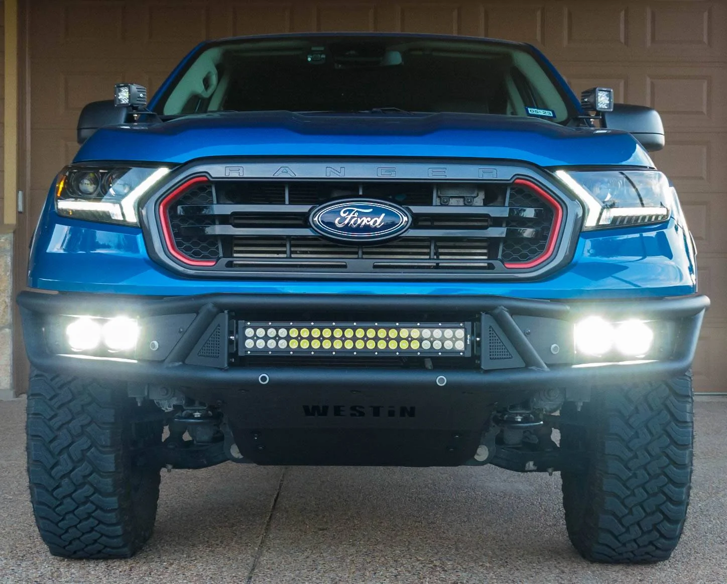

Ditch lights are a great thing to have in rural areas. Really lights up the side of the road. My headlights are amazing, but they just can't throw out to the sides like ditch lights can. Here's a shot with just my headlights vs my headlights and pods. (and front light bar, but it doesn't really make a noticeable difference here, it's mostly a spot beam)
Absolutely massive difference in what you can see in your peripherals.
And here's how they look from the front (my fogs were not on in the pics)
