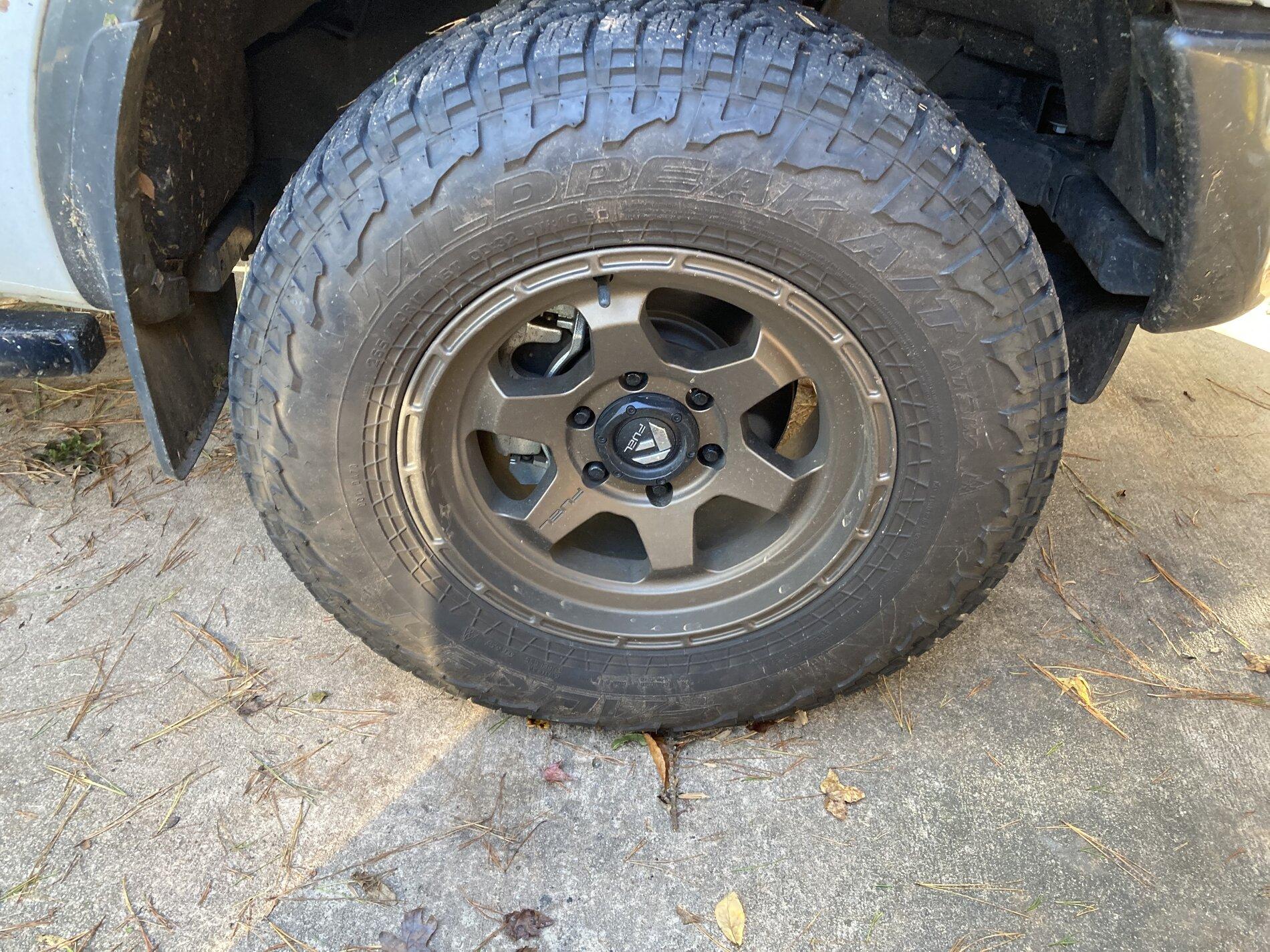

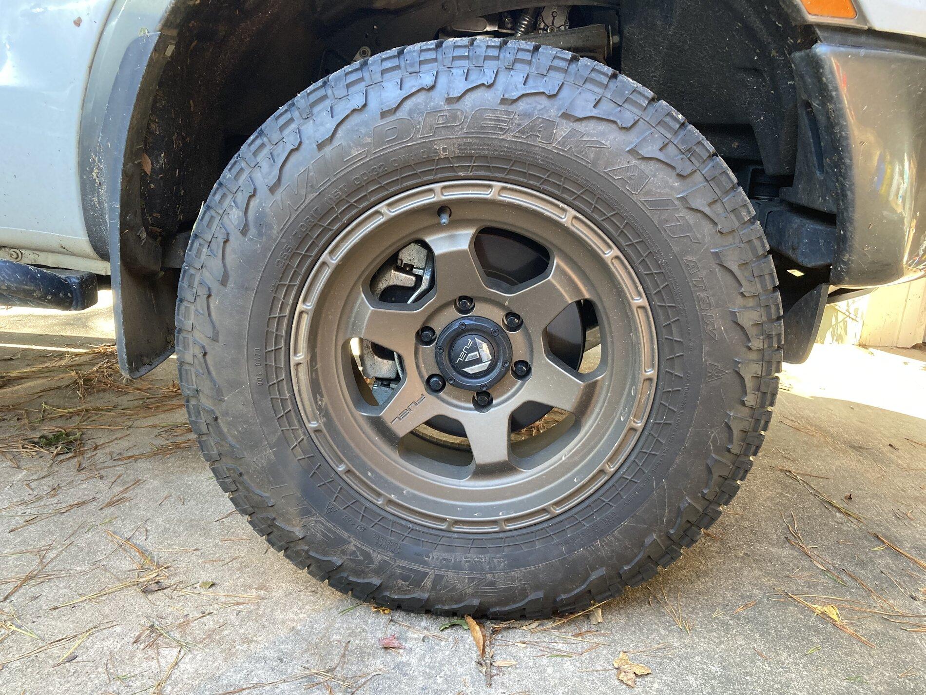

I'm running Falken Wildpeaks in 265/70/17 on Fuel Shok 17x9 +20 offset.
Zone Offroad 2" leveling kit and no cutting/modifications necessary.

Overall pic

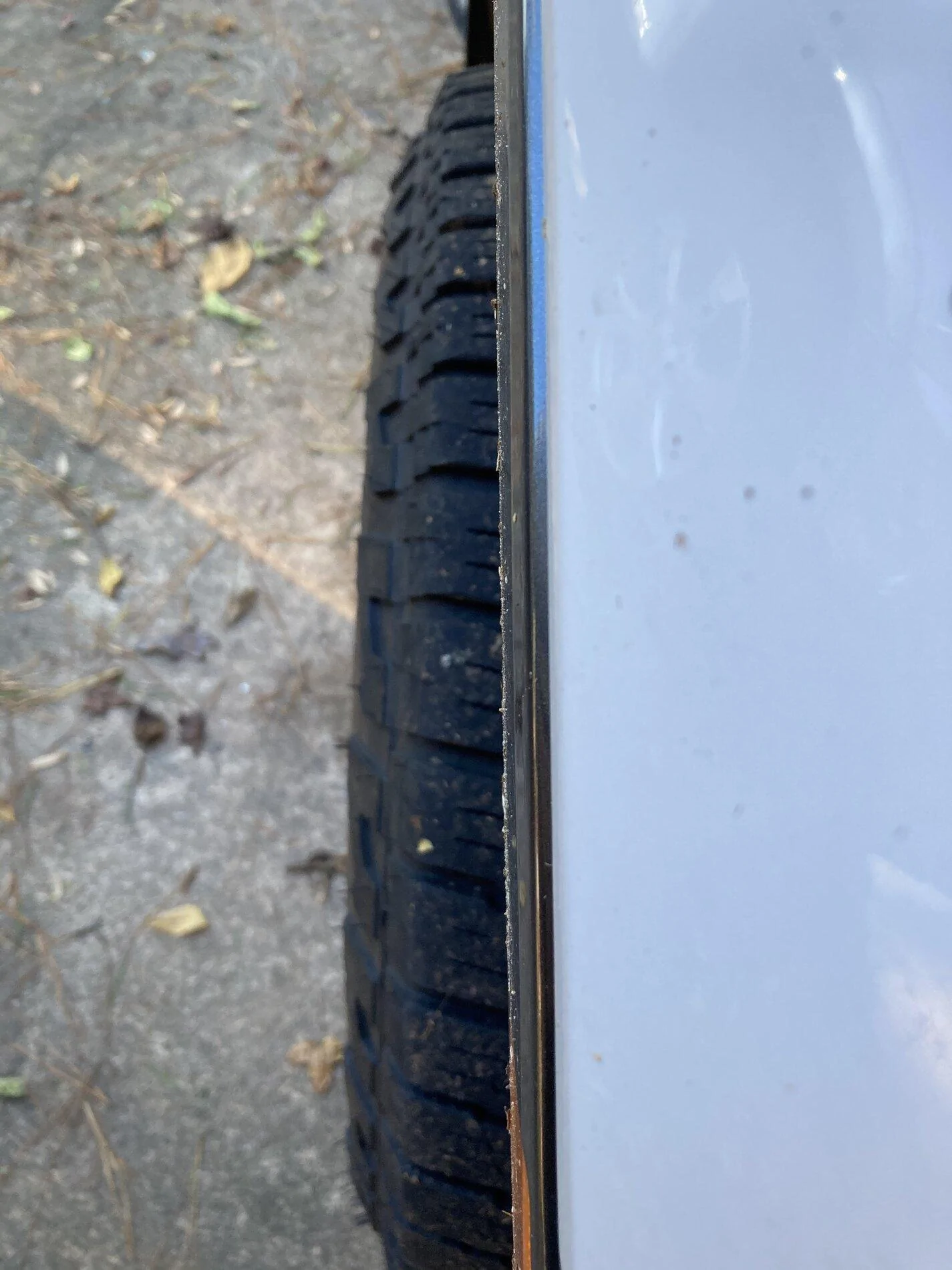

Sticks out this much. Picture is a bit misleading as the edge of the fender is almost even with the edge of the tread.

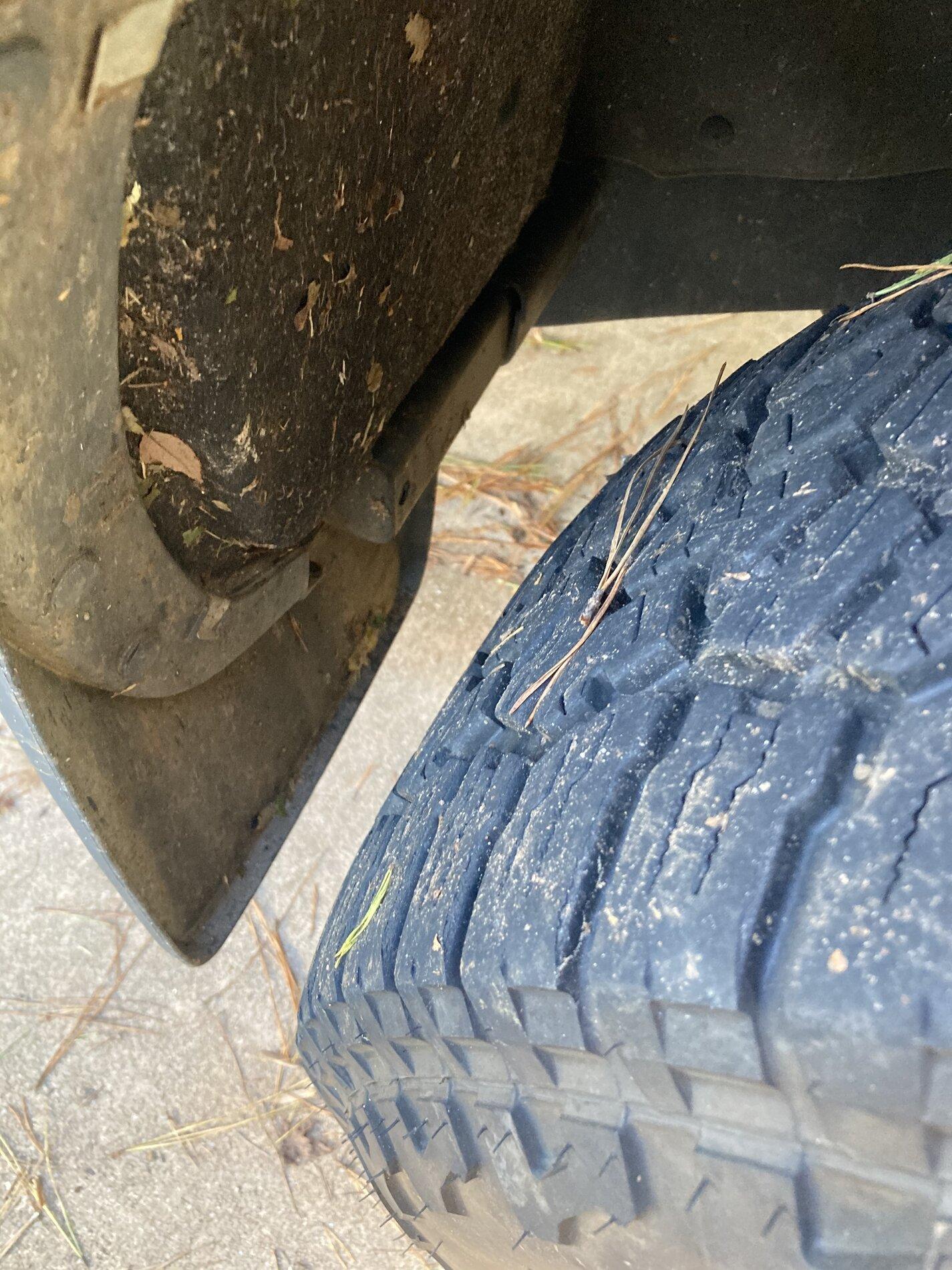

Rear clearance

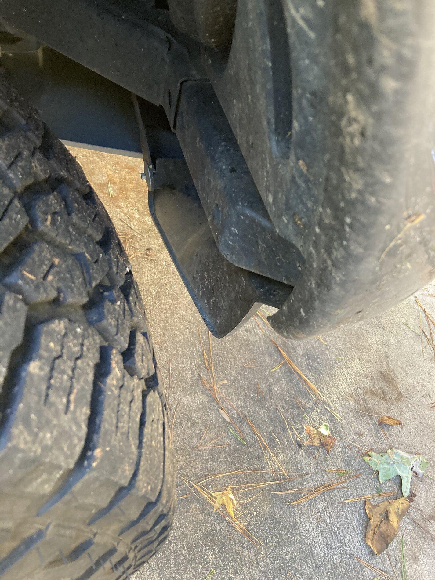

Front clearance
And view from the side
