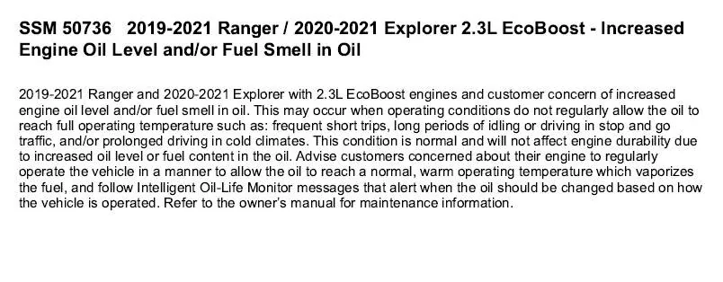

No, the Ranger does not use Oil Temp as a PID, but the PCM uses a inferred temp algorithm, by using the ECT and if needed CHT.
So, if you reference the latest published SSM, that has not been updated to cover the 22/23.
It still covers this issue, so oil temp- full operating temp = full engine operating temp.
So, this would be when the thermostat:
Starts to Open @ 197.6 Deg
Full Open @ 222.8 Deg
Note: My 22, being checked regularly the first few months of ownership and 1 a month or so thereafter, the oil level has never risen, and no fuel smell ever noted.
It's had 1 oil change and getting ready to do the 2nd @ 10k, currently nearing 9K on the OD.

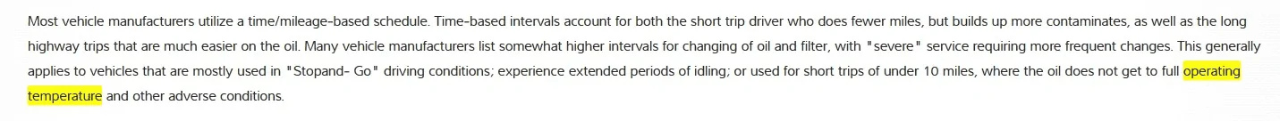

and this note from the manual on oil, Fords determined short trip note.
Sorry, can't get it any clearer but:
Short Trip = 10 miles or less
