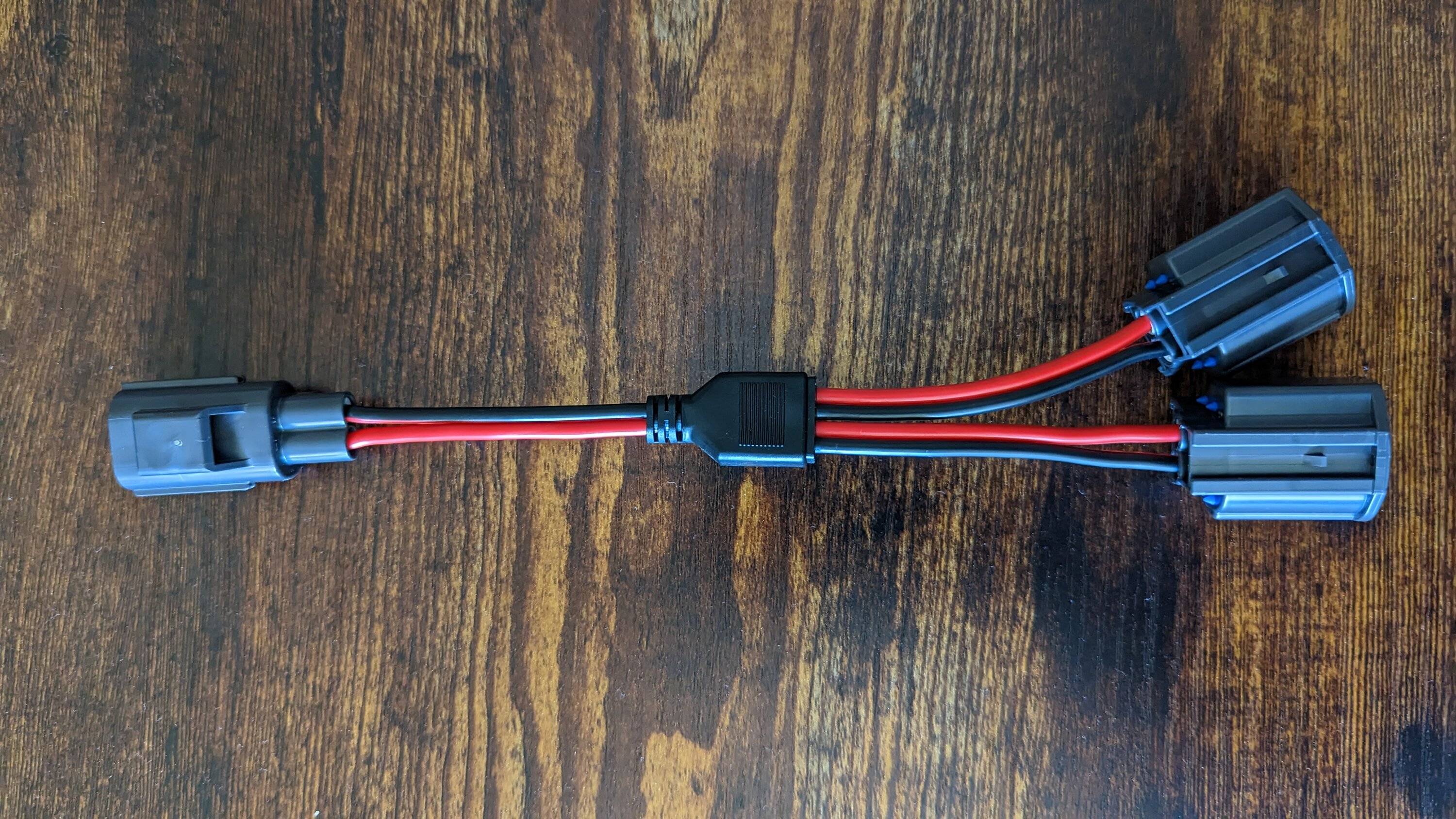

Do we know if this 12v power source is the same as a direct battery 12v source? I could simplify a lot of wire routing in my setup if its as reliable as a direct battery source.
This post here explains it well.
The plug is down near the frame...you could use the 12V outlet harness (seen above) and modify as needed. It's not hot all the time, but there's a long delay after the vehicle is switched off. If I remember right, the delay can be changed using Forscan from 10 minutes to 1 hour. I think standard was 30 minutes.

Ah I guess my big question is: "What gauge is this power harness?"
lol
?‍♂ You're turn to do some digging. lol
I'm a novice idiot when it comes to lighting and wiring. Sid @Msfitoy might know?
