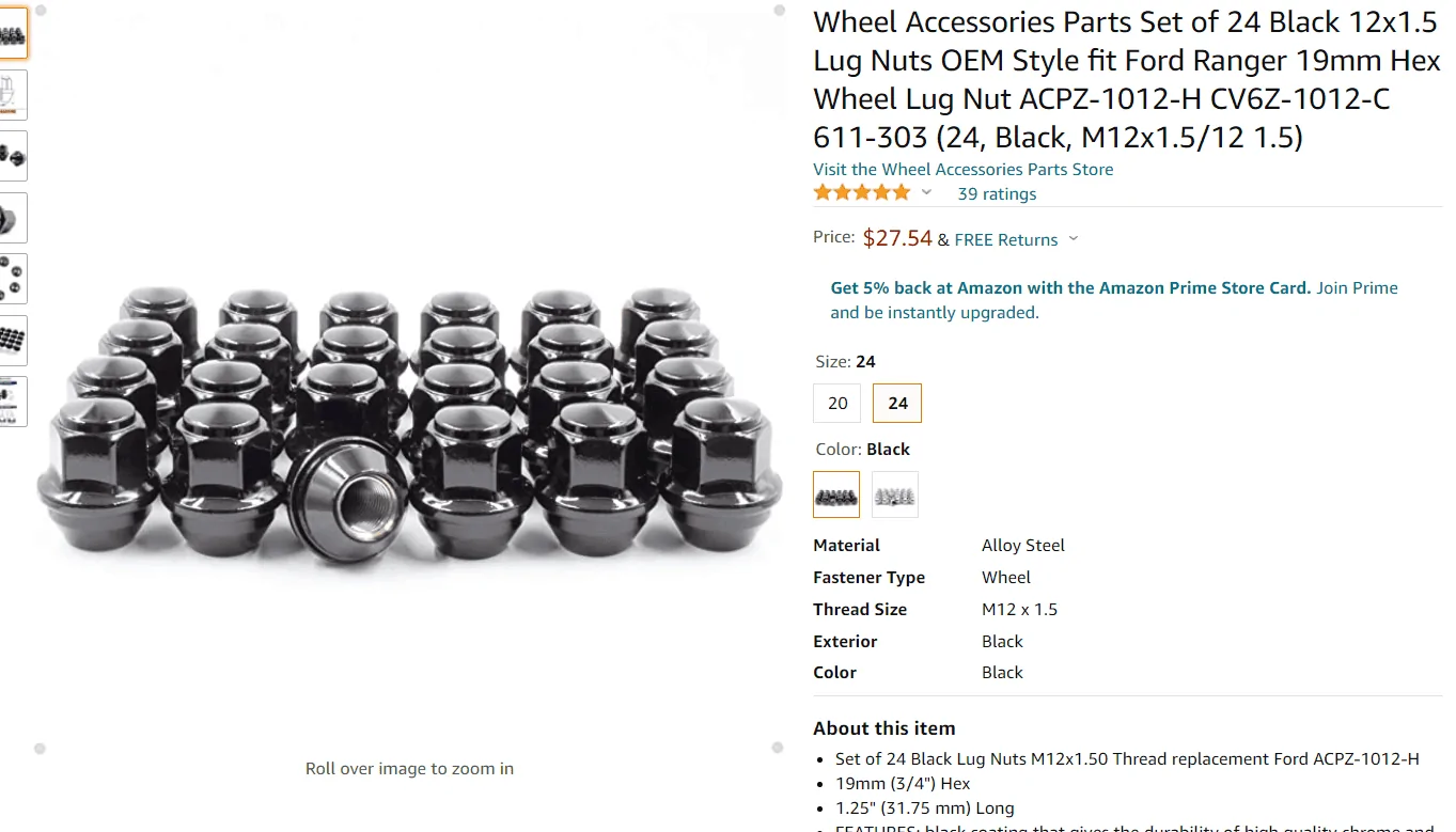

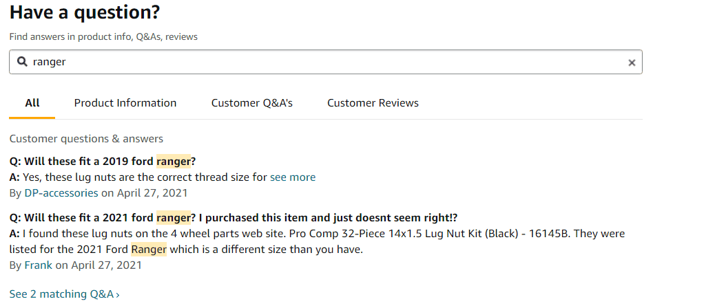

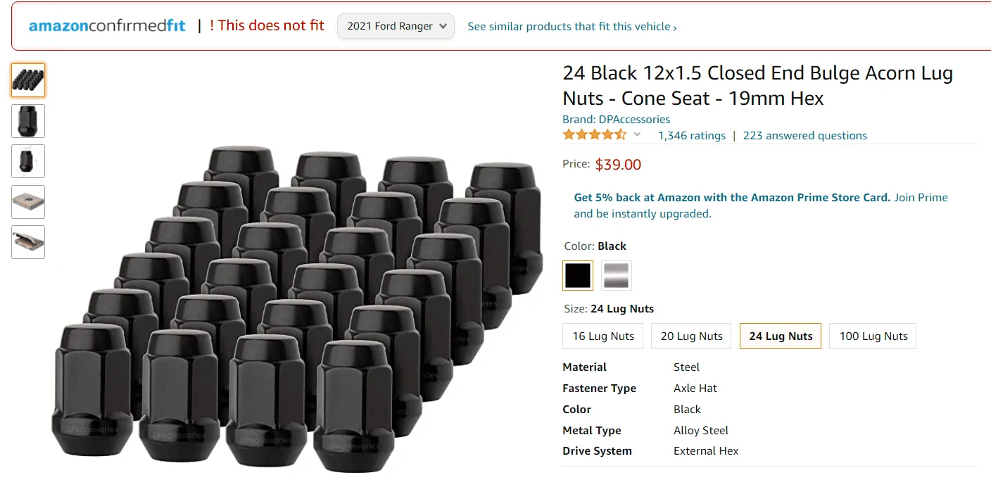

Just an FYI; Amazon says this will not fit a 2021 Ranger. Others have posted black ones that are 14mm and are 3X as long (and it says those are for a Ranger. Someone else posted that the 12MM did not fit right. So I am confused and need to find Ford's Specs on these. ANYONE: Has anyone found Ford's Specs on the OEM lug nuts???? I have a Tremor and nothing on it is silver so the black lug nuts make sense and look better.

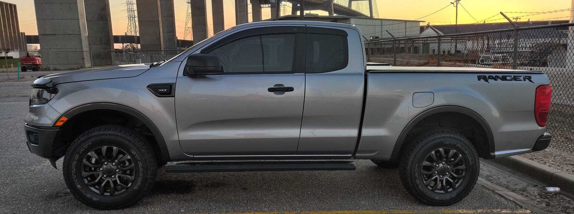

Not sure what your talking about. Those are the ones that are on my truck right now in my driveway. Fit fine. Also just went to the link and it says right in the description "OEM style fit Ford ranger". Look so much better the cheap Ford two piece nuts.

I agree they look tons better and trust that what you are doing is working. All I know is I put that in on Amazon, same product and it says, "Does not fit your 2021 Ford Ranger". Just confusion. I think down in the reviews a Ranger Owner said they did not fit his. Maybe different wheels???? I have a Tremor. Those 2 piece one's suck and silver on the Tremor....black is better. I will probably try those. Thanks

Those are not the ones in the previous link I posted. And I angree and would not use them. M12 x 1.5 is the correct thread size but the area of the taper is not correct. You also need to be very careful reading Amazon reviews. Some products have multiple sizes and they mix all the reviews together. Also, their fit listings are notoriously inaccurate.
The ones in my original post are the ones I'm using and they torque up and work well.

I will go back and find your original post....I could have swore I used your link and that is what popped up. May have been an Amazon link snafu. Thanks for everything....I will order what you got!

I think this is the one from your original post....I have no clue why that other showed up. Thanks, I will try these!!!!
Amazon.com: Wheel Accessories Parts Set of 24 Black 12x1.5 Lug Nuts OEM Style fit Ford Ranger 19mm Hex Wheel Lug Nut ACPZ-1012-H CV6Z-1012-C 611-303 (24, Black, M12x1.5/12 1.5) : Automotive
