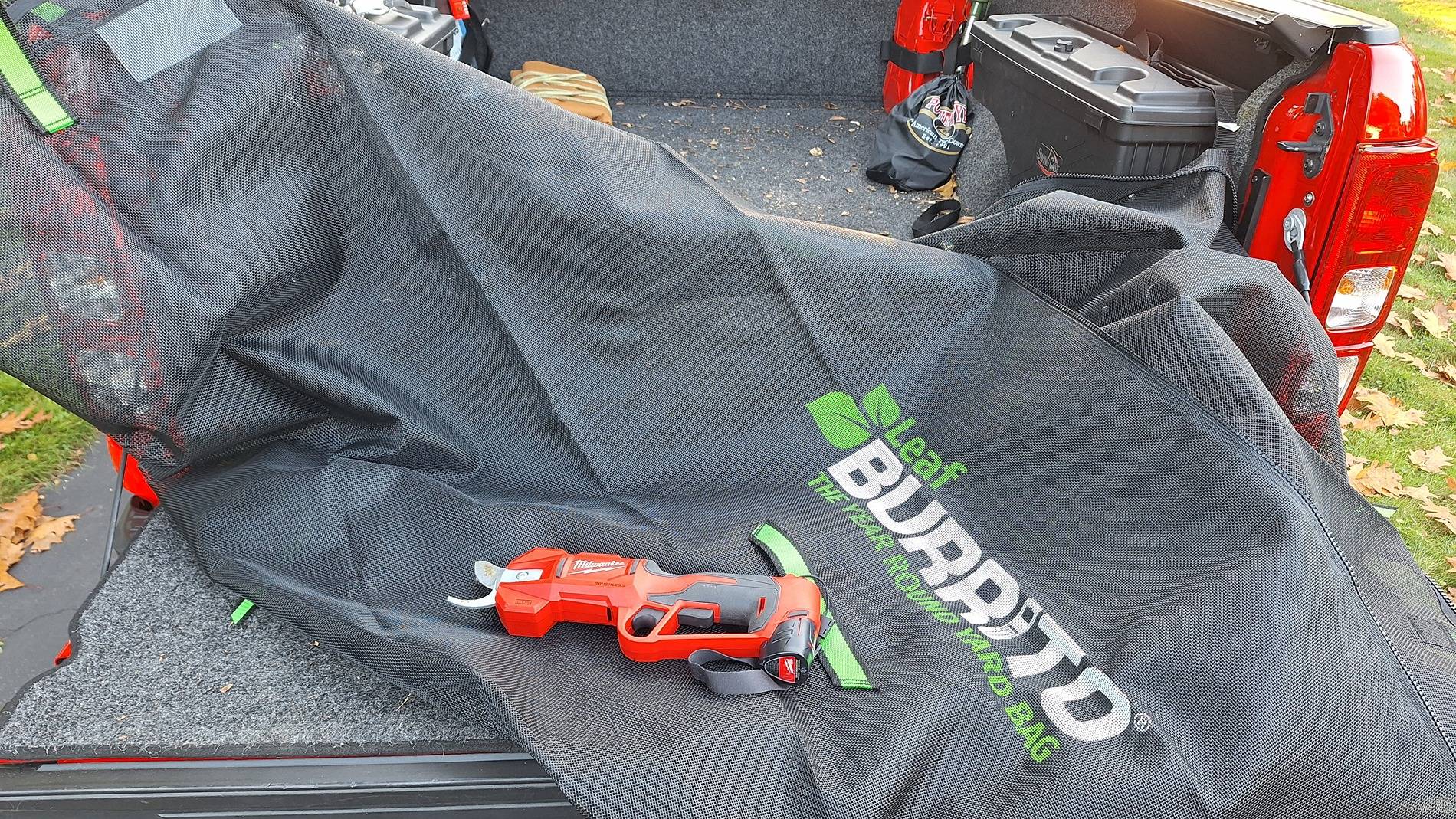

Just got the 7' Leaf Burrito and I've been using those M12 pruners like mad over the last month.
It'll hold 3/4 yard of mulch, so I figure it'll hold 4 bagfuls from the Billy Goat and that will be over 200 pounds.

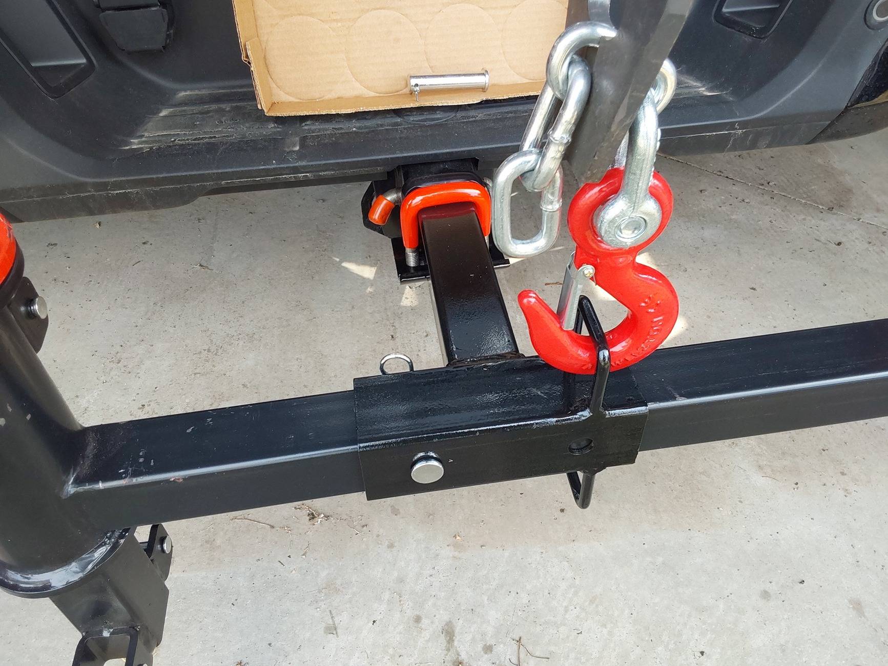

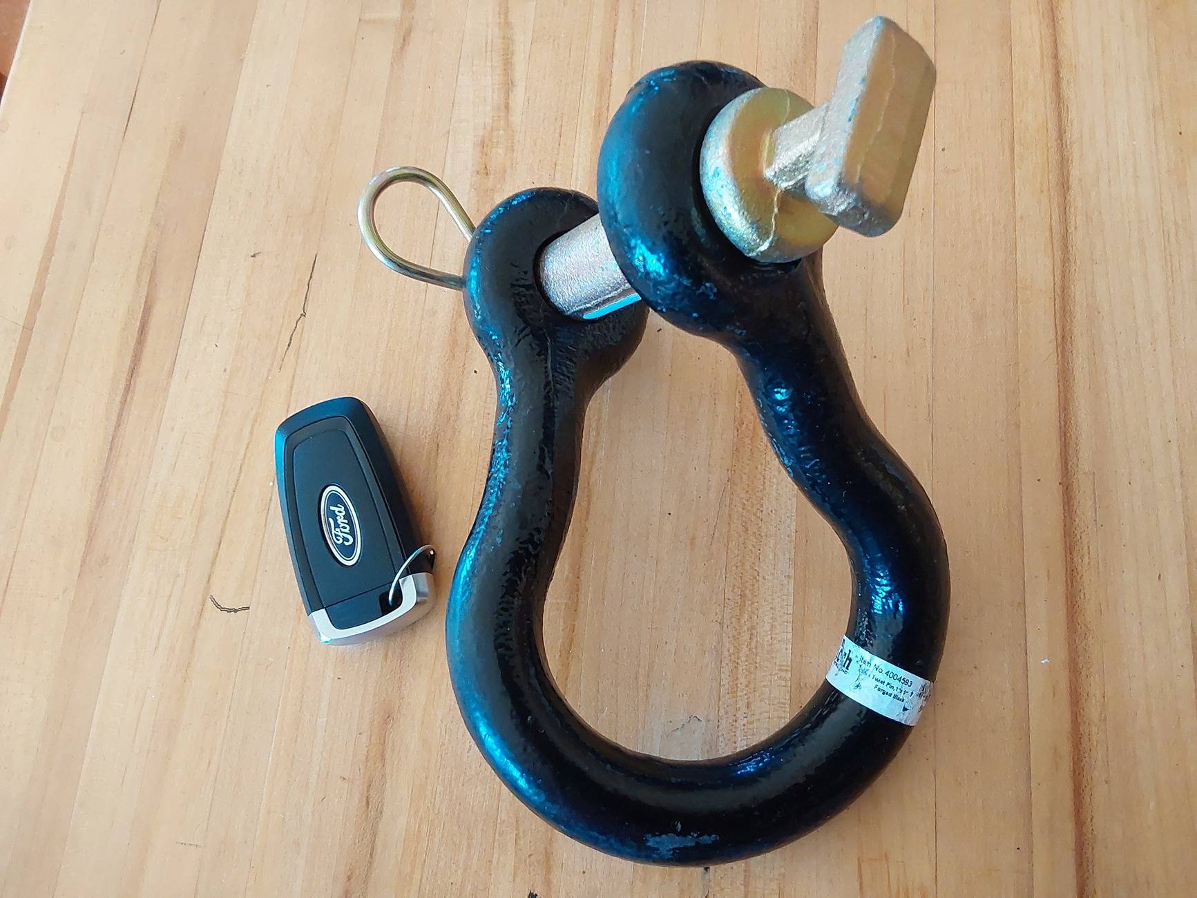

You need one of these to hook the burrito corners to for the crane
My crane will be here tomorrow. I bought one of the $199 ones on ebay and hope it's not junk. It's all your fault ?.
That's a nifty shackle with the twist - that looks like it would be better than a regular one.
Now I need to find a stainless steel one!
Good job on scoring that crane, I hope it fits your needs. Of course, we'll need pics! =)

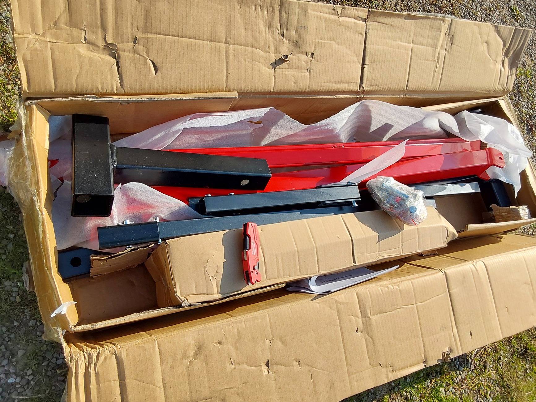

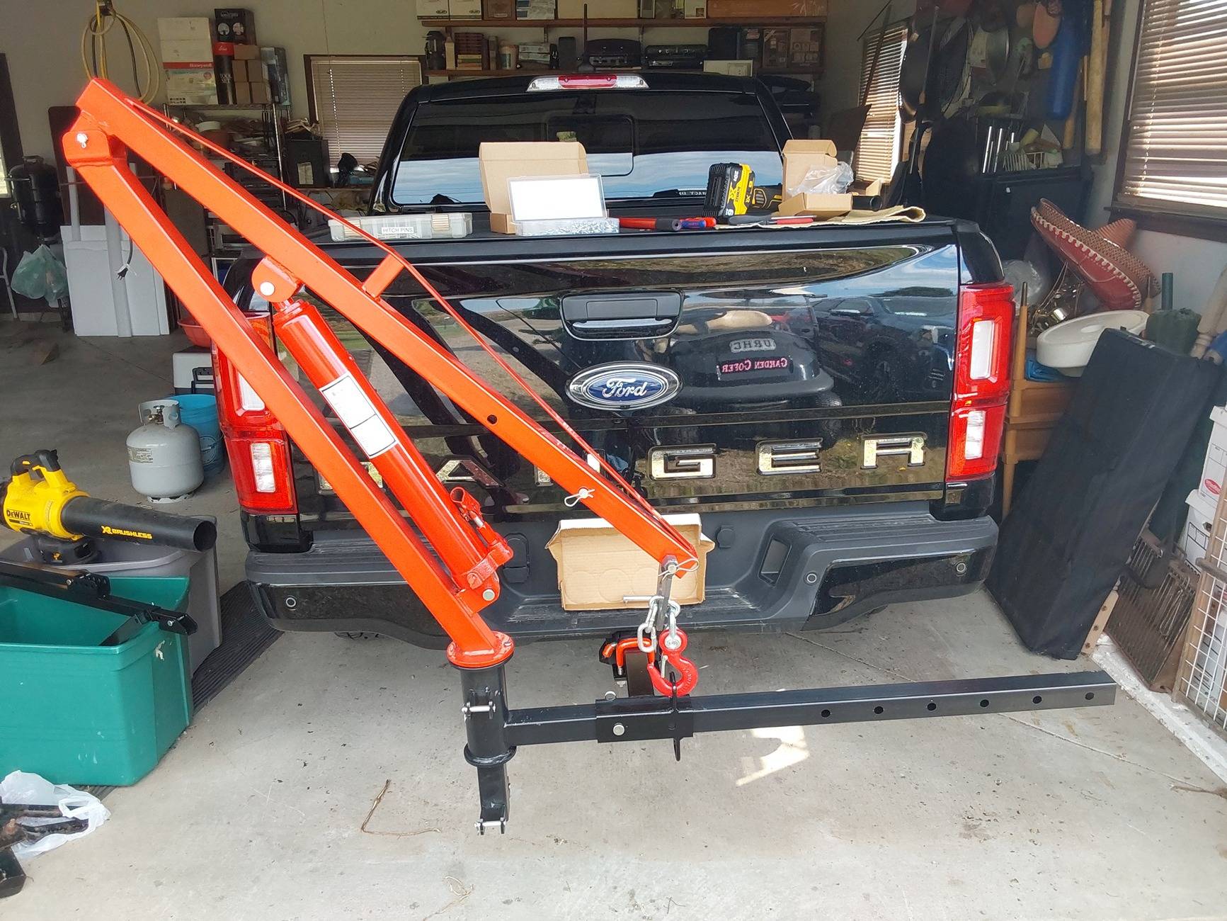

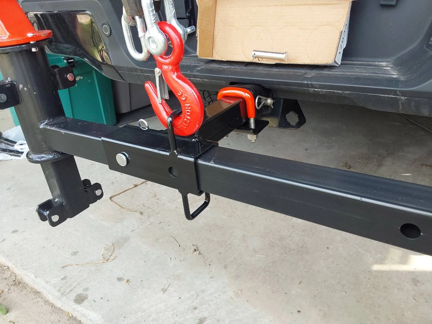

Well I got what I paid for :facepalm: . Fedex managed to poke some holes in the box but everything was there
It all almost went together. Fits the hitch and truck nice but they supplied cotter pins for all the pins and many have to be removed when setting up to use. Luckily I have a box of the spring clips

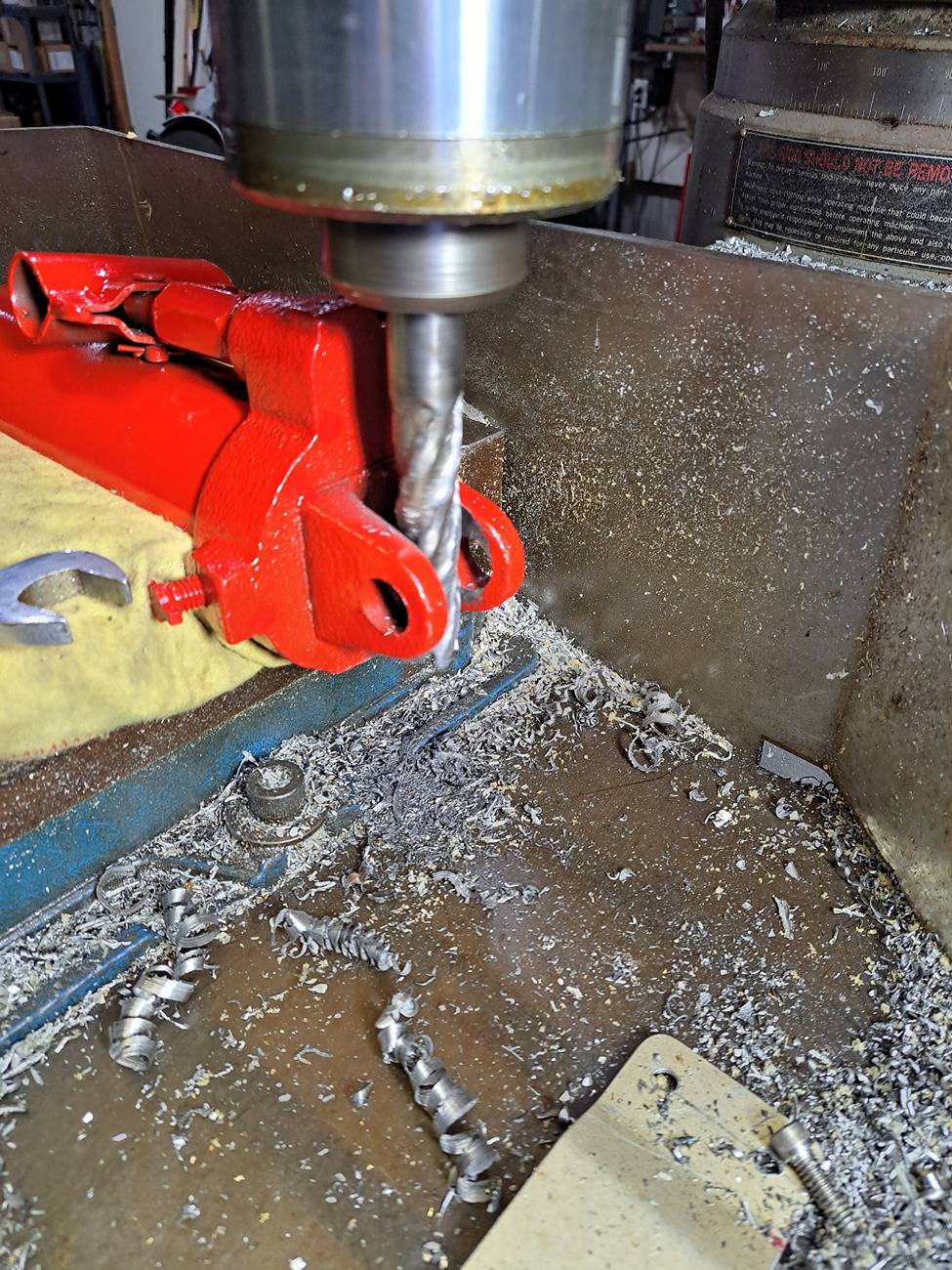

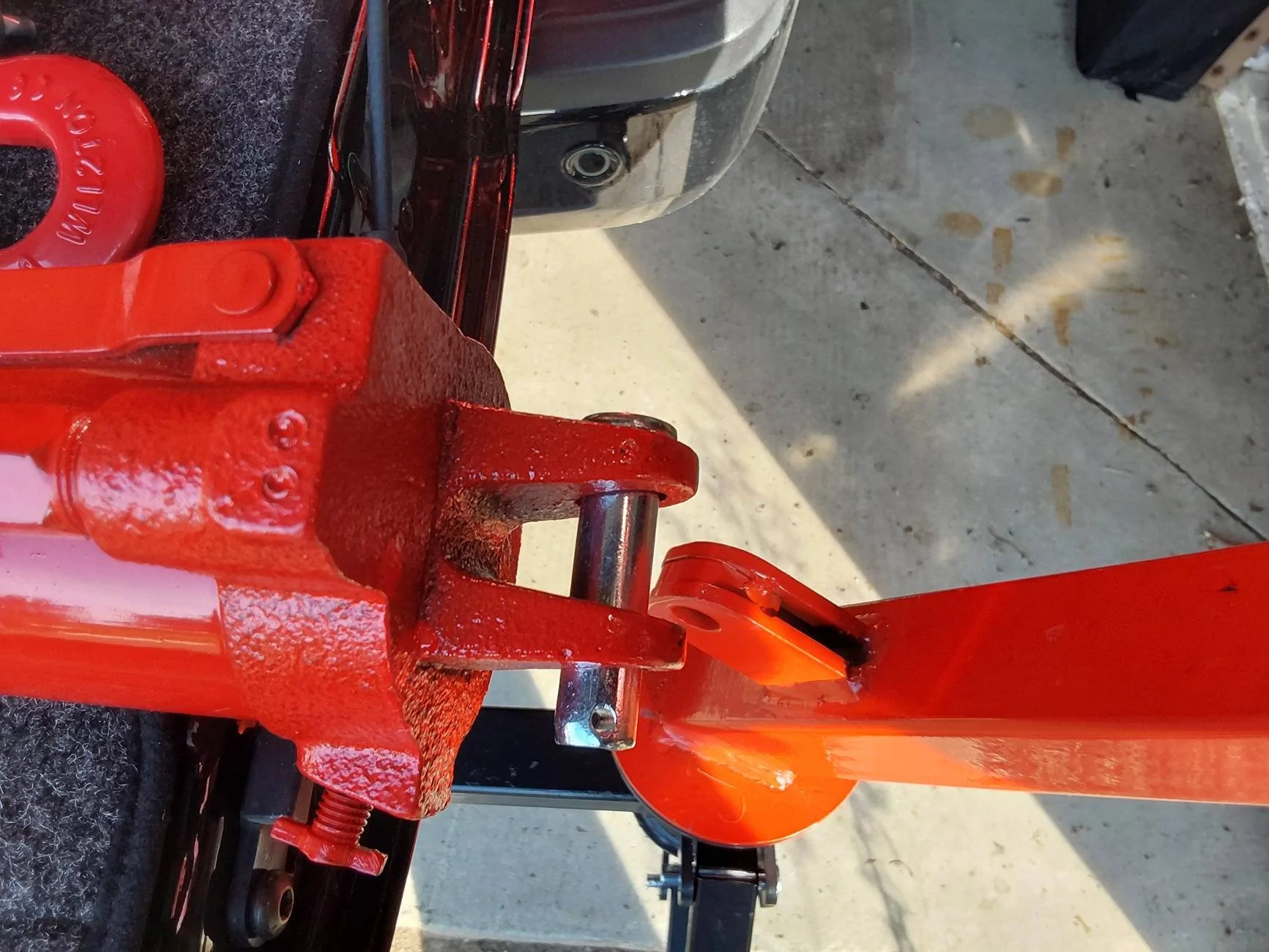

Then I hit a wall. The jack bottom clevis wouldn't fit over the bracket welded to the frame because of a big taper in the casting.
Threw the jack in my milling machine and straightened the taper some
Everything is good now and it will work fine. Going to put one more hole in the support tube so the jack can be left in place, slid to the center and pinned while driving. I doubt it's safe for 1000 pounds but handles 200 lbs fine.
It looks great and I like that color.
I also like the clevis pins, instead of the bolts I have.
And good thing you have the skills and tools, far better than an angle grinder I would have grabbed.
For mine, I'd like to alter the hoist chain with maybe a grab hook or some way to alter the length.
I look forward to hearing any mods you might do and congrats on your great deal!

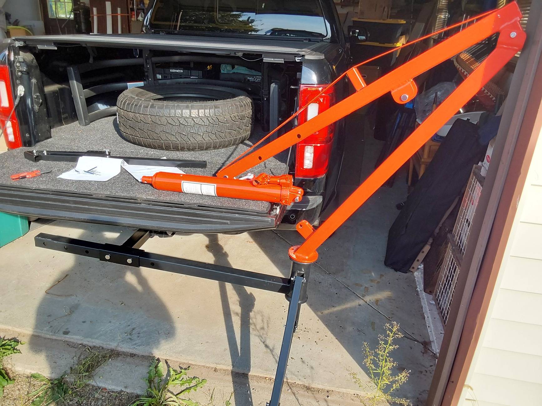

I placed the crane in the receiver and assembled it except for the stabilizing legs and drove to the rental place (only a mile away with 25 mph speed limit). It stayed in place without any issues.
When I lowered the tailgate, I had the crane slid toward the hitch about a quarter of an inch too much and nicked the paint! Bah! But I guess being an aluminum tailgate, it's not a huge deal. Still though, I'm going to get a Race Red Ford paint pen.
A friend was with me (he actually paid for the rental) and the two of us were like a pair of monkeys with a football trying to rig the medieval torture device (the aerator, I had never used one and holy crap, what a heavy bucking beast!). I'm sure we were good entertainment for the rental guys! =D
We got it in the bed, left some load on the crane, and tossed on a 2" ratchet strap (left the tailgate open). As we started to pull out, a rental guy comes running out the door yelling: "you left the effing legs down!" =p

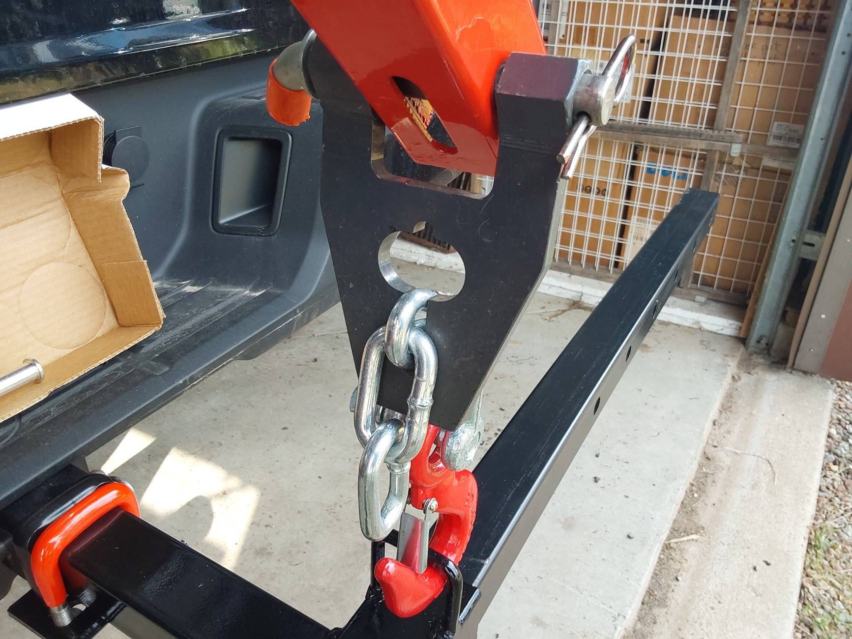

I did two things as "mods" to the crane. First, I used a smaller shackle to take up some chain slack, I think that's a good enough solution for my needs. As you can see in the pics, it lifted the thing plenty high enough.
The second thing I did was wrap electrical tape on the crane base so I would not slip in in too far again. o_O

back home with the infernal thing
I unloaded by myself on a pretty level spot and it always felt in control
plenty of lift height for this use
you can see how close it has to be to the crane because of the boom length, especially when lowered down

3/8" shackle taking up chain slack, not the most ideal I suppose but rated to 1300# in optimal use, if you know of something better suited, let me know (not that I need much reason to buy something!) =D
d'oh! nicked it! =(
didn't have a paint pen, so used 3M vinyl electrical tape, maybe I'll used the paint pen when I get it =)
crane FTW! Aerator not so much!
little girl neighbor commented that the dirt plugs looked like a whole lot of poo! LOL, that made it all worthwhile!
=D
I did a couple mods to mine. Drilled a hole for the travel position
Then welded on some hooks to lock everything in position for going down the road.
Then grabbed the chain adjuster plate I machined for my tractor
and will test it out next week. I need to cut a 3 ft piece of chain to replace the stubby that came with it
Not bad for cheap Chinesium :handsinair:
Fantastic mods! And I really like your chain adjuster plate, that's brillinat!
The welded-on hook loop is ingenious and with your transport position, I think that would be highway worthy. =)
I don't have enough amps in the garage for my welder (and I haven't welded in over 20 years) but I might need to do your loop/hook mod in the basement! =)
Thanks for sharing - gonna need a Ford Ranger crane section on this forum!
Edit: I just noticed that yours uses a hitch pin for the side-to-side adjustment while mine are two bolts with jam nuts. I may drill mine to do the same and then I certainly won't nick the tailgate any more.
Yours is stronger without the holes but even a small 1/4 inch pin would be a good safety measure for going down the road. Mine uses a pin on the swivel for locking rotation and is limited to holes located every 30 degrees on the mount plate. Before deciding to bend up and weld on hooks I tried a axle strap used for tying cars to trailers to see if it would remove wiggle so something like that may be easier for you. Just a 2 inch wide by about 18 inches long strap with steel loops at each end. Mine has a 8 ton jack that sucks. Each pump moves it very little. I may switch it to 4 ton I have laying around for faster operation. I can see yours is much better made probably from thicker wall steel but mine is just for 200 pound propane tank loading so it should survive. Making a harness to clip on the tanks next to make it easy to get them from vertical to horizontal.
