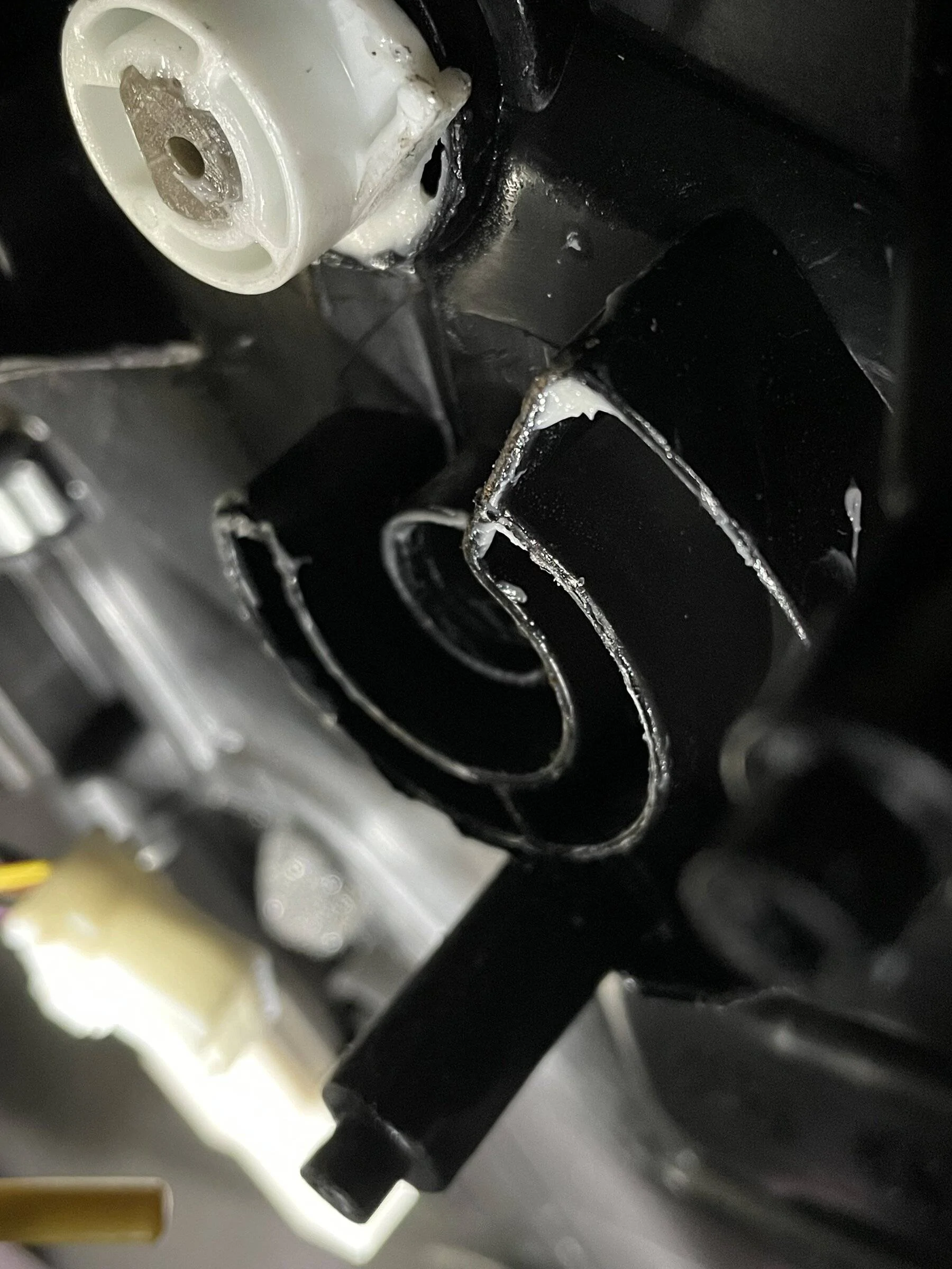

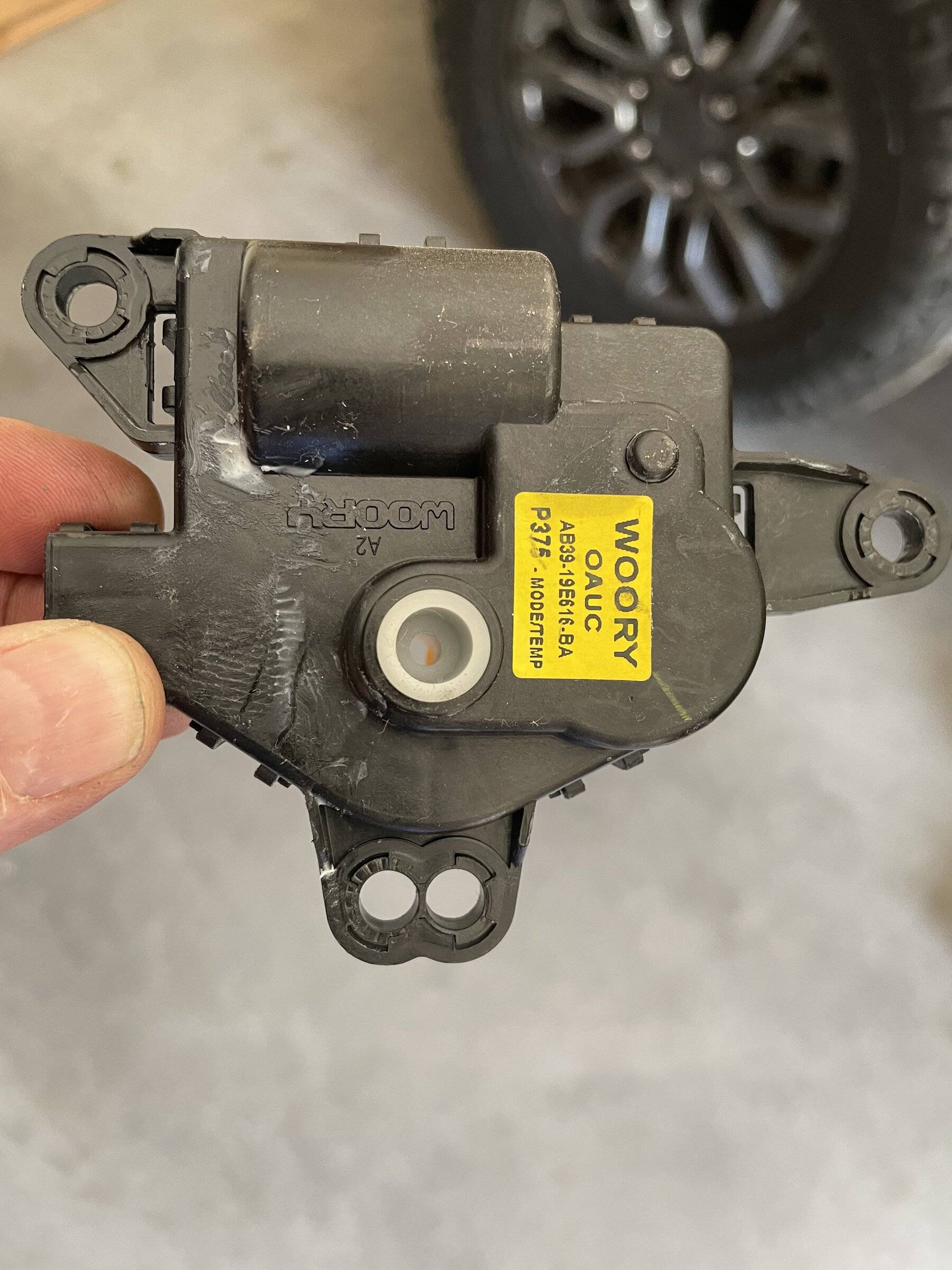

Spent the last hour removing the broken actuator on my Ranger. This is a known issue for those that have 2019 - mid 2020 where the drivers side sticks closed and you only get heat. I found this out last Saturday when it was 106 degrees out. ?
It is covered under warranty but my dealer said it would take a week just to look at it (yes they wanted me to leave it all week!) then another 7-10 days to fix it and that's IF parts are available. It's a fairly easy fix without taking the whole dash apart but you'd better have small hands and be able to squeeze into tight spaces.
A huge thanks to Daniel @dmeyer302 who has a post and video here on how to fix it yourself. As soon as I flipped the white tab up I had ice cold AC blowing on the drivers side again. ?
There's more info in this thread here. But here's a quick picture of the white tab that needs to be moved up. You'll need a long thin flathead screwdriver to get in there. The actuator sits below this in the half rounded pocket. Getting it out isn't easy but it will slide out from the back, pull out the white clip on the back side, tilt it down and it will come out that way. It's a pain because there's a metal support bracket right in the way.
