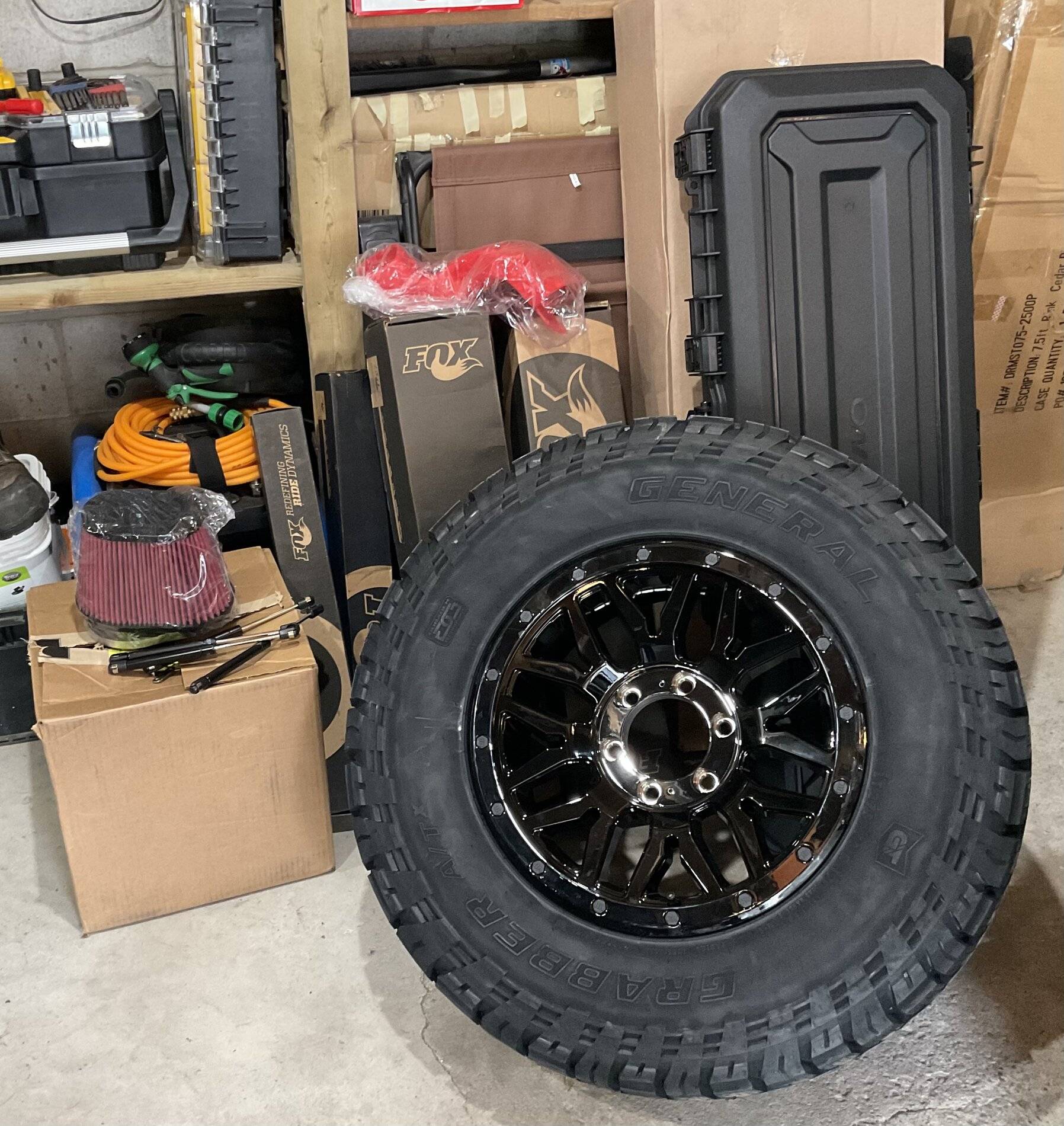

I cleared my afternoon and had a 2nd birthday party for my Ranger. Lots of friends were there…Roush, aFe Power, Fox Performance, General Tire, Menace Wheels, and Plano All Weather Cases. There was no cake but a good time was had by all. Details are in my build thread - Phase Three.

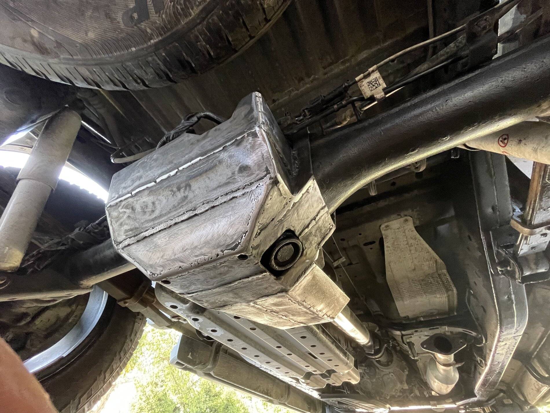

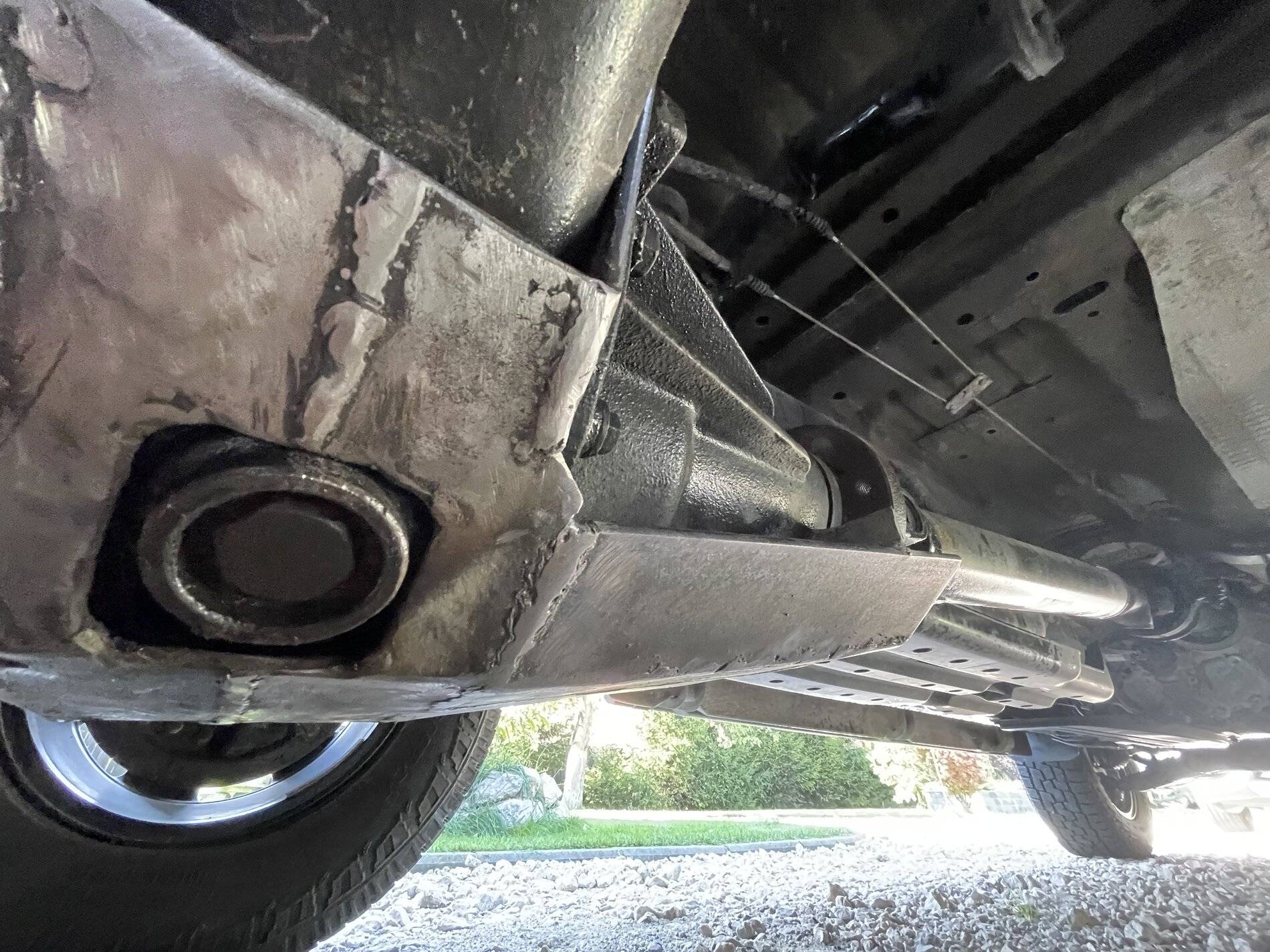

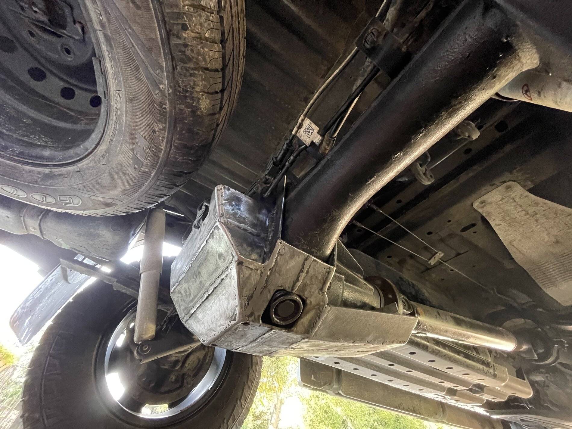

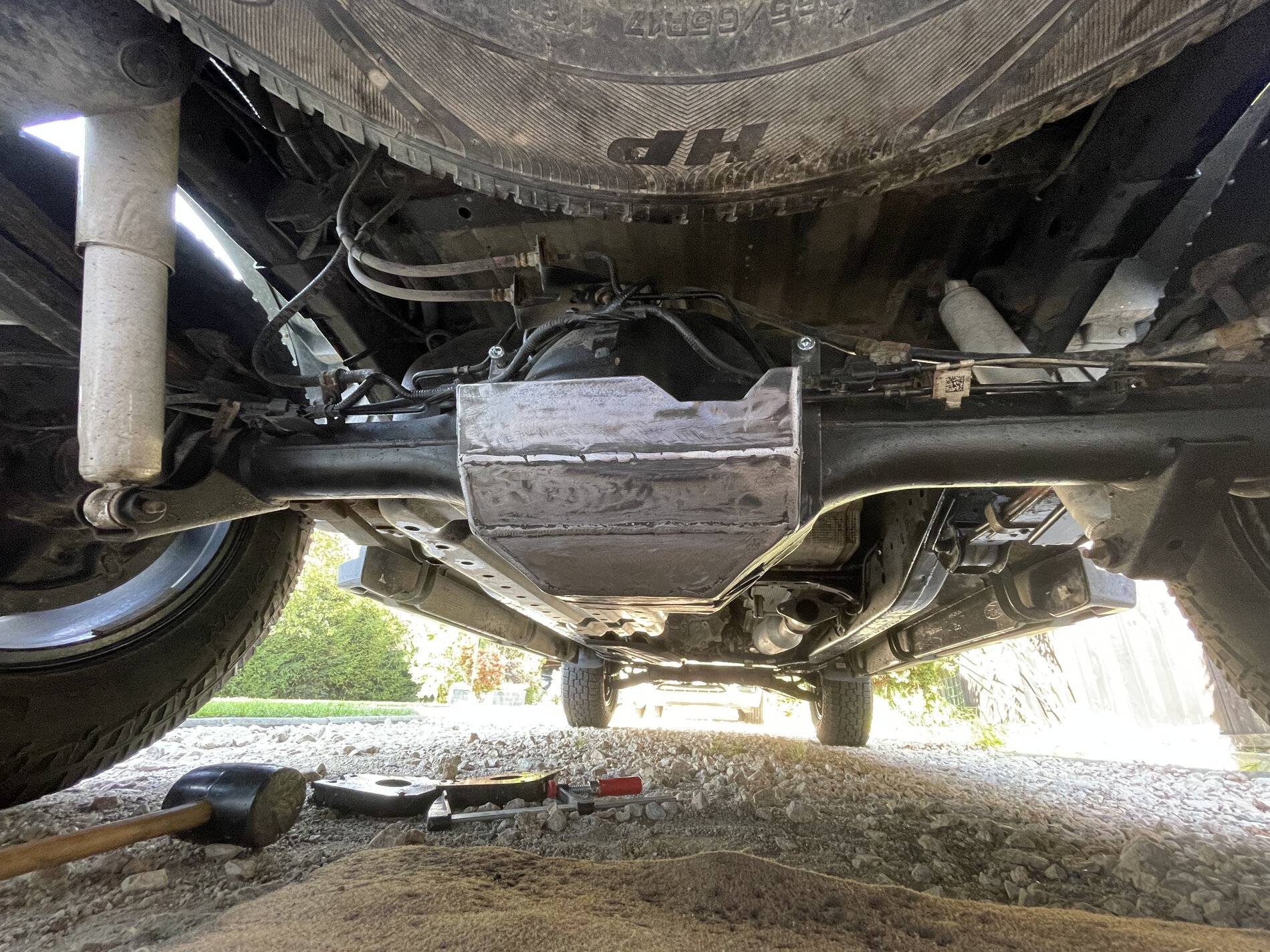

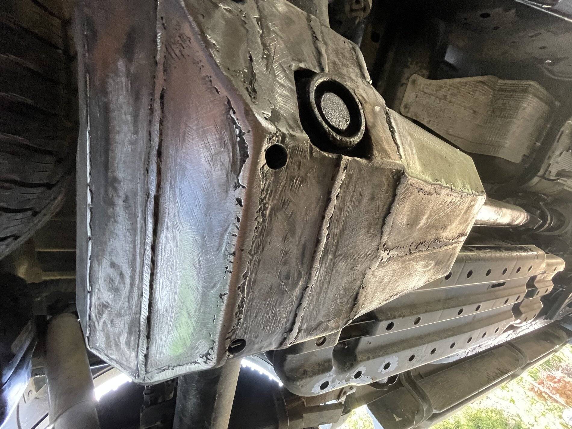

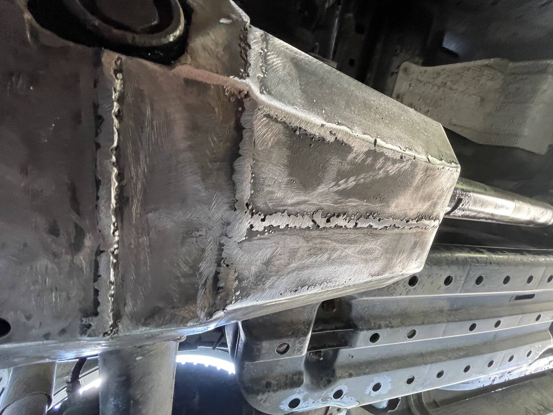

Time to brag on my DIY rear differential cover/skid plate. Not yet finished/cleaned/painted. I am not an efficient welder, actually this is the first MIG welding project. Until now I only stick welded (MMA) stuff. The idea was to do as much welding as possible, thus I made it from mild steel 5mm thick flat steel(60mm wide). The cost is about 20$ not including welding wire(flux) cutting disks and other.
I am thinking to paint it dark gray. My car is full black, except a few items. Initially I wanted Ford blue, yet I find it too flashy. What do you guys think? Black is an option, of course ;).

I have a ton of respect for folks who do their own welding - even more respect when they crawl under their trucks on gravel driveways to work on them! ?

In all fairness, I only did the measuring and tacks under the car, the main welding was done on the workbench. However I did a lot of crawling, testing, welding and testing again as the metal stretches and bends from the heat.
Thank you for your compliment, I appreciate it!

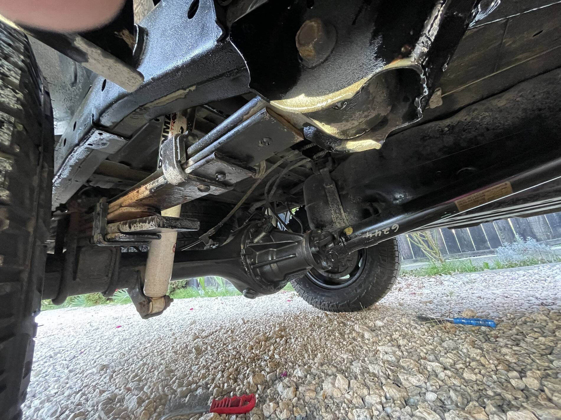

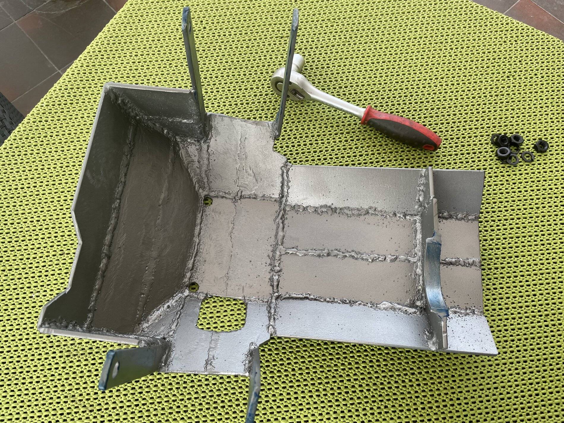

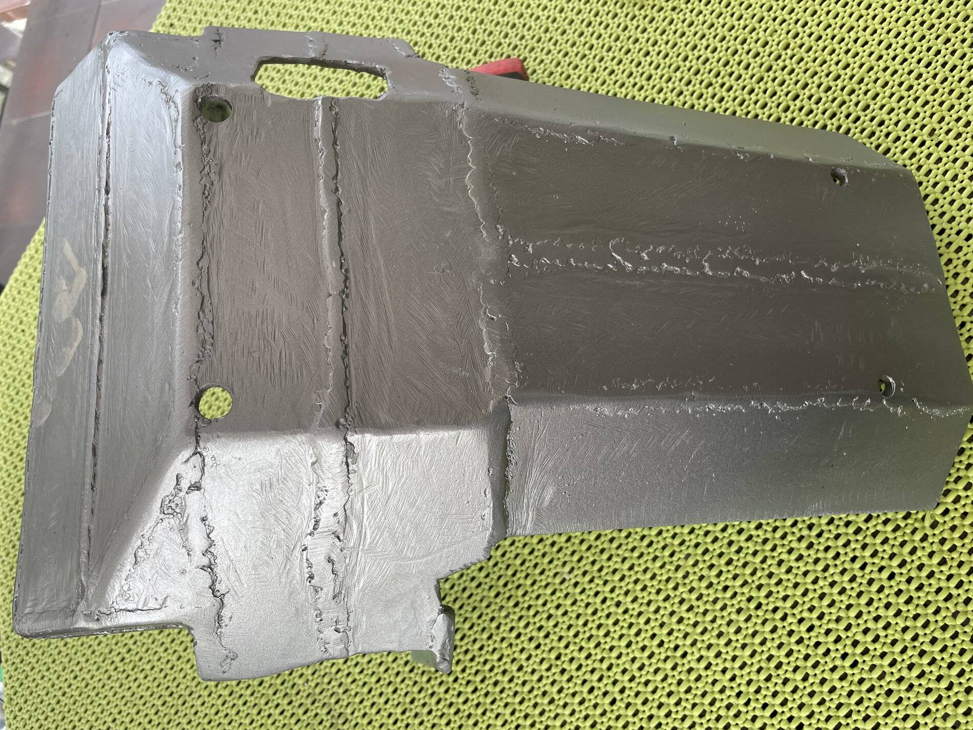

Pre install pics. I’ve decided to go with custom paint ? so I’ve mixed black and silver as a top coat over a base of zinc paint. I could have dressed the welds and splatter on the inside better, yet it was not easy to grind there with the angle grinder. Flux welding seems to be an art I do not master yet. Anyway, I am satisfied with this little project.

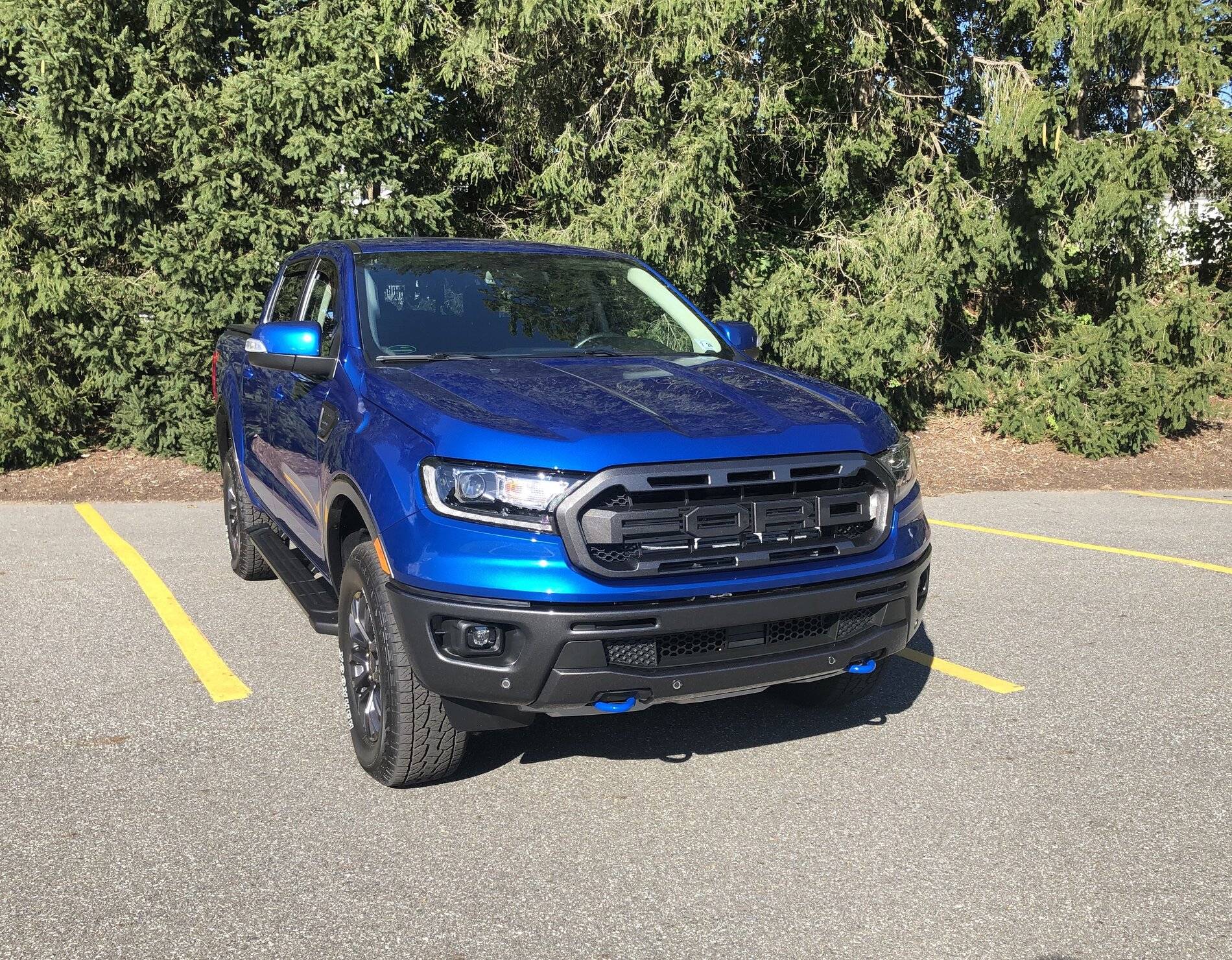

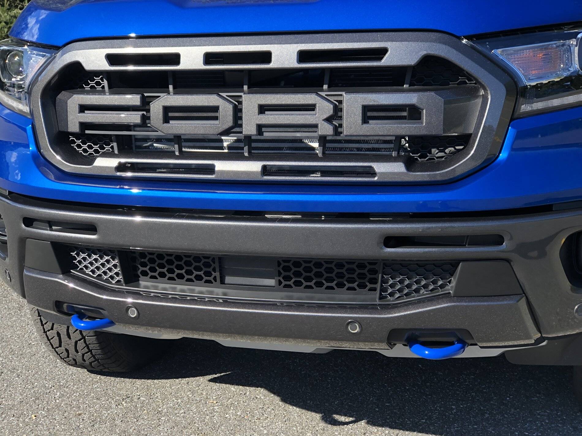

I installed my new Raptor grille, lower valance, sensors and rings that I had painted Magnetic. Also added a Putco lower insert. I sanded the silver putco logo, scuffed the rest of the grille and painted it with a few coats of SEM trim paint. Also threw on a set of Weathertech in channel window visors. Now she just needs a good wash.

Great looking color combo with the tow hooks!

Looks great, Tony!
