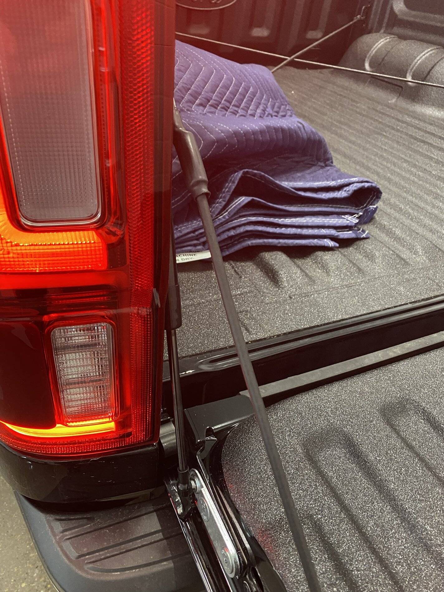

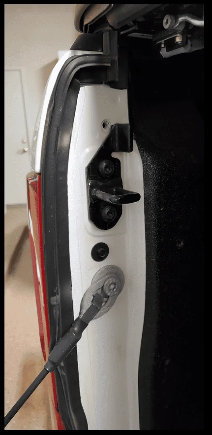

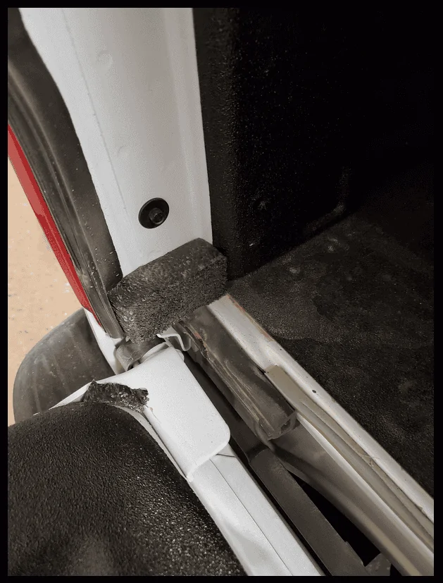

Yes, ingenuity with a few hours of brainstorming . . . and ignoring the instructions.
I found the odd shaped lower corner gaps most difficult to fill. Including the gap behind the hinge plates.
Together with some closed cell foam packing blocks and weather seal from Home Depot, I used pieces from two packs of this ESI Ranger specific seal.
ESI Ultimate Tailgate Seal with Taper Seal Compatible with Ford Ranger 2019 and Newer
After several small test fittings, I ignored the instructions, then cut and installed the pieces for a better fit.
I put the seals on the outer edge to keep dirt out of the latch mechanisms.
The Home Depot seal works great across the bottom except at the ends where the tailgate corners are rounded. I used the thicker blocks there.
I still have a few small holes which I may fill with caulk.
Prior to delivery, my dealer installed the Ford damperer thingee. Never cared for the way the tailgate cable gets crunched. After installing the seals on the outer edge, had to remove the damper, not enough clearance.

Cool. For the hinge gap, I too am trying silicon caulk. It's not meant for larger gaps, but as you said, to hell with instructions. I filled in one side and waiting to see if it sticks.

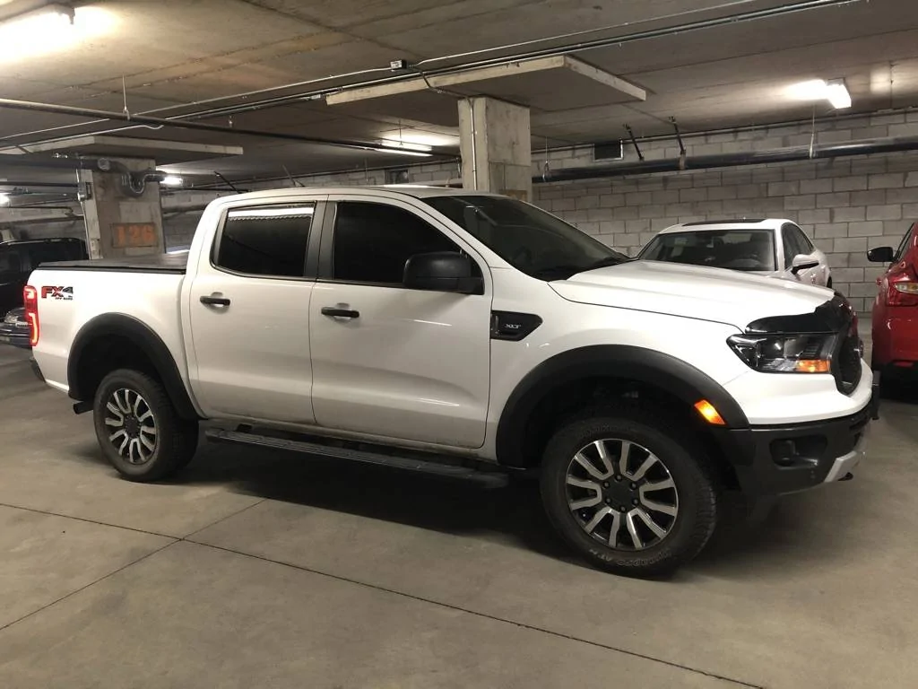

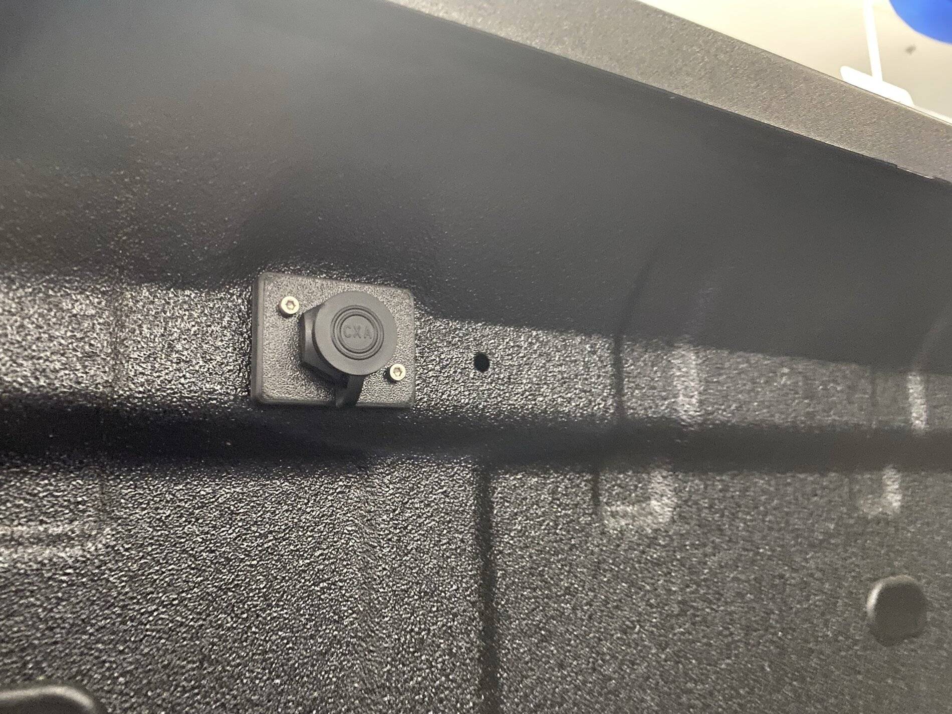

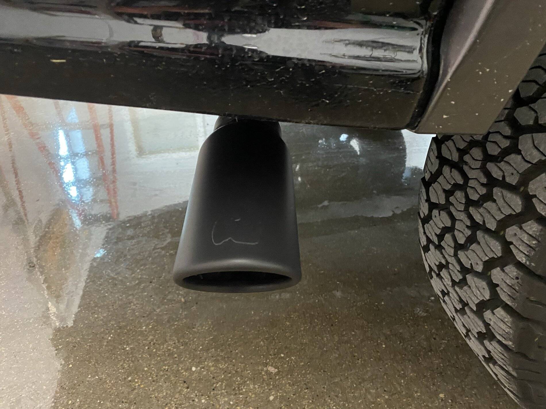

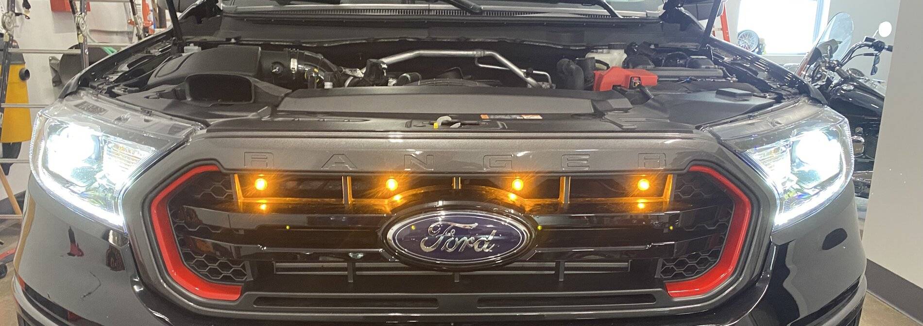

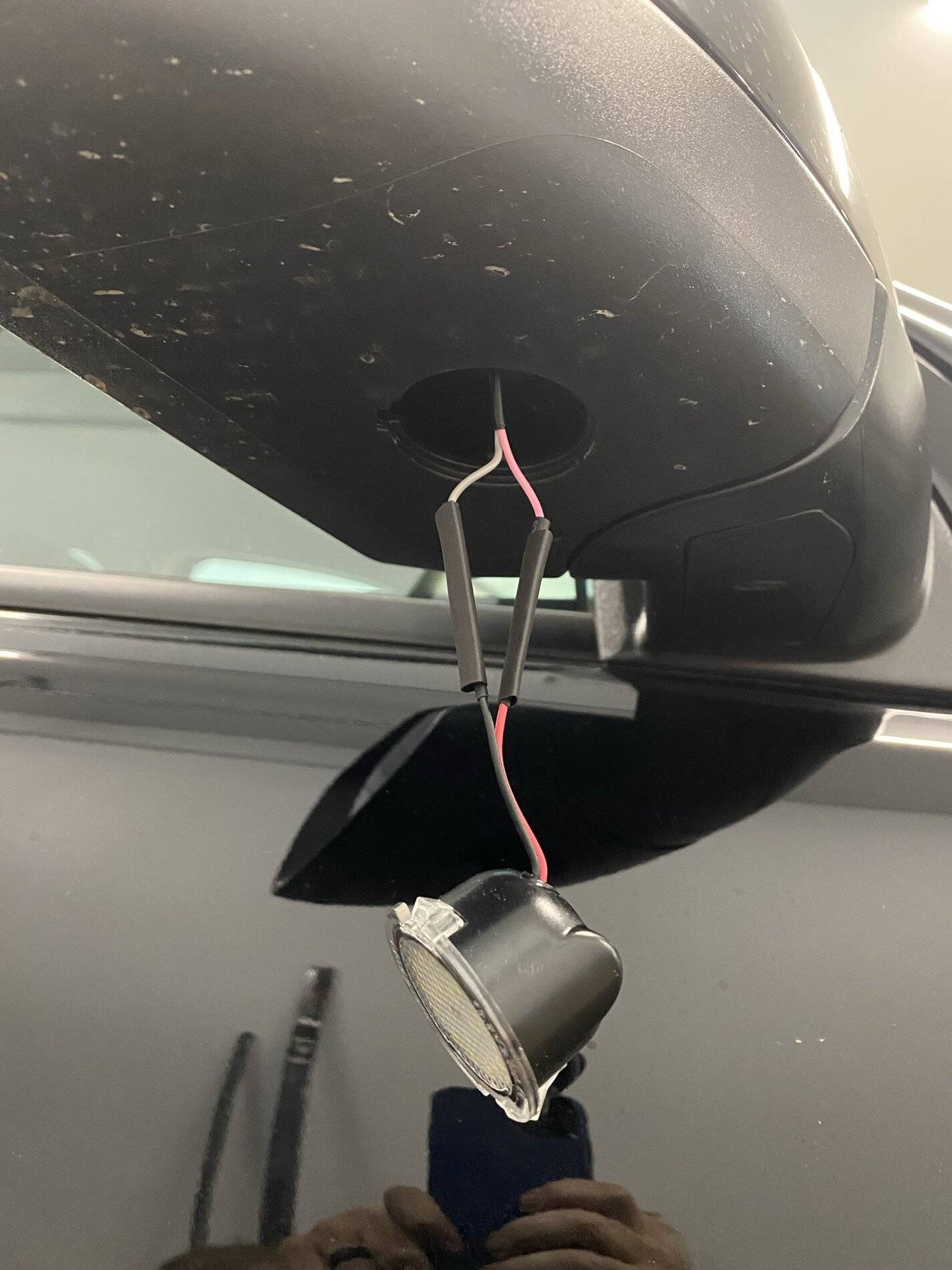

A busy weekend and a new truck … LOL! Have to have the Tailgate dampener, grill lights, Rhino exhaust tip, bright puddle lights, Wolf Haus split power ( bed lights and inverter coming), console organizer.
that’s all for now … ?

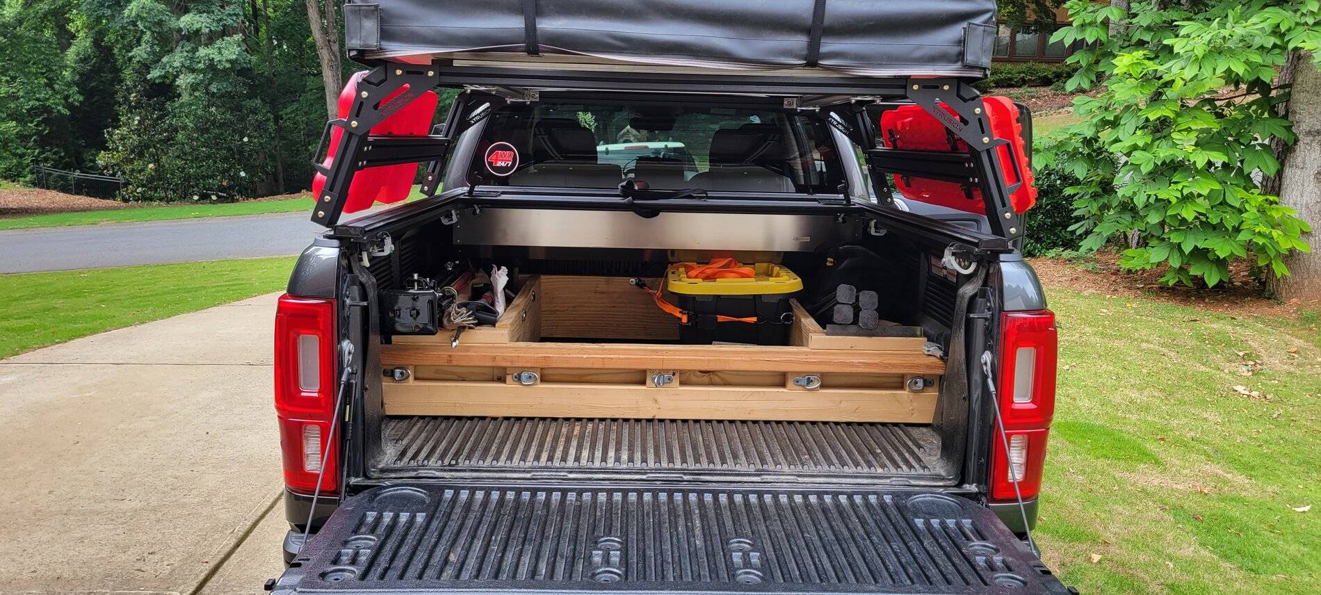

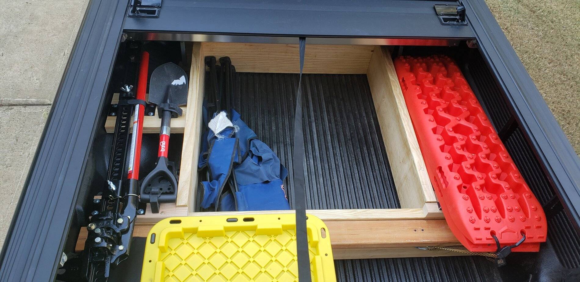

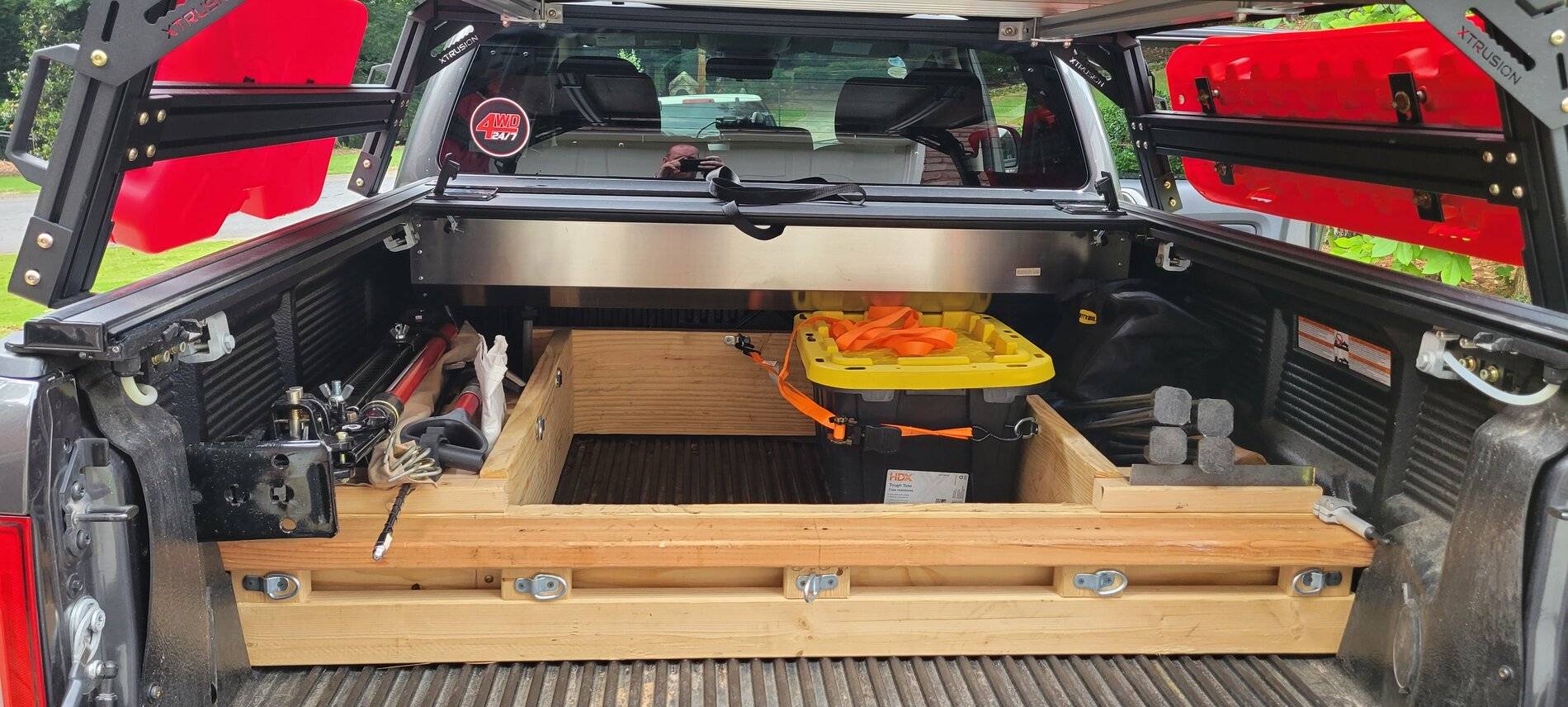

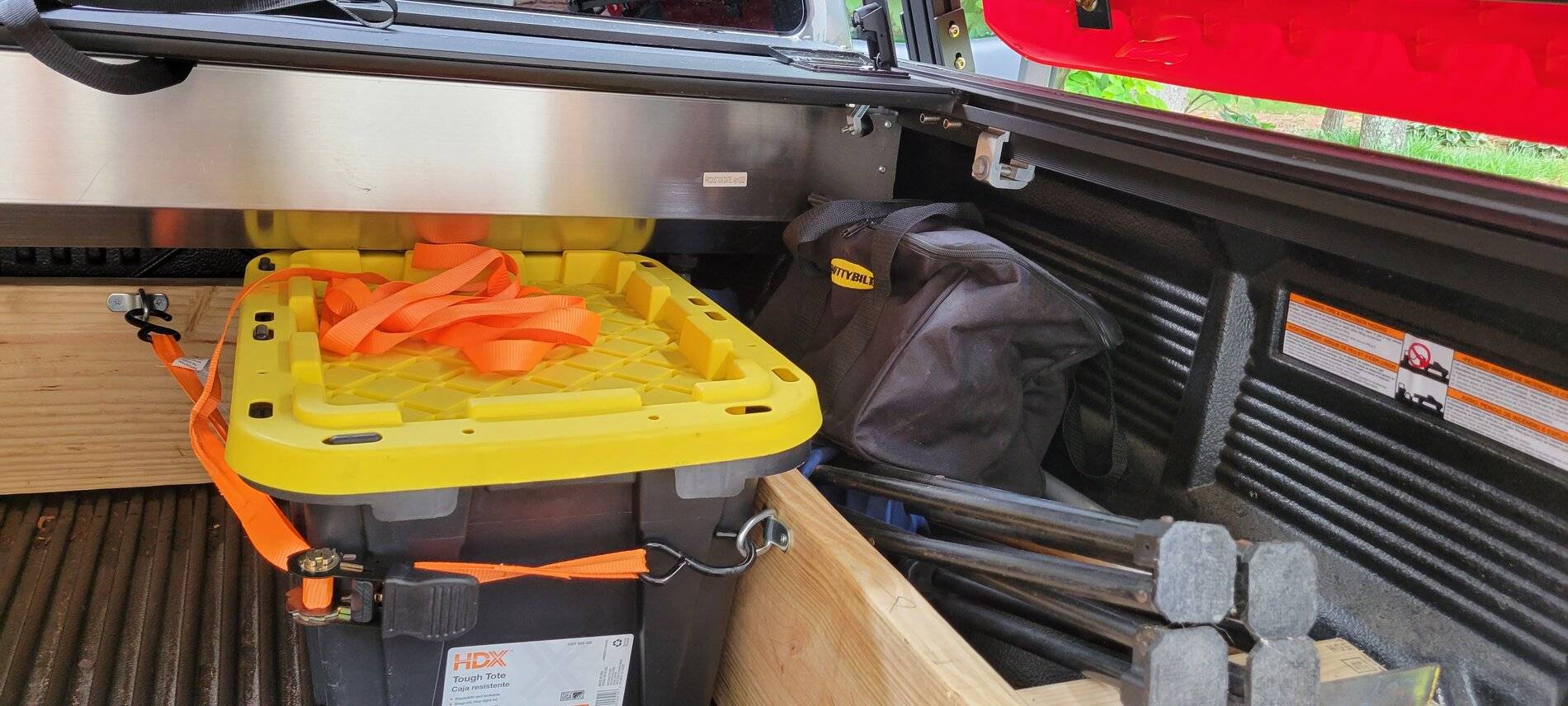

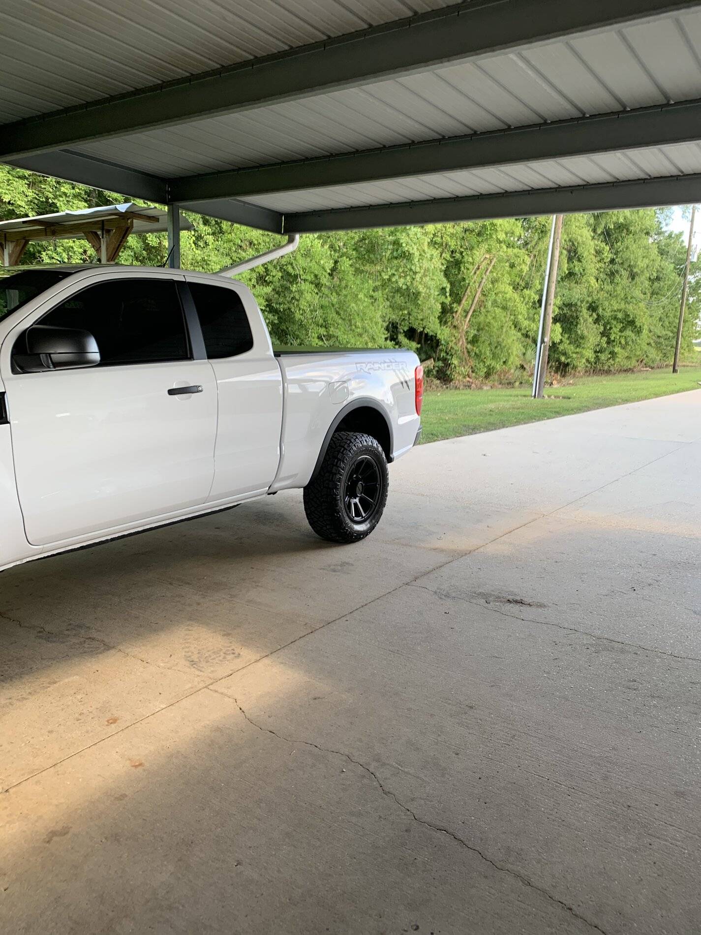

Just a little update on this seemingly minor little switch-up:
Moving my big, heavy recovery box closer to the front of the truck actually made a really noticeable difference in how the truck felt over speedbumps. It wasn't as bouncy and didn't jar me. There is a bridge I have to drive over on the way to the lake and after I put the add-a-leaf on the truck, it felt like the rear was getting airborne over the bridge. I would always forget to slow down and experience it and get a little annoyed. I forgot it this past Saturday but the truck was much smoother with the weight redistributed. WIN!
Before:
After:
