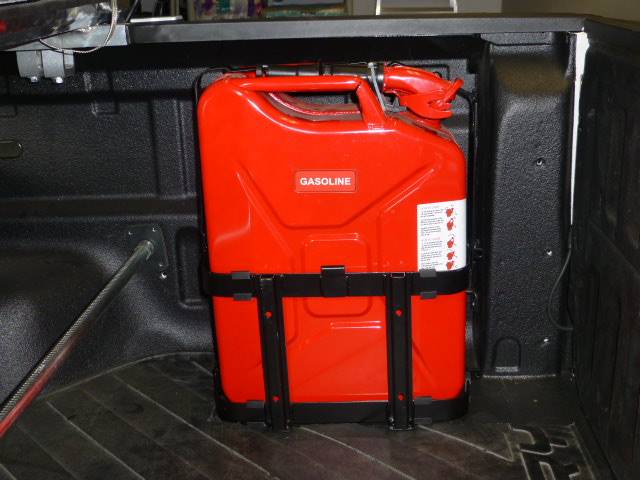

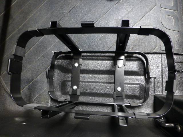

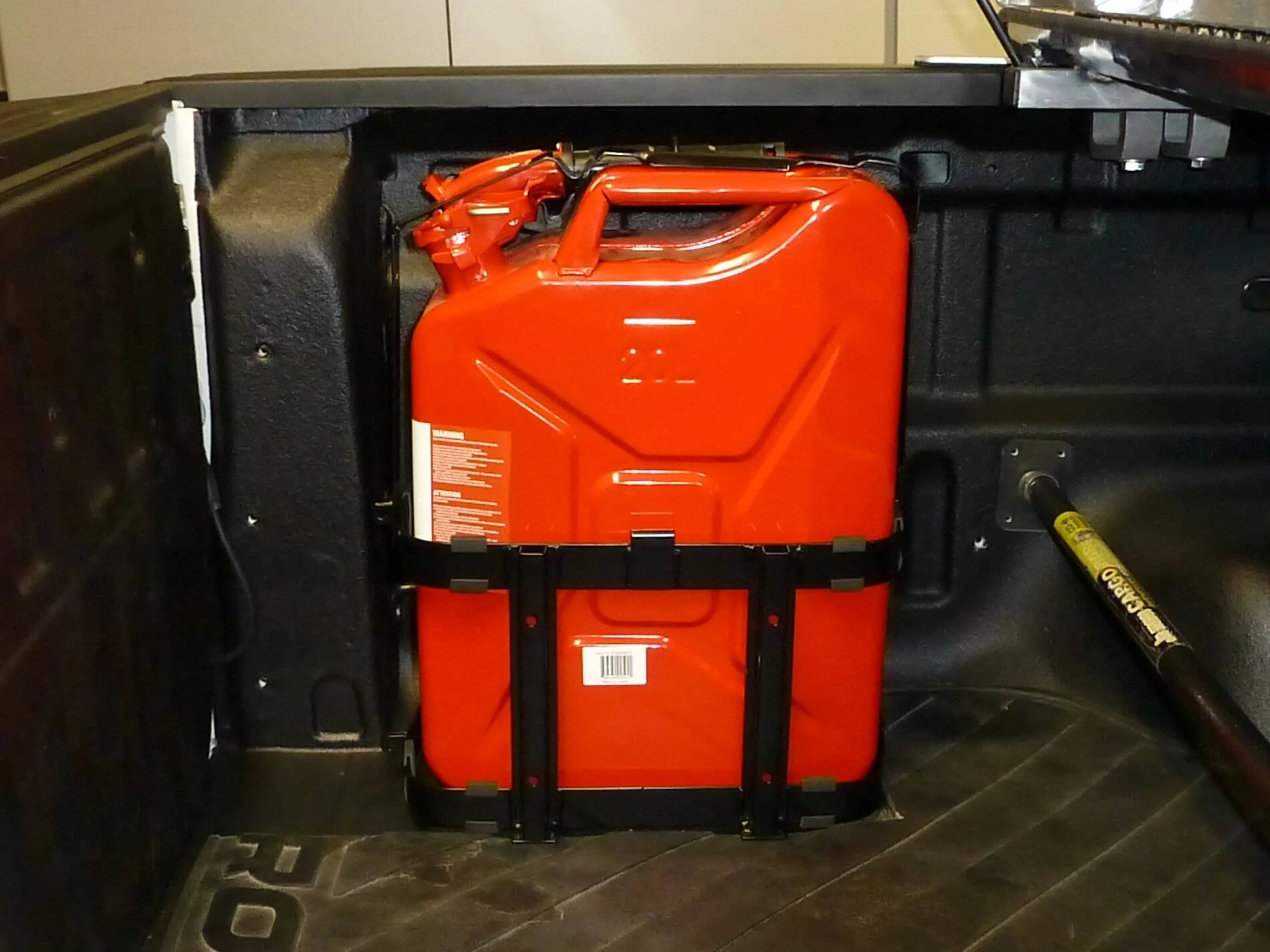

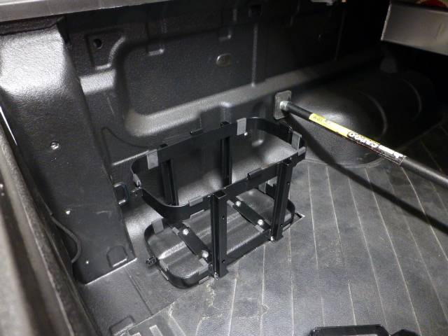

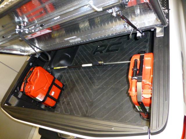

Installed 2 Wavian 5-gallon Jerry Cans.
Parts list:
2 ea. - Wavian Jerry Cans.
2 ea. - Smittybilt p/n 2798 holders.
8 ea. - ¼-20 stainless steel rivet nuts set in the truck bed aft of wheel wells. Used a 5/32” drill for pilot-holes, a 23/64” for the rivet nuts. Nuts were installed with an Ares Mod. 70418 Rivet Nut Setter.
8 ea. - ¼-20 x ¾”L stainless steel hex bolts.
8 ea. - 5/16” stainless steel split lock-washers.
I used the rivet nuts so, if cargo necessitates, I can simply unbolt the holders with a 7/16” socket wrench, and then reinstall, all without crawling under the truck. A 10’ RevX Mega+ siphon hose can move the fuel from the cans to the tank. Cans are secured under a locking Diamondback cover.
