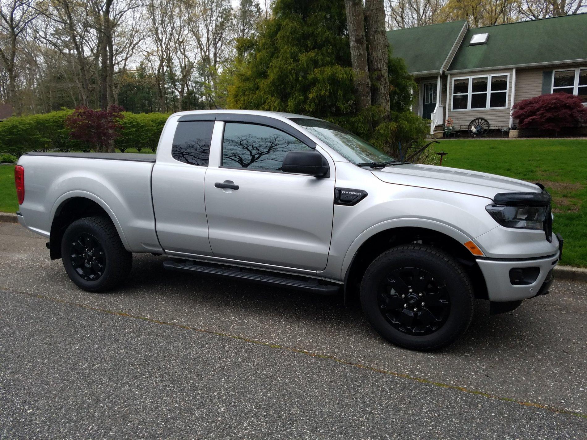

The vinyl between your driver window and rear passenger window is just a sticker and is painted blue underneath. Both sides obviously.
I haven't decided if I wanna remove that or not. Gotta see some more pictures of it I guess. I don't want to regret that one.

Just use a hair dryer and some patience (peel 'em slowly) and they'll come right off. Or let it sit in the hot sun for a few hours - has the same affect.
Yep that's what I did. Can use a heat gun, but a hair dryer on low would be much more forgiving. Use a plastic credit card to get it started if needed. I use 50/50 iso alcohol with water to clean the area afterwards. Then your choice of wax/sealant on top for protection.

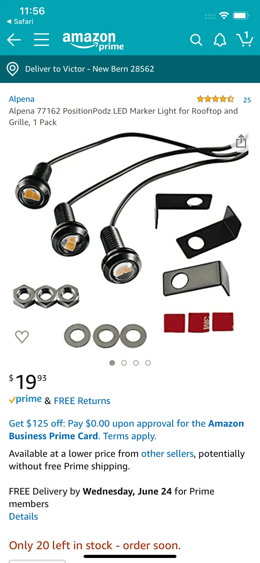

Wow $20! I feel cheated.
I paid $93 for the ones from Stage 3.
How was the Installation?

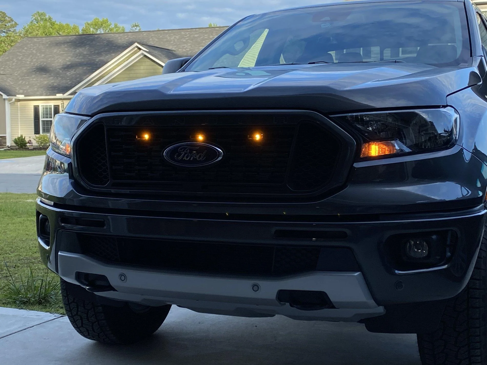

Totally! I was going to buy the one from Stage 3 but someone mentioned these from Walmart/Amazon and bought them. The install wasn’t bad at all. I took my time but in less than an hour they were wired up and mounted. I used the supplied angles and 3M automotive tape. I did add some spacers to get the base of each angle to bond to the radiator plastic duct/fairing. Wire them up in parallel and tap into the positive cable from the side marker. Ground the negative side and done.
