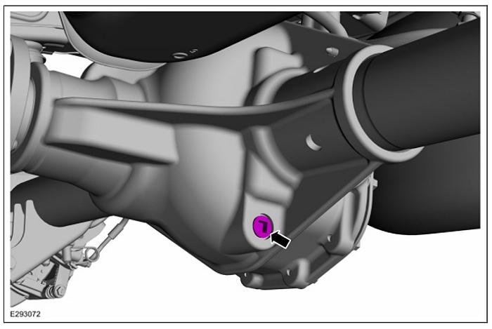

The drain for the Ranger rear axle is not in the cover.
It's in the differential housing.

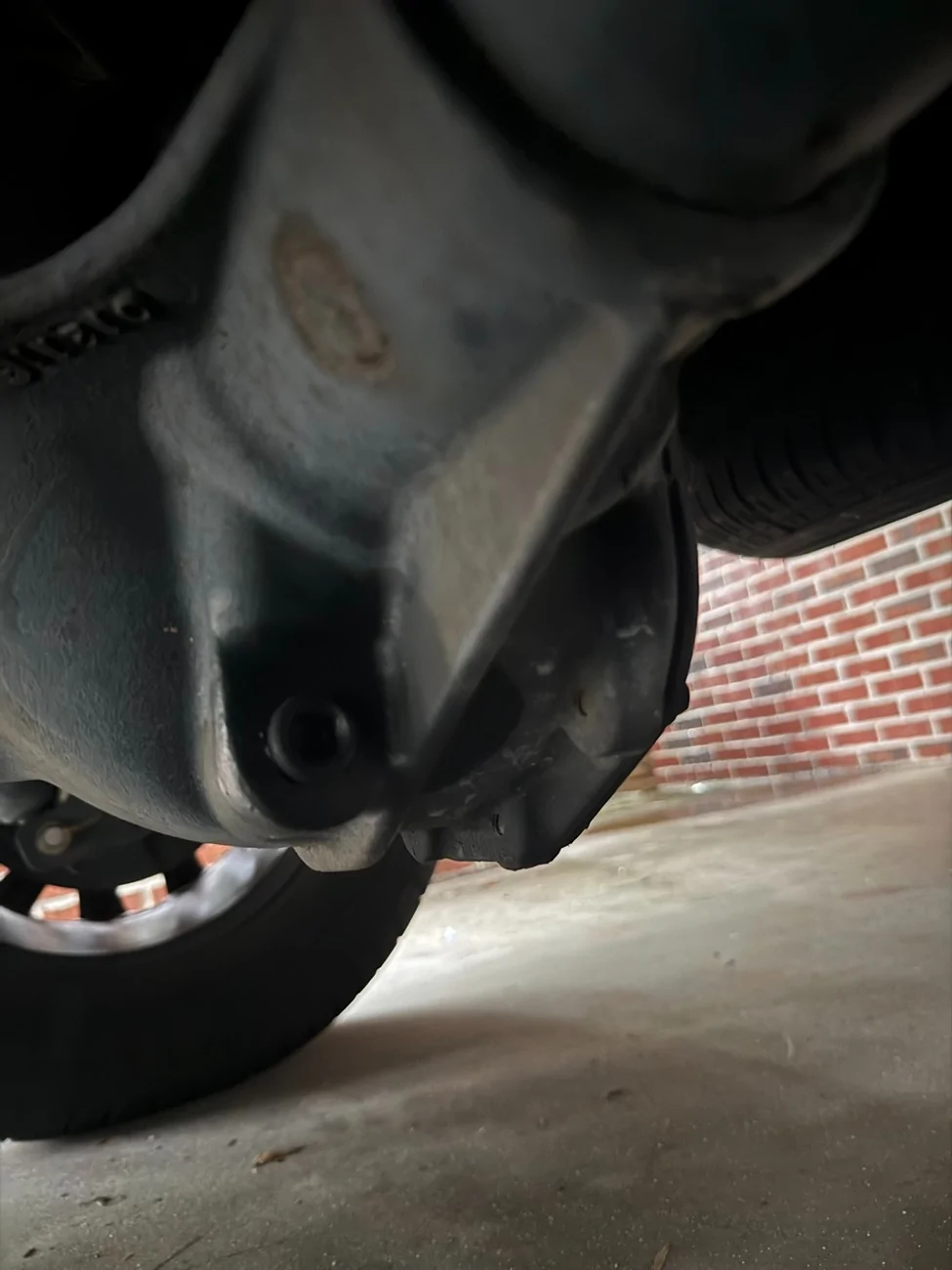

Yes it is on the '21 XLT. The '22 XL does not have a drain. I was disappointed that there s not a drain. Popping he cover was the drain method. It was pretty clean for 134K miles.

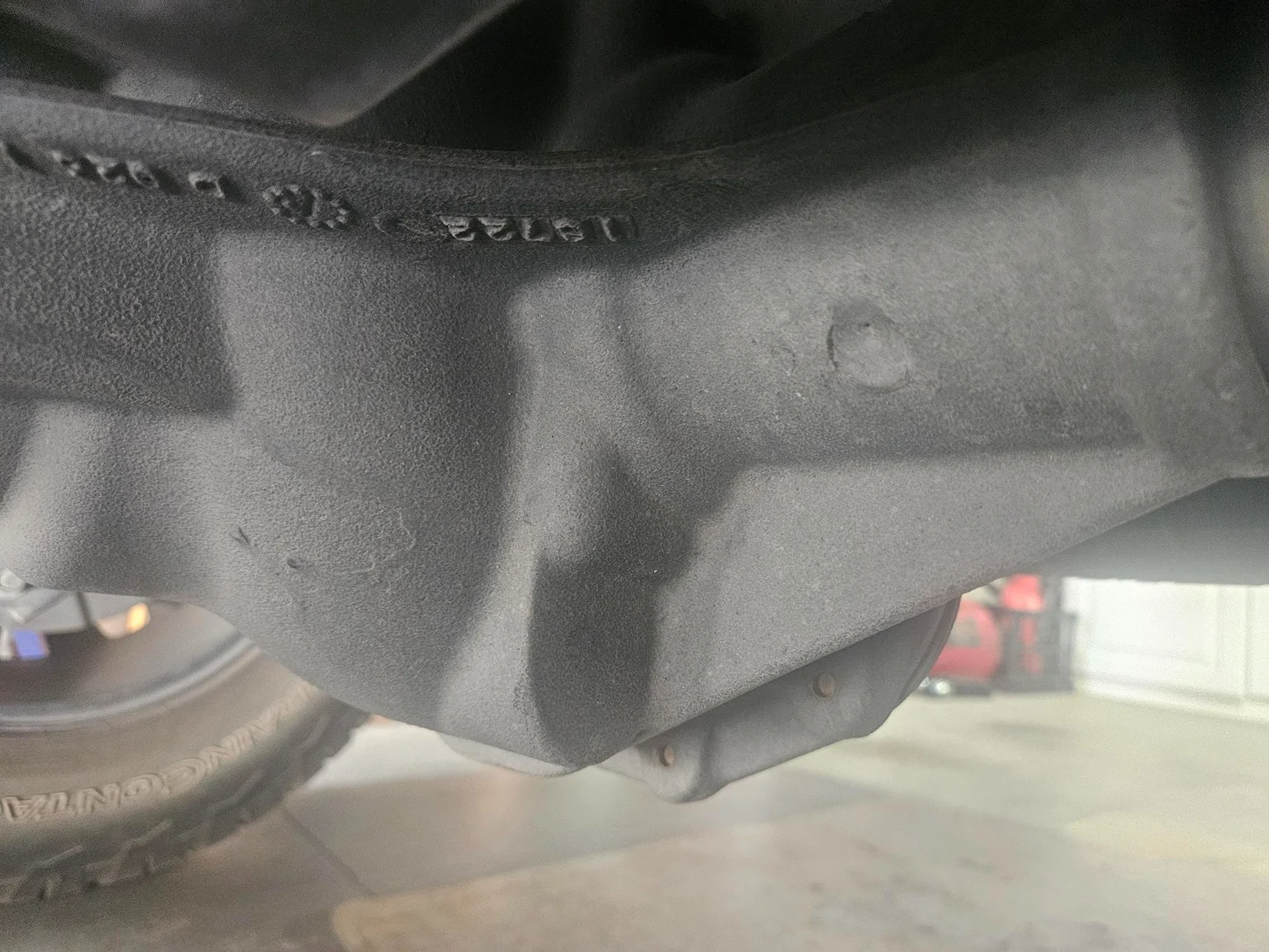

My 22 has the electronic locking axle, no drain plug.

My "21 is FX2. Does your differential have a drain?
My '22 FX4 has no drain plug in the casting. Oops, forgot to add that above.
