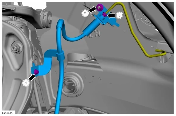

I am assuming you are talking about this
I cannot find specs on Thread Size, but did find the Hard-Line P/N that joins the Flex Hose
I tried Google searching specs on the part number - no luck
Colo_Ranger
Apr 19, 2021
3,801
12,923
2021 Ford Ranger XLT FX4
You are a god among men, my friend. That's the part. I'll call my dealer and see if there are any around town.
