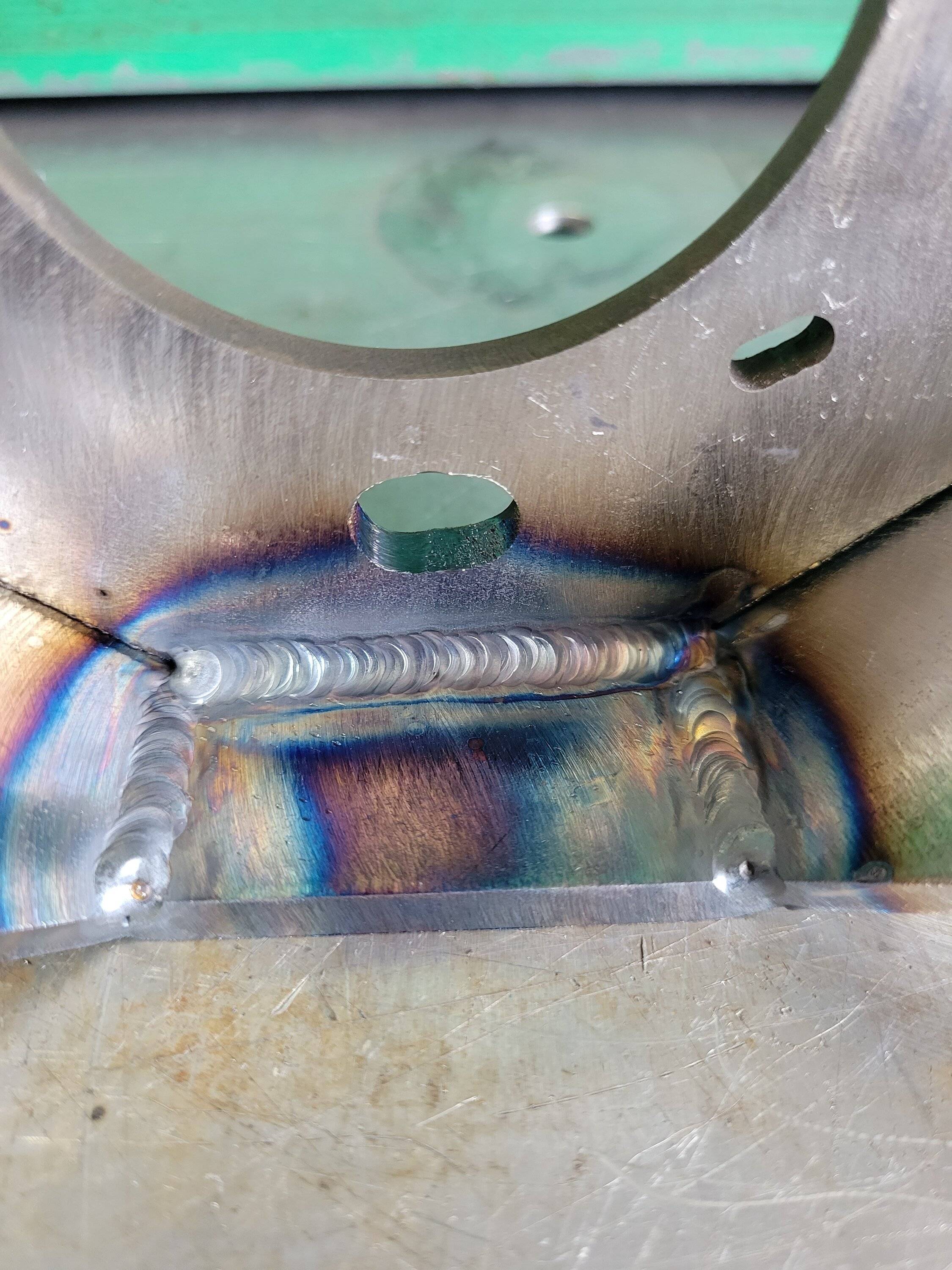

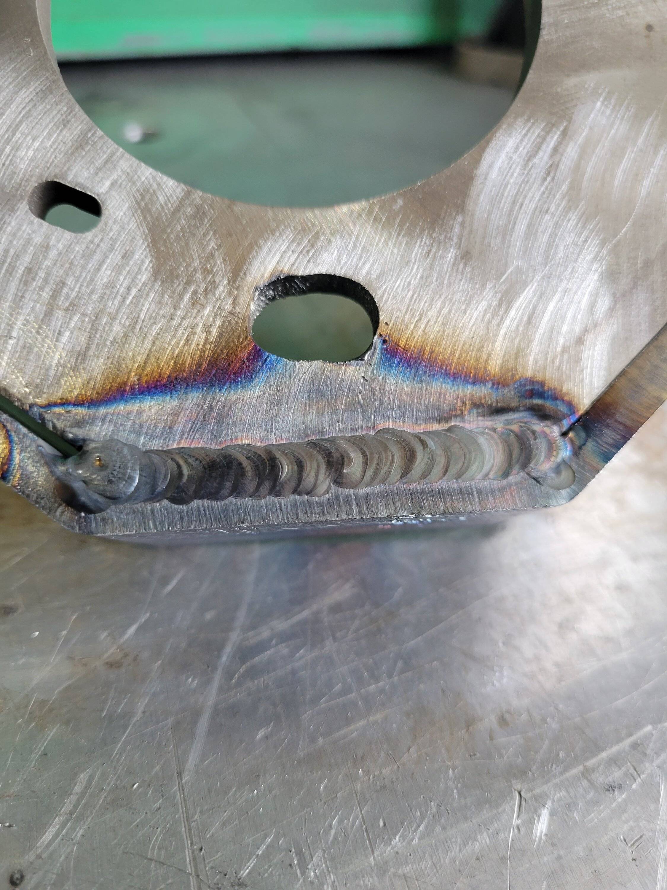

Started on the second one already. Its still pretty early might just get them installed today. Fyi im running 130 amps with a 2 percent thoriated 3/32 tungsten using 1/16 filler, number 7 cup. The material that is being used is 1/4 cold roll steel way thicker than oem.

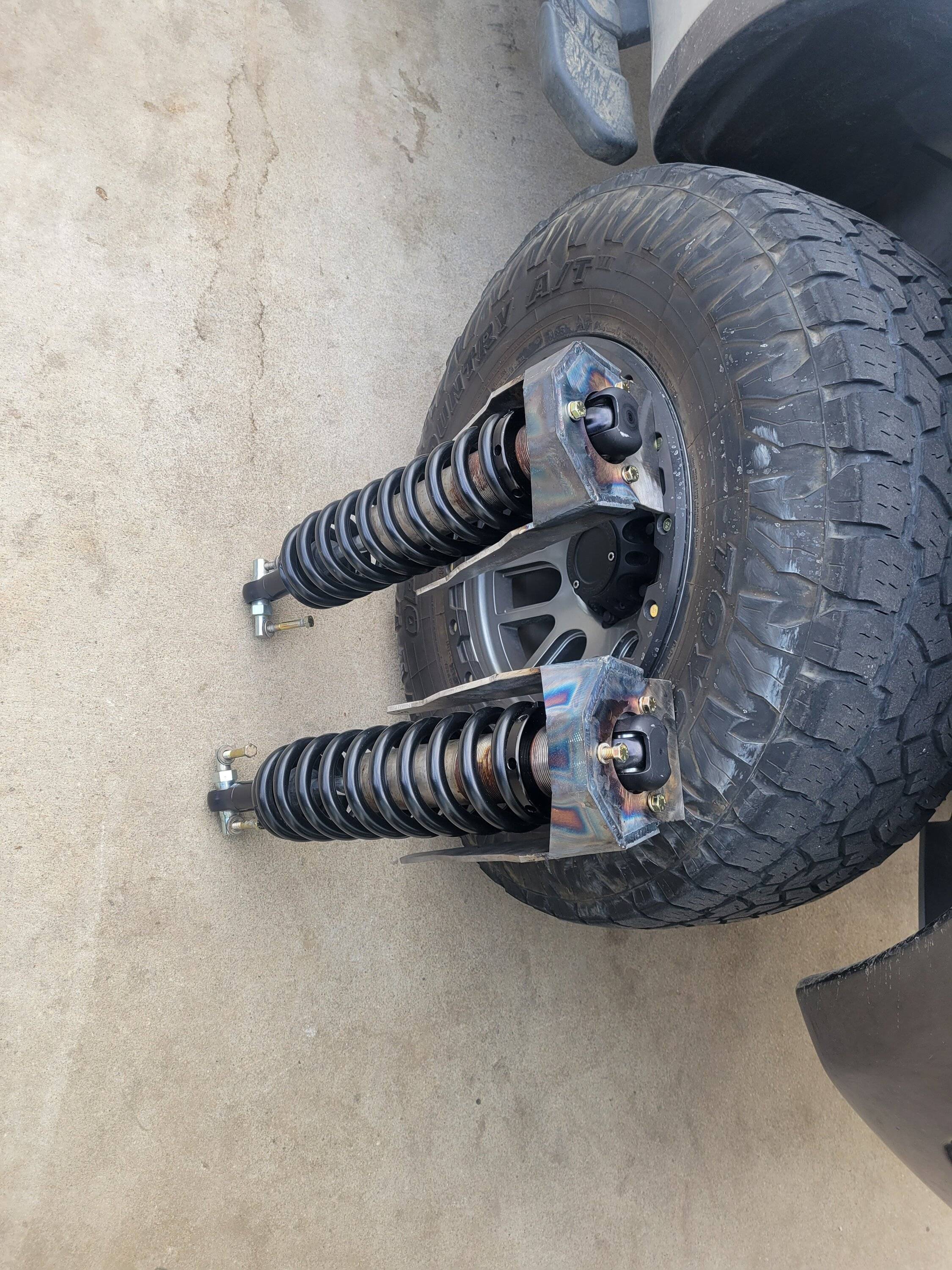

Well thats 2 of them done. Just realized i don't have any more flap wheels so will have to wait until the weekend to cut my truck. Anywho both towers are now done. I still need to paint them with steel it
