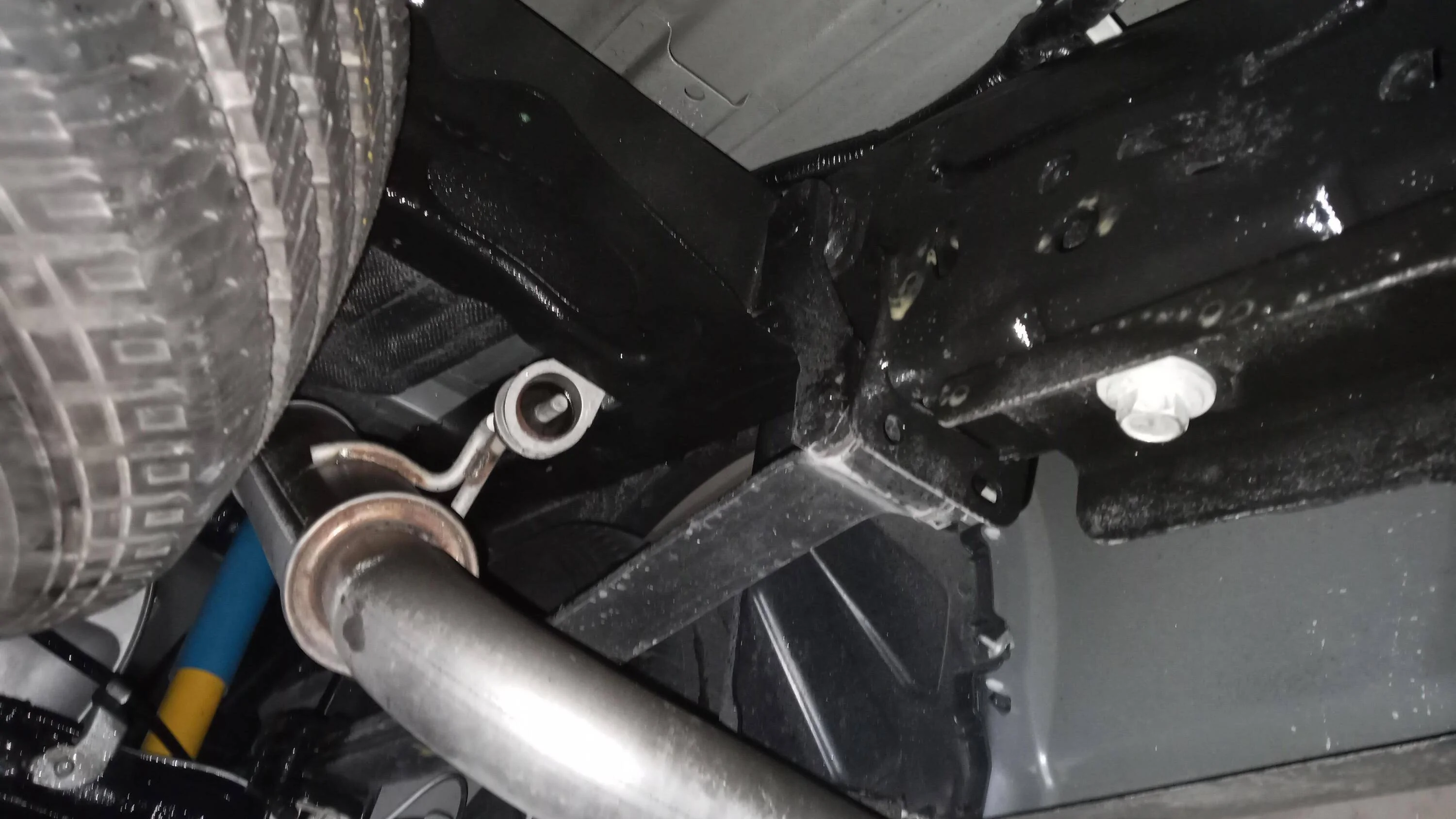

Fluid film, My favorite stuff.
Didn't get everything as I don't have a lift. Weld seams and sections where surfaces mated and such were my main goal. The flat areas of the frame can just be sanded and repainted if need be.
Besides, I rather not have FF rub all over me during oil changes..

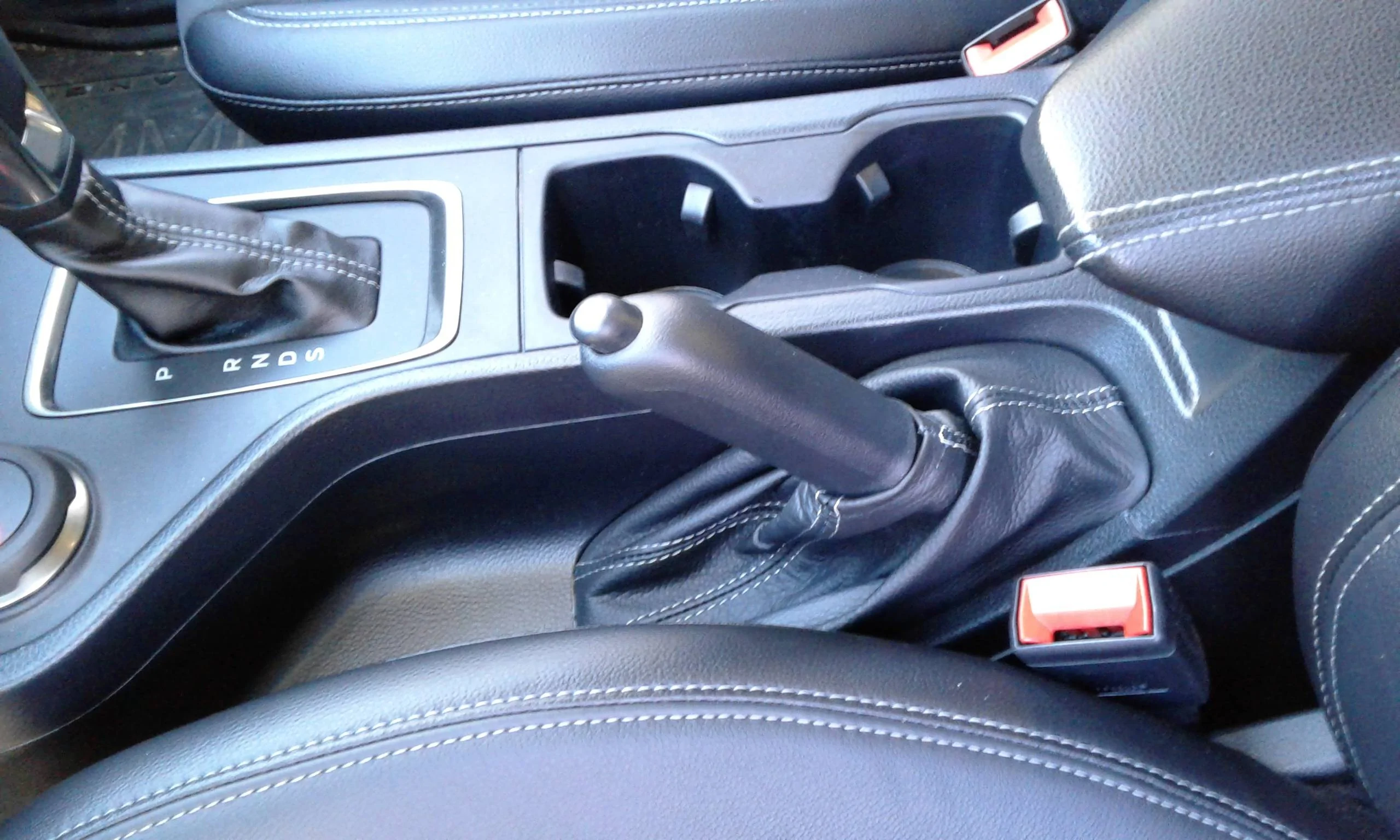

Added the tailgate dampener, and the Redline leather hand brake boot. Will add review, part numbers, links to purchase etc., on my build page.. also found out something interesting about the hand brake.

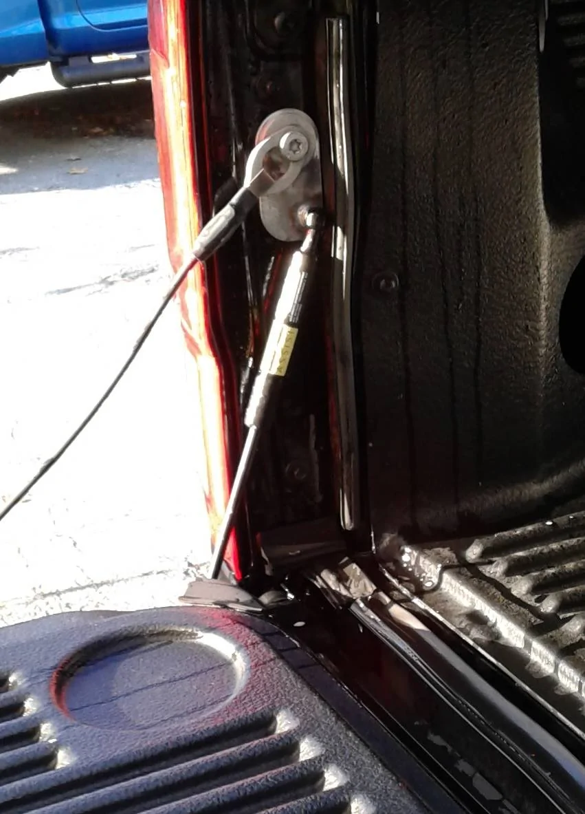

Better late than never....Welcome to the club Frank! ?
Btw there's a thread for damper mods here. Yes you need a mod for a mod. ?

I've read about binding issues, but haven't noticed any... yet. And thanks for the virtual shirt, I'll be sure to wear it on casual Friday's.
