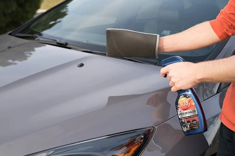

David try using a clay mitt. They're much easier to use and cover a larger surface. Plus if you drop it you can just rinse and continue on where as a clay bar is ruined once dropped. Do the "baggie test" which is while the truck is wet take a plastic sandwich bag, put your hand inside and rub the panel you're about to clay. If it feels gritty then clay that panel, once done re-test with the baggie and repeat until smooth.
I use a speed detailer (any will do but of course I use 303 :shock:) for lube and spray it on the panel very liberally, more is better. Then take the mitt and go over it lightly in an up and down or side to side motion, just don't go in circles. Don't use any pressure just let the mitt do the work. It's really easy to do and following this it's hard to damage the surface unless you either apply to much pressure of use to little lube. I used about a half a bottle of speed detailer (probably to much but better safe than sorry) and it took me under an hour to clay my Ranger.
Here's the clay mitt I use. Once done just rinse it off, let dry and store in the package it comes in.
https://www.goldeagle.com/product/303-contaminant-removal-mitt/

Thanks for the link and I think I have an email coupon from Gold Eagle for free shipping. So you use the mitt with the Speed Detailer! Ah, I was thinking you use it with a soaped up truck.
I spray the Graphene directly into my applicator for no over-spray but you spray the detailer on the panel. Hmm, I shall give it a try.
Thanks!
PS - Kate will, undoubtedly, go bananas with a clay mitt! =D

You can use it with the soap (or ONR as John said above) but the speed detailer gives you more "slickness" and less chance of scratching the clear coat.
Yes spray the panel down then clay. Baggie test until smooth.
Kate will love it because she can use the whole bottle and it's really not going to waste. :p
