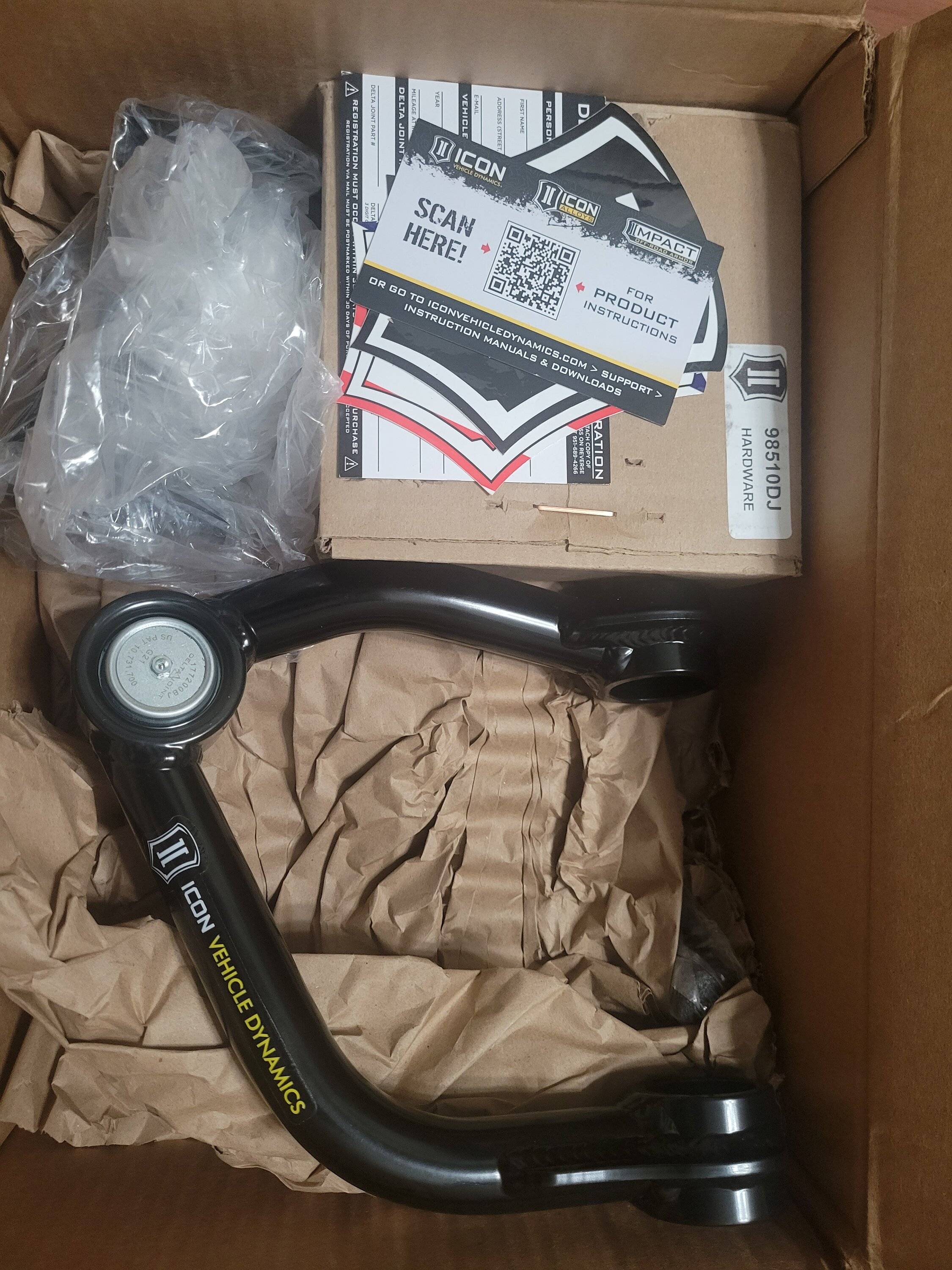

got home from six flags to find these arrived will be installing this weekend.
