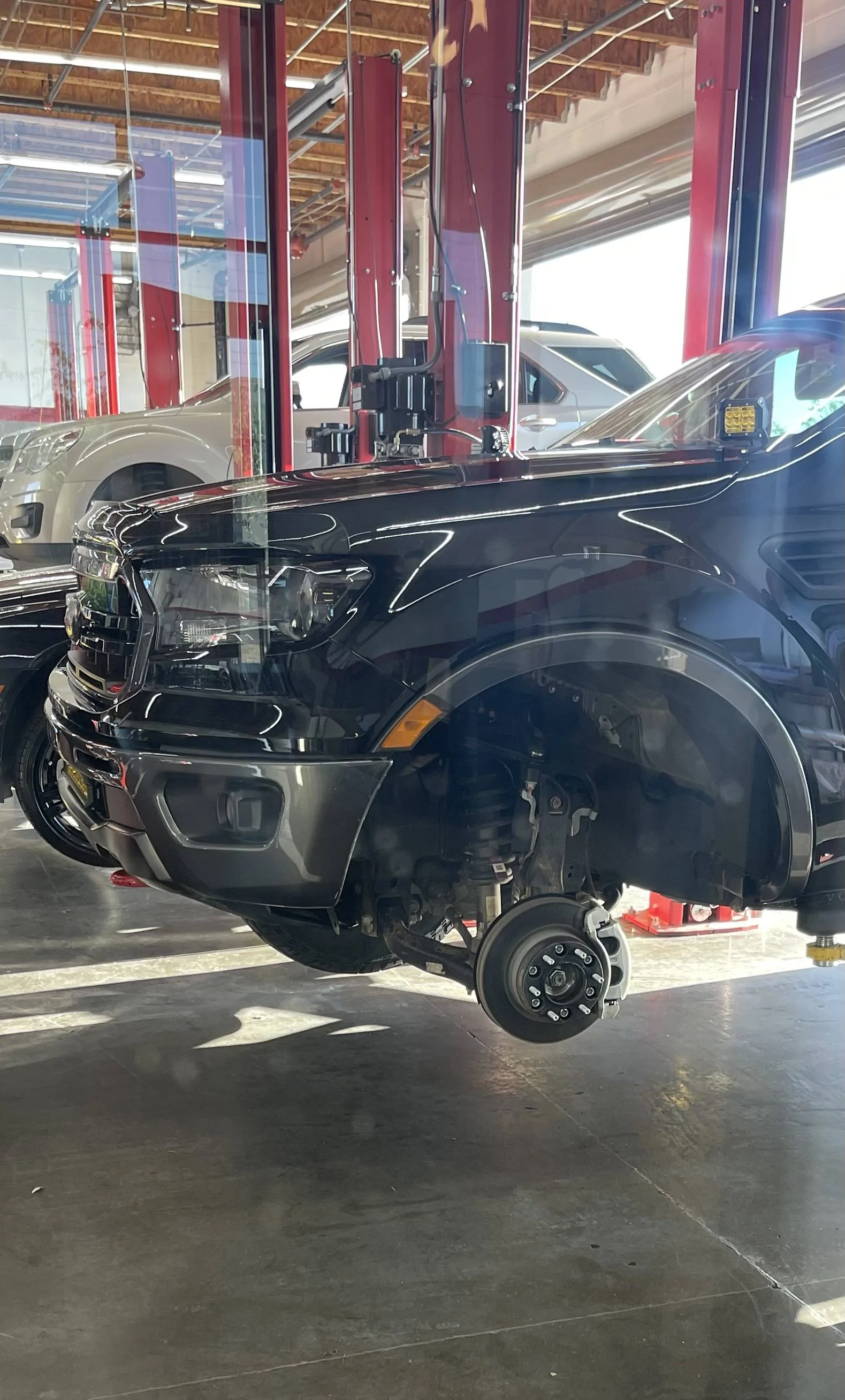

Finally got around to this...
Currently running eibach 2.0 in front and rear, Icon tubular upper control arms, and readylift anti-intrusion bars.
Wheels are KMC KM718 Summit 17x8.5,+18offset
Tires are Falken Wildpeak AT3W 275/70R17
Visually - very pleased
Audibly... something is left to be desired. I've had two techs (one is the guy who installed them) agree the upper control arms are unacceptably loud and creaky sounding anytime the suspension articulates. I was there for the install, I know it was done properly, and the second tech (wasn't there for install) agreed, and also attempted to correct the issue himself and could not. Apparently there isn't enough grease on earth to make these things operate quiet and smooth ?‍♂?
I opened a ticket earlier with S3M. Hoping to get some resolution.
Anyone else have issues with the Icon Tubular Upper Control Arms (Steel Knuckle)?

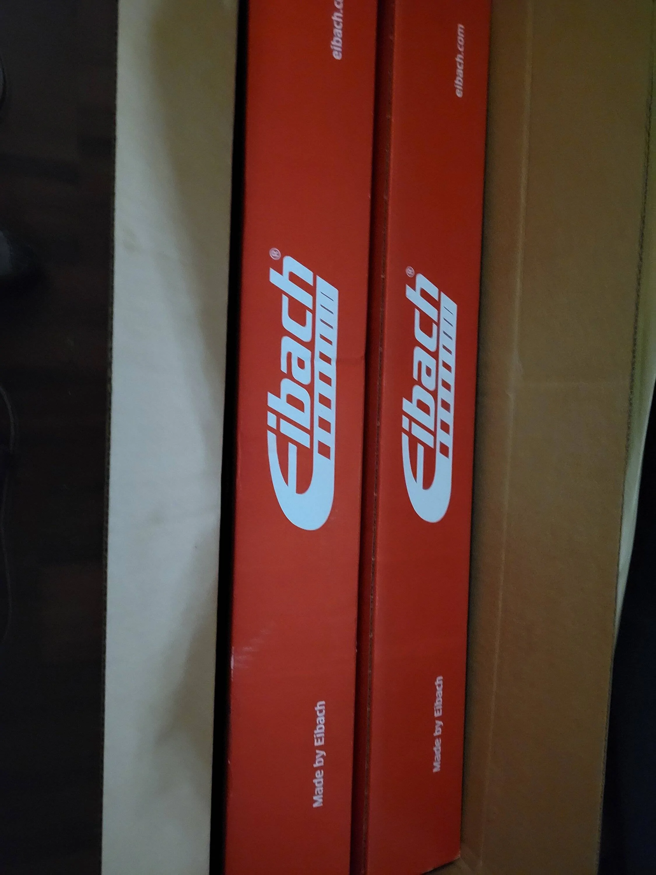

f150 rear eibachs showed up today. will install on the ranger this weekend.

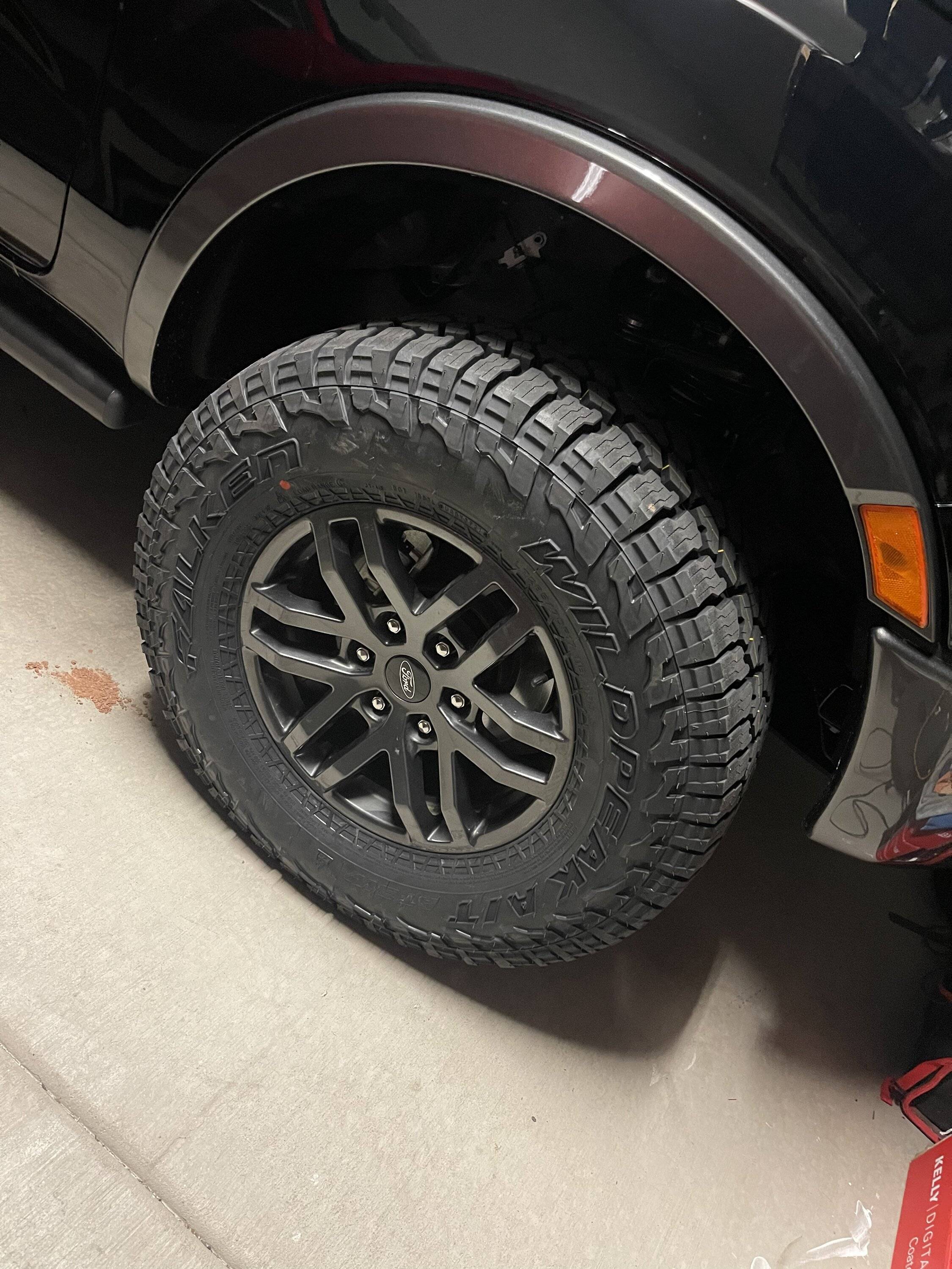

wheels and tires today!
method 701s in bahia blue! 17x8.5x0
falken wildpeaks 275/70/17s!
both front and rear intrusions bars were replaced with bds before anyone ask lol
wheels look great! i like how they are clean without all the fake bead locks and extra decorative rivets etc.
