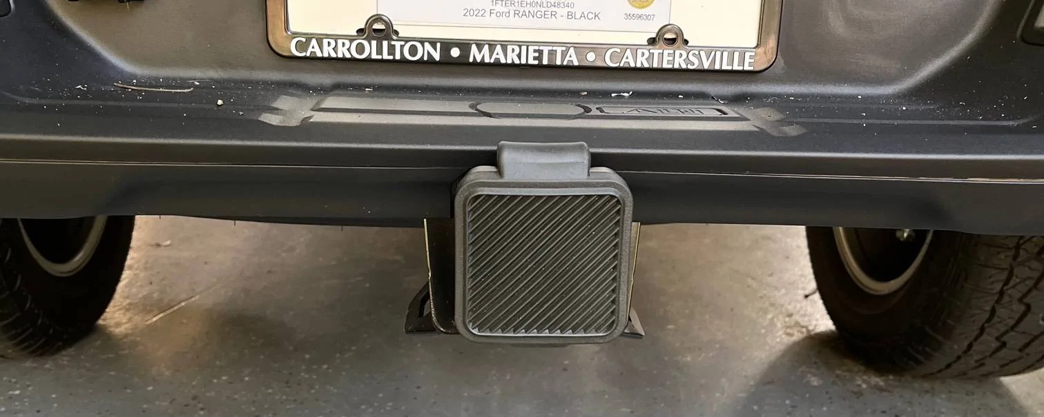

Installed the Trailer Hitch Cover Plug/Cap. Nothing fancy, just functional.

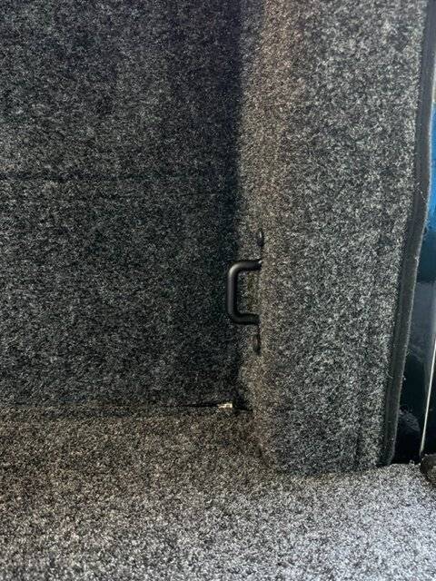

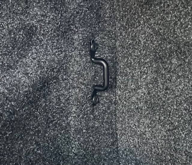

After installing the trailer hitch cover/plug, installed the BedRug.
I decided to mount my tie downs on the exterior, rather than have them poking through the bedrug.

Good call, I think. That's a clean look for sure.

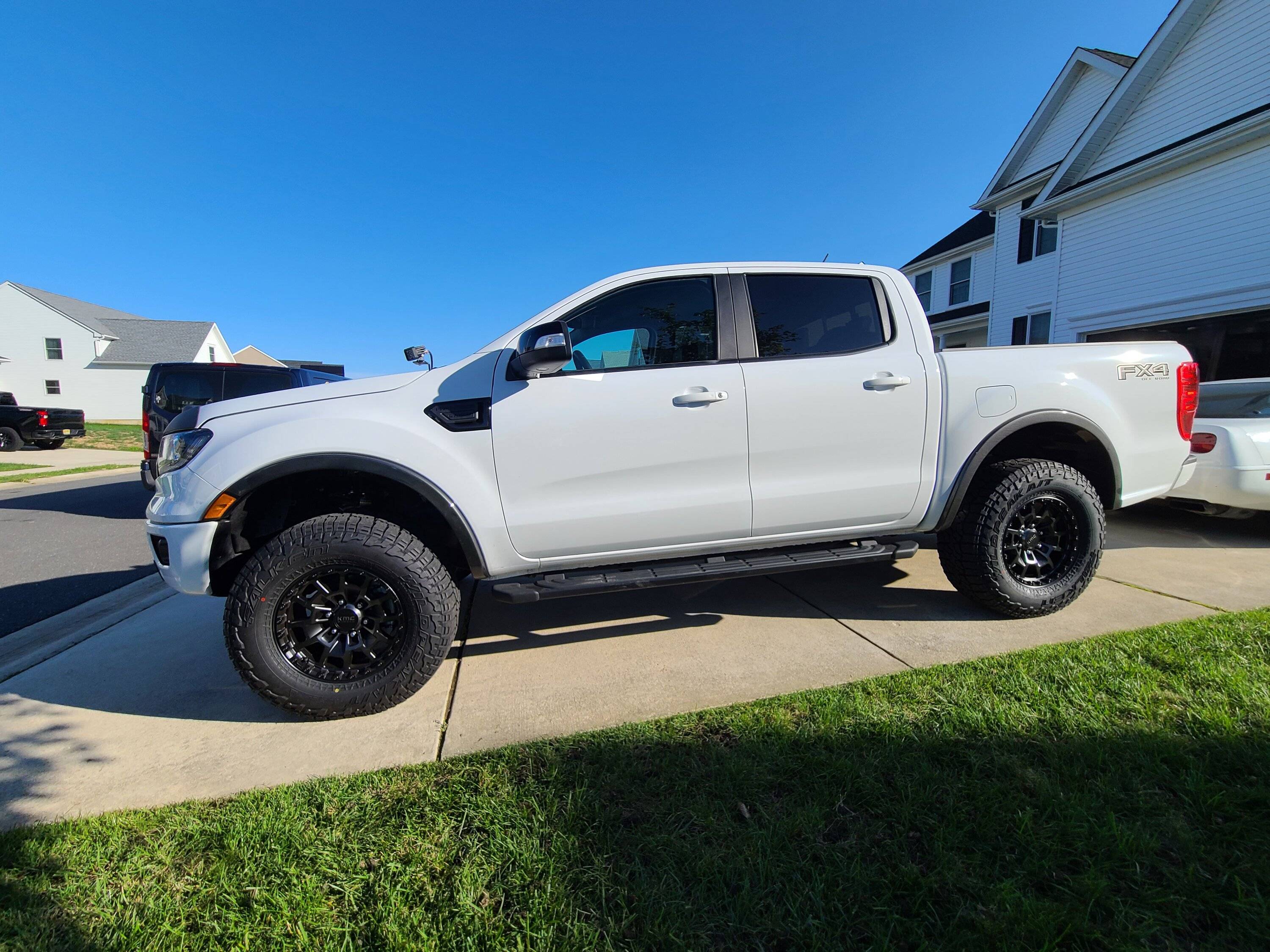

Finally got around to this...
Currently running eibach 2.0 in front and rear, Icon tubular upper control arms, and readylift anti-intrusion bars.
Wheels are KMC KM718 Summit 17x8.5,+18offset
Tires are Falken Wildpeak AT3W 275/70R17
Visually - very pleased
Audibly... something is left to be desired. I've had two techs (one is the guy who installed them) agree the upper control arms are unacceptably loud and creaky sounding anytime the suspension articulates. I was there for the install, I know it was done properly, and the second tech (wasn't there for install) agreed, and also attempted to correct the issue himself and could not. Apparently there isn't enough grease on earth to make these things operate quiet and smooth ?‍♂?
I opened a ticket earlier with S3M. Hoping to get some resolution.

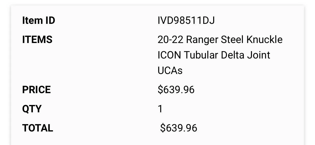

Anyone else have issues with the Icon Tubular Upper Control Arms (Steel Knuckle)?
Oh... side note, no picture, but I also installed redline's gas struts for the hood... now all I need is an engine cover and it'll be like I bought my truck 2 years ago ?.
i have those UCAs and I get no noise at all. Quiet as a church mouse.
I like it, at this stage most of what I seem to move is furniture and boxes, and this seems the perfect solution. I always have the option to LineX coat the bed under it if I would want as well.
It turned out pretty good, although I feel like the ‘wings’ on the back posts where the tailgate shuts could be about 1 inch longer.
I do like the fact that the rug extends onto the tailgate, so nothing can fall between the bed and the tailgate.

looks good man almost the same setup i got!
also if it is a poly bushing they will make lots of noise... my camburg uniball arms i had on my tacoma made loads of noise mainly in winter thou but it was a squeak sound. it could also just be icon as well..... they are so so at best... hopefully you get it sorted or learn to ignore it lol

Steel knuckles. It did take a lot of grease to get them … greased.
We’re the UCA bolts (the long one) torqued on the ground, under weight, or in the air?
On the ground under weight... second tech thought maybe we'd done it in the air and repeated the process after re-greasing everything up again. Sounds stayed the same.
I'm at least hopeful If you're saying they should be whisper quiet. Though I can't imagine there is anywhere else for grease to get to.
Will see what S3M comes back with I guess.
