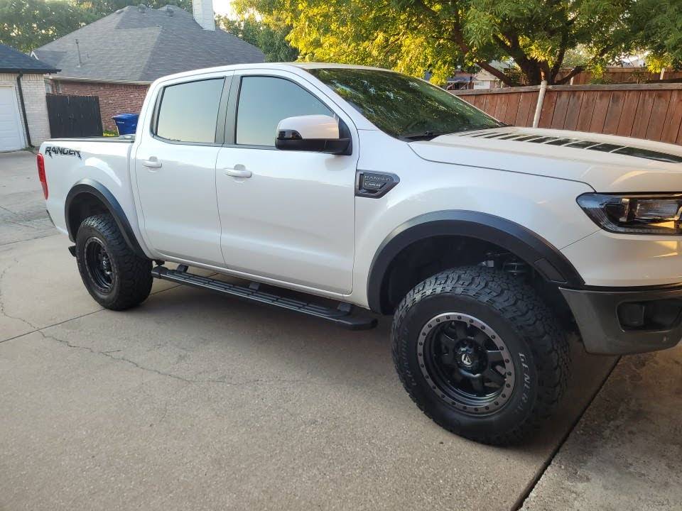

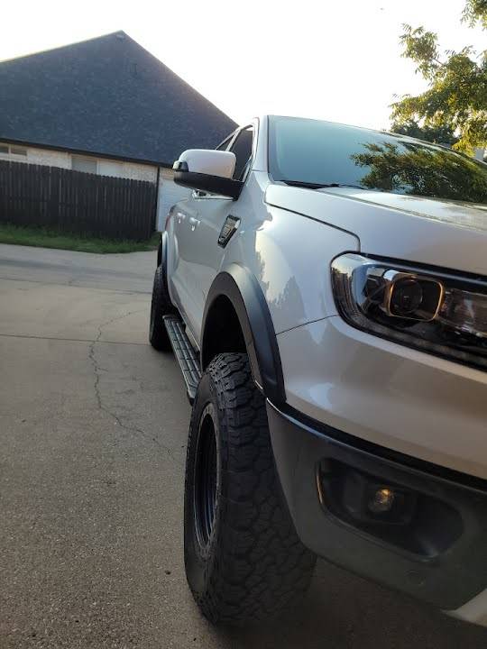

Lund SX133S Fender Flares - as others have mentioned, you have to do some modification on the passenger side as the side marker light won't clip in and stay. I filed the light itself as it's got about a bit more than 1/8 inch of extra material so I just filed it flat and the light then clipped in and stays.
