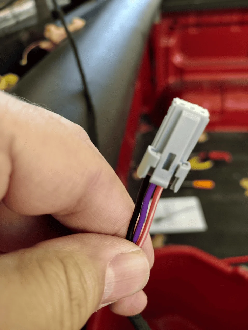

I recently installed the Redarc Tow Pro Elite with Lumen Module and when initially testing all seamed to be working as expected. Additionally, all 3 lights worked as expected when pressing the brake pedal. This was with no trailer waiting on the calibration period to complete. Somewhere along my test driving I noticed that my center mount high / mount tail light stopped working. After using a meter and a tow plug tester I am not getting signal back to the 7 pin trailer plugin point when the brakes are applied. Signal does work if I press on the Redarc button for manual control. Has anyone else experienced this issue? I hate to take everything back part, but it may get to that.

Looks like you have a bad connection to the high mount brake light connector that was installed as part of the brake controller kit.

Contact Lumen they have a guy who knows that system in and out. Dealer installed mine and I had it back to them 4 times before they found two wires crossed ( to third brake light) They said instructions were incorrect or misleading. Let me know if you don’t get anywhere and I can dig up his number

The connector you splice together at the center mounted taillight has a bad connection. You will need to pull it out and inspect it. You have to manually put that connection together and sometimes the little tiny wires are not seated correctly.

I found the problem. The white end cap that holds the wires in place did not engage / lock in place. Without that the wires can slide back out of position. I was not able to push this into position by hand. I used pliers to press against it. It will actually lock into position and be flat against the connector as show in picture.

I had to use pliers to snap that together also. The instructions are lacking with regard to this connection.
