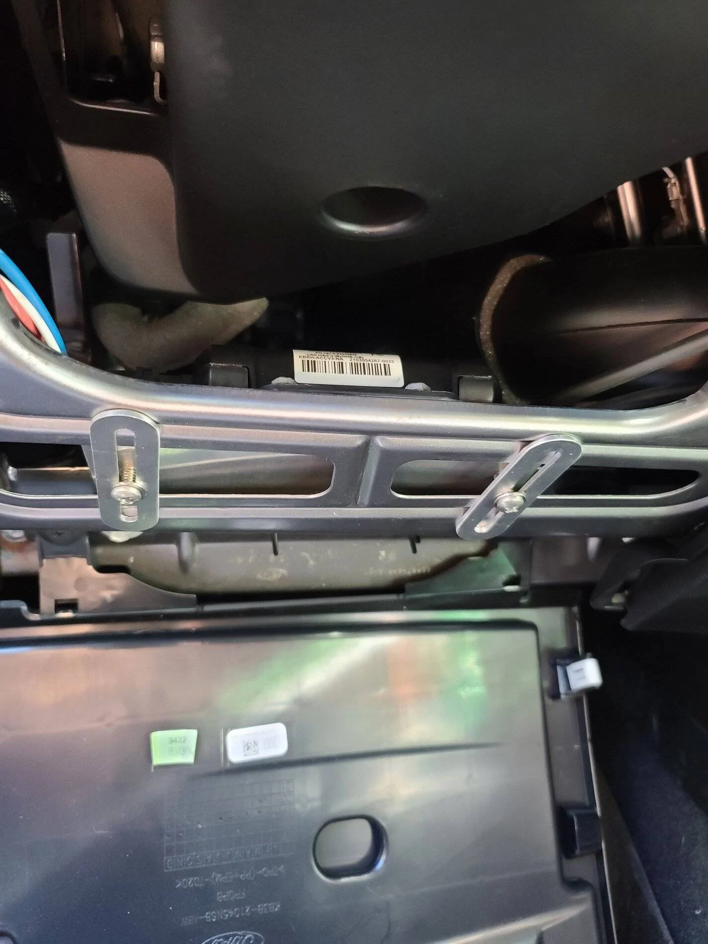

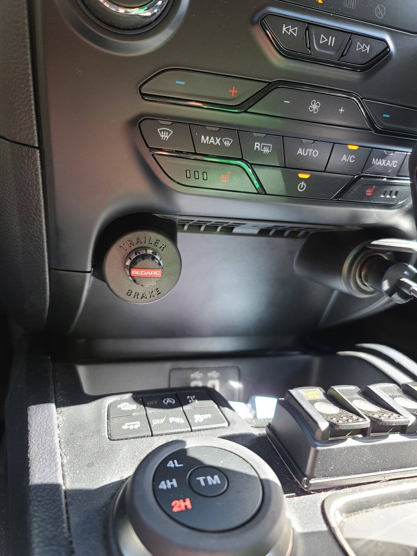

?EDIT. That should say Redarc Tow Pro Elite? I wonder how many people got absolutely robbed by the dealerships BEFORE the internet? My local Ford dealer quoted me $900+ to buy and have the Redarc controller installed. They said it was very complex and time consuming and there was the hole they needed to drill in the console or the fuse panel cover for the knob. What actually happened? I watched the Etrailers.com YouTube video, spent an hour and a half (not including fabricating the COMPLETELY unnecessary mounting plate and clamps), and finished the installation without drilling a single hole anywhere. All at a savings of almost $700.

No, I'm not too concerned with that given I'll be towing a 600lb overland type trailer mostly on dirt roads. I know I'll need to drive on the hiway to get to those dirt roads but that's fine. Also, I don't think the dealership is aware of that option, as this is the exact model and part# they quoted me.

You're correct, normally it wouldn't be a necessity but this trailer is made for WAY more sketchy terrain than I'll probably ever drag it so it comes with them.
