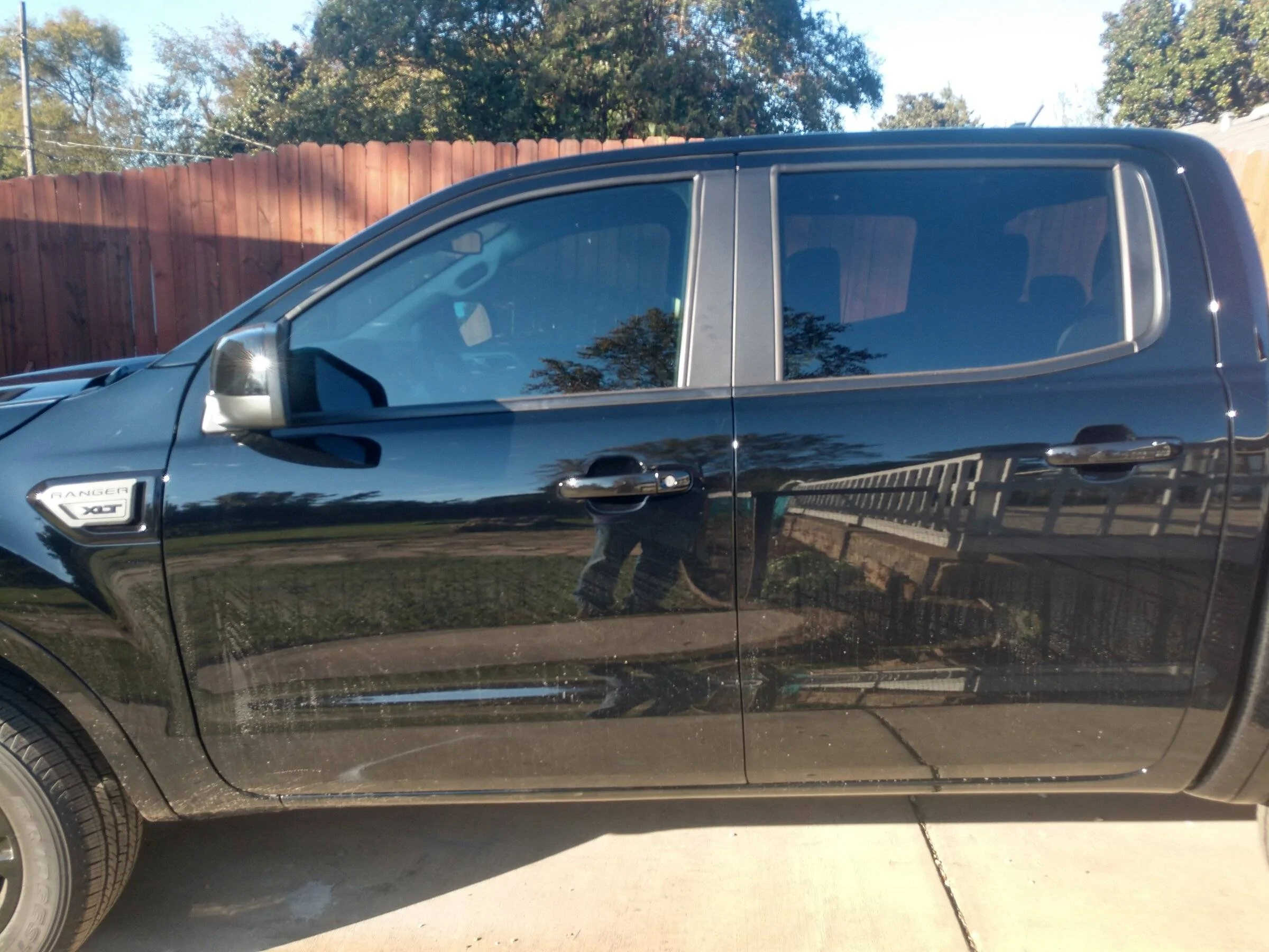

There is definitely paint underneath.....mine with the vinyl removed....

I was about to order paint matched pillars for my crew cab, until I stumbled upon this thread! Where they difficult to remove?
5,912
29,476
No, not at all. It's a thick vinyl. If you use a heat gun or even a hair dryer on low heat, start with a corner and just slowly peel off. You'll see where at the top it kind of wraps over the top edge...grab a corner and pull off at a 90 degree angle. Even if it tears, just take an edge and resume pulling.
Where the vinyl goes under the rubber window molding, it's only about 1/8 inch, and should pull right out from under the rubber.
Any residue can be removed with a bit of alcohol.

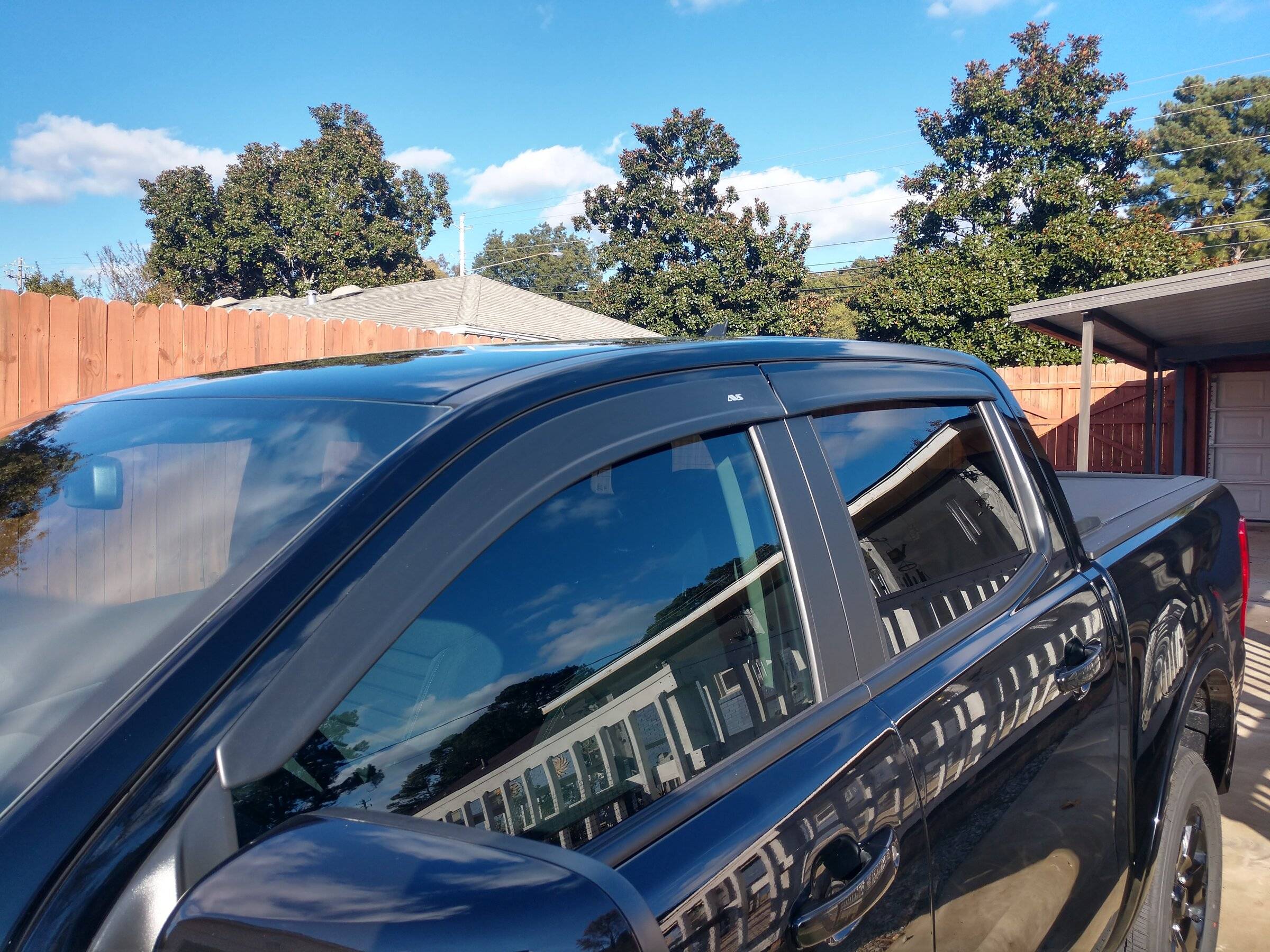

That's good news! I dislike how cheap this looks between the doors. I wonder how it'll look with those pieces removed on my CC?
I'm probably also going to remove my vent visors, as I bought them in Matte Black to go with the pillars, but I honestly do not like them now...
Looking at the pics of mine closer now, I'm unsure if it'll look right with those removed? What about the window weatherstripping? Looks like it's part of the pillar trim?

It shouldn't be...vinyl runs just underneath the weather stripping...kind of like it is a "flap" over the vinyl...mine peeled right out from under the stripping...stripping is actually part of the entire window channel that is pressed into the door window frame.
Remember...once you start to remove, there's no going back. Vinyl will stretch and lose the adhesive...can't be re-attached.
