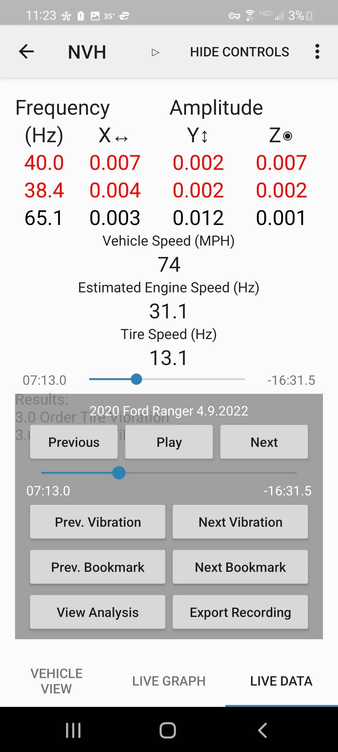

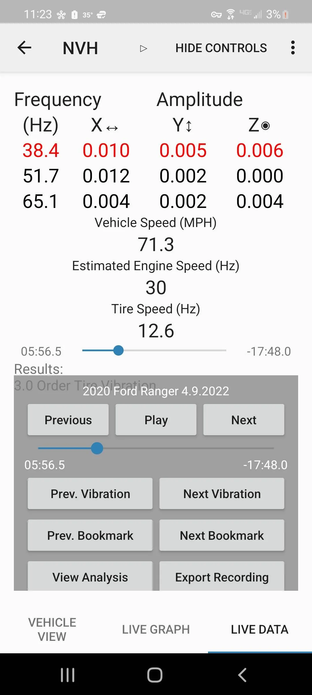

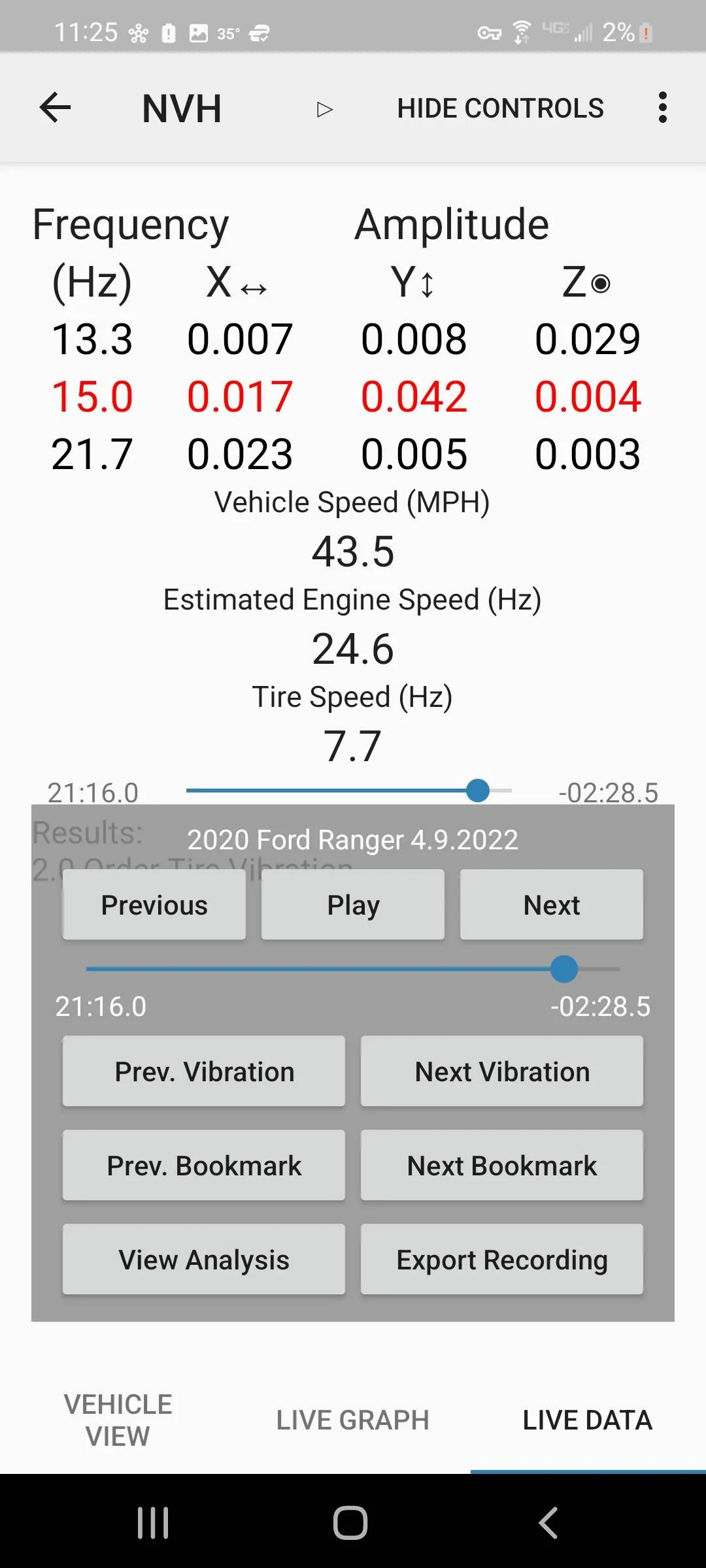

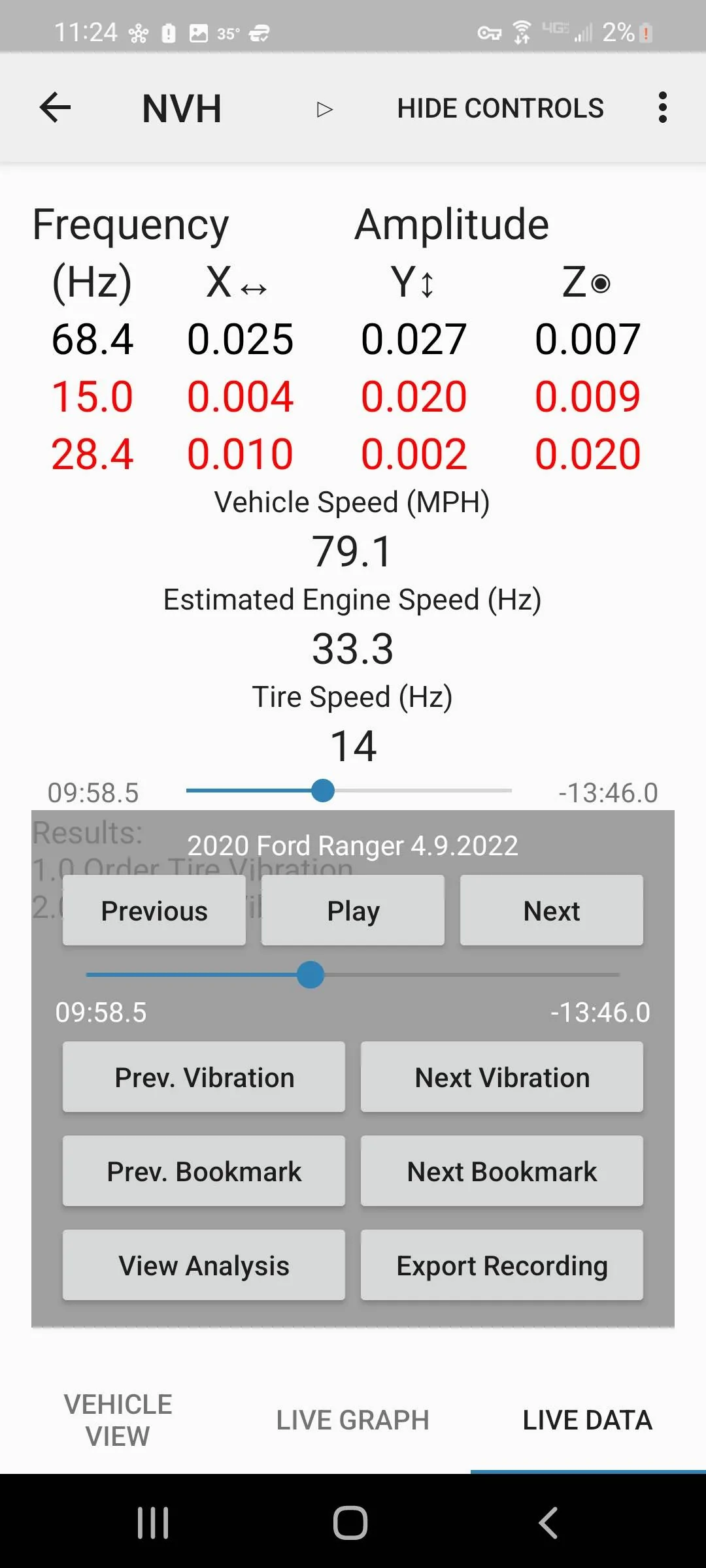

Phil,
Thanks for all your help on this site regarding NVH. Well, my vibration was tolerable and now again it's back... wondering if you could advise a little here (again). Getting lots of vibrations at 40-50 and again at 70 and up. They feel different. The lower speed feels like a shutter and the higher speed feels like a wheel balance issue to my butt and then it feels like both at the same time after that.... it's annoying to say the least. Here are a few screen shots of the NVH tool, captured from solid mount in center console. Frequency at upper end seems to suggest driveline and frequency at lower speed suggests tire balance based on your rule of thumb. Any thing you see here? Headed back to dealer again next week... thx!
