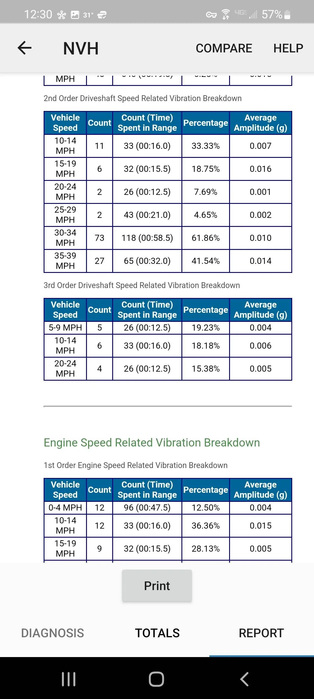

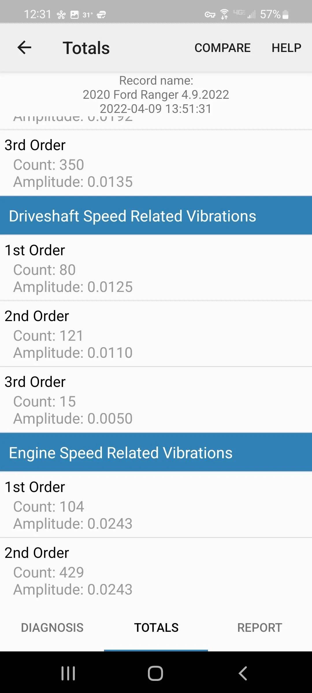

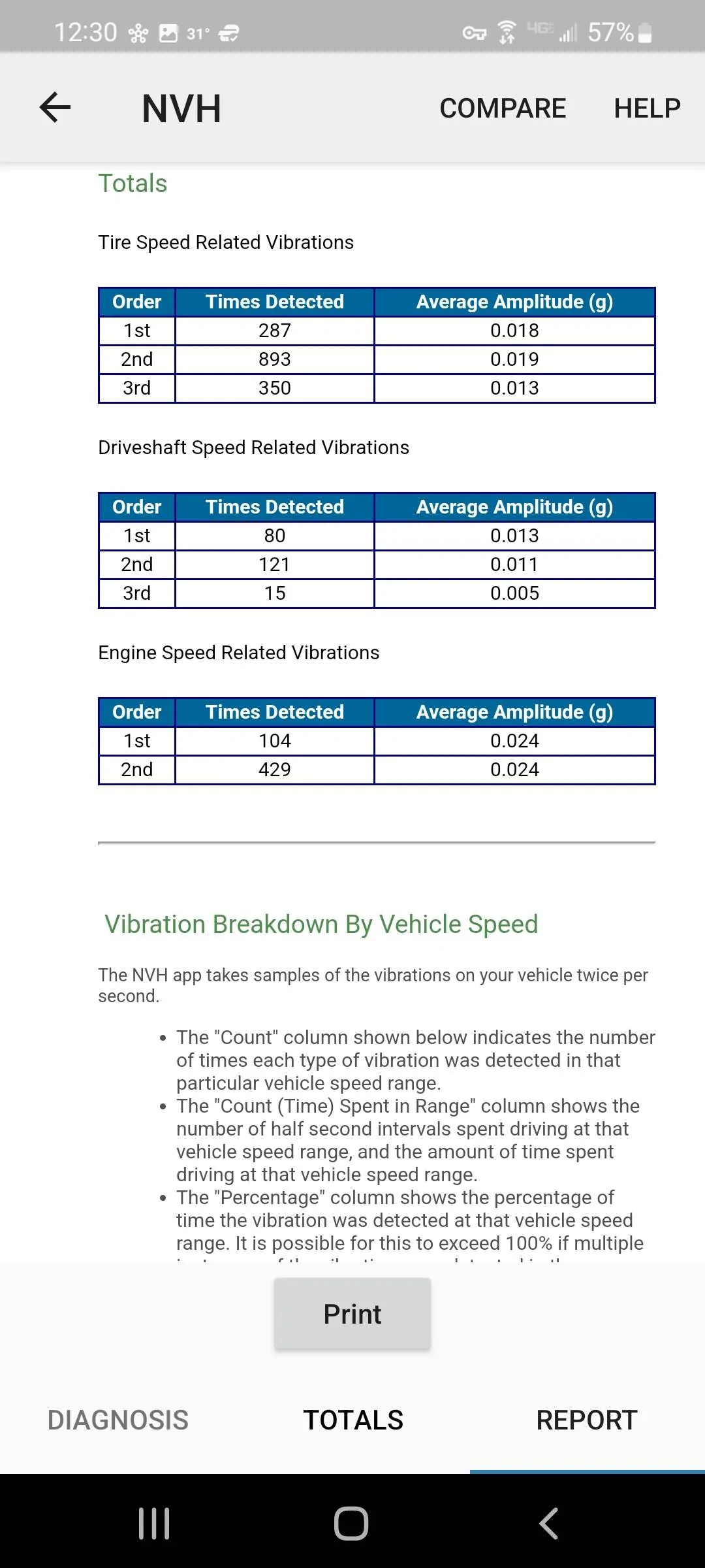

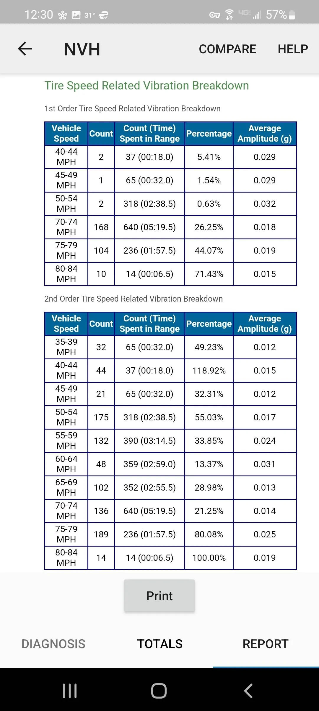

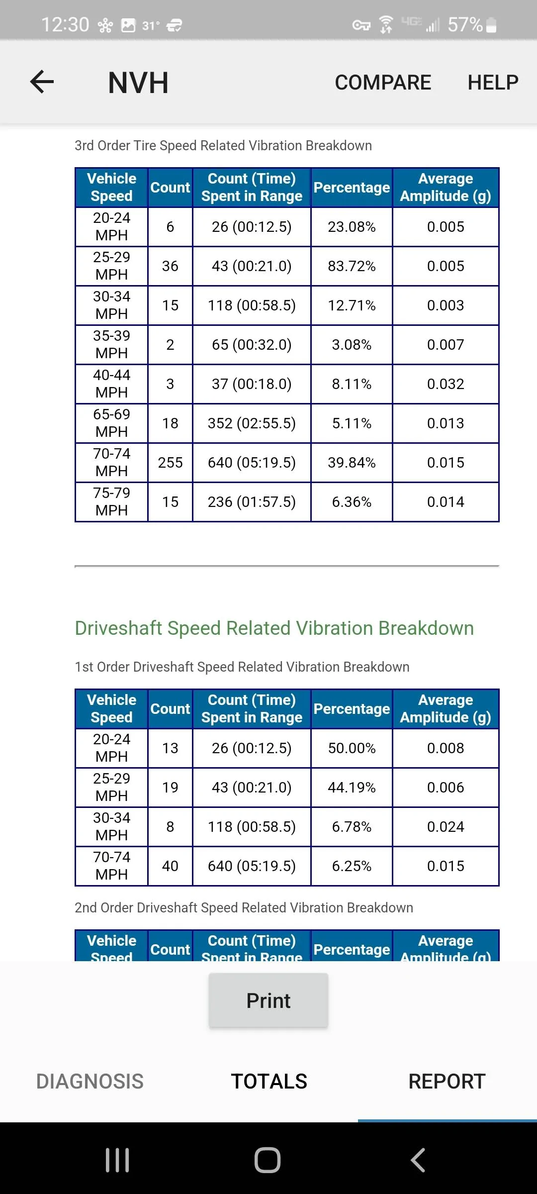

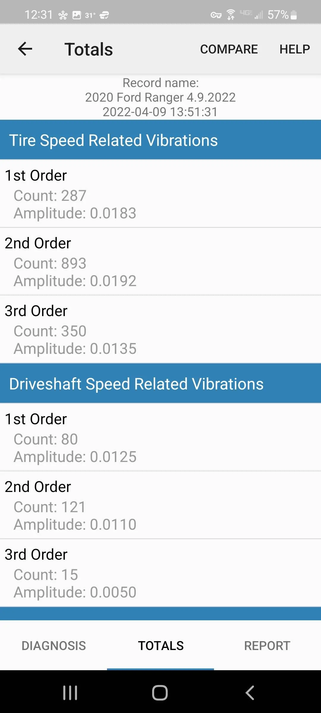

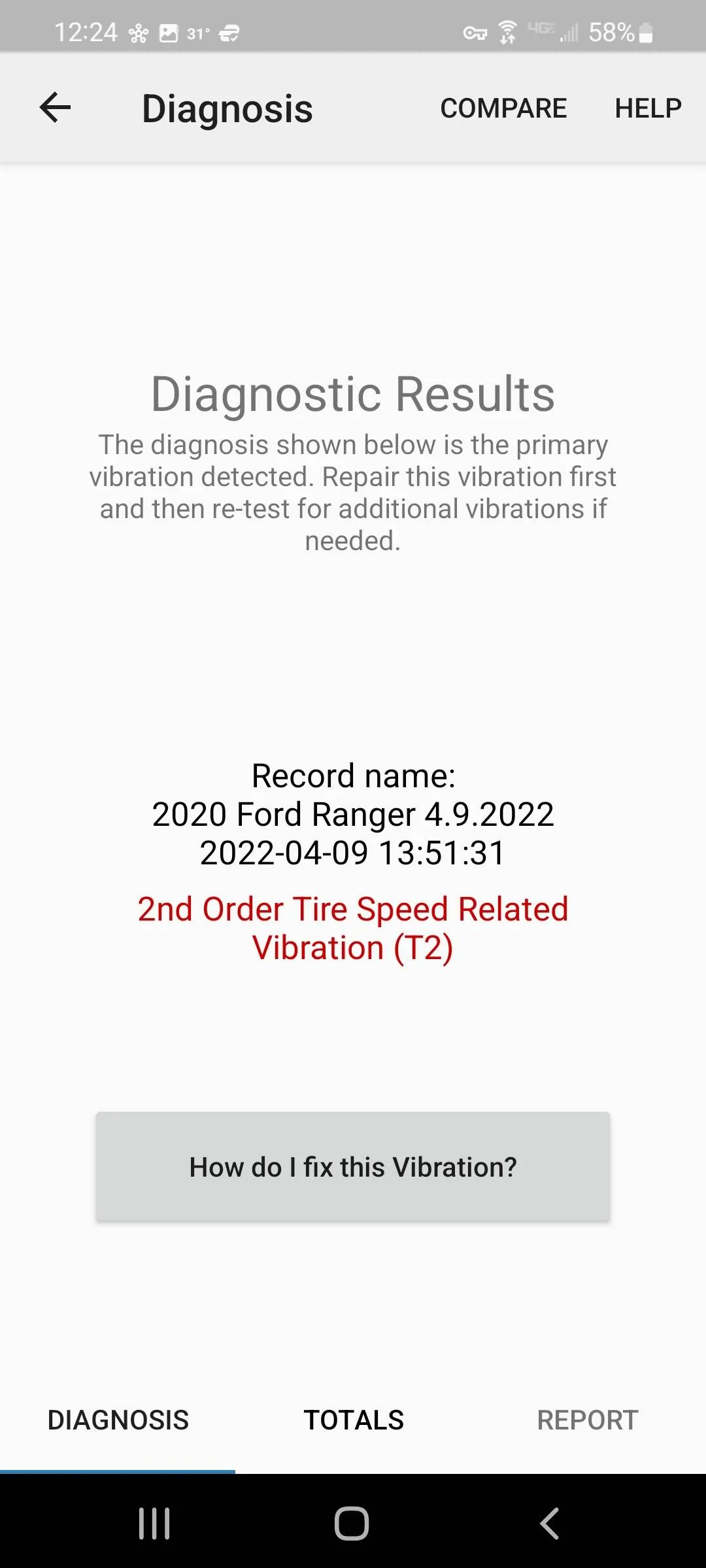

This tool does provide "ordering" at each vibration it recognizes...see below...

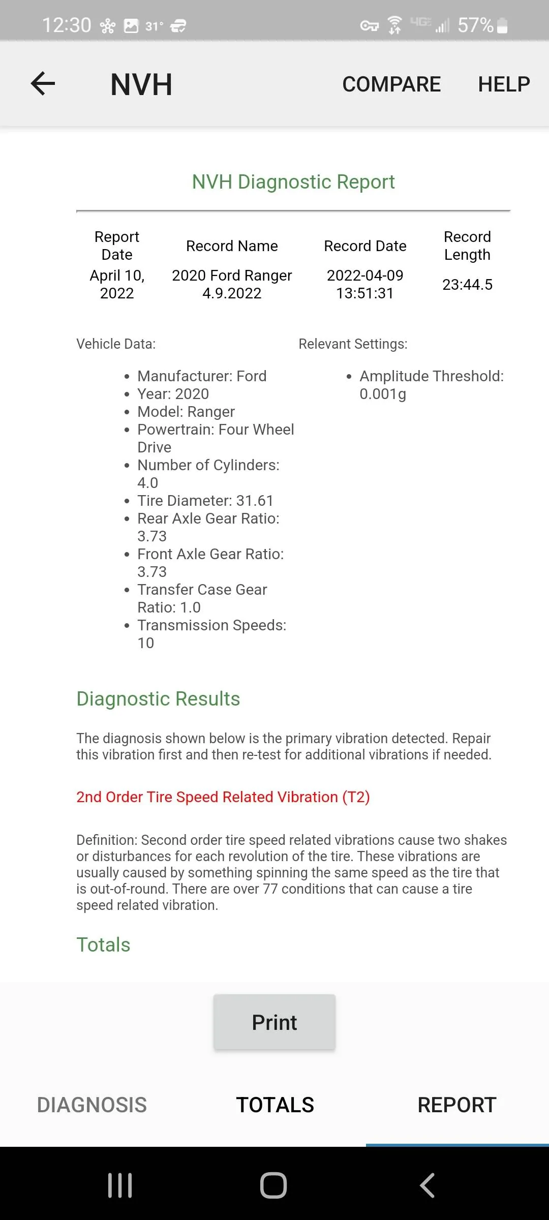

It calls out the most "egregious" issue first and expects you to solve that first then move on to the next. It also parses out each vibration into speed ranges like below...

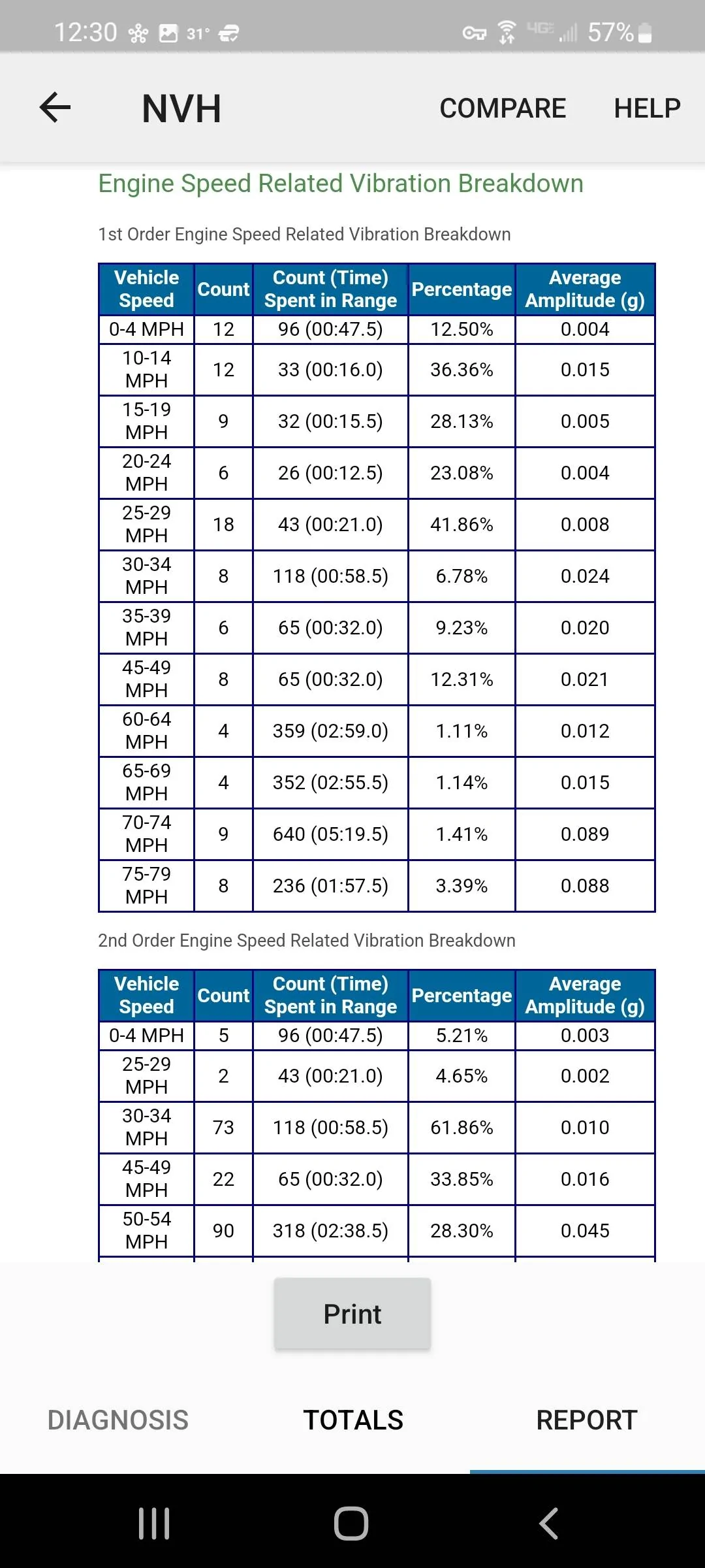

Then finally breaks down each count by order and amplitude ...
It also allows playback of the entire recording.
Hi Chris,
Certainly a lot of data, now the important part is extracting the information contained in the data. I think you might be seeing the affect of the 1 inch wheel spacers you added that are producing the 2nd order tire....JMO.... Still indicated tire vibration is front and center, and hopefully your tire shop can help with the diagnostics...
