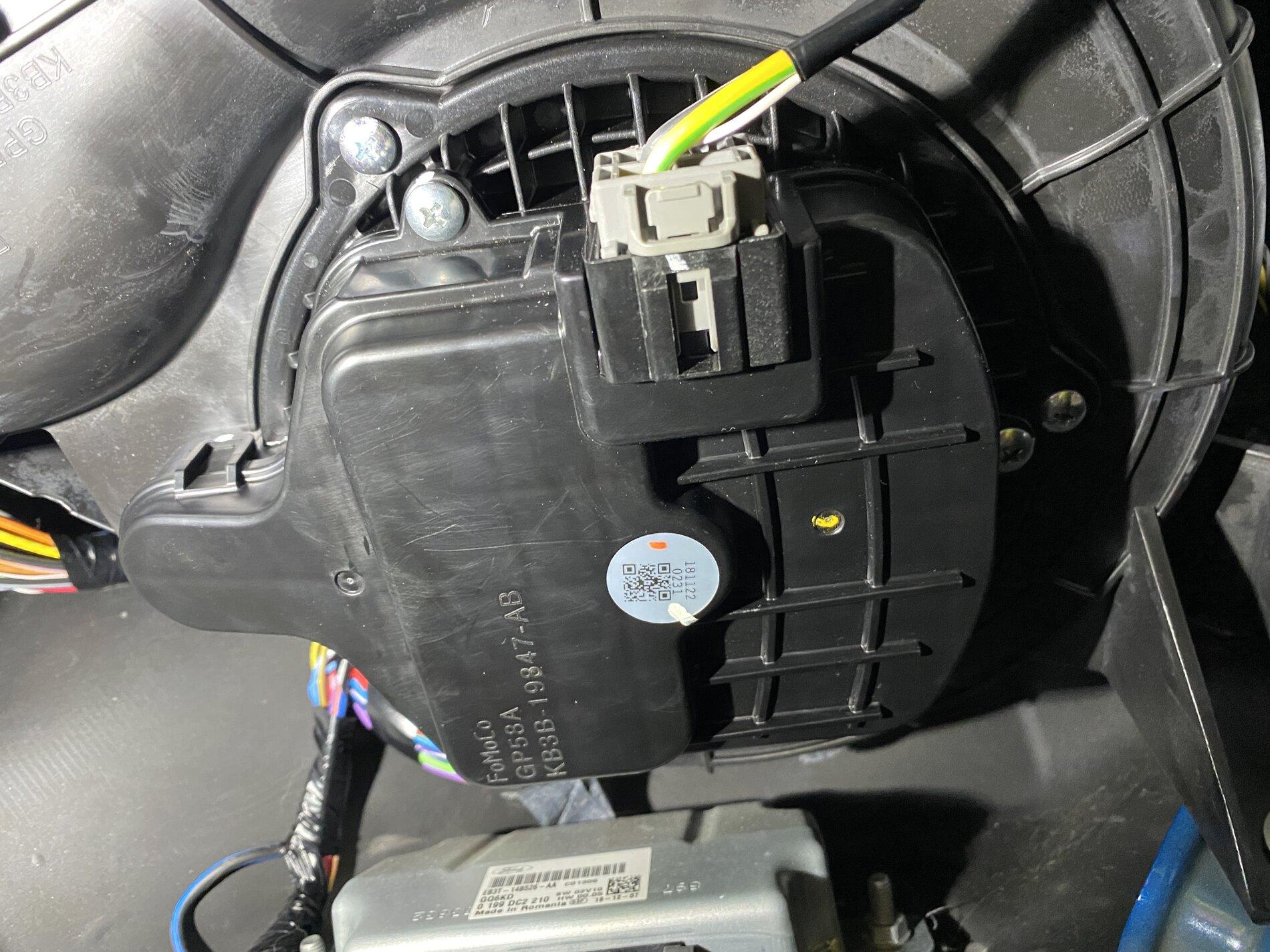

Incorrect sir. Just go straight under the dash and you will see 3 screws holding the blower motor in. Remove those screws and you can get the blower motor out to remove the rest

Thanks, about to give it a shot now. Appreciate the insight! I'll let you know how it goes!

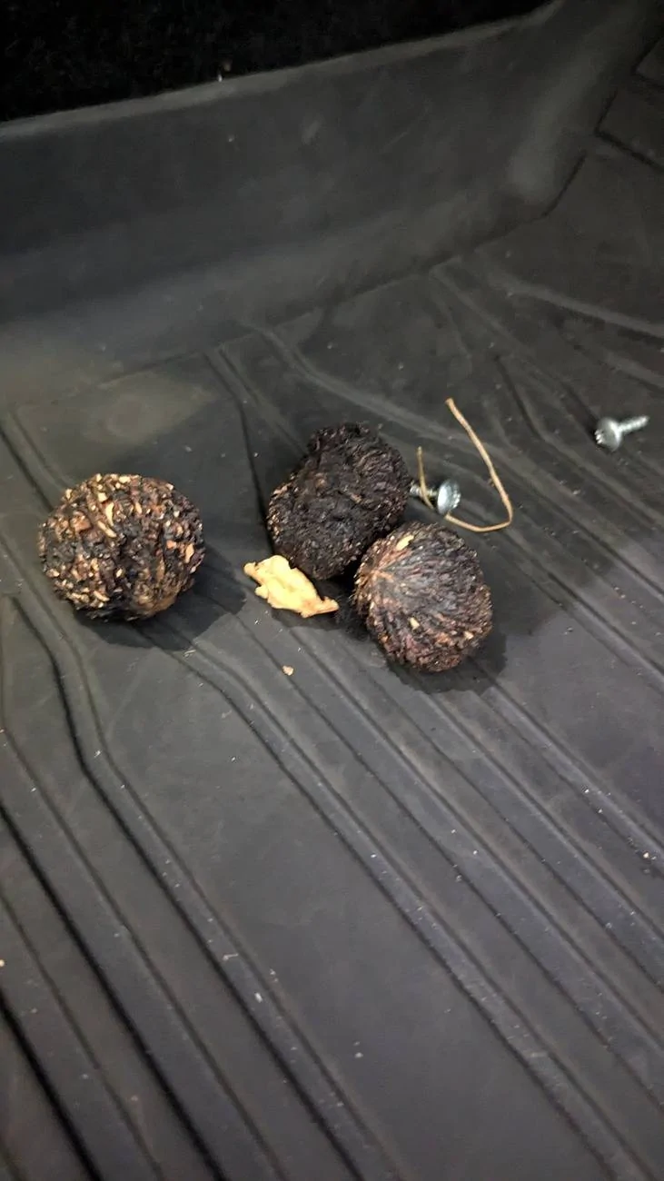

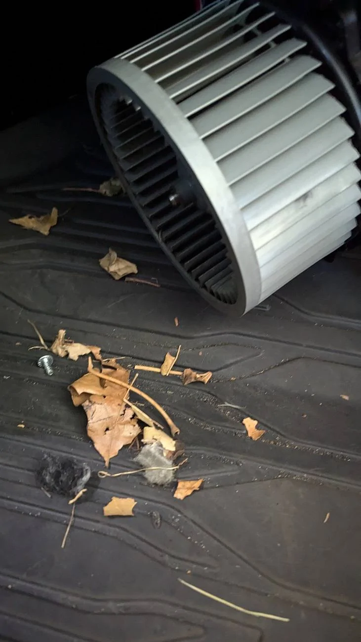

Thanks for this! Anybody like Walnuts?
