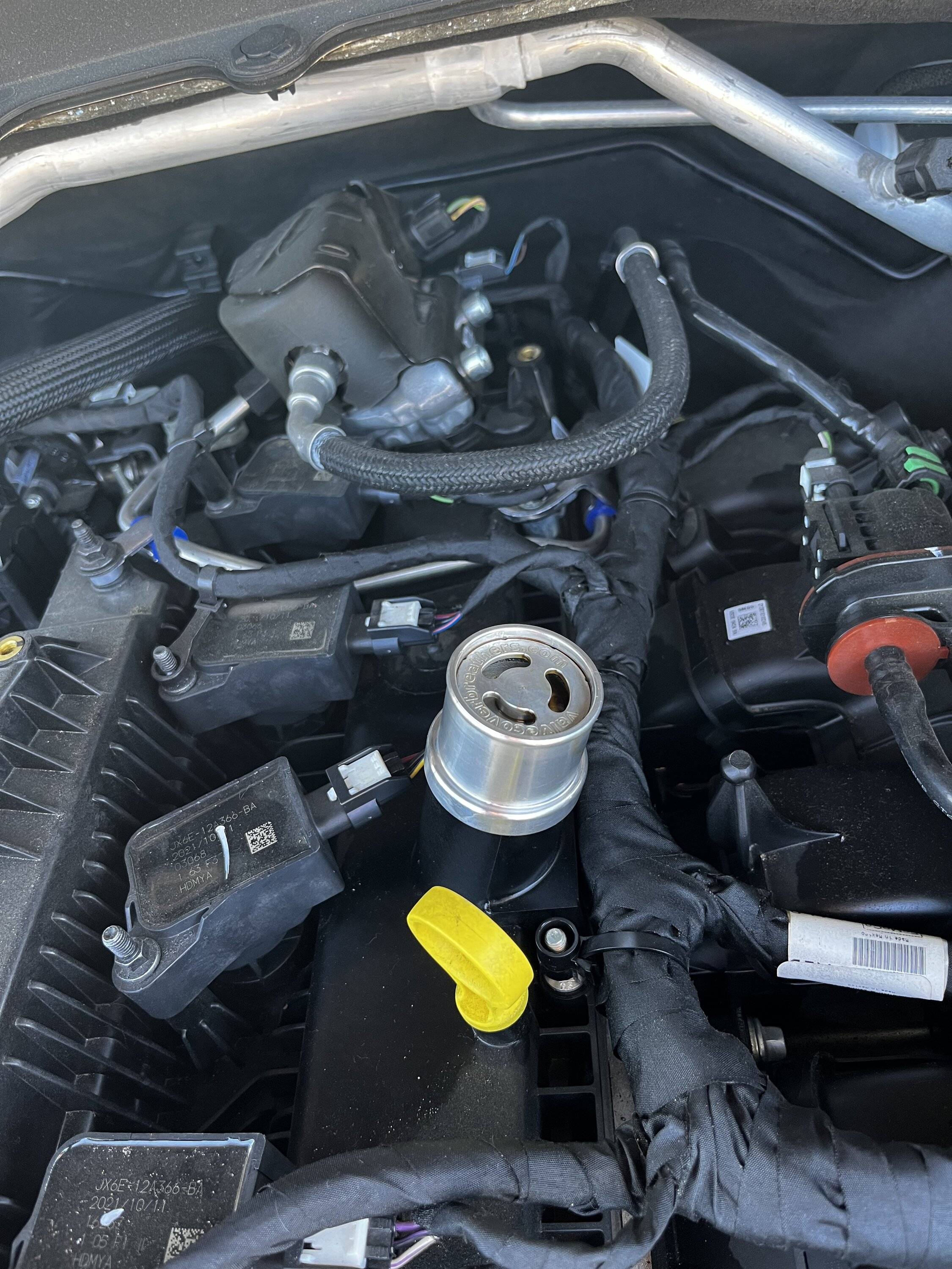

I am a firm believer in the UPR valve, but in the interest of science I had a 700-mile trip to do and thought why not let's see what happens
