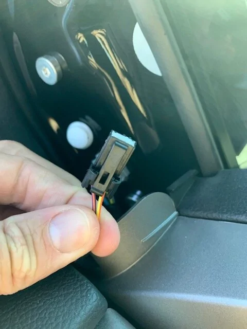

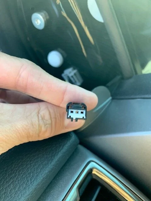

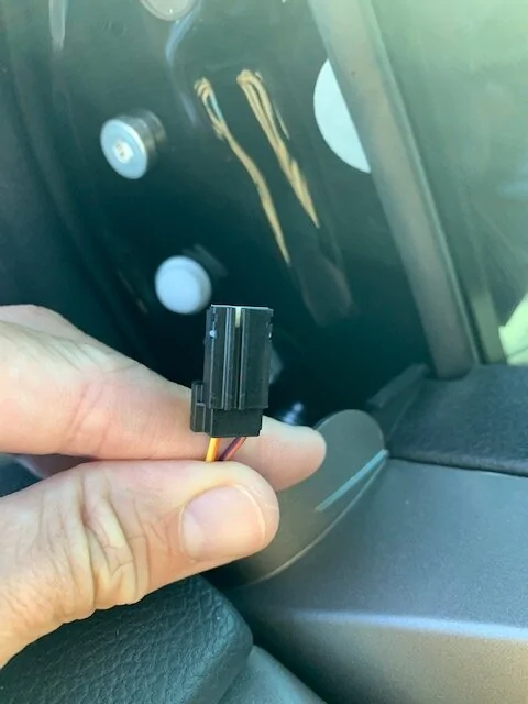

After reading through the few threads I found on tweeter upgrades I have a few remaining questions. I am looking to only upgrade the tweeters, as I have heard the high end could use some work in the Rangers. I have a 2020 XLT with no stereo upgrades and my questions are:
1. Can I upgrade the tweeters without an auxiliary amp?
2. I found a thread listing these Kickers as a direct fit into the housing, are there any other that folks know will pop right in without soldering or adjustments?
3. I had seen another thread that had door panel speakers and tweeters as a package, and those tweeters had the same plugs as the stock Ranger ones did, so it was an even more direct fit. For the life of me I cannot find them again, but it was a package anyway and I don't need the door panel speakers. My question is, does anyone know the part number or the plug type that our tweeters use to buy OEM or something that I could wire new tweeter wires into. Pictures of the current plug are attached (I would need the female side).

Just wanted to bump this to mainly see if anyone has information on the pictured type of plugs. I would like to make this as clean as possible and make my own harness.

I upgraded mine an I just cut the connector off. I left enough wire on the connector to reattach it if I want later.

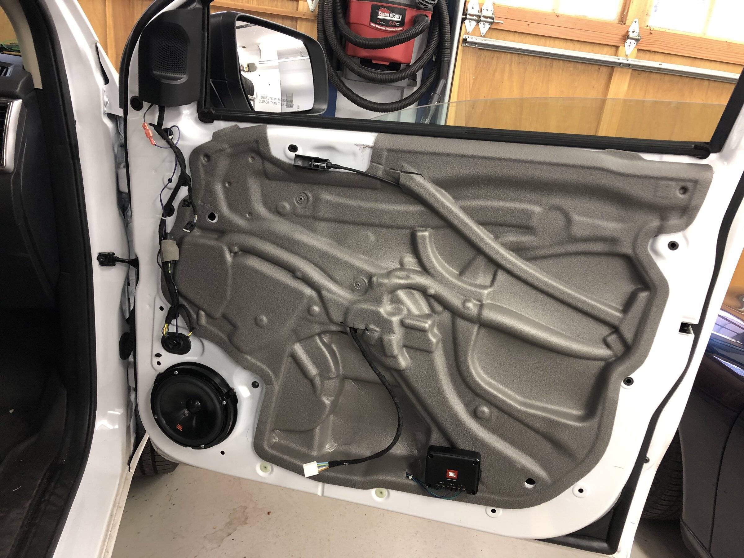

So yeah i figured I needed the crossover. Saw another thread about where to mount it but here is where I ended up. There’s actually a lot of room here, right behind the storage bin. Still needs more power but sounds way better with 6 new speakers. Better highs and less muddy bass. I’m 62 so entering the “eh?” Phase but even so I can hear the improvement. PS - the way the door latch cable attaches is genius.
It's very convenient but being plastic makes me nervous for long term durability. Probably an easy repair.
