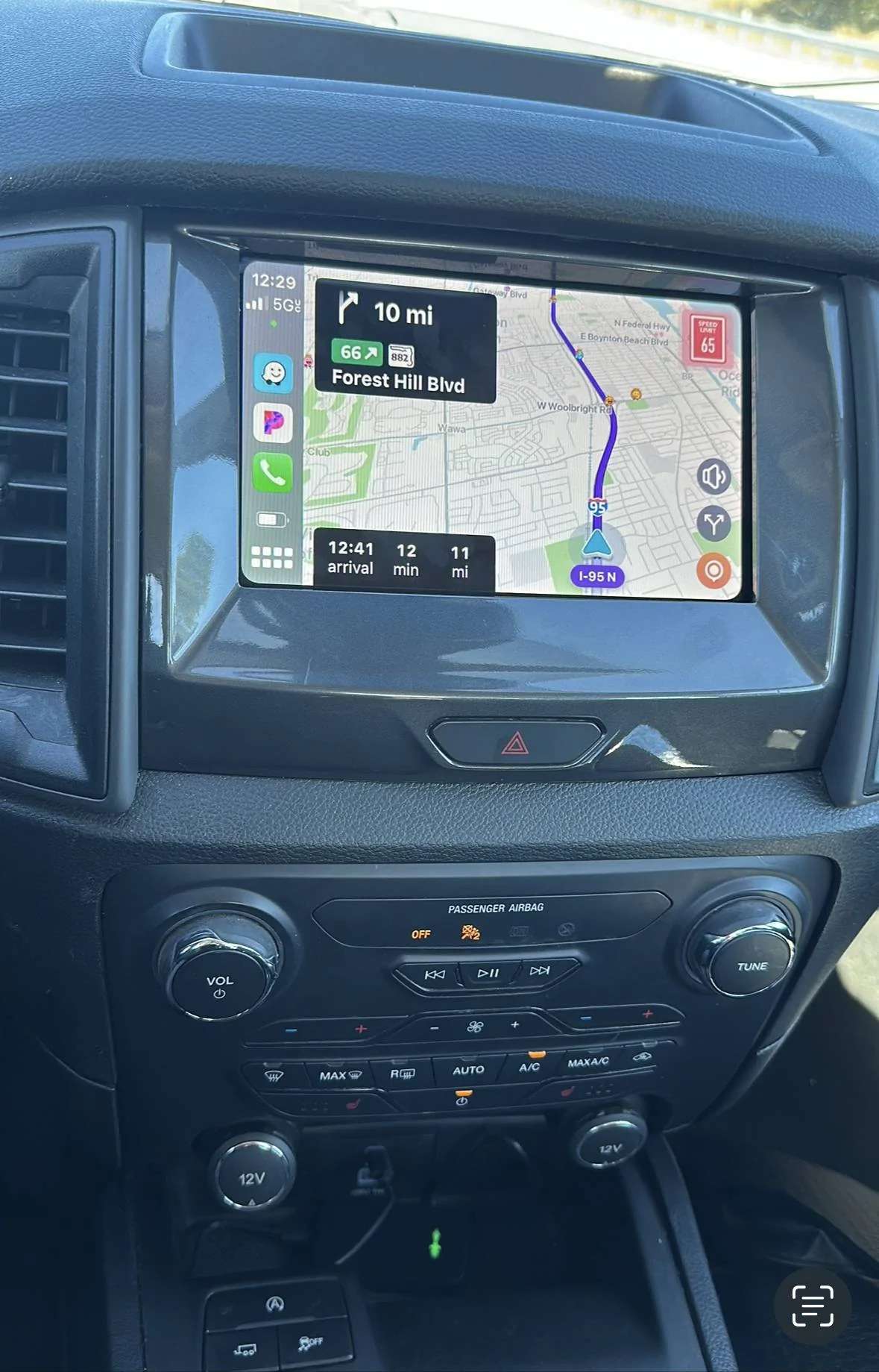

Hey all, I purchased the upgrade kit and installed it in my 2019 Ranger. I'm very happy so far, but have some minor issues that the folks at the company have not given me an answer to, or at least one I can understand.
1 I do not have a climate control icon on the screen. I can only use the buttons on the bezel but blind to temperature and cannot easily chose other climate modes.
2 I'm using apple car play but for some reason I have to install the phone every single time if I want to use the phone without the apple car play feature. Even with apple CP it has to automatically configure itself every time I connect it. Asks me about the 911 feature etc.

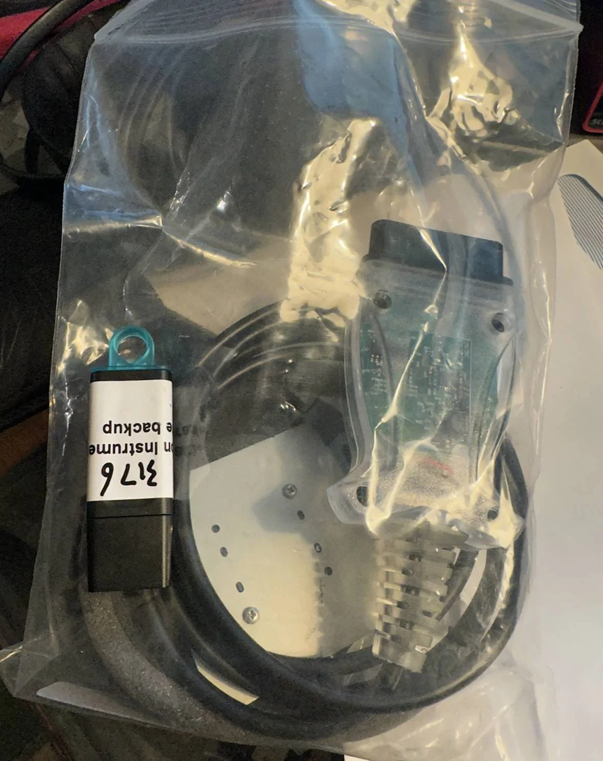

I received a USB with some general instructions, a USB/OBD cable etc. Also links to Forscan with what appears to be access to a lic download. I checked the version and it was already the latest version.

Watch this install video as a ref, you may need to use Forscan and perform a FCIM & APIM self-test, to get it to register that the new screen is installed, plus look for anything under New Module Initialization (In Forscan) I do not know for sure if the FCIM or APIM would be included in that run procedure.
I would also find and clear any and all fault codes - if present
I believe they (Intellegent1tech) can log in remotely and get it programmed if needed via Forscan.

Hi, yes that's the video I used where they said the GPS antenna was included. Great help on getting all the panels removed and the mechanical aspect of it. I will got to the forscan page and tr and find a download that might help. But where I got the kit, they simply said the climate screen button will simply not be available. A bit odd, but maybe they're right. Also communication with them is rough as they are I believe on China and the time zone does not help either. Yes, they programmed it using my VIN when purchased. Thank you!

I did lose the navigation and climate control options on the larger touchscreen; I have a compass now instead of the map (but to be honest, I use Waze so the maps not a huge loss). The climate control on screen was cool, but everything on the panel below the screen works fine. Re-connected my phone via BT, and reconnected by FordPass app after getting home and connecting to my Wi Fi.
