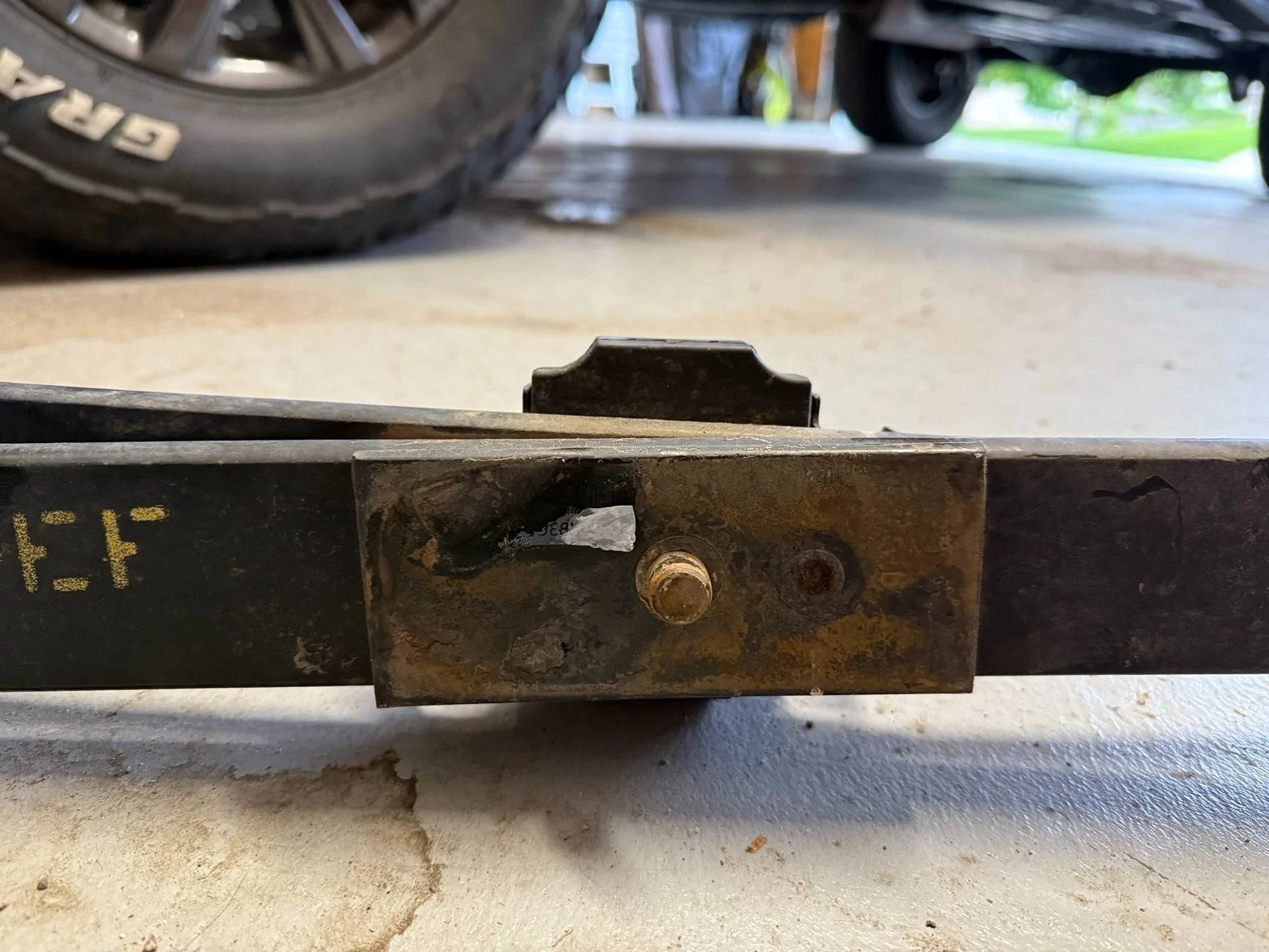

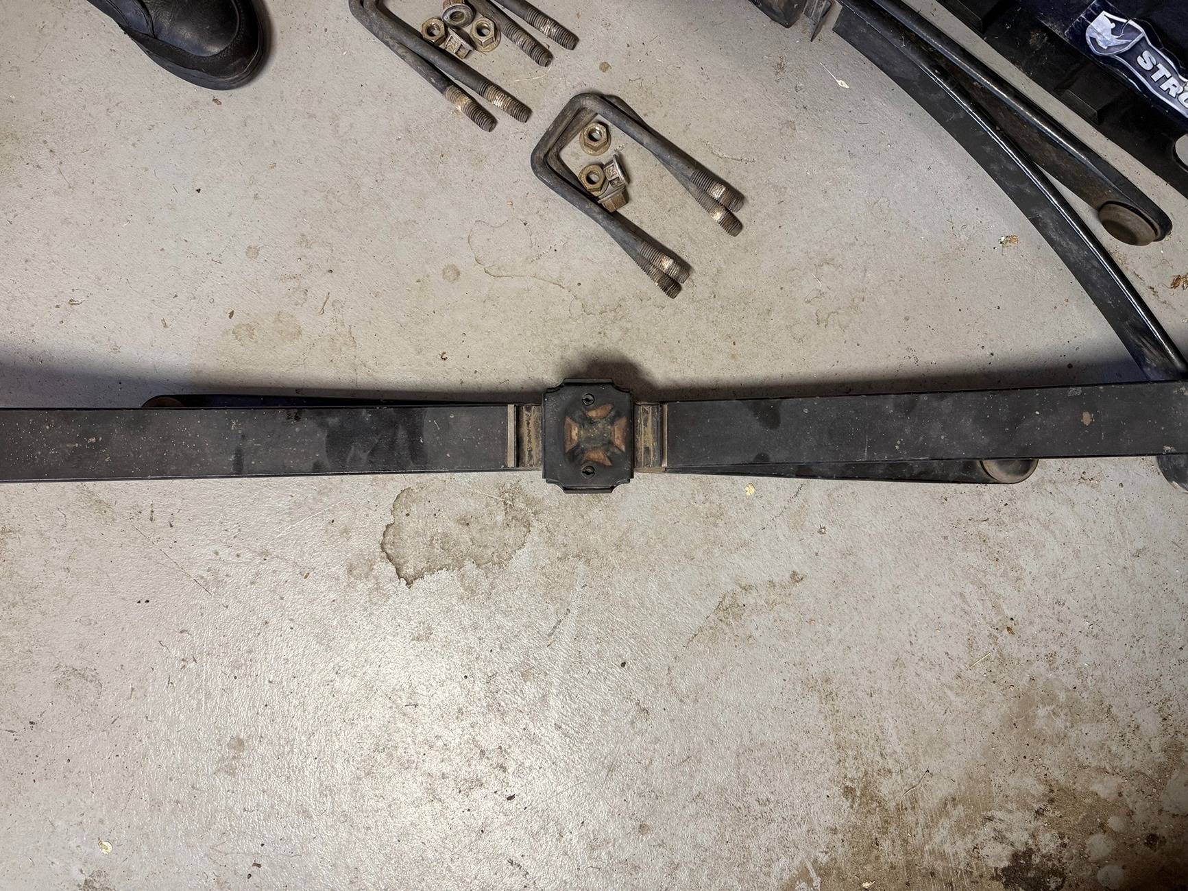

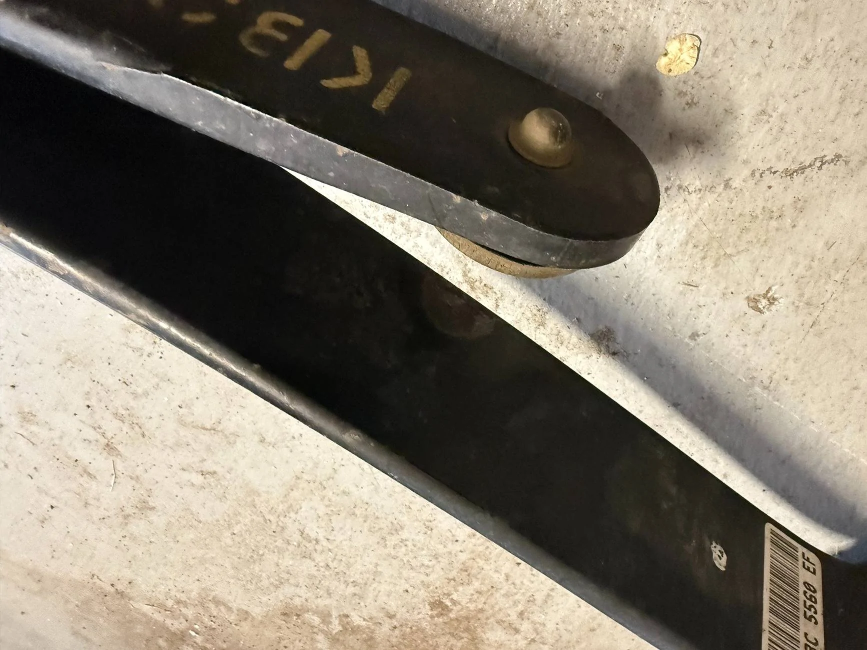

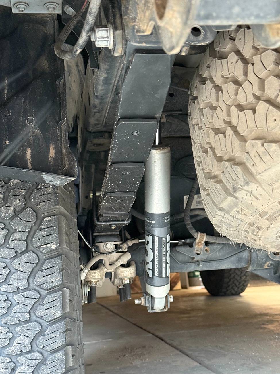

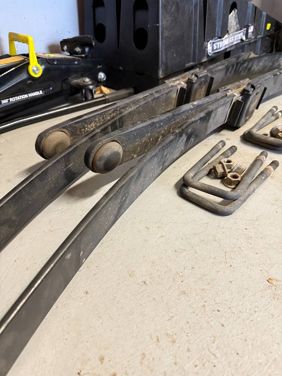

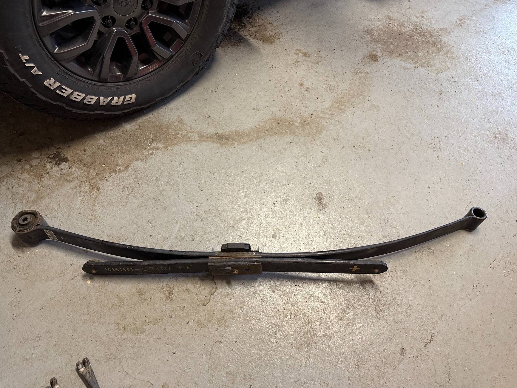

I got my ICON rear leaf springs in today at the 3/8" rear lift configuration. They definitely ride better. The install was not bad with an extra set of hands from a buddy. The hardest/worst part was the first bump stop bolt broke off like others have been reporting. I will deal with that another day and swap in the ICON bump stops. I ordere-d the 2 leafs and the ICON hardware kit, but annoyingly the new leafs come with new bushings already installed in the front and don't come with new bushings for the rear side, so I'm re-using the original rear bushings and lubed them up with bushing grease. So for anyone buying new leafs, definitely get a set of new rearward bushings, too! They should really come in the the kit.
My driver's side OE spring was misaligned or bent somehow but not broken, the rubber bumper was 1/3 the way off from fully contacting the mono leaf! I had no idea it was like that until I had dropped the spring out and looked at it. I'm definitely glad I upgraded the stock leafs. I should have sooner. Dropping the axle I could see my Fox 2.0 shocks extend an extra ~1.5" of travel that I have been missing out on the last 5 years due to the limited travel of the stock springs.

I am sitting at a 2" rake now with the 2.5" level and new ICON springs -- here are fender measurements to level ground --
38" front / 40" rear on the passenger side
37.5" front / 39.5" rear on the driver's side (I did re-use the factory driver's leaf spacer)
I am expecting the rear to settle ~1" once the new springs get broke in

Here are pictures of how jacked up my factory driver's side leaf was at 77k miles. My best guess is it got twisted out of whack while off roading (3-wheel event lifting a rear wheel?) and I never noticed. It still rode normal.

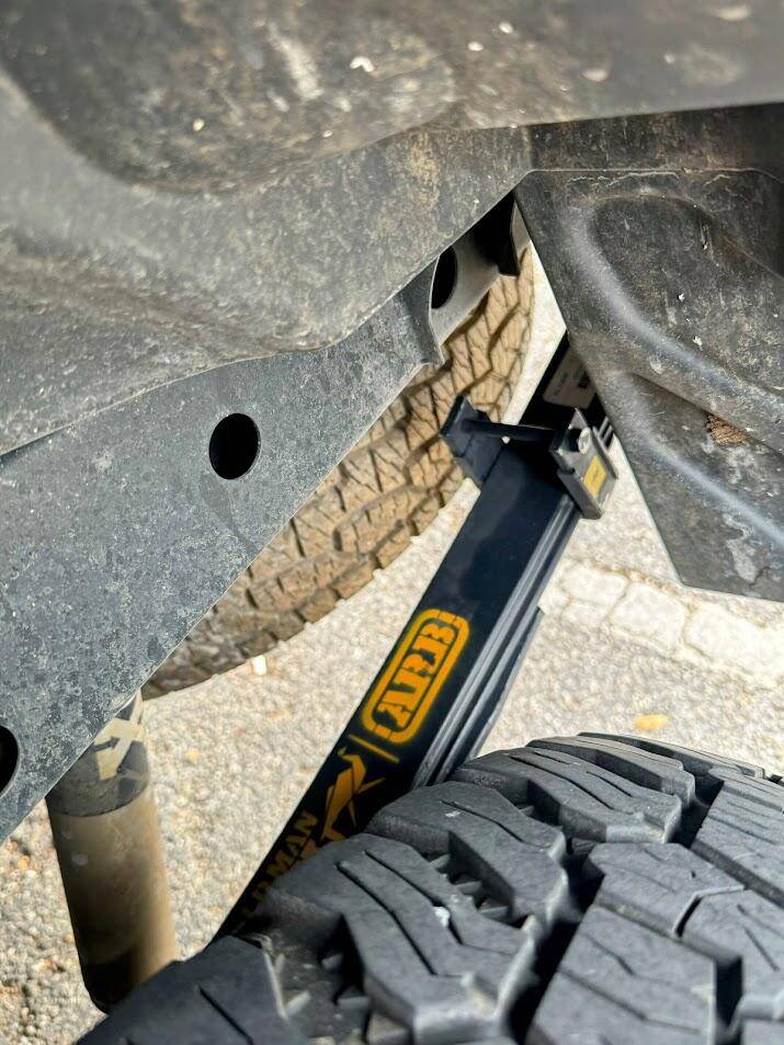

Even with the Fox rear shocks, I used to cringe anytime I saw a bump in the road cause I knew it was going to knock my teeth out.
Tossed on the ARB OME springs yesterday and it's a completely different truck. Actually rides smooth now, comfortable even! Feels like I bought a new truck.
I put the ARB / OME EL121R which lifts the rear by by 1.5" and adds 600 pounds capacity. Better ride than the stock springs. Have the BDS 3.5 " front lift (replaced the BDS coilovers with Icon Vehicle Dynamics Extended Travel 2.5 V.S. IR Coilover Shock Kit 91255). OME's gave the truck a tiny rake which disappears when I tow my overlanding trailer. Have the BDS rear Shackle 1" lift. Replaced rear shocks with FOX 985-24-068 which has a liitle more travel. Could not be happier!
