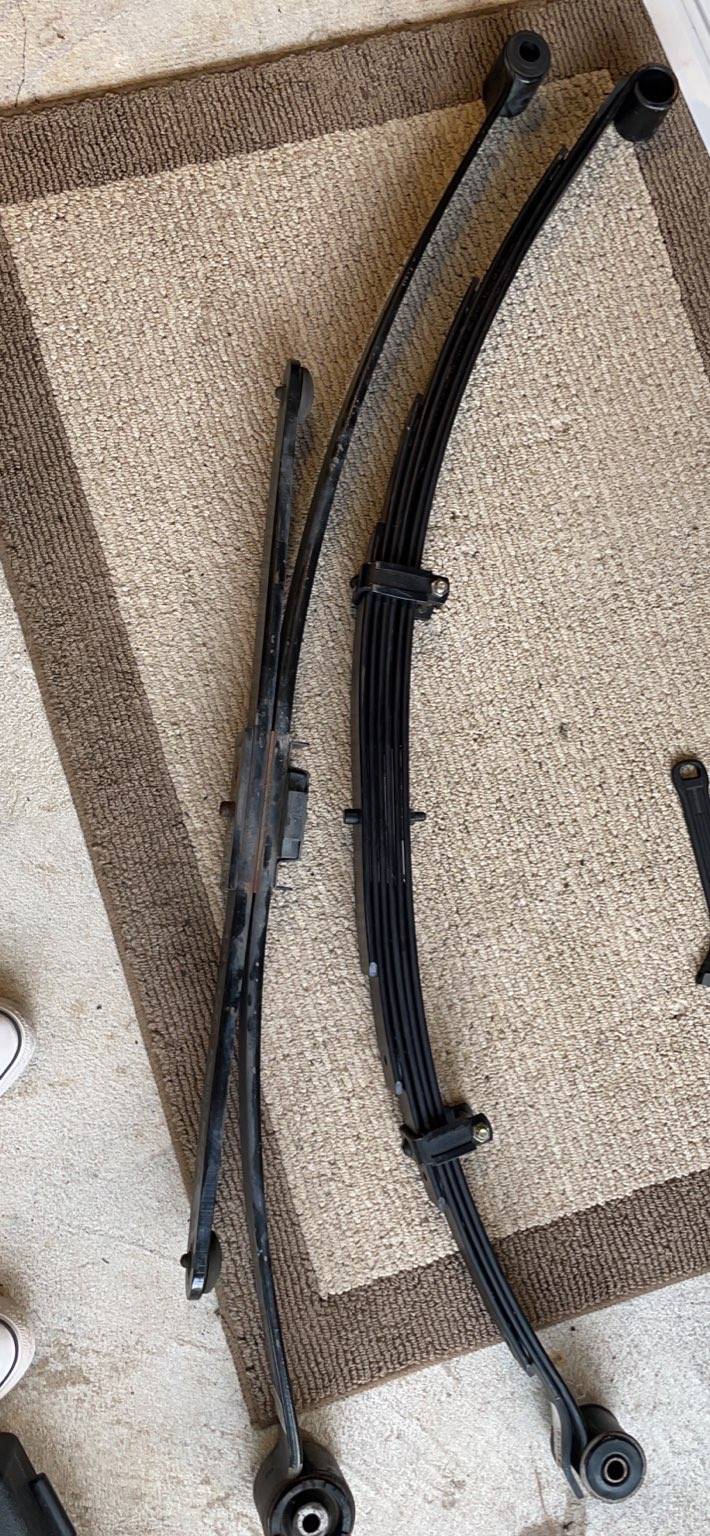

Has anyone installed these yet or waiting to install themselves? If you’re going to DIY, don’t forget to chock the rear wheels. Had to use a ratchet to pull the axle back forward to line up the driver side shim into place. Also, make sure to have the Ford shop manual for the rear springs as well. Icon’s are lacking specificity for torque.

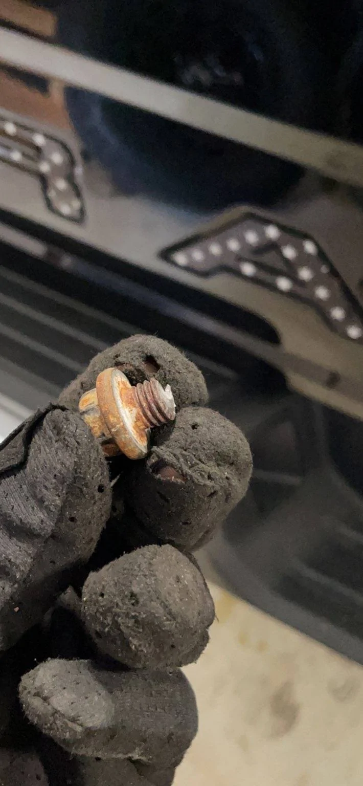

Lastly, be careful when taking off the factory bump stops. It seems the earlier Rangers may not have had any anti-seize or the wrong grade of hardware used to bolt them to the frame. Twisted both off after letting them soak with WD-40 and other rust cutters. Now to find a shop to extract the rest of the bolts and hope I don’t hit my non-existent bump stops this week in traffic…

Only have a drive around the neighborhood to compare them, but so far they seem to really smooth out bumps and potholes. I’ll update after I actually get a little more real world driving to compare them. I have them set in configuration 2, 1.125” higher than stock and leveled out with stock when carrying 350# in the bed.
For comparison purposes, I still only have BDS 2.5” spacer level on the front with the stock FX4 struts but have BDS NX2 shocks in the rear(incremental upgrades).

After about two months driving on these, I think they’re one of the best bang for your buck mods that I’ve done yet.
Wouldi do it again? If I knew about the ROW leaf packs when I did this, maybe not. If I didn’t know about those leafs, 100% would do this again…even more so now that I have an ARE bed shell for them to handle that extra weight while maintaining a nice ride.
Side note: learned something from a mechanic that does a lot of dealership work today, over the past few years Ford has started to send vehicles out of the factory with Red loctite on bolts that are attaching things to the frame. They explained this was why my bump stop bolts twisted off so easily, and said to remove them to heat a little with a propane torch before turning them. I’m neither a mechanic nor have I tried this, so take that as you will.
I think their blue threadlocker is just as strong as what all of us would consider red. One out of 4 of my driveshaft bolts hung up so bad coming out I thought it was galled or cross-threaded from the factory. A little bit of heat softened the blue goo up just enough to get it out. Probably the reason for all of the 'one-time-use' stuff on the truck. They either get buggered up coming out or they don't trust people to put threadlocker back on them. I half wonder if it is some heat-activated stuff that kicks off when the bolts go in at the factory.

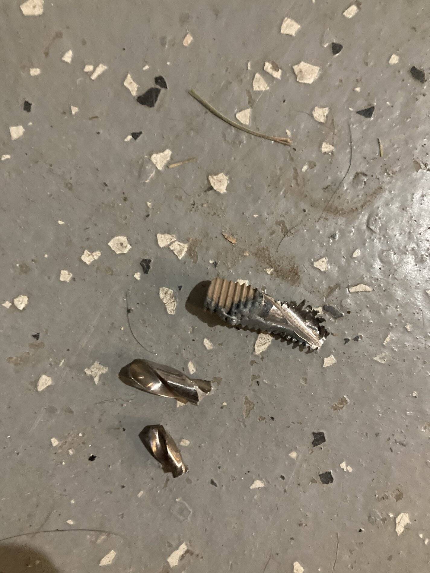

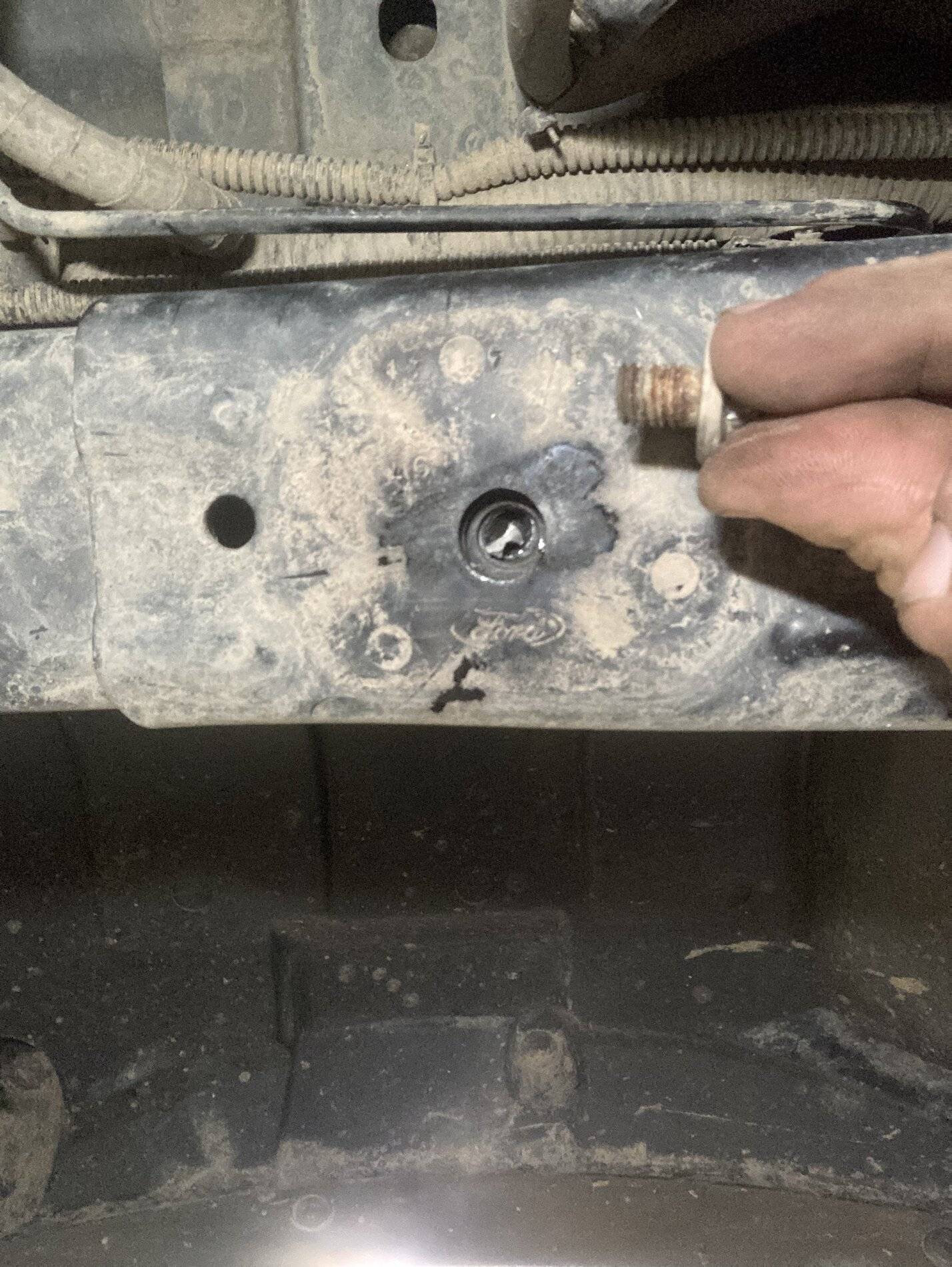

I broke one of the bump stop bolts off when installing my new rear leafs. I made a mess drilling it out and ended up cutting it out with a torch.
There is some access into the side of the frame I think if needed it could be drilled oversize and a nut could be used on the back.
Ouch. I wish I’d known what I learned yesterday to post a PSA here sooner. Sorry that happened to you as well!
Yes, as an approach method for all body hardware, a little torch heat will break any locktite. Just don’t get carried away with that. A moderate amount is all you want. Excessive heat will draw out the temper of the hardware making it useless to reuse if appropriate.
