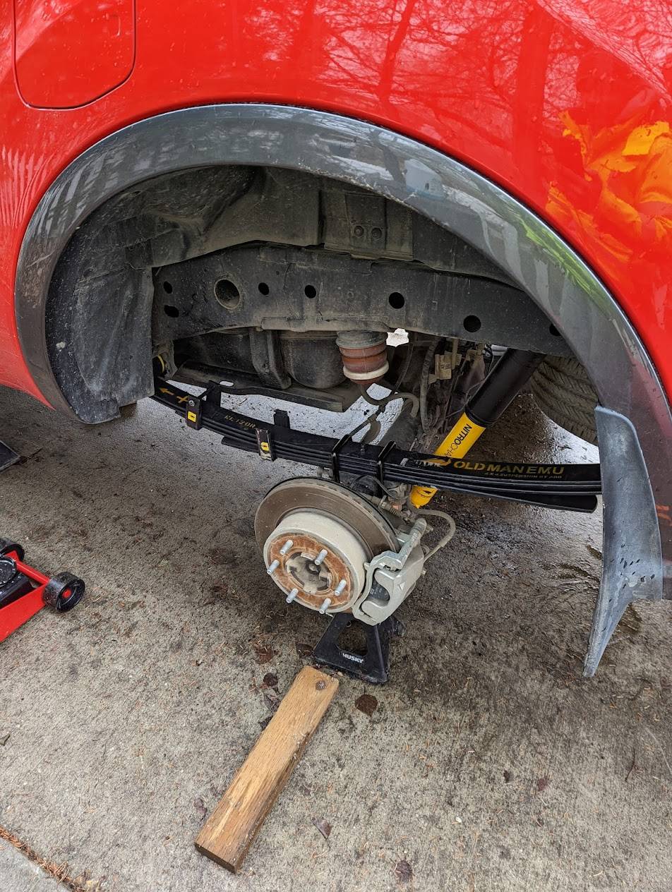

installed new OME leafs, wondering about the part that contacts the bumpstop
mapco
Evan
Jul 8, 2020
112
554
Fairbanks AK
2020 Ford Ranger XLT
There is no "bracket" on these leafs that contact the bumpstop or hold the U-bolts in place. Is that right?
Frenchy
Mar 15, 2020
165
7,560
10,776
Elizabeth, Colorado
Field Service Technician
If I remember correctly(it has been a while and I dont have the truck anymore) I want to say if there was a bracket on top of the old leaf spring then you would use it on the Old Man EMU leaf. But if memory serves me right I dont remember a bracket that sat on top. Just the one under the axle. Just make sure you torque it and you will be fine.
Frenchy
Mar 15, 2020
165
7,560
10,776
Elizabeth, Colorado
Also it looks like you did not put the little spacer back in on the drivers side. Put that in as it is still needed. You.may have to gring the little nub off but I promise it will stay.
