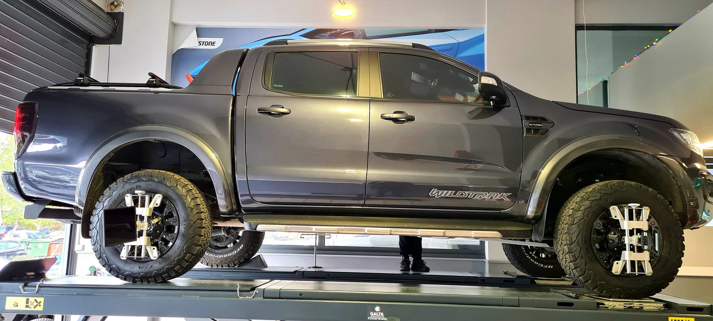

So it's both. It lifts the car by 2" and levels it. Best upgrade yet, totally different car.
Looking at that and the picture of the truck now I have a better understanding. It is more of a lift kit due to the shackles wich I prefer of the US not getting that with the Fox shocks.

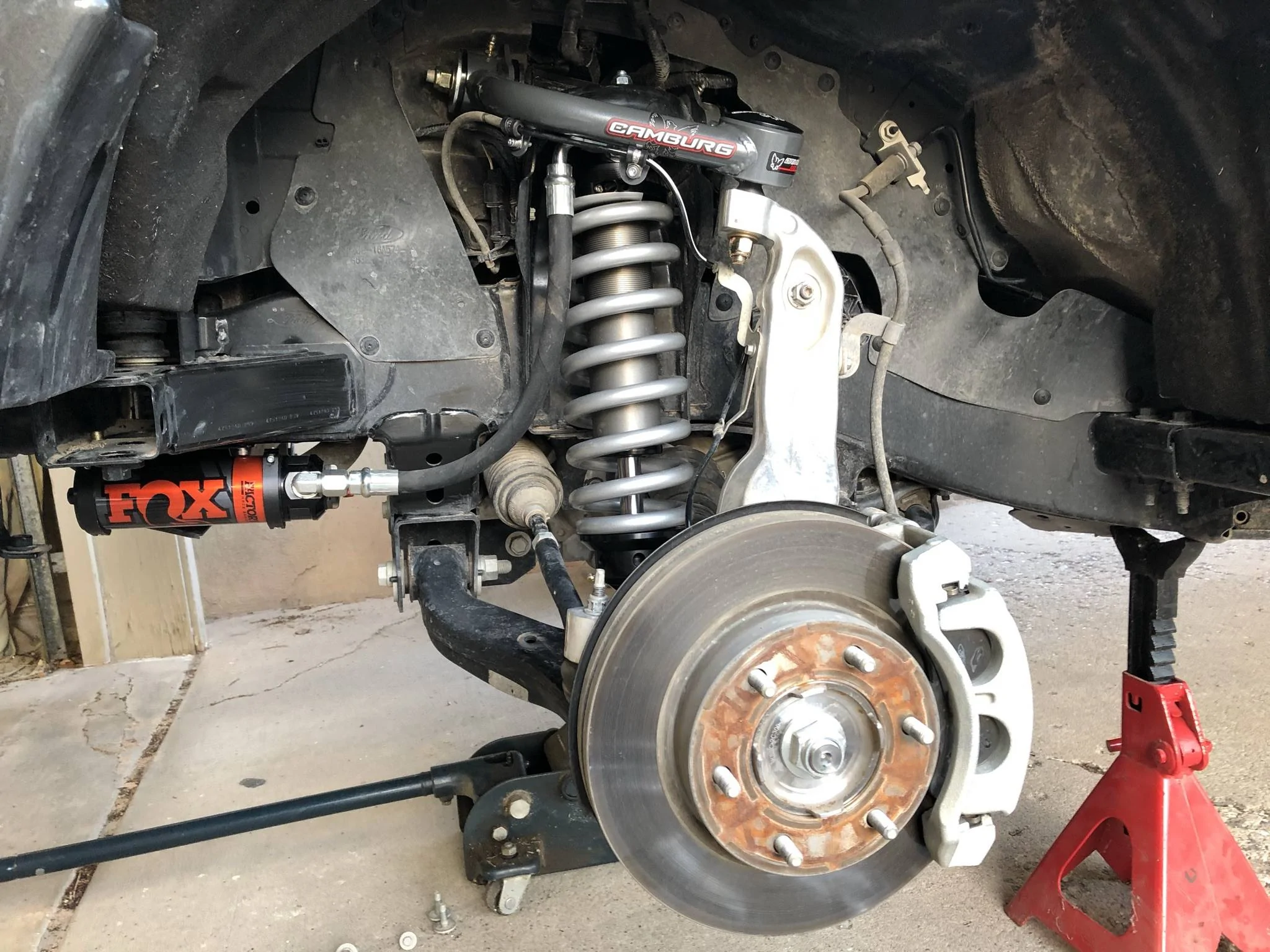

I noticed that with the Camburg UCA’s, the front suspension feels different. After installing the Fox coilovers I went for a short ride with the OEM upper’s so I would have a benchmark to compare to, the difference was immediately noticeable. The suspension was able to smooth out much quicker after taking larger hits and it just feels smoother while taking the hits.
I wasn’t worried about fitment issues, I was just curious if they were going to be worth it, IMO they are. We off-road regularly and couldn’t be happier with the Camburg/Fox upgrades
+1 on this! We too love these Camburg arms. We have (basically) the same set up you have on our ranger at the moment. Fox 2.0 with Camburg tubular arms. We have tested these out now for about 7 months and have done highway, trail, rock, and even obstacle course testing with this set up. Love every minute of it! Although we did have to back away from the level 3 course in some area's. Did not have quite enough clearance for some area's haha We have had a lot of folks coming to us for Camburg and SPC lately.

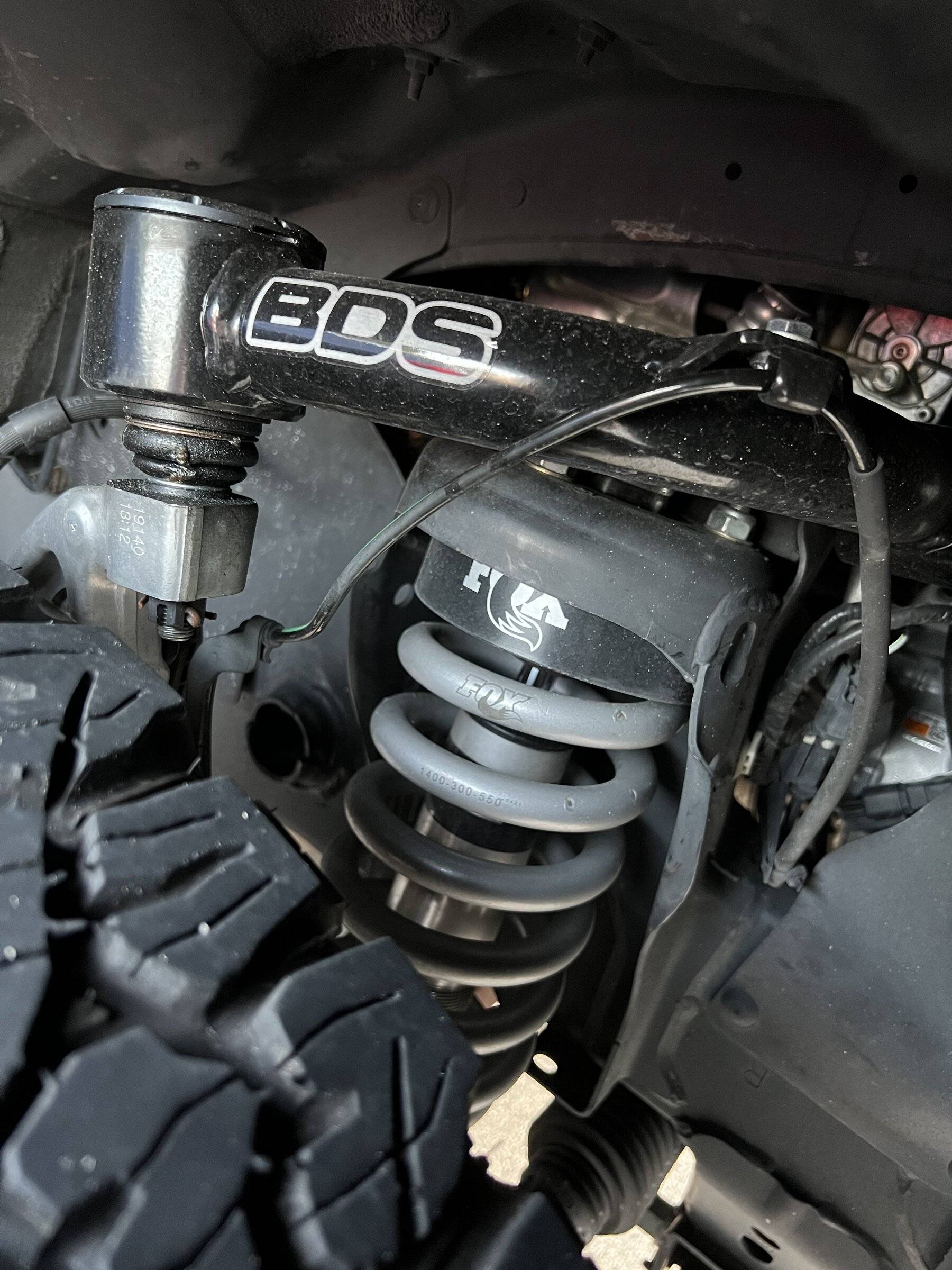

I have the Fox 2.0 set up with BDS UCAs. I had to run the Fox with the stock UCAs for a few months before the BDS came in. I definitely noticed a difference in the alignment and ride once I was able to get the BDS installed. I have not had any issues with the UCAs impacting the springs.
